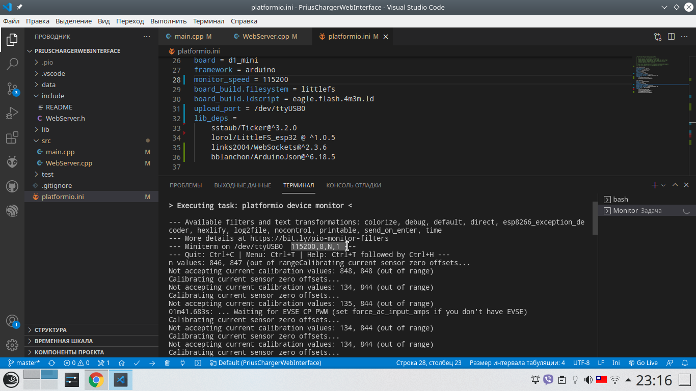

- Posts: 52
- Joined: Wed Feb 27, 2019 7:03 am
- Location: Belorussia. Borisov
- Has thanked: 16 times
Re: Gen 3 inverter converter control software
Hello everyone! Anyone have any success in getting data from atmega to wemos via the web interface? Atmega sends data to the port monitor, wemos sends the "params" command correctly and it is visible in pytty. I connect uart esp and atmega - there are no parameters in the web interface ...
atmega firmware:download/file.php?id=10638 from Bexander. ESP firmware: https://github.com/jamiejones85/PriusCh ... bInterface in which I changed the speed of the serial port from 57600 to 115200 (the same in atmeg) (I did the right thing?)
- Posts: 1787
- Has thanked: 83 times
- Been thanked: 431 times
I made changes to the firmware also for the parameters, https://github.com/jamiejones85/prius3charger_buck (out of date with Bexanders firmware), but I've not used or developed it further, I went with a different charging setup.
