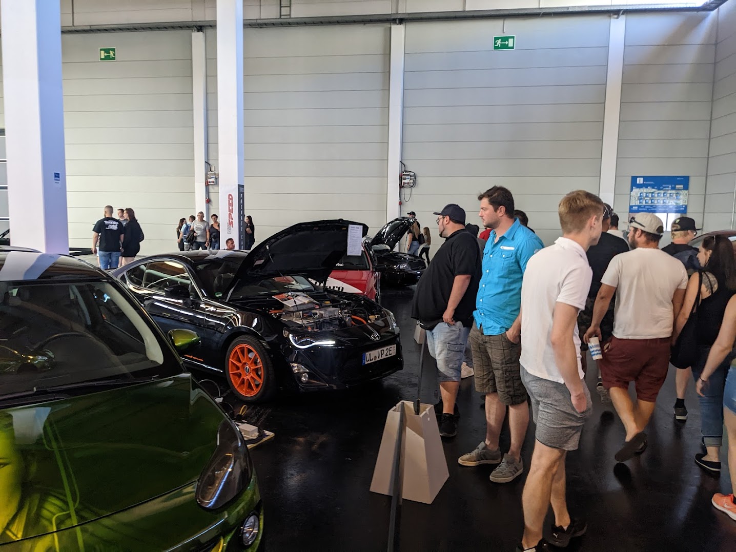

The EV86 is driven on a daily basis during summer. At the moment it is exhibited at a car tuning fair where i normally wouldn't go but i wanted to demonstrate that the EV86 is a possibility to have a fun and cool electric car that is not boring.
