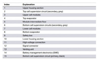

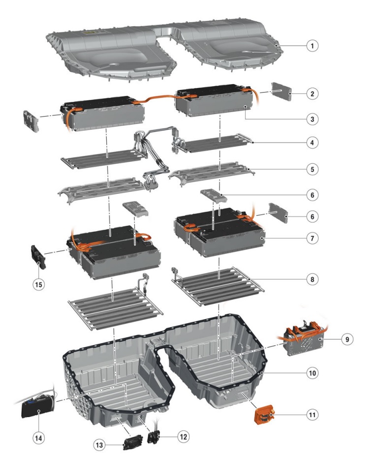

maybe you'll find this exploded diagram useful

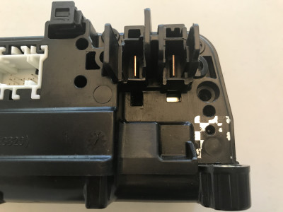

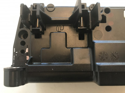

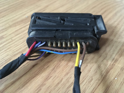

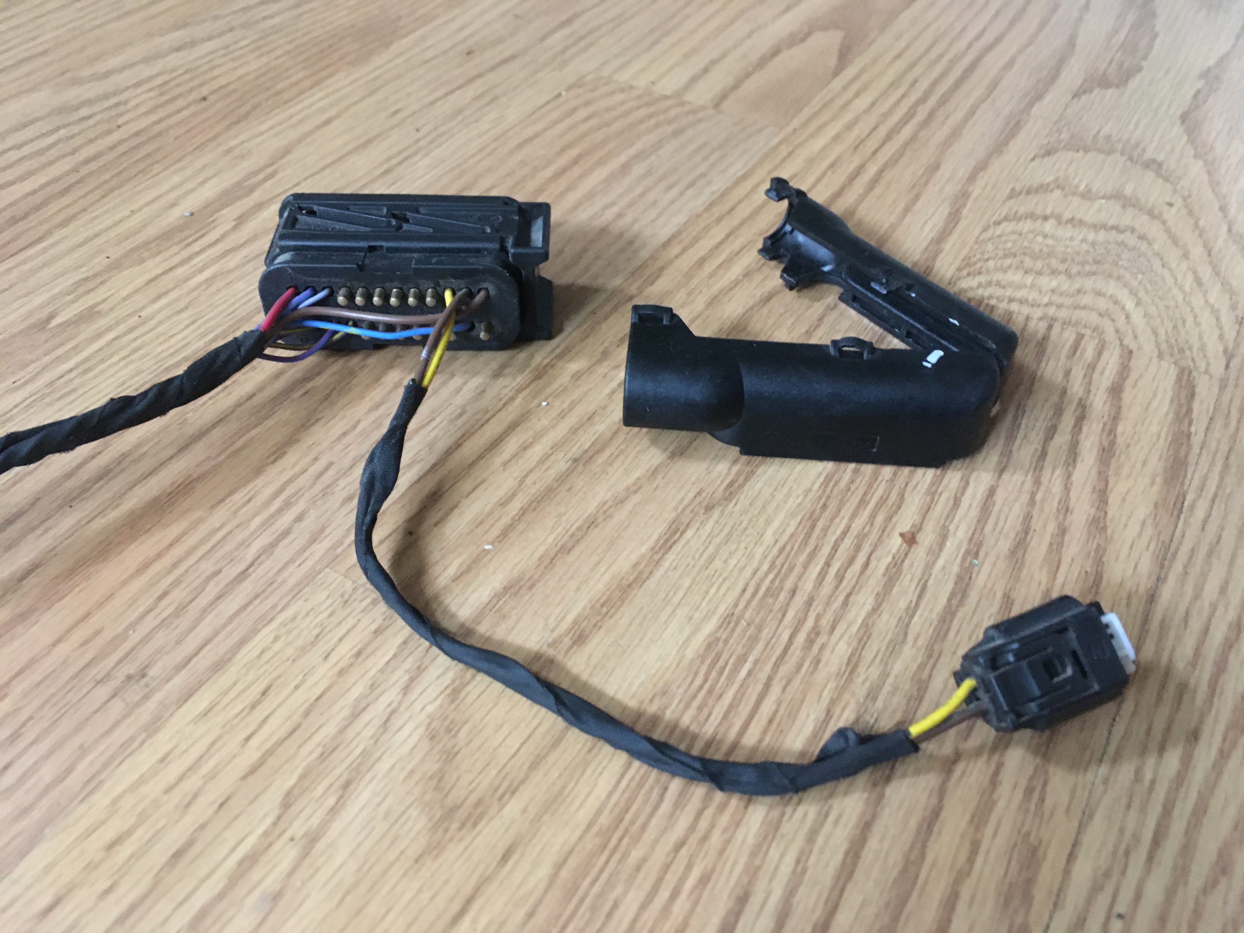

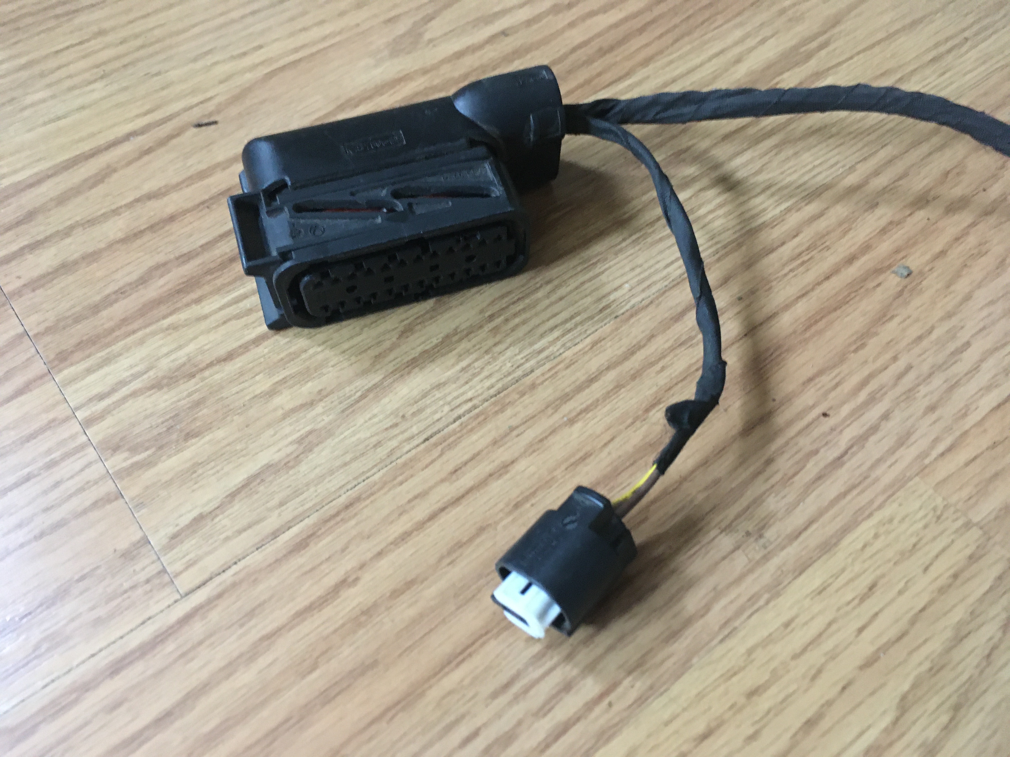

my 2018 530e battery pack came with the signal connector pig tail so I decided to unwrap it to see if it would hep any of those who are metal case cover removal averse
and considering it was covered with honey or molasses or both, which now I have successfully transferred to my hands and now to the keyboard, I really hope someone on here appreciates it

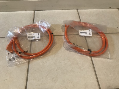

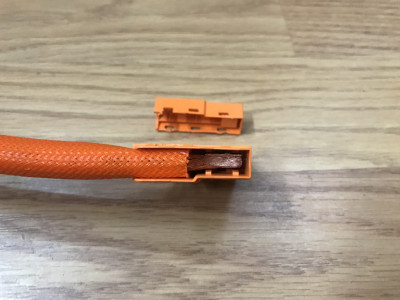

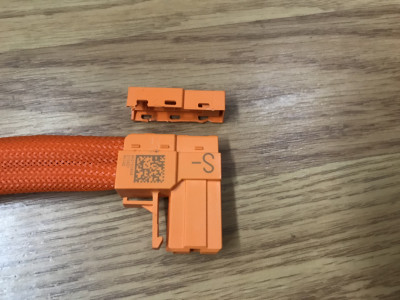

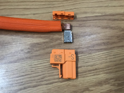

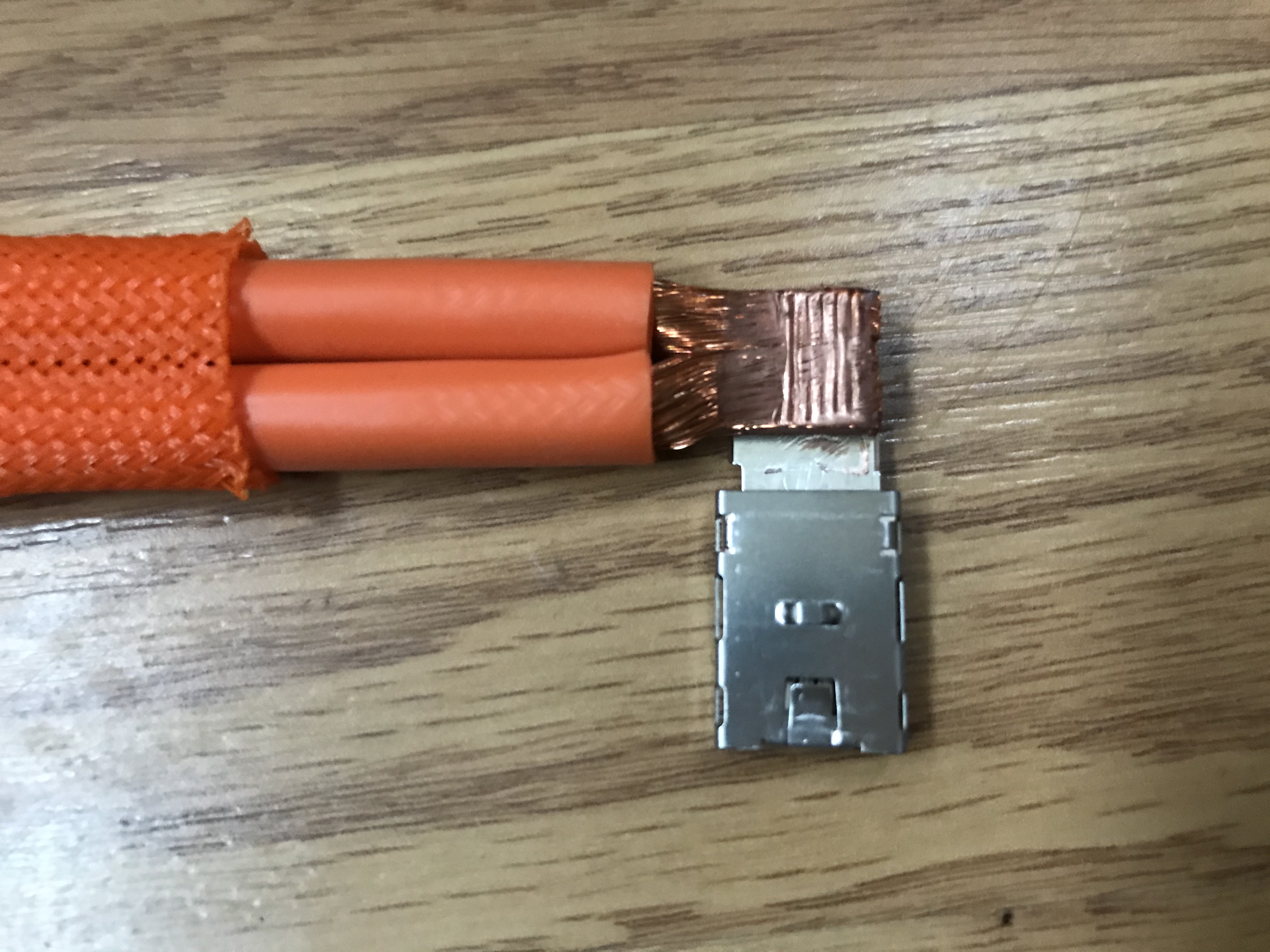

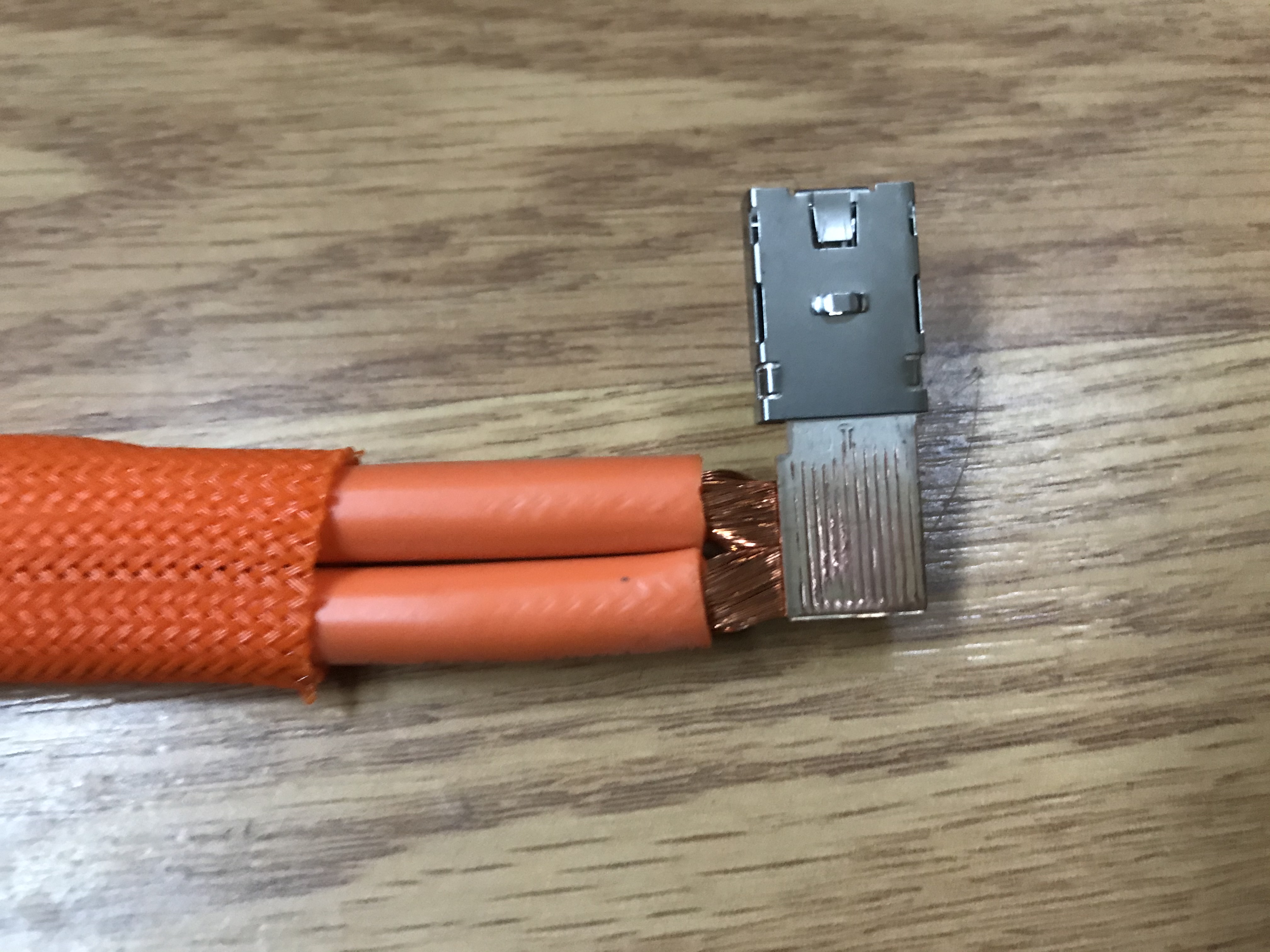

I thought someone may be interested in how the battery cables are built, so I went out and bought two of the #1 cell module main negative leads part # 61 27 8 621 016, this is the longest cable in the pack, I plan to modify the ends on these and use them as my to and fro to the pack
these are keyed, meaning they plug in a certain way
more excruciating detail can be found here: I bought a BMW 530e hybrid battery pack - Now What?

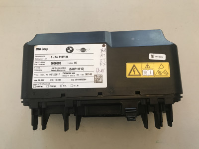

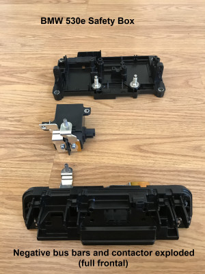

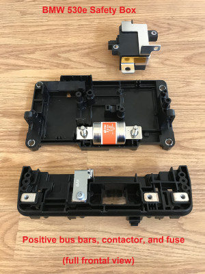

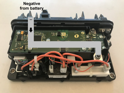

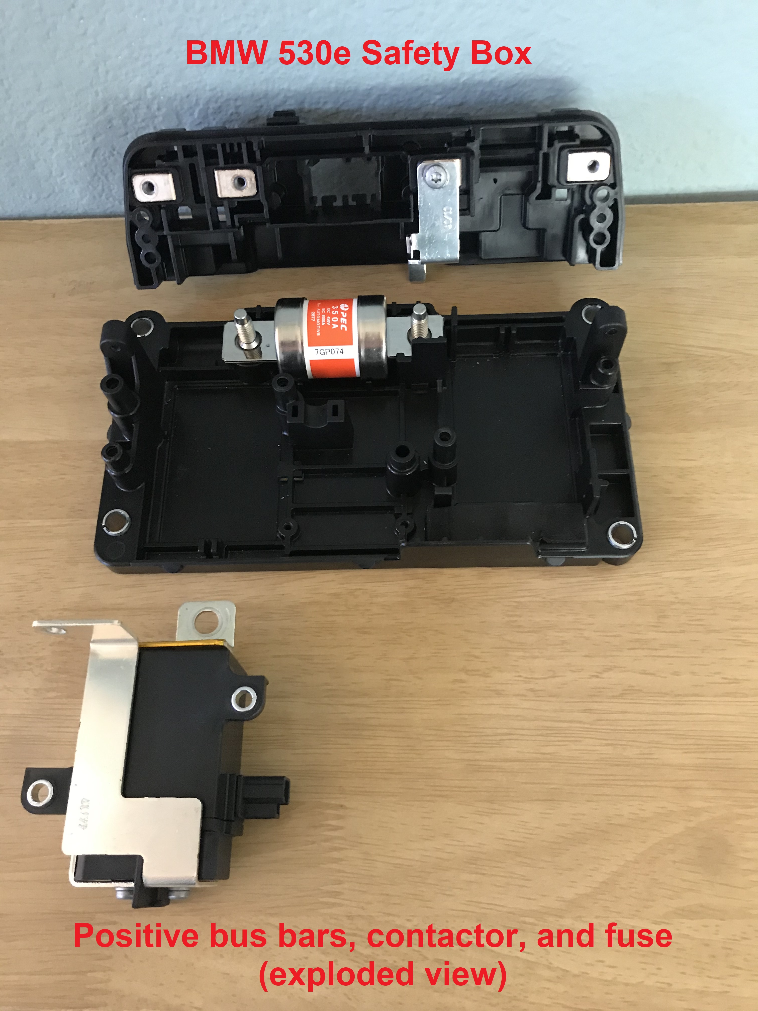

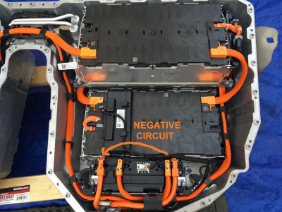

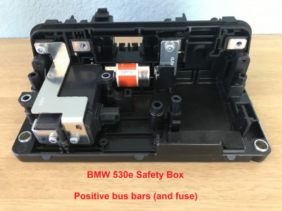

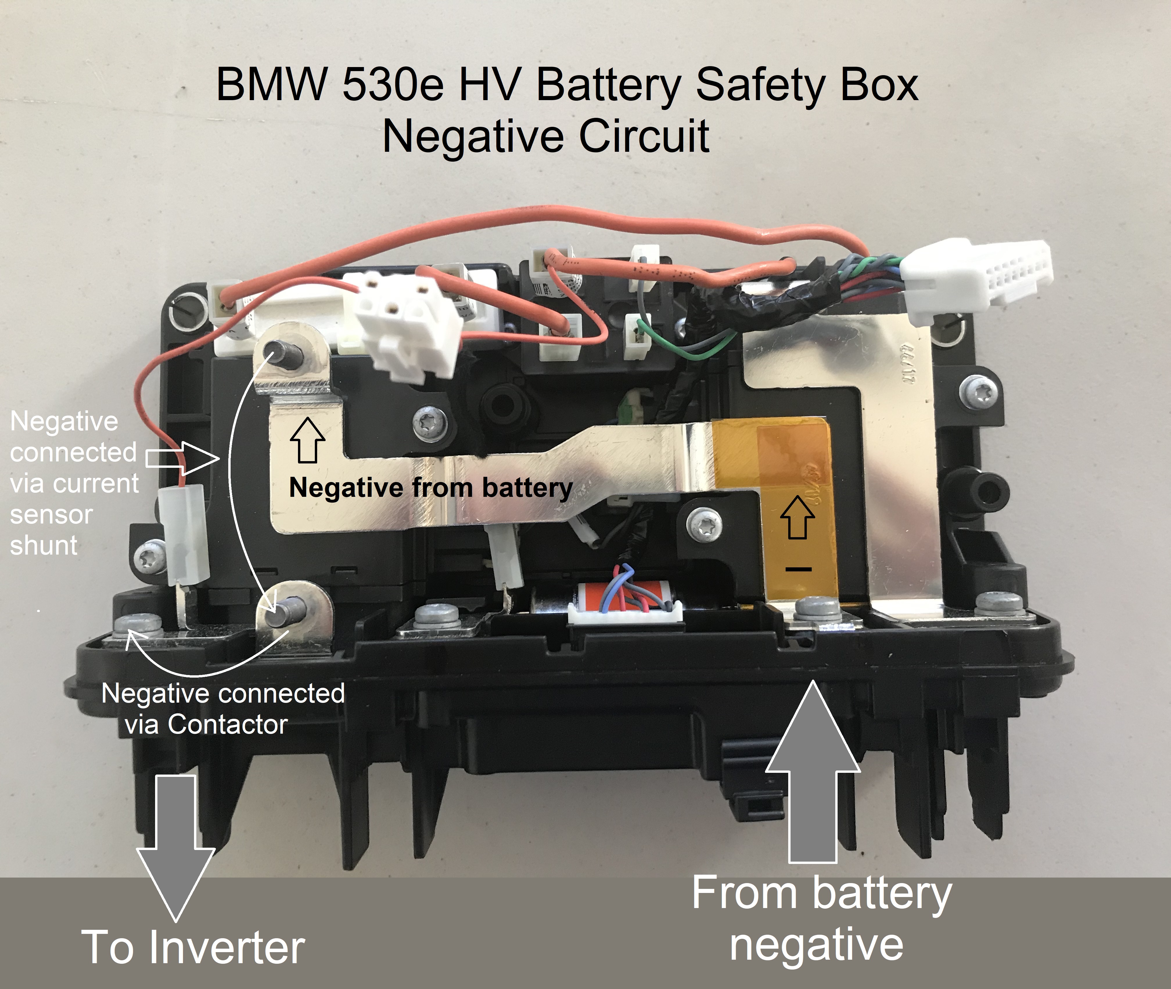

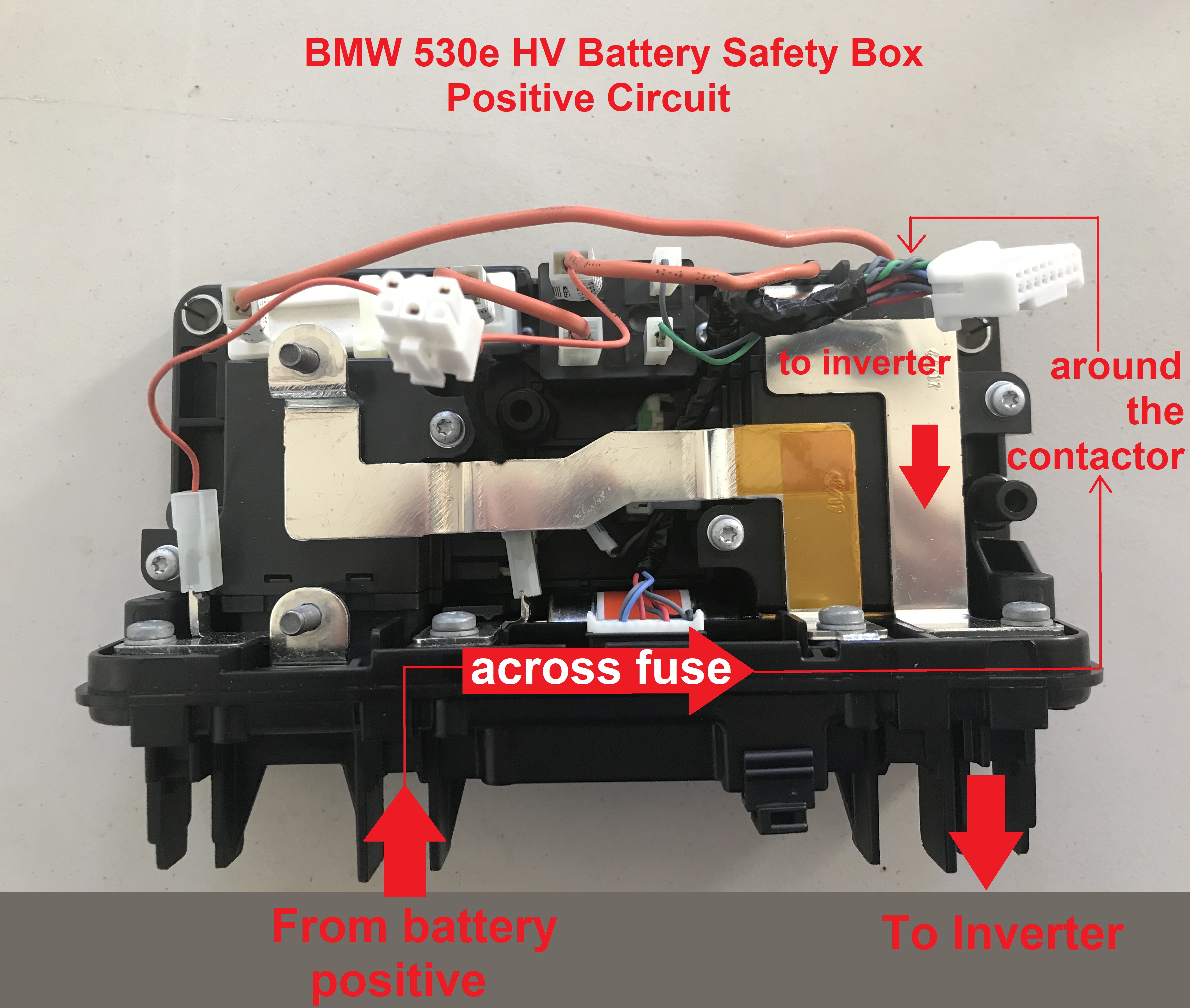

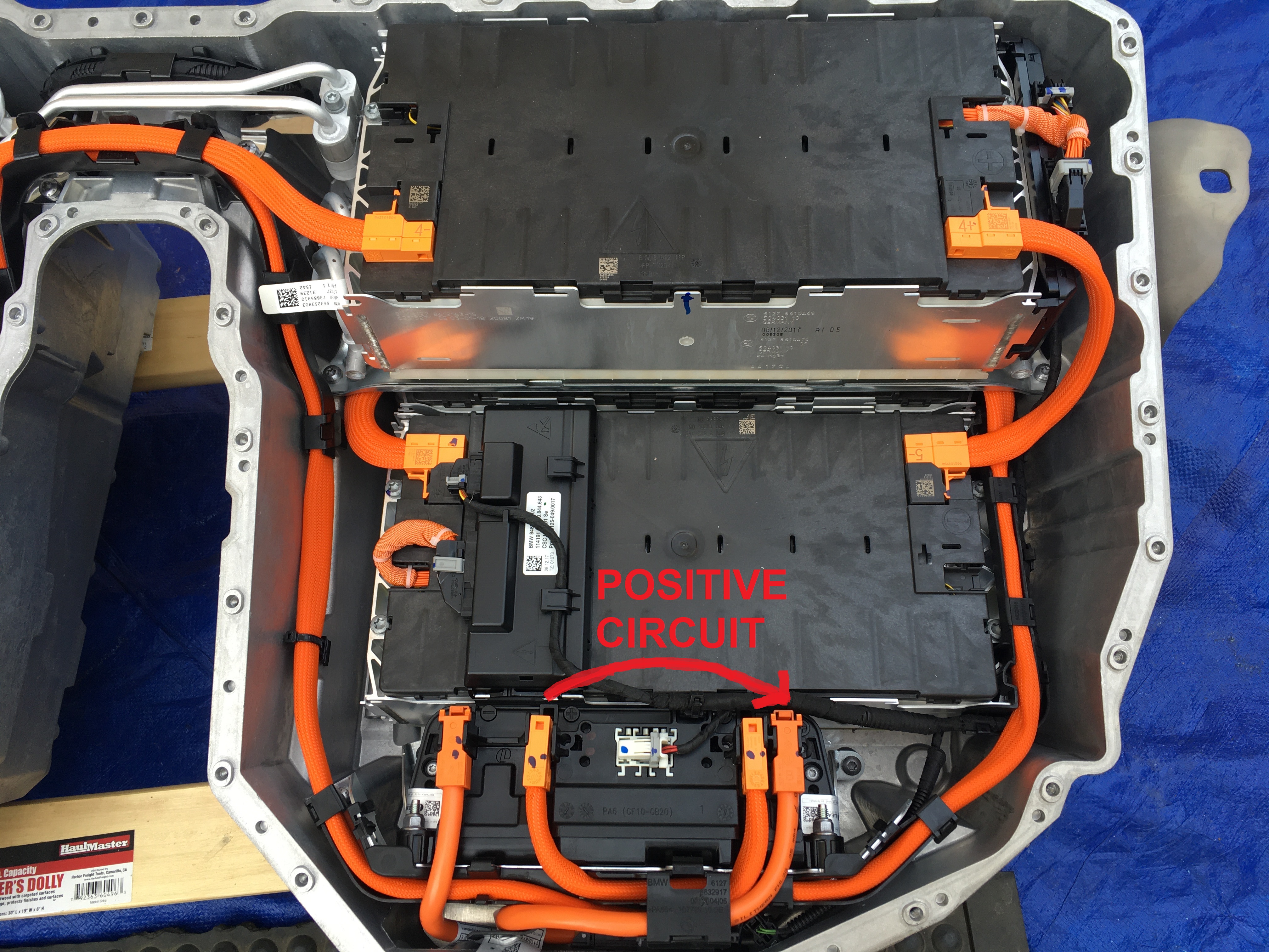

I finally fandangled with my 2018 530e HV Battery Pack Safety Box today and think some of you may find these pics useful, as I was perplexed by all the German zigging and zagging inside of this box
apologies I wish I had the forethought to use the same orientation as above

Thanks! Are you able to get the part numbers from the main fuse (orange cylinder) by any chance?
