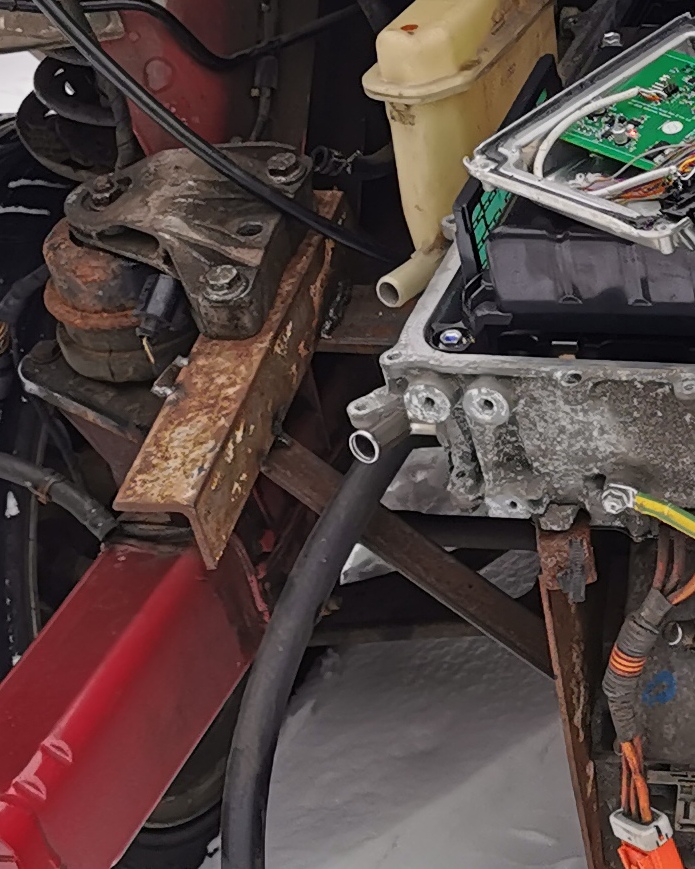

the lower mounting point could not hold. i did made something like you. it was destroyed soon... made a solid fix from old Lada rear trackarm (have some midsize warehouse with lots of old cars/parts/metal stuff)
Next car will be 1973 2103 with GS450h or Audi 100 quattro RWD :)

geduxaz wrote: Fri Feb 18, 2022 7:21 pm the lower mounting point could not hold. i did made something like you. it was destroyed soon... made a solid fix from old Lada rear trackarm (have some midsize warehouse with lots of old cars/parts/metal stuff)
Ok, at least I have a template for a proper one now :)
Yes transmission sits kindof high and also more forward than the original

Also I see that I moved all gearbox much closer to the stabiliser (to the rear) and made it lower.
I was thinking that it must be as low as possible, in the center for the weight distribution.

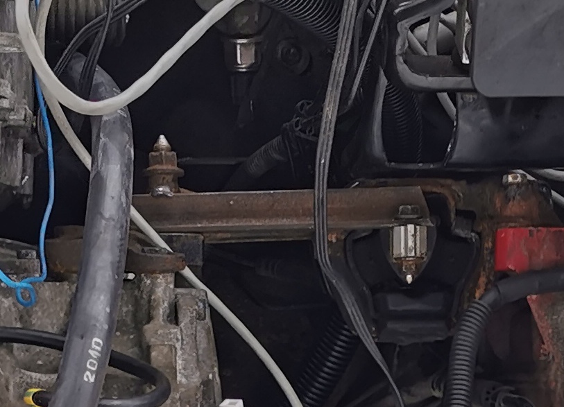

crasbe
Posts: 301
Location: Germany
Has thanked: 49 times
Been thanked: 151 times
Re: Audi A2 /w Prius Gen2 Transaxle & Inverter
Post by crasbe »
A little hint about Nylock nuts: The screw must protrude at least 2-3 threads out of the nylon part for the Nylock to work properly.
In your case it's about flush (hard to tell from the picture), which would be too short.

I was thinking of bolt on bumper support
Posts: 6771
Has thanked: 385 times
Been thanked: 1593 times
Ok, that looks much beefier than mine, but also compared to the stock A2 torque arm

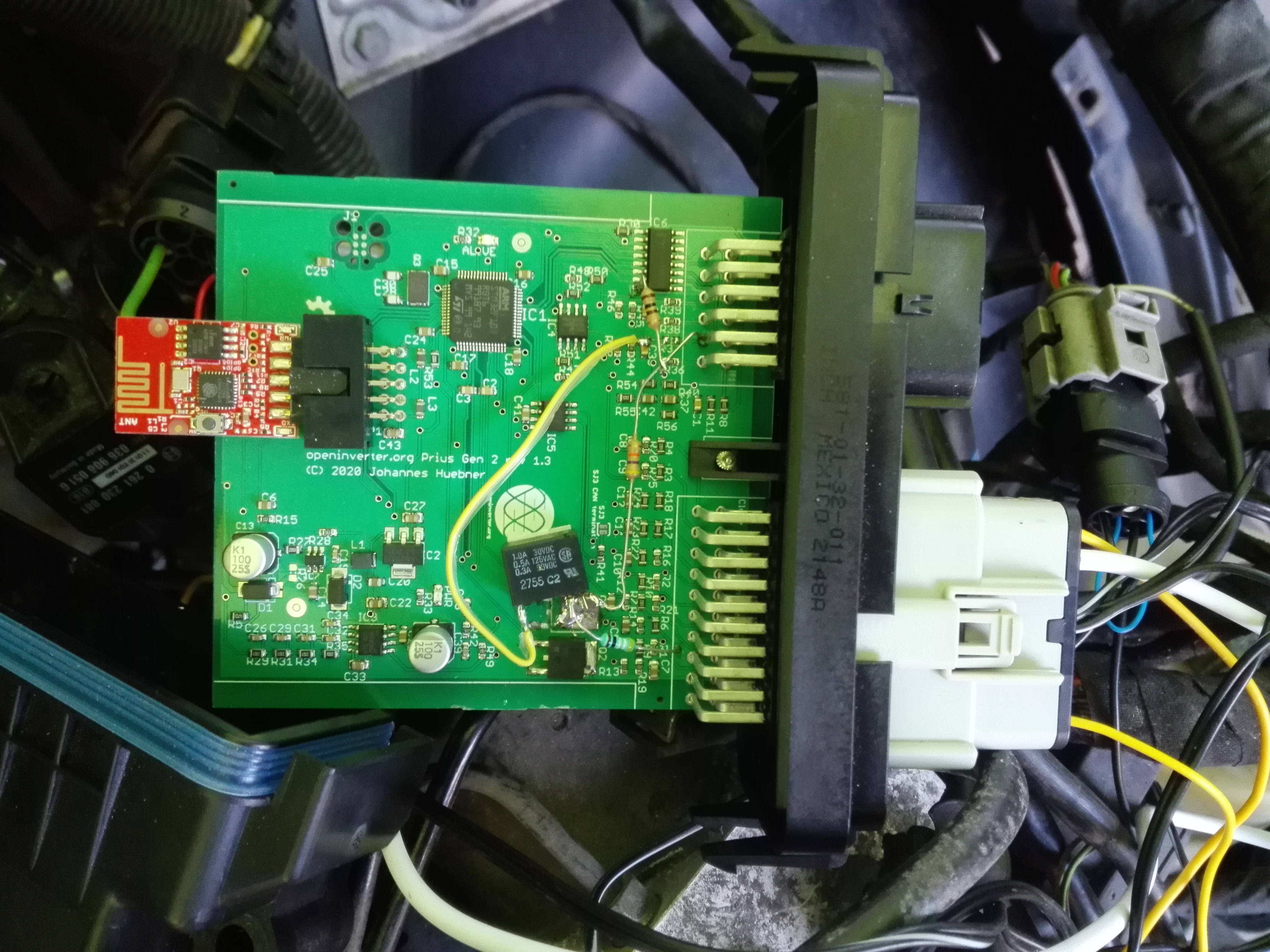

Summary:
- Putting a V3 mainboard into the ECU enclosure
- Reusing original wire harness without cutting off connectors
- Preparing the inverter

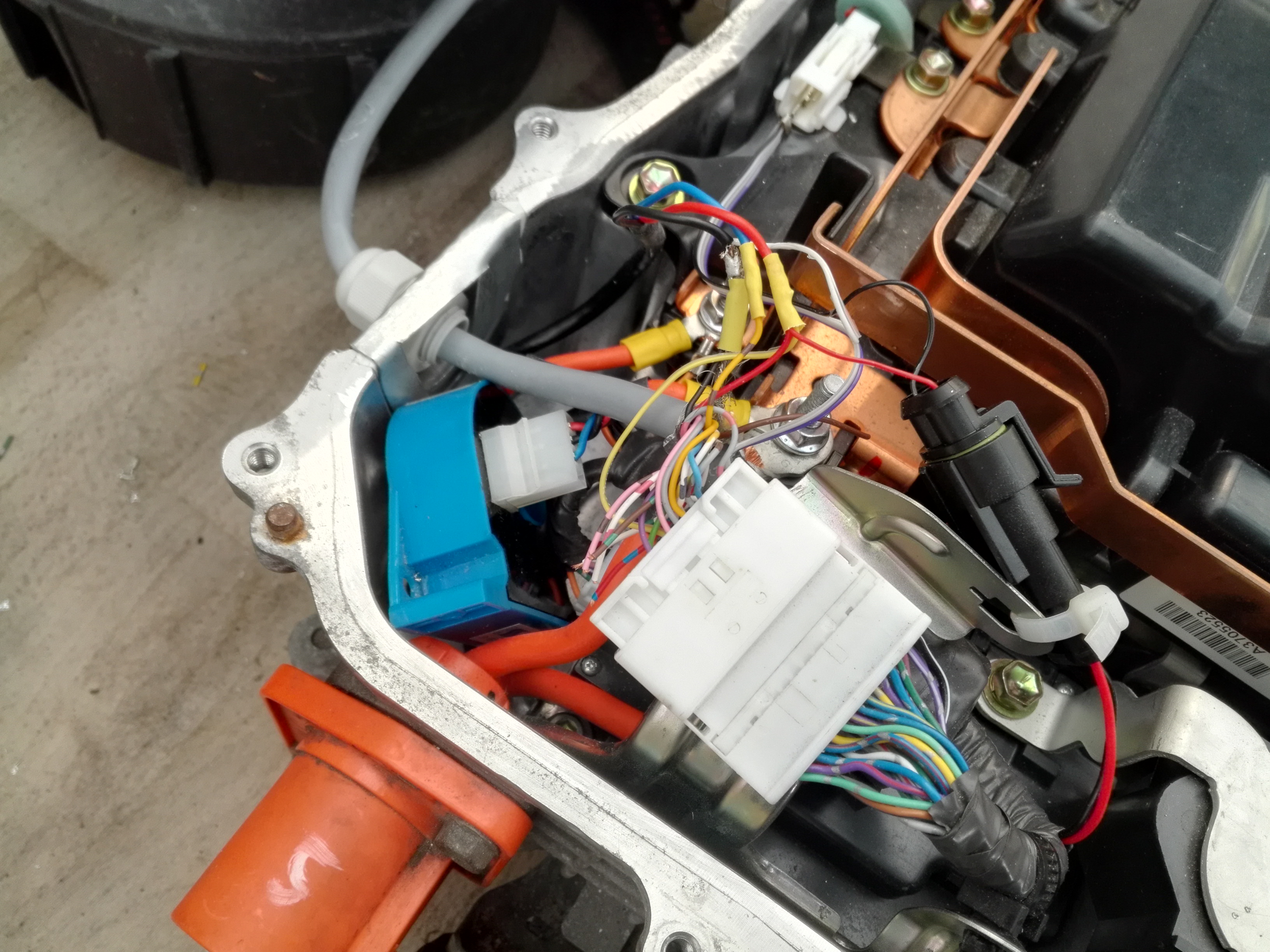

hugow93
Posts: 61
Joined: Mon Feb 24, 2020 9:33 pm
Has thanked: 26 times
Been thanked: 9 times
Post by hugow93 »
johu wrote: Mon Mar 07, 2022 6:06 pm
Summary:
Great video!
I was wondering about how the original HV connector on the inverter could be used.
Just checking, should the positive be rerouted to the contact point I've circled in the picture below?
I gave it a try this evening, but my precharge bulb lit brightly instead of flashing momentarily.
Converting a1994 Suzuki Samurai soft top
| Siemens 1PV5135 Motor | Gen 2 Toyota Prius Inverter + OI Control Board | 24 kwh Renault Zoe battery |
Posts: 6771
Yes, thats where I connected it. Not sure why that creates a short on yours
I tested charging via the A/C inverter today and already blew some of the IGBTs/diodes by some transient, even though I just used my 16A lab supply. I might just throw out the IGBTs and replace them with a bridge rectifier. At least the chill plate is reused then

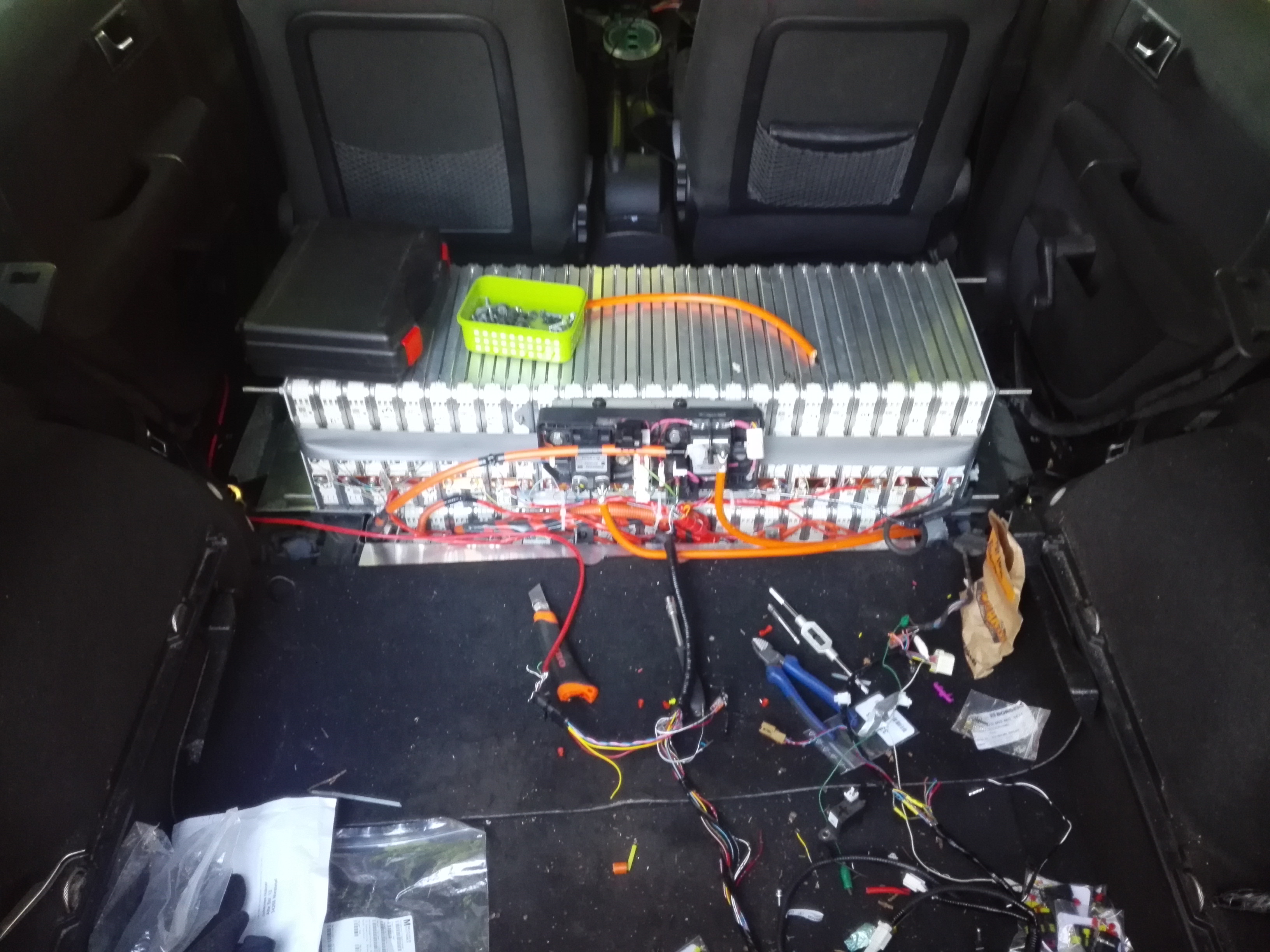

Today I reinforced the torque arm, will just test whether it holds up.
Yesterday I modified the inverter to accommodate an additional current sensor on the cable down to A/C inverter and DC/DC converter. Otherwise there would be no current sensor on the charging path. It is normally a +12V/-12V supply type but when it is just fed with +12V and GND it simply cannot measure negative, which is not required anyway. So instead of connecting the MG1 current sensors to the control board, I connected this. To keep it from interfering with normal operation, I only switch it in when actually in charge mode via a small relay. I have shorted the forward and reverse pin and also installed a Schottky diode to 12V. So now I can connect a single wire to 12V to
- Put inverter in charge mode (both forward and reverse high)
- Close the current sensor relay
- Supply all relevant circuitry for charging
Of course the additional current sensor has a different gain, I'm thinking about adding a "chargegain" parameter that switches to a different gain in charge mode.
