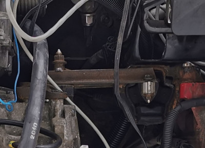

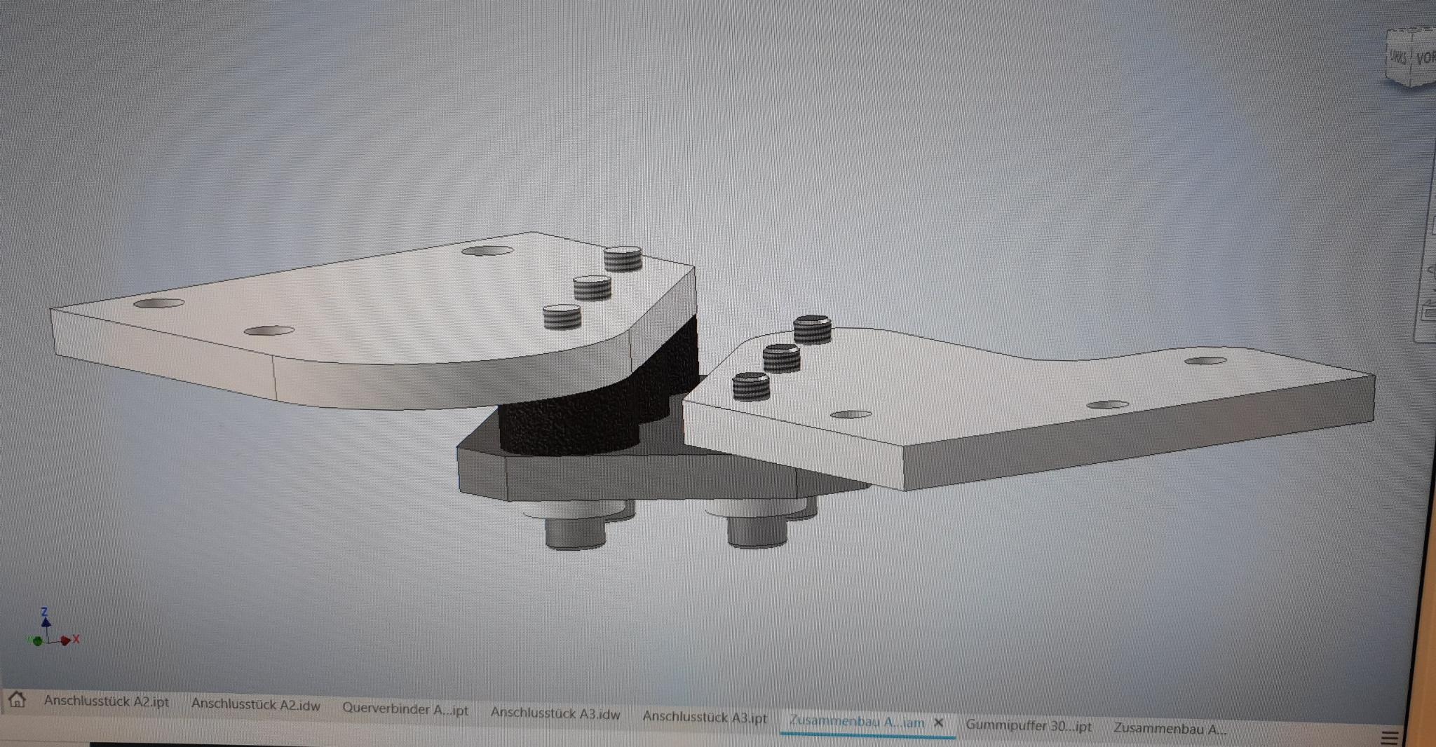

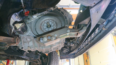

arber333 wrote: Thu Feb 10, 2022 9:19 am
geduxaz wrote: Thu Feb 10, 2022 8:57 am Why you do not use original audi mount? will you have a rubber bushing there? or EV motors are so vibration free that you can mount it directly to frame?
Argh! NO dont bolt your motor directly to frame!
No no, there will be rubber in between! I couldn't make do with the original Audi mount, it sits too low.
EDIT: screenshot added

Re: Audi A2 /w Prius Gen2 Transaxle & Inverter
Post by geduxaz »
I made it on original mountings :) wanted to make pictures but they are ugly. Its test version and later i plan to rebuild to more nice ones.

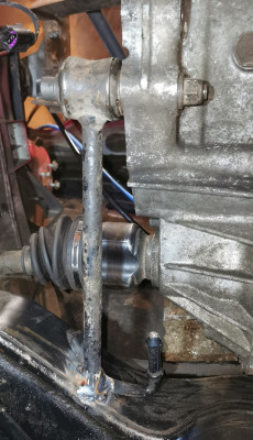

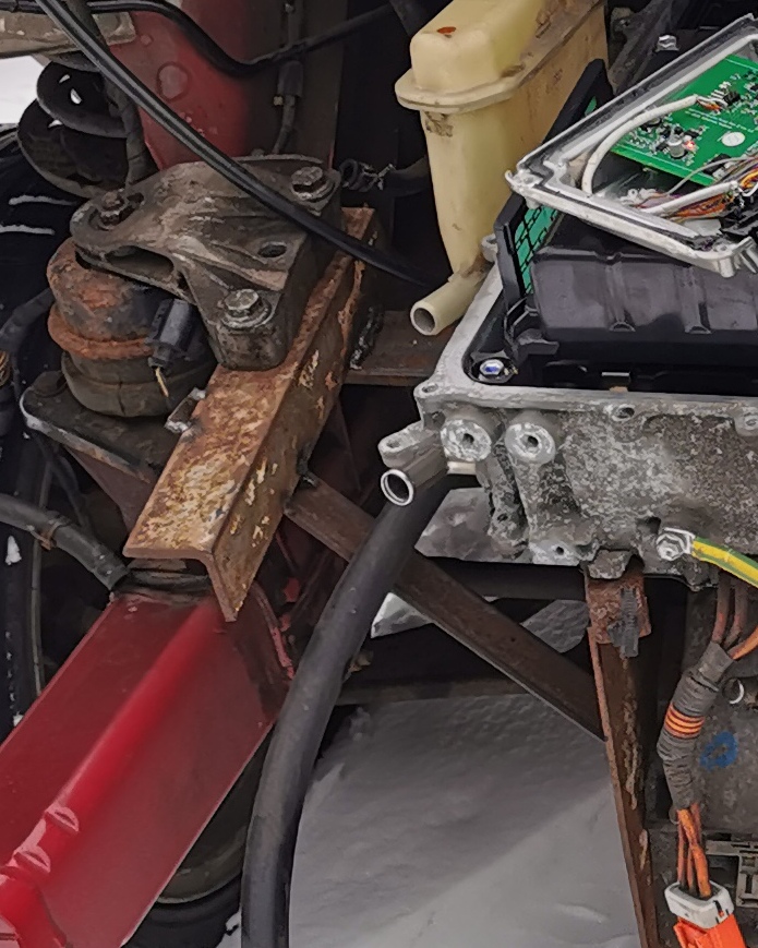

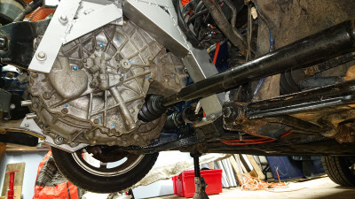

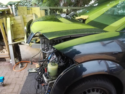

The inverter is bulkier than I thought.
@geduxaz: can you close the hood on yours?
On the plus side I fixed the torque arm

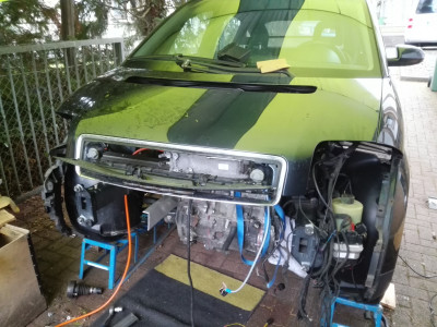

Nevermind. Removed that silly air duct, now it fits comfortably.
I think the duct was to prevent sucking engine room smells and heat into the interior. With these gone, no need for it
Post by geduxaz »
johu wrote: Fri Feb 18, 2022 11:43 am The inverter is bulkier than I thought.
1. Hood closes perfectly, but i still didnt install air duct. it was removed during engine removal. But from the uncalibrated eye it should still fit nicely.
2. From the pictures you have gearbox rotated more and MG1 wiring cover is higher than my.
Post by geduxaz »
the lower mounting point could not hold. i did made something like you. it was destroyed soon... made a solid fix from old Lada rear trackarm (have some midsize warehouse with lots of old cars/parts/metal stuff)
Next car will be 1973 2103 with GS450h or Audi 100 quattro RWD :)
Posts: 6761
Has thanked: 383 times
Been thanked: 1580 times
geduxaz wrote: Fri Feb 18, 2022 7:21 pm the lower mounting point could not hold. i did made something like you. it was destroyed soon... made a solid fix from old Lada rear trackarm (have some midsize warehouse with lots of old cars/parts/metal stuff)
Ok, at least I have a template for a proper one now :)
Yes transmission sits kindof high and also more forward than the original
Post by geduxaz »
Also I see that I moved all gearbox much closer to the stabiliser (to the rear) and made it lower.
I was thinking that it must be as low as possible, in the center for the weight distribution.

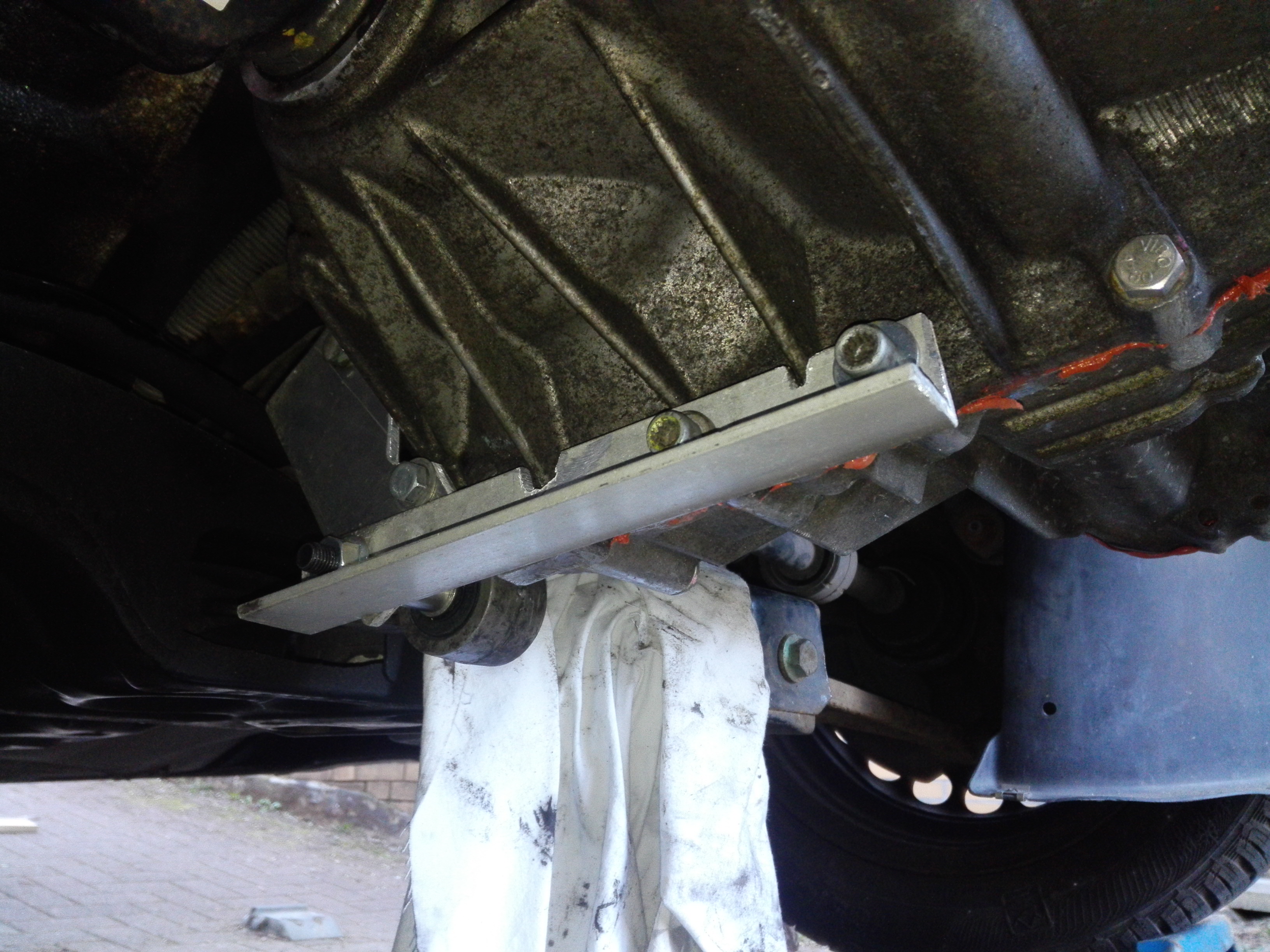

crasbe
Posts: 300
Location: Germany
Has thanked: 47 times
Been thanked: 150 times
Post by crasbe »
A little hint about Nylock nuts: The screw must protrude at least 2-3 threads out of the nylon part for the Nylock to work properly.
In your case it's about flush (hard to tell from the picture), which would be too short.
Post by RetroZero »
Transaxle support with front & rear mountings
On my golf, I decided against using the transmission bolt holes to fit a support for the torque arm. With heavy regen or torque from standstill, I am concerned about breaking those bolt and where they are fixed. Landing up with a damaged transaxle is not ideal. I used the engine to transaxle lugs and fitted the torque arm in front (on a reinforced front sub frame support)
I also made a transaxle mounting that went all the way around and bolted to the original top mounting support from where mountings could be fixed (front and rear). Don't know if it all makes sense sense, but golf setup is different as well so maybe not relavent.
Torque arm support
Torque arm support
Post by geduxaz »
RetroZero wrote: Sun Feb 20, 2022 11:13 am Don't know if it all makes sense sense, but golf setup is different as well so maybe not relavent.
A2 has soft front, no attachement points.
Post by RetroZero »
I was thinking of bolt on bumper support
Posts: 6761
Ok, that looks much beefier than mine, but also compared to the stock A2 torque arm

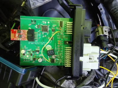

Summary:
- Putting a V3 mainboard into the ECU enclosure
- Reusing original wire harness without cutting off connectors
- Preparing the inverter

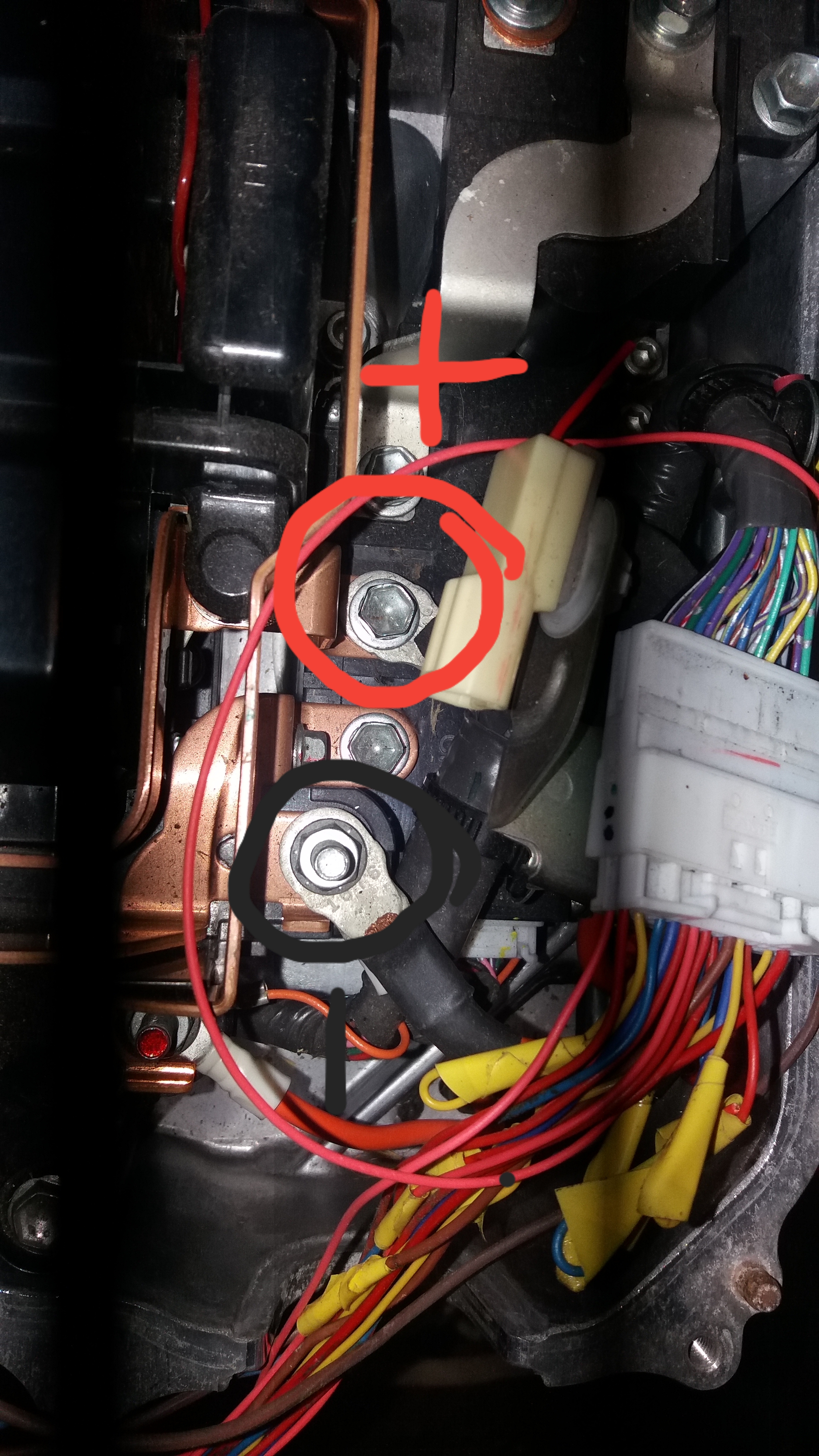

Post by hugow93 »

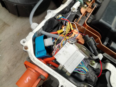

johu wrote: Mon Mar 07, 2022 6:06 pm
Summary:
Great video!
I was wondering about how the original HV connector on the inverter could be used.
Just checking, should the positive be rerouted to the contact point I've circled in the picture below?
I gave it a try this evening, but my precharge bulb lit brightly instead of flashing momentarily.

Posts: 6761
Yes, thats where I connected it. Not sure why that creates a short on yours
I tested charging via the A/C inverter today and already blew some of the IGBTs/diodes by some transient, even though I just used my 16A lab supply. I might just throw out the IGBTs and replace them with a bridge rectifier. At least the chill plate is reused then
