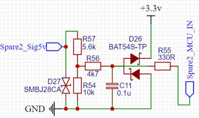

That is great work aot93, thanks for sharing everything. I'm doing something similar for my Panda and did quite a bit of research on automotive protection for controllers after having similar bad experiences blowing up micros. I'm with arber, you need quite a bit of protection in the circuit to prevent smoke for car applications. There is so much noise there and we often make mistakes when wiring!
If it is any help, this is what I ended up with for a 5V analog input where you can't easily use cheap opto isolation: SMBJ is a chunky TVS diode that protects from ESD and big nasties
R57 and 54 are just voltage divider to 3.3v (you can change this for a 14.5V input also)
R56 is input current protection and part of a filter with C11 to smooth the inputs
D26 is Schottky diode that clamps the input to the processor's supply rails
R55 is the final current limiting protection to mean if anything gets through that, the processors own protection has a chance
The goal is, whatever you throw at the input, the mcu never goes out of its safe input range.

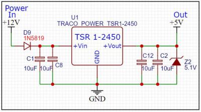

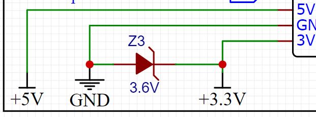

This rejects that energy to the supply rails, so you need to protect those also with a zener to not exceed the max voltage limits on those rails: I always stick a Schottky diode on the power input just in case also.
Same on the 3.3v rail: Finally, I think the CAN transceivers also need protection, so double TVS on there is the minimum that is advised: Its all a bit of a faf but probably worth the effort. If opto isolation shares the same ground (which I guess it will do in the car wiring) I don't know if that is fully effective? Much better than nothing I'm sure.
Just thought I'd share that. You can get similar bits in through hole and smd.

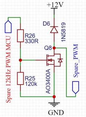

I've found this cheap and effective mosfet output works really well also. If you are using PWM, you need a Schottky diode across the load if it is a coil. A normal diode will get very hot, I found out! Its great seeing all the different ways people are developing their own stuff and getting things on the road. Really inspirational. Its amazing what people in this forum are achieving. I'll post my Panda progress one day. I switched on the HV for the first time yesterday and got the bms, battery, contactors and DC-DC working. Charger next. First steps towards getting the motor turning on the bench before the power saw comes out!

Thanks for the suggestions, all very good and interesting.
I know some people like to use op-amp drivers for analogue inputs, which is also a good approach.
Of course board space and component availability come in to this as well.
The capacitors are tantalum, not sure where the EL reference is coming from, agree you EL's are not ideal for this job.
