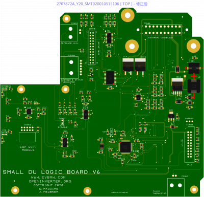

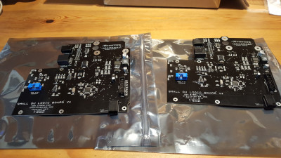

Some good news on board supply. I have now acquired a much more reliable pcb manufacturer here in Ireland and boards will be in stock for immediate dispatch. No more silly delays and boards are being built on an automated smd line so quality is much improved.

No more Boards for the Tesla S Units? Ok, thats hard. Luckely i had ordered it soon enough.
@all: Anyone realize an ESP with the Tesla Units (lower the Output Power when ESP gets active)? My Smart Roadster has an ESP Module with "Trust+" that could communicate with CAN.
And how i could realize a Slip Control? Over 200kW in the Back of a 750kg Car is a good Neckbraker

Hi everyone!
Due to I am new to the opencontroller project I want to ask you some general questions. My plans are to use a tesla SDU with 4..6 tesla battery modules.
1) On using the replacement EVBMW logic board - does the SDU runs with DC nominal voltage 96V, 120 or 144V ?
2) On using the bare board (due to the full board is out of stock) - is there a component list available ?
thanks a lot!

Since announcing that I was stopping supply of built boards for Tesla I have had a storm of emails and contacts from people begging me to reconsider. Now, the problem of small volume board building is not something that many people encounter. I won't go into the painful details but trust me it's not easy. I spent a ton of time and legwork trying to make it work and just couldn't. Over the Christmas period I was looking again at ways to get boards built particularly for my Toyota projects. I think I hit on a super way to do this and good news is it will work for Tesla boards also.The video here gives a full explanation and I expect to be using JLCPCB for all my builds if things go to plan. So, more boards, faster and cheaper:)
