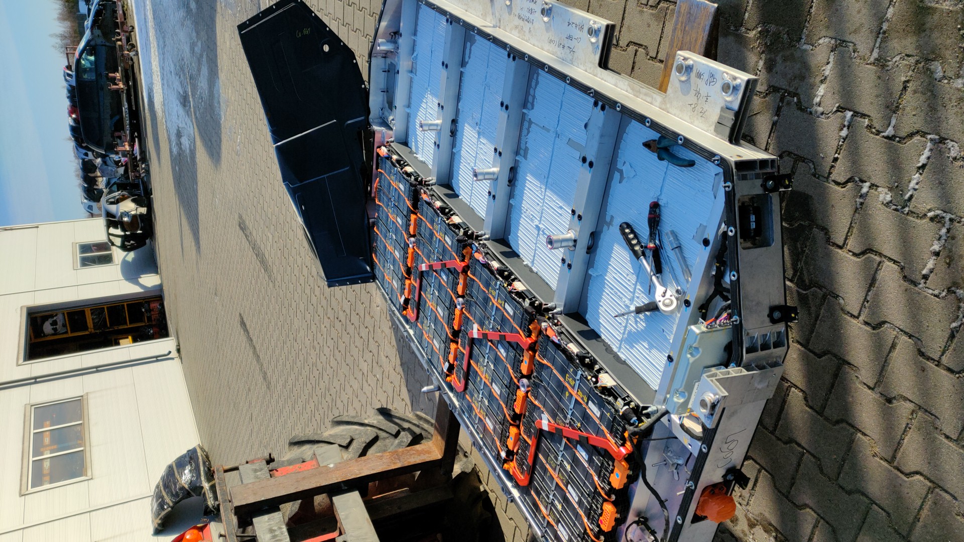

I have 77,4kWh battery from kia ev6/ioniq 5. I'll check bms later and let you know.

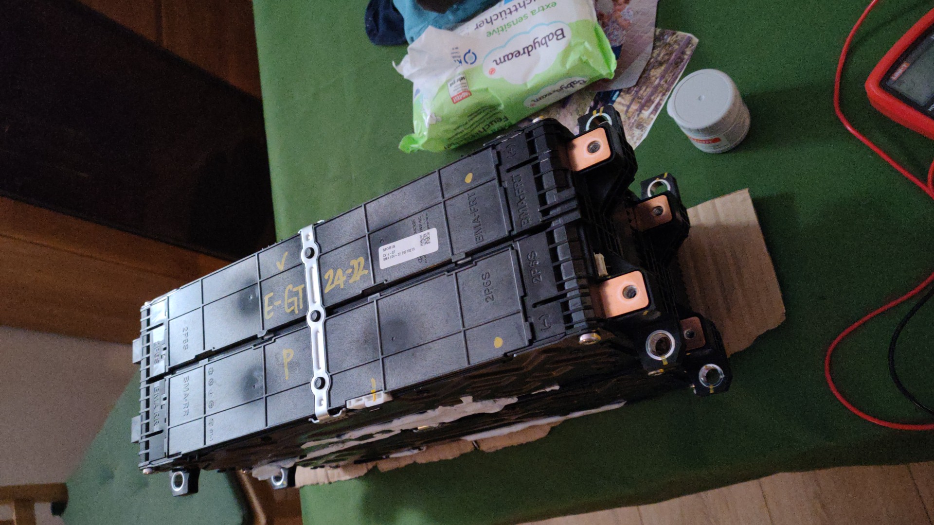

- With connecting wing
Width: 428mm, Depth: 158mm, Height: 109mm
- Connection wing not included
Width: 380mm, Depth: 136.5mm, Height: 109mm
Weight: 10.85kg
jon volk
Posts: 574
Location: Connecticut
Re: 800V Hyundai Ioniq 5 Battery
Post by jon volk »
I wonder what the output capability of these are. If I could get to 400v with 16 modules, that would get me to 38kwh and at 10.85 kg each, that would amount to a pretty good weight savings over my 32kwh 2x Volt packs. By the above dimensions, it seems I could get all 16 under the hood up front.

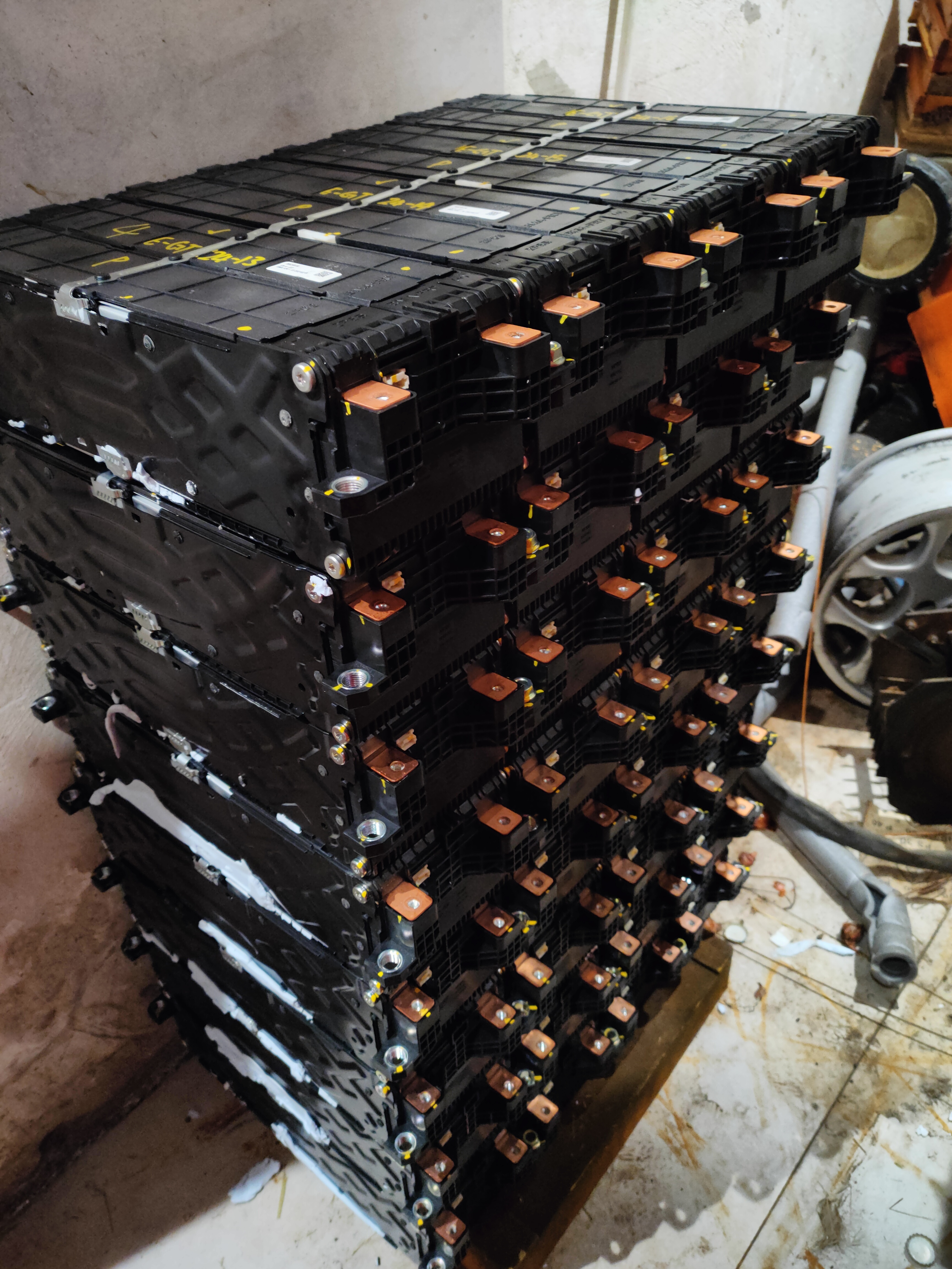

I'm also pondering about buying 16x EV6 modules and having 400V pack. Any ideas how many amps those can push out?
Bad thermal stability .. so cooling is a must, I guess? I'm currently happily running Model S modules without cooling and they don't get hot at all.

I have 32 modules to make 96s,my setup is w124 benz with lexus gs450h,i pull 500amps peak with no issue,i have an orion bms2,ive made sure to have 8 temperature sensor monitoring the battery and it hardly raises any temparature

I have no battery cooling as it was imposible in my setup,so i have 16modules fronT and 16 at the rear,However im in Nairobi Kenya,we are at the equator(best weather in the world (18-32 Degrees max) all year round
