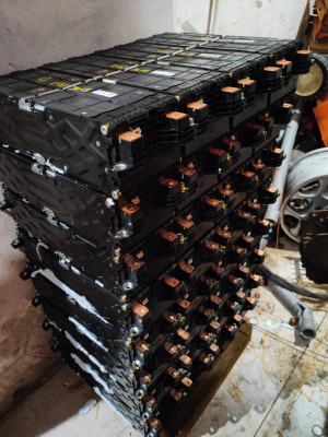

Interesting read and a quite good video:
https://insideevs-com.cdn.ampproject.or ... pened/amp/
Does anybody have further details on the BMS on this battery?
Are there slave units in the modules and if so, what ASICs might there be?

I have 77,4kWh battery from kia ev6/ioniq 5. I'll check bms later and let you know.

I haven't seen it yet, but I'm guessing:
- 6S2P bonded cells
- Cell connections at both ends
- One piece of BMU with part number 375A0-xxxx with MAX17841 based isoSPI bus
- 8 CMUs with part number 375A1-xxxx, each with 2-2 MAX17845 chips
- One MAX17845 chip handles 2 modules (12 cells), one CMU can handle 4 modules, so 8 CMUs can handle 32 modules.
What did I win?

- With connecting wing
Width: 428mm, Depth: 158mm, Height: 109mm
- Connection wing not included
Width: 380mm, Depth: 136.5mm, Height: 109mm
Weight: 10.85kg

I wonder what the output capability of these are. If I could get to 400v with 16 modules, that would get me to 38kwh and at 10.85 kg each, that would amount to a pretty good weight savings over my 32kwh 2x Volt packs. By the above dimensions, it seems I could get all 16 under the hood up front.

I'm also pondering about buying 16x EV6 modules and having 400V pack. Any ideas how many amps those can push out?
Bad thermal stability .. so cooling is a must, I guess? I'm currently happily running Model S modules without cooling and they don't get hot at all.

I have the same batteries 77kwh from ioniq 5..arranged the in half /96 series and pull about 500amps peak with no issues or temparure rise

I have 32 modules to make 96s,my setup is w124 benz with lexus gs450h,i pull 500amps peak with no issue,i have an orion bms2,ive made sure to have 8 temperature sensor monitoring the battery and it hardly raises any temparature

I have no battery cooling as it was imposible in my setup,so i have 16modules fronT and 16 at the rear,However im in Nairobi Kenya,we are at the equator(best weather in the world (18-32 Degrees max) all year round

Hi Joe, I have this battery also and want to install it with a leaf em57 motor and a Zombieverter.
But for the battery I will need to have only a 400V system. It is yet to be determined if I will have room for all 32 modules or just use 16.
What work did you need to do to get the Orian BMS2 to support the battery in your configuration of 96s? Do you see an issue if I create a 400V pack?
Also have you (or anyone else) seen any info on getting the use of the Ioniq 5 BMS and the slave BMS's into thje Zombieverter for battery support?
