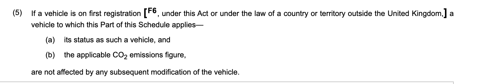

For those who don't want to delve into the wording of the actual regulations in question. Here is a précis of the regs. as they affect us:-
All cars first regd. up to 2001 shall be taxed at rate X, and those after 2001 shall be taxed at rate Y.
EXCEPT electric cars first regd. before 2017 which are EXEMPT.
DVLA are interpreting that as meaning cars first regd. between 2001 and 2017 and converted to electric should be taxed at rate Y.
I hope that clarifies what DVLA are doing.

Re: Registering and changing tax class of an EV conversion in the UK
Although I agree with every word I guess the issue here would be the tyre tax. Every car in the country would be driving on the canvas before they would be replaced and you can guarantee there would be a black market in dodgy dangerous tyres.eUKenGB wrote: ↑Thu Mar 17, 2022 10:02 am I've been campaigning for many years to instead put car tax on fuel. Well, in my head anyway. It was just the perfect and FAIR way to collect tax proportional to usage of the roads etc. But with the change away from the ICE, it's no longer worth thinking about. The alternative that I read somewhere (may have mentioned it before) is to instead put the tax on tyres. Think about it. Not as stupid as it sounds. In fact, not stupid at all.
My interest in this whole Tax Classification of converted cars issue is not just at a personal financial level. I realise that for many it would not and probably should not affect their decision to perform a conversion, but for me it's bigger than that.
Yes I have plans for several conversion projects that fall into this category (2001-2017) and the financial savings would be worthwhile, BUT of more importance is that future road tax charging should be fair. As I said, for many years I've been an advocate of mileage based charging. Not only does that suit me as I don't commute so annual mileage is relatively low and with multiple vehicles it has always irked me that tax is charged on all vehicles even when only one can be used at a time (the rest securely parked off the road, on my own property). So one is forced to play swap the insurance/tax game and only be able to use a small selection at any one time.
Although my current vehicles are individually not in the 'high tax' bracket, I did for a while have a Mercedes SL500 which with its large V8 was approx £600 pa. just for road tax. All for a mere approx. 1K miles in a year. Whereas anyone with a low emissions ICE vehicle could drive e.g. 100K mile in a year at zero cost. Not only would they create far more pollution in that time, but they would make use of and cause wear and tear of the roads at a rate 100x my use of the SL. For which I had to pay £600 and they, nothing, £ZERO.
Then in 2017 another nonsense scheme was introduced which means that a post 2017 SL, after 5 years would only pay £150 pa. Meanwhile, the pre 2017 SL (basically the same car) would be stuck with the original £600. This is simply utter madness. A scheme thought up by complete idiots and that doesn't even address what they claim they're trying to address.
Fortunately, with the advent of EVs, they HAVE to come up with a scheme based on mileage, which is THE ONLY fair way to tax road usage. However we are now faced with this current nonsense that DVLA refuse (although ultimately not their call) to re-classify converted cars 2001-2017. So they will be stuck with the old VED scheme that has already angered me to the point of changing cars to avoid the nonsense. So I will NOT convert a car to then be illegally forced to pay the old ICE VED rate. It's a matter of principle. The financial savings mount up for each such converted car, but the main issue is that DVLA are WRONG. Logically, legally and morally and this is unacceptable. If the powers that be decide DVLA's flawed interpretation is correct (it is NOT and I will never accept that it is), then the law needs to change. It is utter nonsense to commit the UK to such massive changes to its entire infrastructure in order to deal with the switch to EV, outlawing ICE from 2030, all in the name of 'saving the planet', while refusing to allow a car converted from ICE to EV to be taxed as an EV.
That's the final point. This is not about obtaining 'free car tax'. It is about a car converted to EV being then taxed as an EV (at whatever rate that may be), because that is the right and just way to apply VED/road tax. Anything else is wrong and unacceptable.

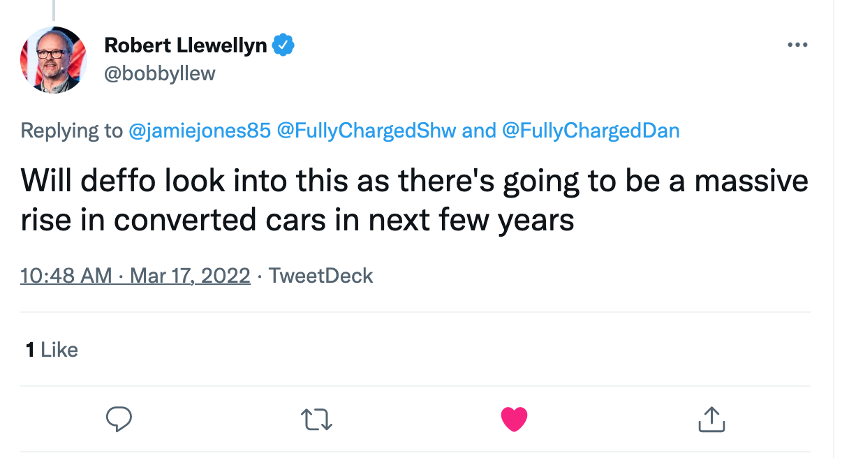

Got Fully Charged interestedBMW E91 2006
I spoke to Robert about a year ago and although sounding interested at the time, when I actually sent him the details, got no reply until I repeatedly chased it and then a reply from someone else that they were too busy to do anything about it, but we had their moral support.Bigpie wrote: ↑Thu Mar 17, 2022 10:51 am Screenshot 2022-03-17 at 10.49.50 am.png
Can people send their info to production@fullycharged.show regarding this issue.
Not the outcome I was hoping for.

Would be interesting to see if DVLA allowed a reduction or zero rated the VED if someone fitted a modern low CO2 emission engine to a gas guzzler ? That might prove a case possibly ?
Could it be DVLA are basing their decisions on the first registration of the vehicle after manufacture ?
No but I believe it works the other way round. If you fit a V8 to a small car they will very quickly raise the tax rate for the car.Peter wrote: ↑Sat Mar 19, 2022 9:12 pm Would be interesting to see if DVLA allowed a reduction or zero rated the VED if someone fitted a modern low CO2 emission engine to a gas guzzler ? That might prove a case possibly ?

That's a definite no. The legislation very clearly states that if a car has a CO2 emissions figure recorded at first registration, this figure is NOT affected by subsequent modifications. You can install a V12 or the world's most efficient engine, and the tax will not change. This is in fact the very thing that the DVLA believe prevents an EV conversion from being zero rated for tax.Peter wrote: ↑Sat Mar 19, 2022 9:12 pm Would be interesting to see if DVLA allowed a reduction or zero rated the VED if someone fitted a modern low CO2 emission engine to a gas guzzler ? That might prove a case possibly ?
The relevant legislation (which refers to cars with a CO2 emissions figure):
If a vehicle is on first registration, under this Act or under the law of a country or territory outside the United Kingdom, a vehicle to which this Part of this Schedule applies—
(a)its status as such a vehicle, and
(b)the applicable CO2 emissions figure,
are not affected by any subsequent modification of the vehicle.

As catphish says. That is THE argument they're using to deny us the re-classification when converted to EV.
Since an ICE powered car is NOT an 'exempt vehicle', it IS then covered by Schedule 1 and hence cannot have its original emissions figure changed. A restriction I completely understand as that would open the door to anyone claiming their car now produced fewer emissions and they should pay less VED. That would be IMPOSSIBLE for them to implement. However, it was clearly never meant to prevent a car being converted to electric propulsion, hence becoming an 'exempt vehicle' and thereby NOT subject to Schedule 1 at all and that whole "cannot change emissions" statement is rendered irrelevant.
However they are still wrong, due to the exemption. Fundamental logic dictates that a positive and a negative results in a negative. DVLA are distorting/misunderstanding that to mean such a combination results in a positive and that is NEVER true.

Here is a link for the actual - Vehicle Excise and Registration Act 1994catphish wrote: ↑Sun Mar 20, 2022 3:39 amThat's a definite no. The legislation very clearly states that if a car has a CO2 emissions figure recorded at first registration, this figure is NOT affected by subsequent modifications. You can install a V12 or the world's most efficient engine, and the tax will not change. This is in fact the very thing that the DVLA believe prevents an EV conversion from being zero rated for tax.Peter wrote: ↑Sat Mar 19, 2022 9:12 pm Would be interesting to see if DVLA allowed a reduction or zero rated the VED if someone fitted a modern low CO2 emission engine to a gas guzzler ? That might prove a case possibly ?
https://www.legislation.gov.uk/ukpga/1994/22/contents
I can't see anywhere which says:
Can you post an exact quote & location of the section the DVLA are using to suggest VED can't change?"If a vehicle is on first registration, under this Act or under the law of a country or territory outside the United Kingdom, a vehicle to which this Part of this Schedule applies—
are not affected by any subsequent modification of the vehicle. "

The quote is exact. It's from Schedule 1, Part 1A (5).SuperV8 wrote: ↑Mon Mar 21, 2022 10:26 am Here is a link for the actual - Vehicle Excise and Registration Act 1994

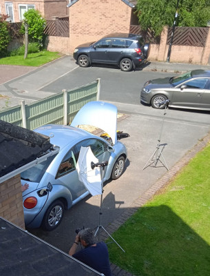

The Telegraph are covering the issue over the Jubilee weekend. I've had them round taking photos etc.
