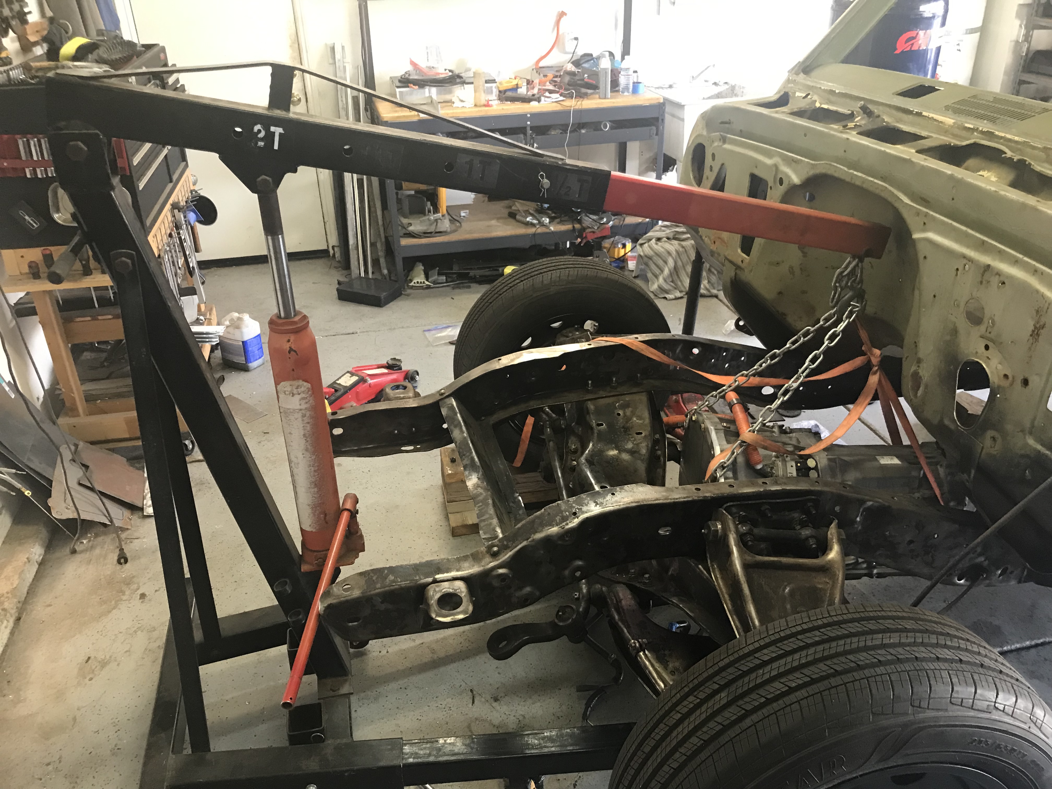

Post by Gregski »

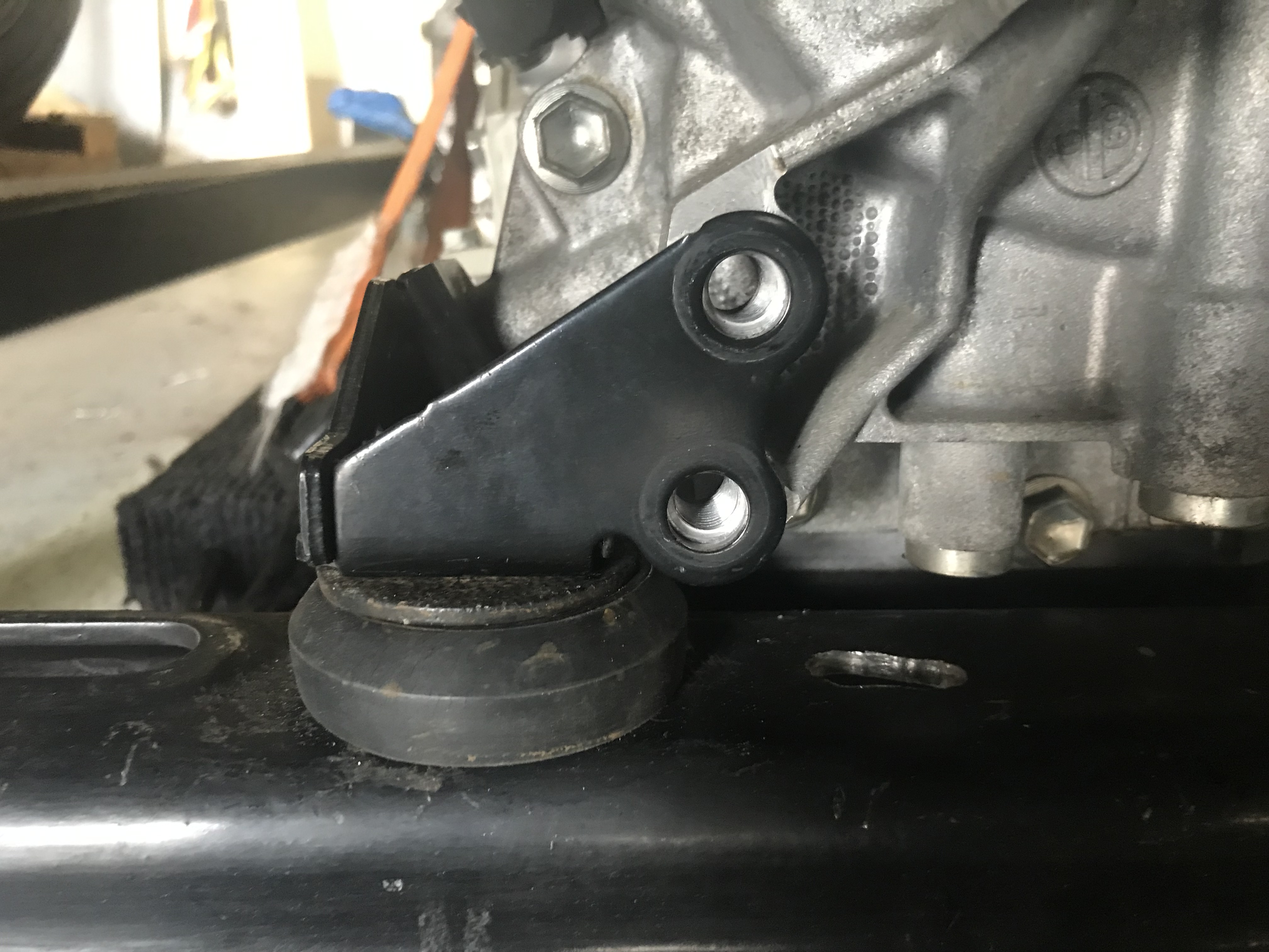

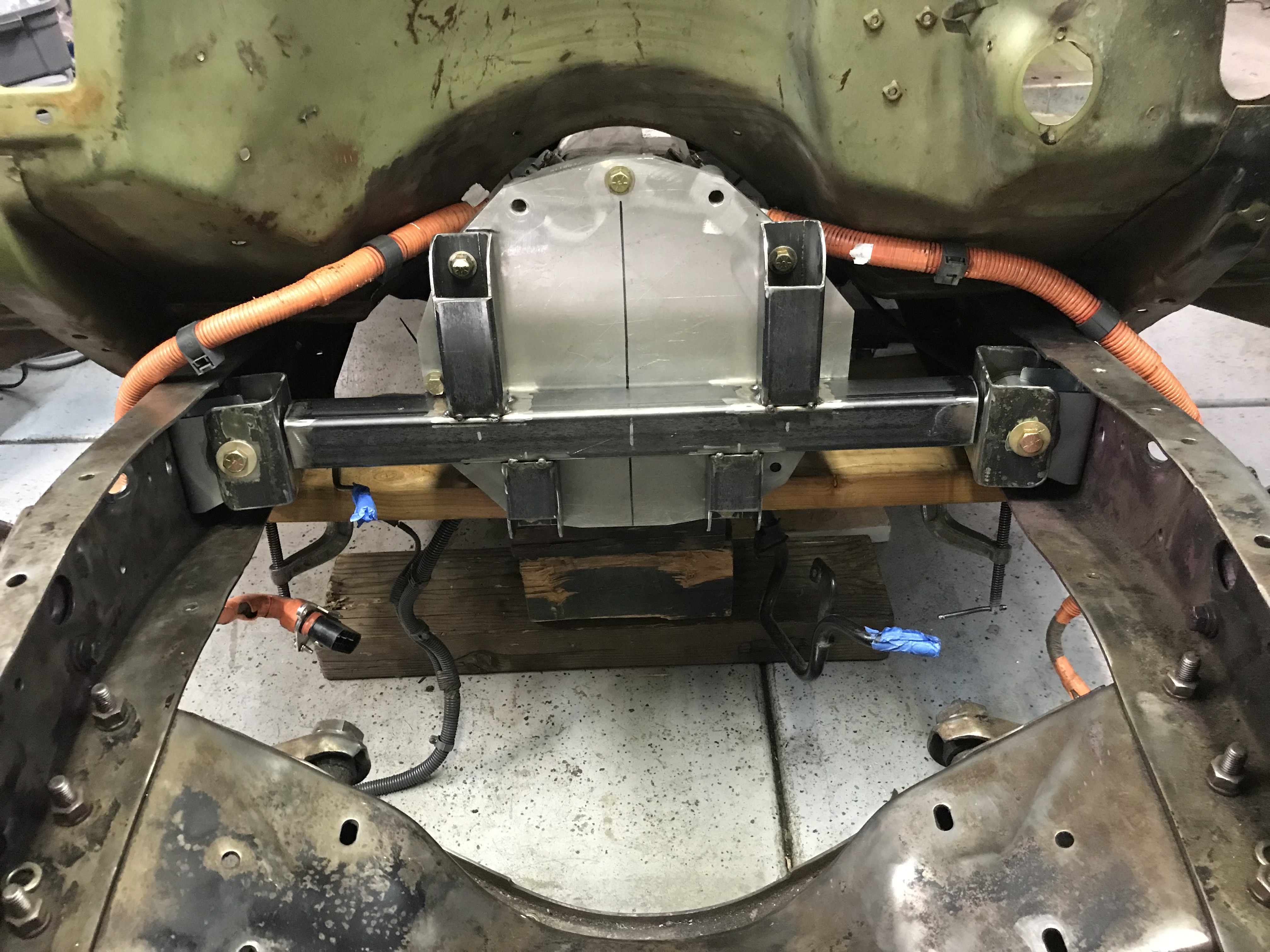

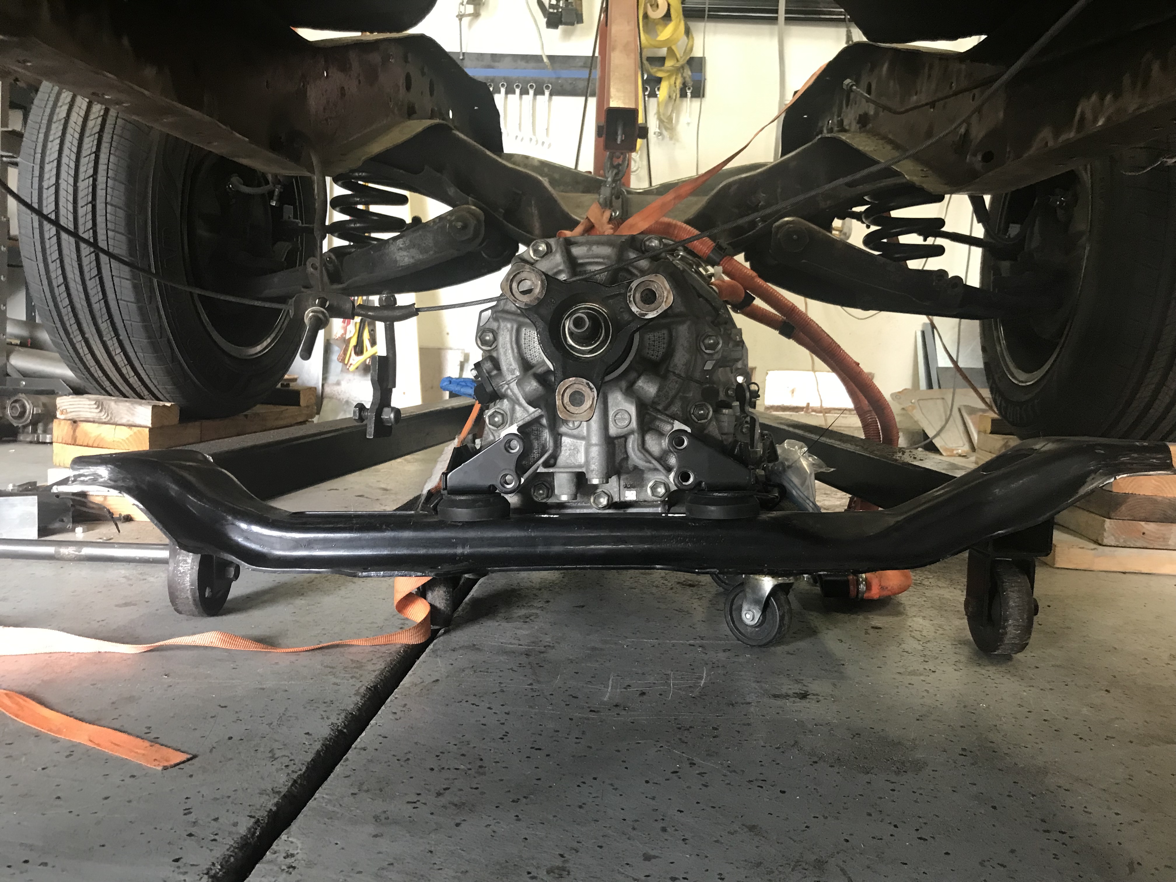

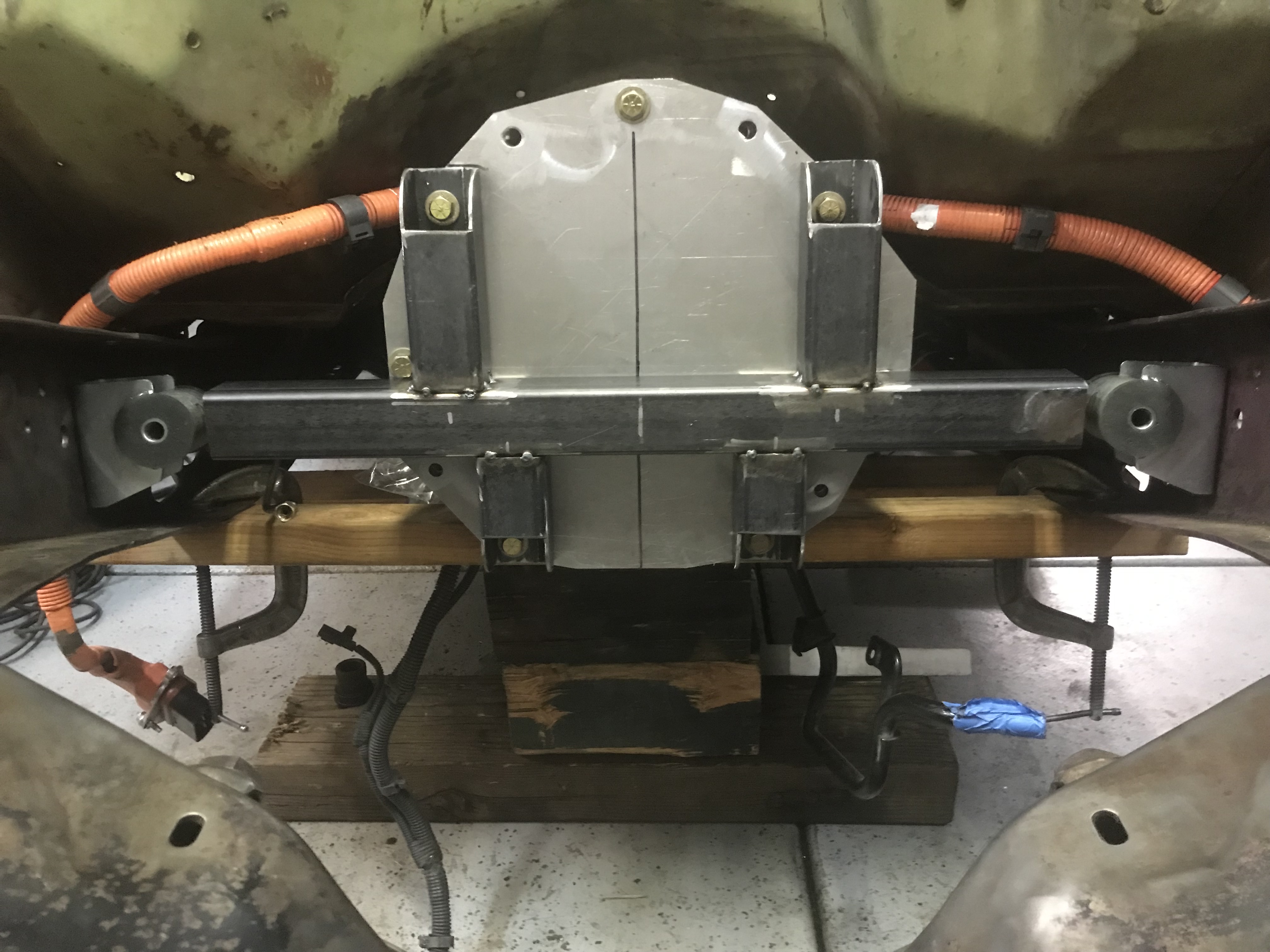

having eliminated the original crossmember that held the Turbo TH350 transomatic in place in the first place, I moved on to one with some drop, using rubber feets from my stock radiator core support (run what you brong!)

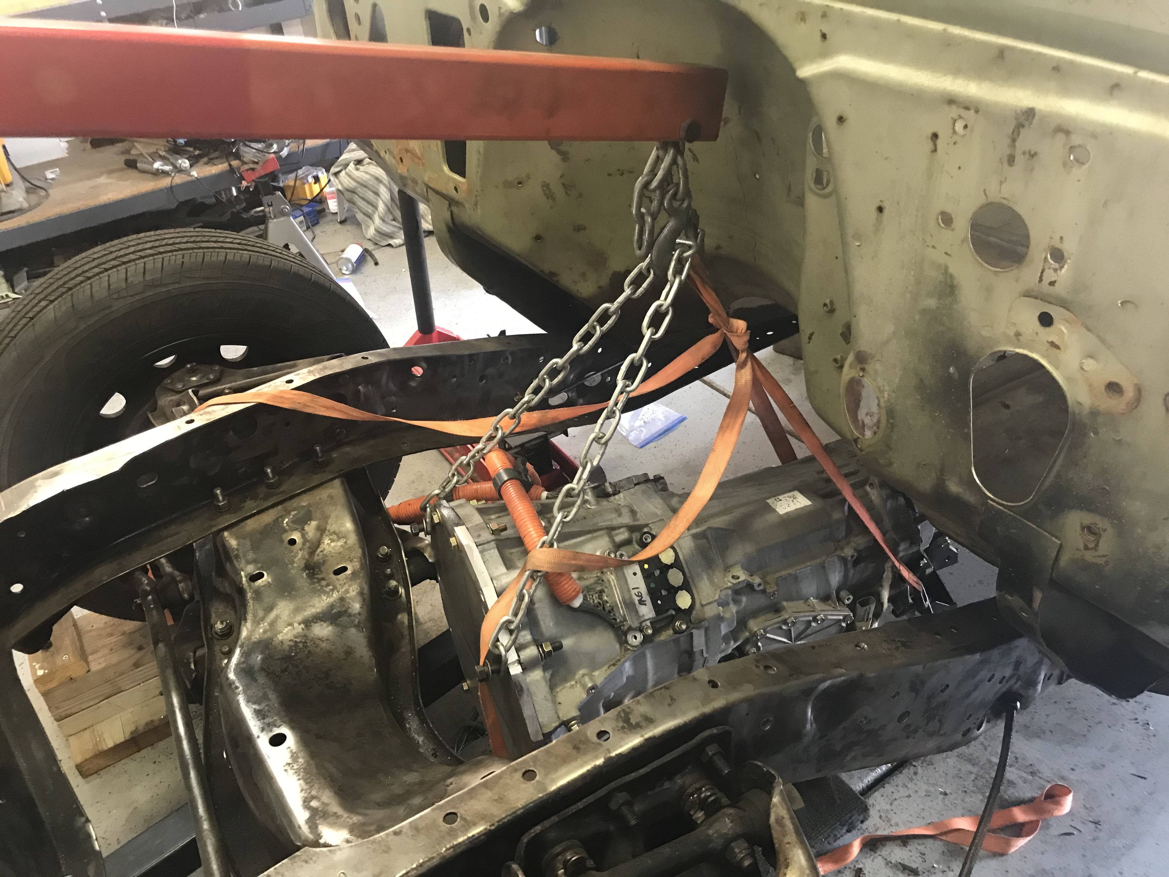

Post by Gregski »
mounting the transmission is by far the biggest job on this project
Gregski
Posts: 3160
Has thanked: 631 times
Been thanked: 1607 times

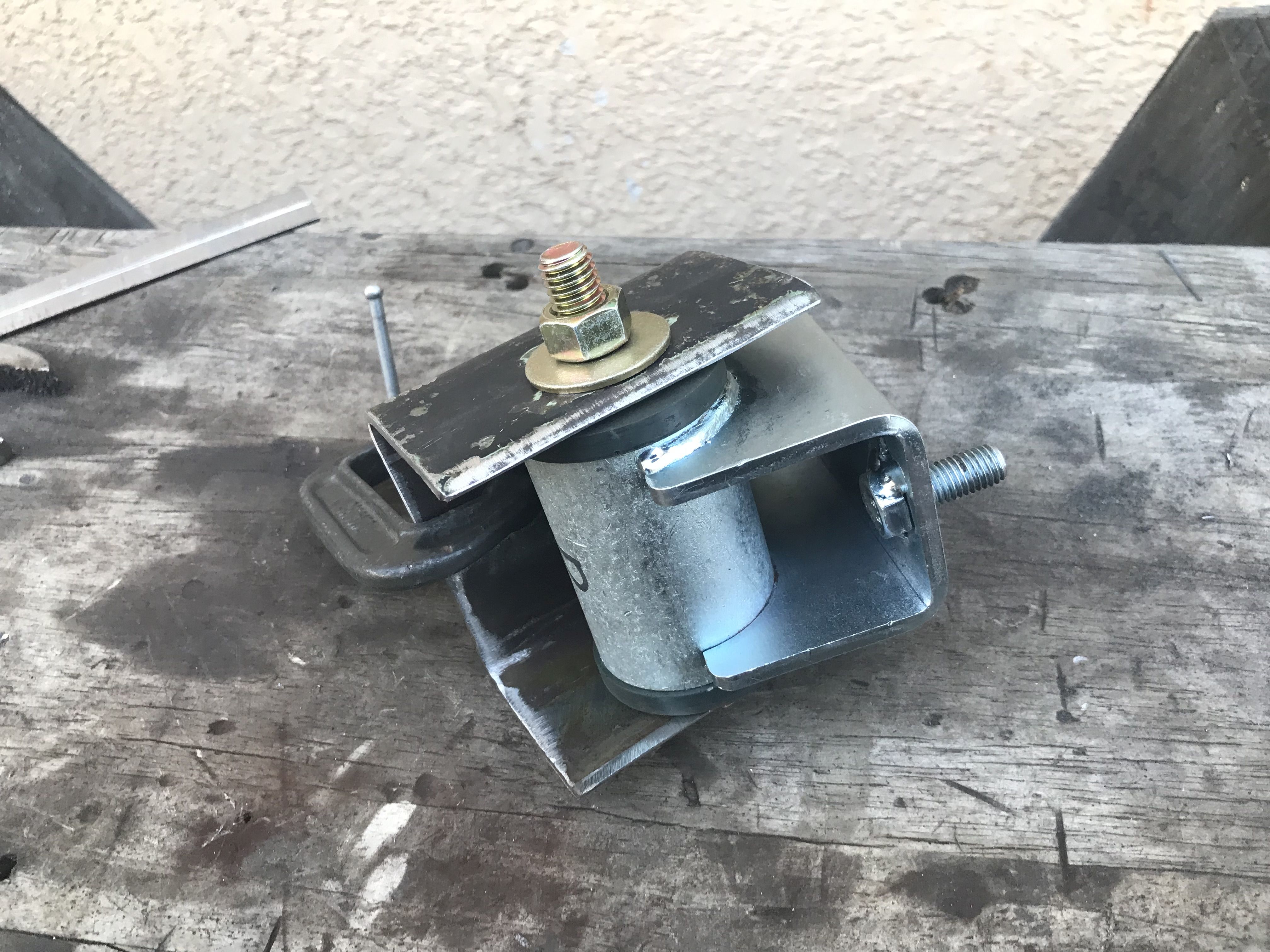

Post by Gregski »

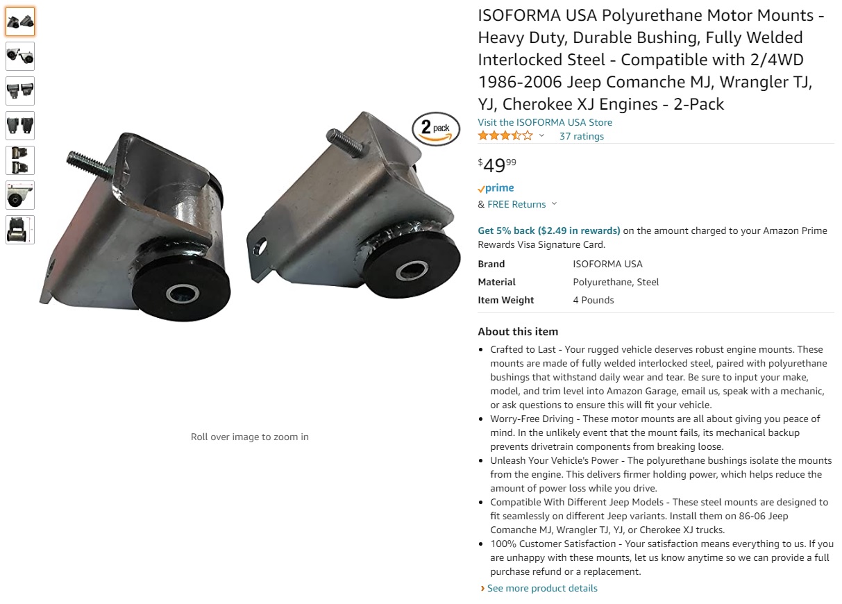

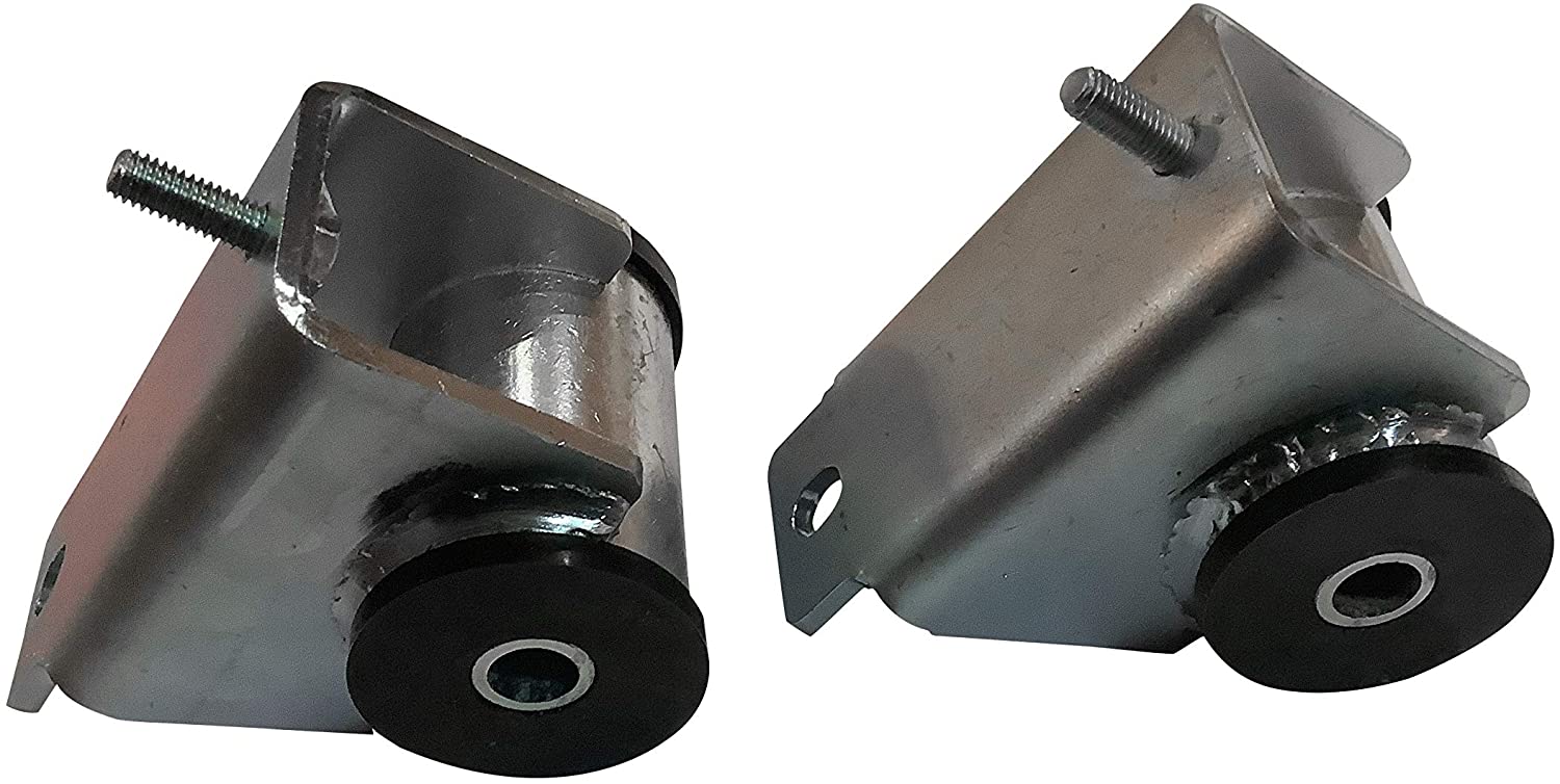

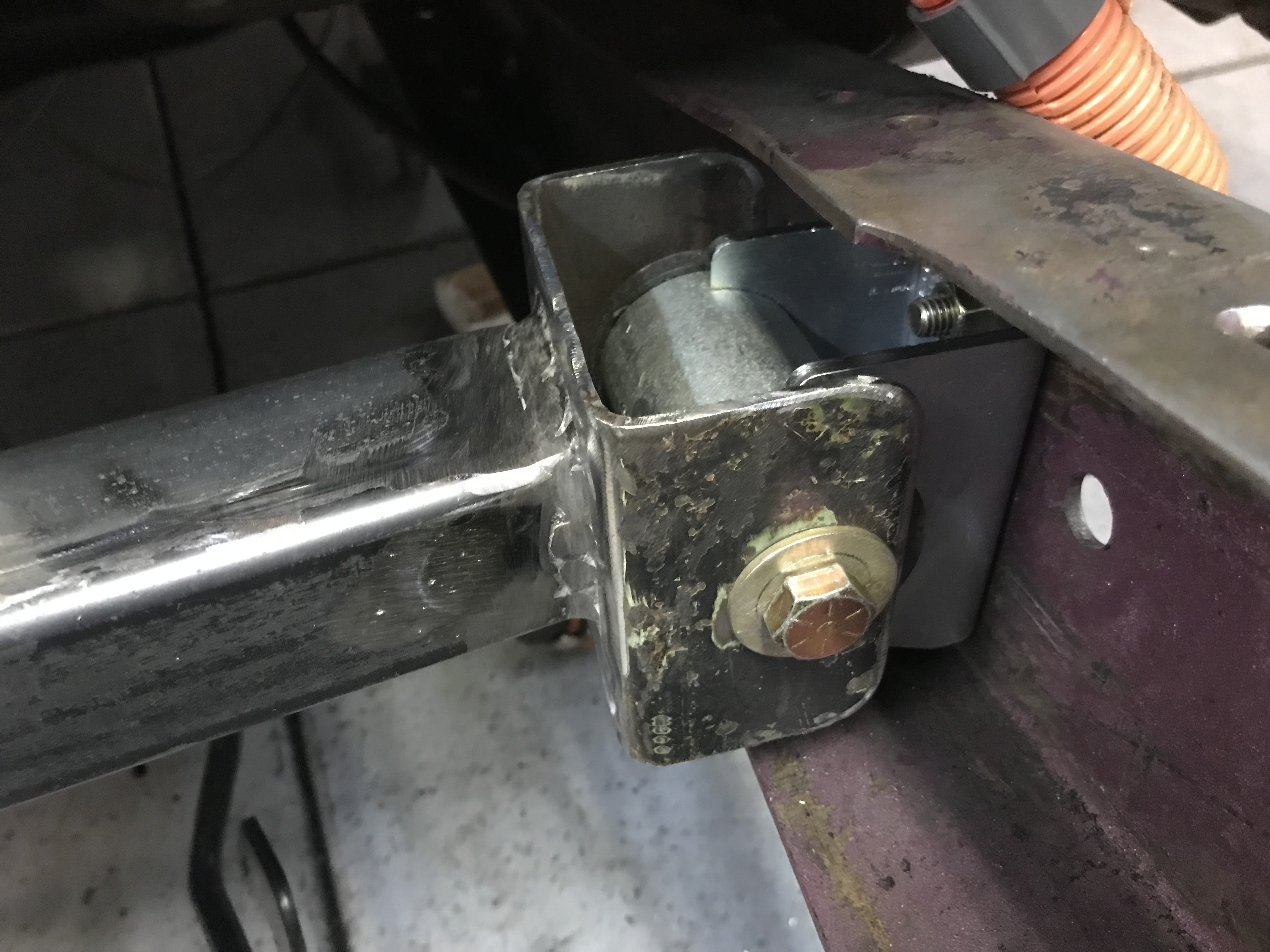

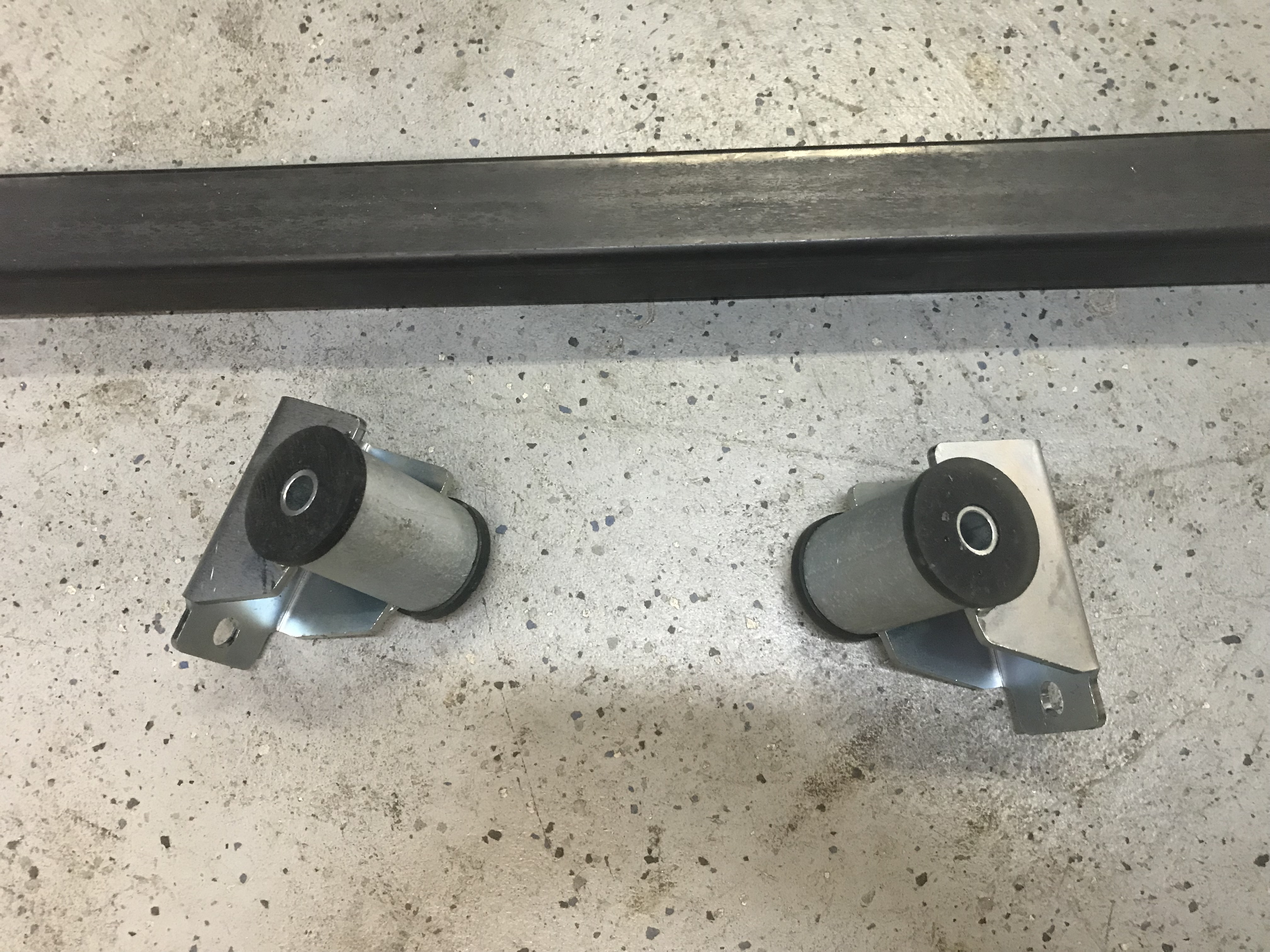

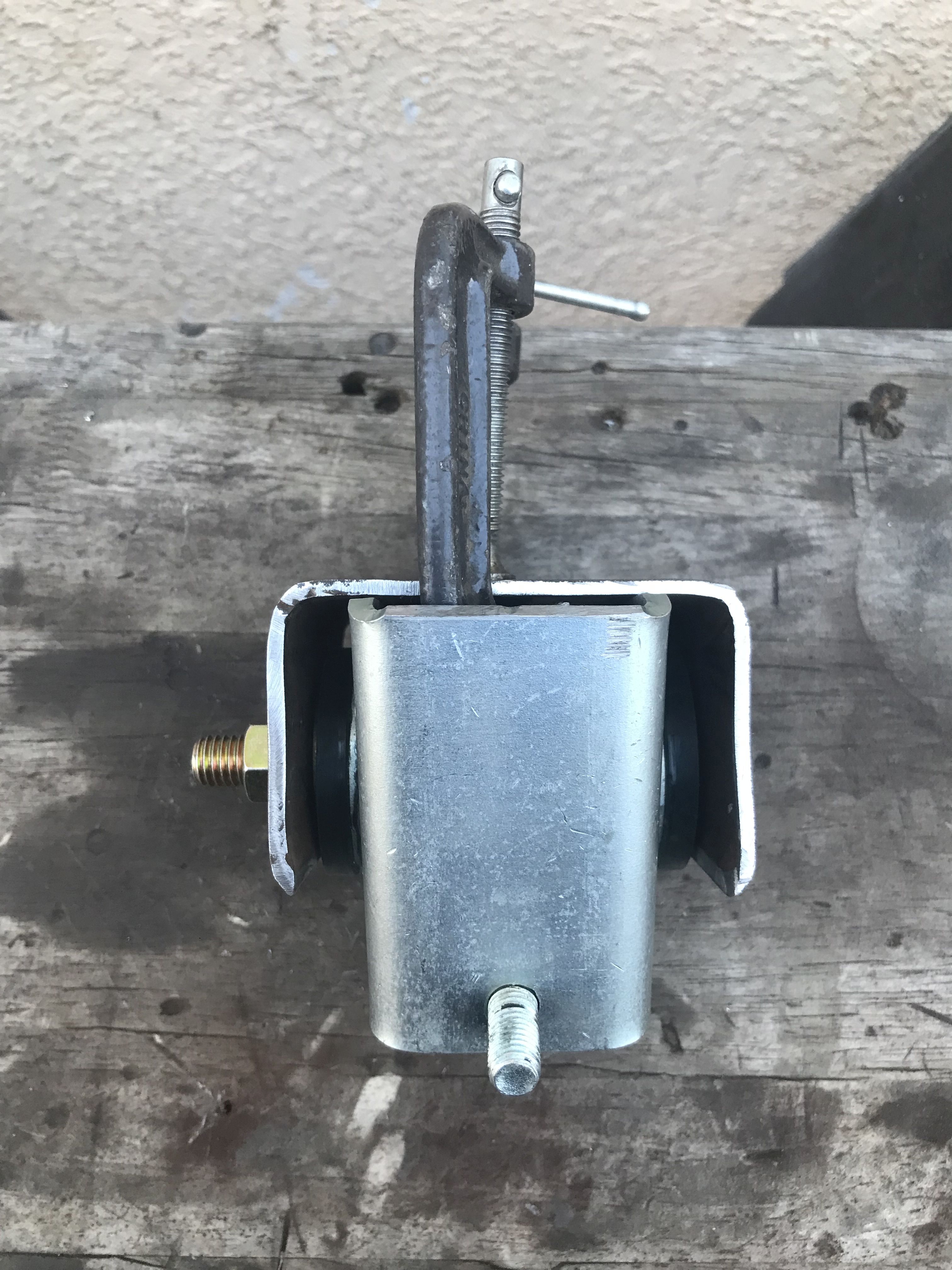

I'm going with these Jeep like AMAZON motor mounts, figuring if they was strong enuff to hold an engine they ought to hold a transmission
now hang on to your comments as this is all just spit ballin' mock up, and that frame's got more twist and turns than you know it

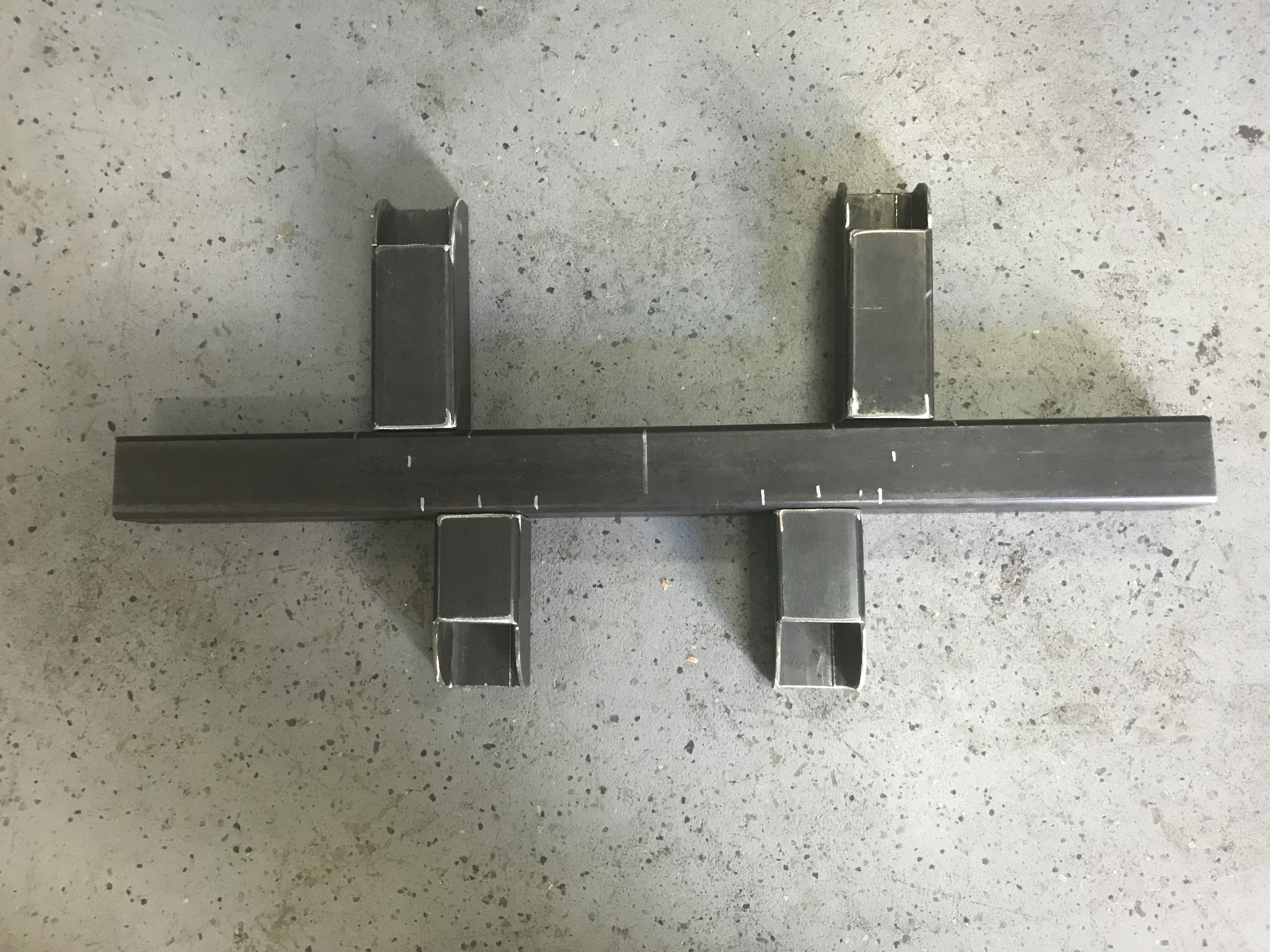

Post by Gregski »

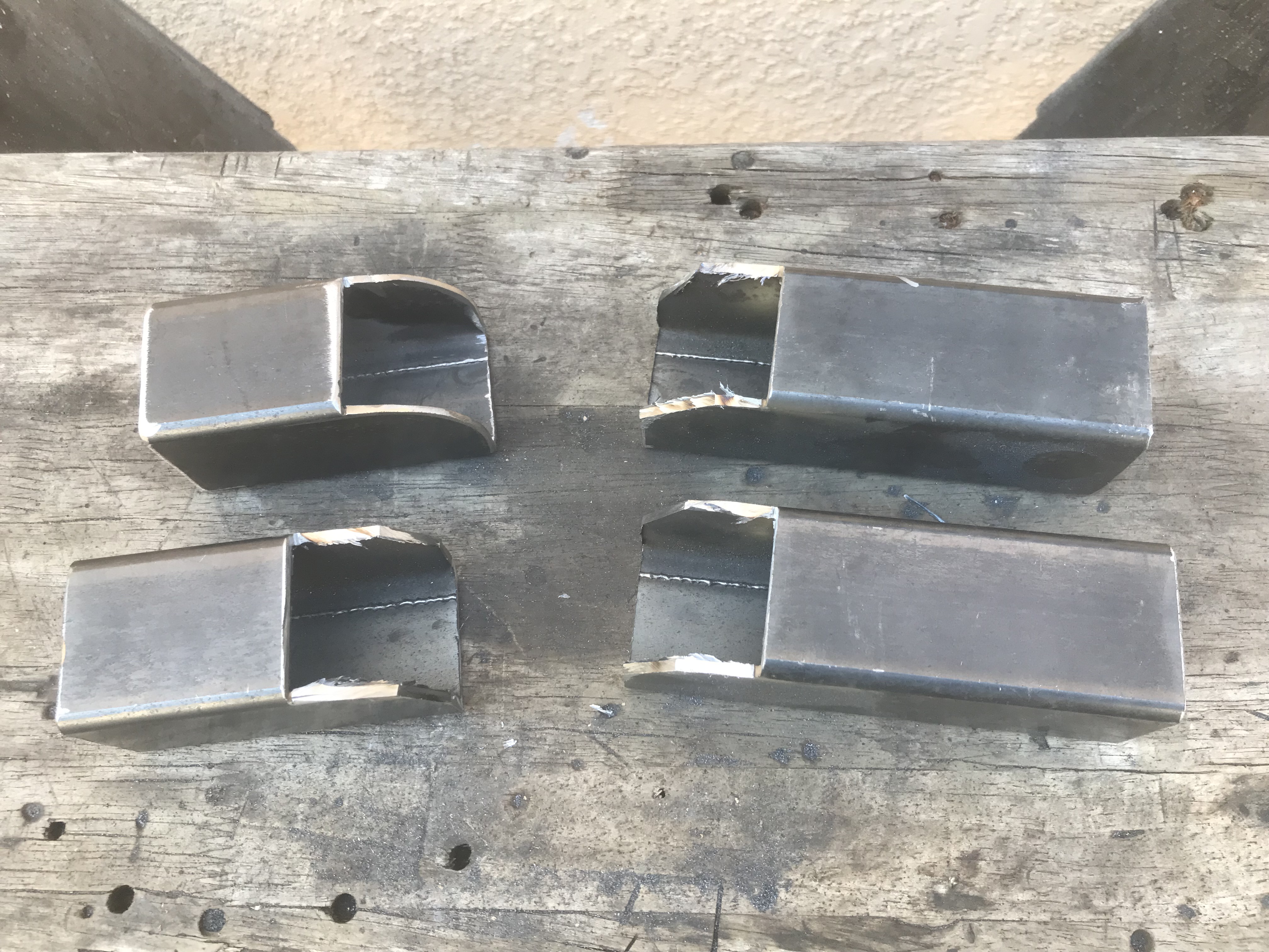

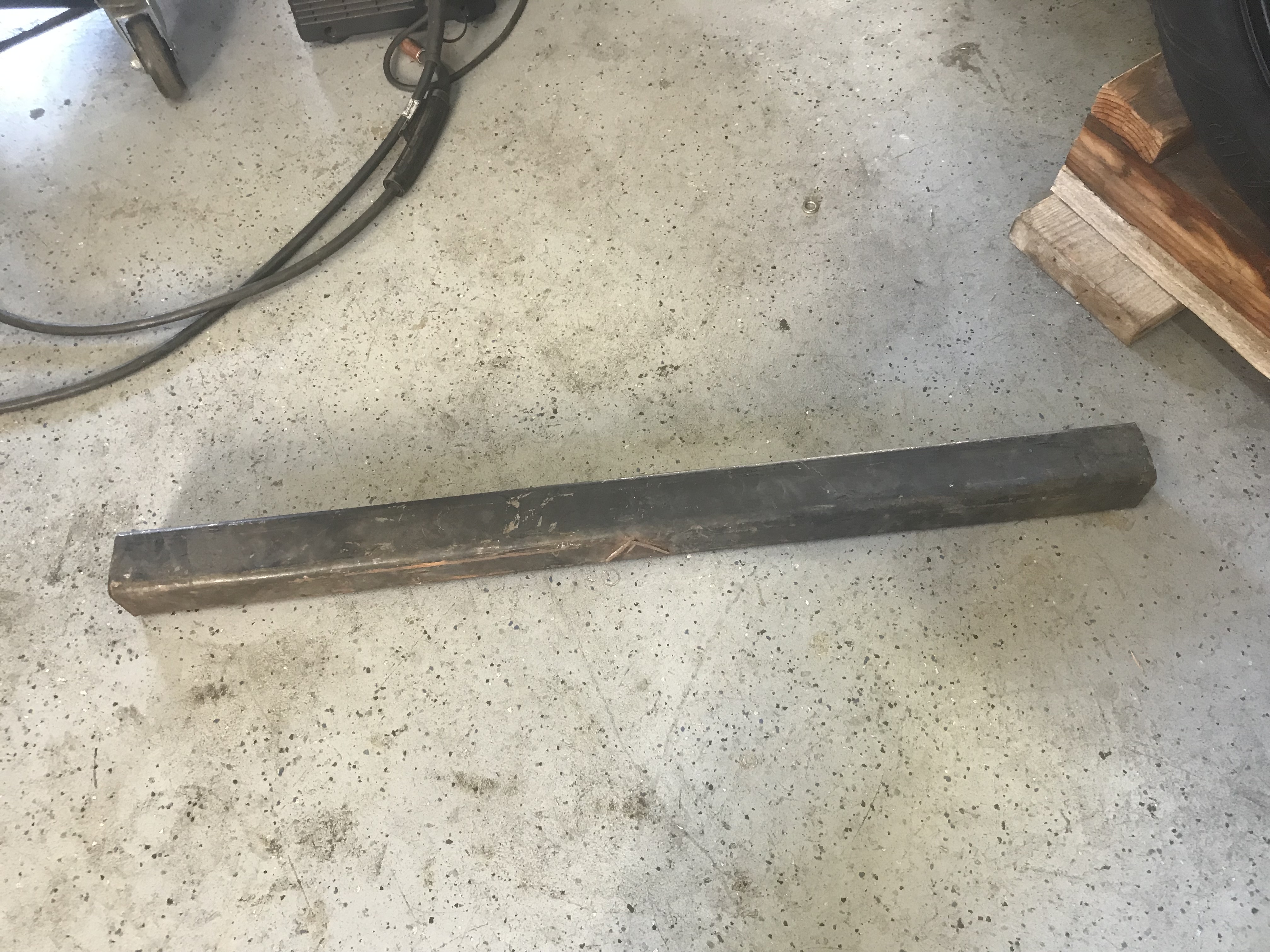

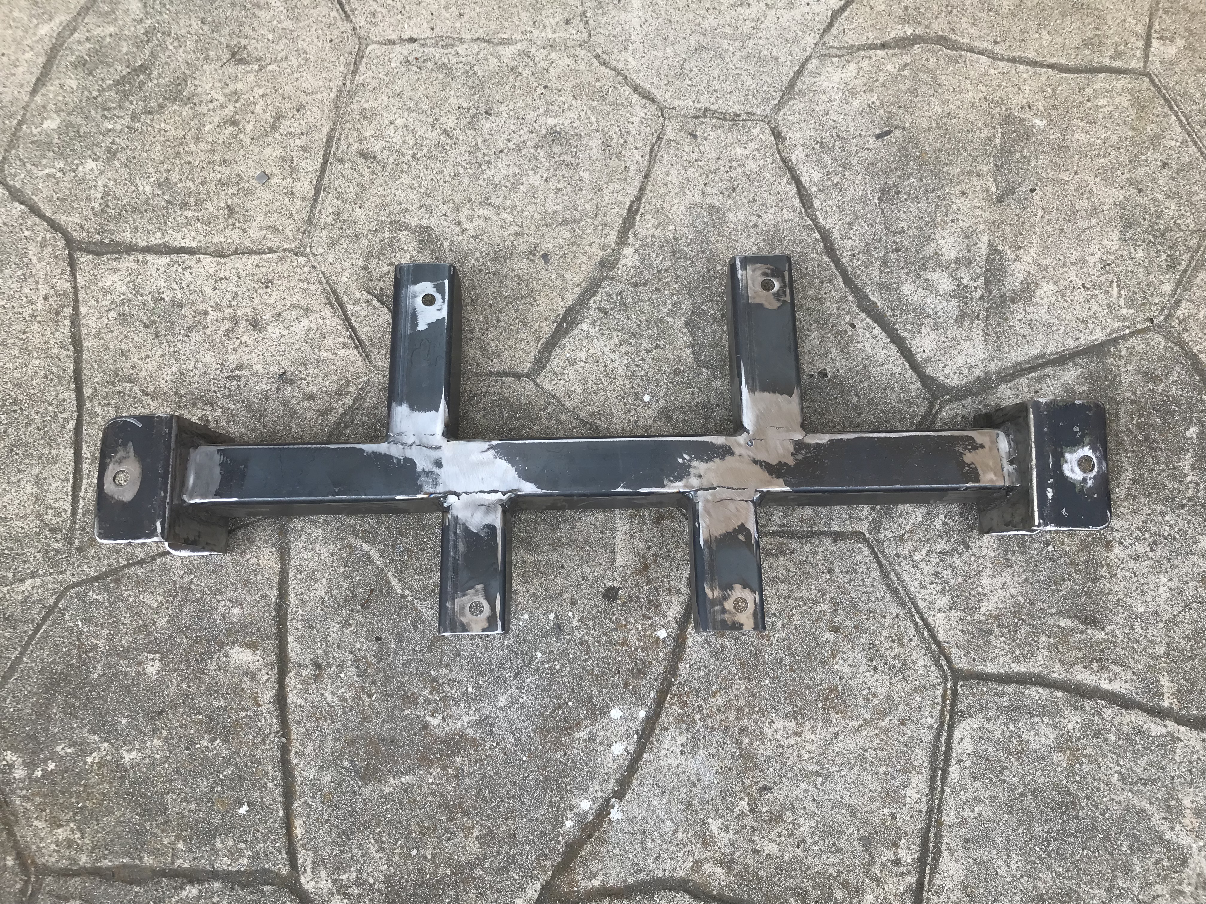

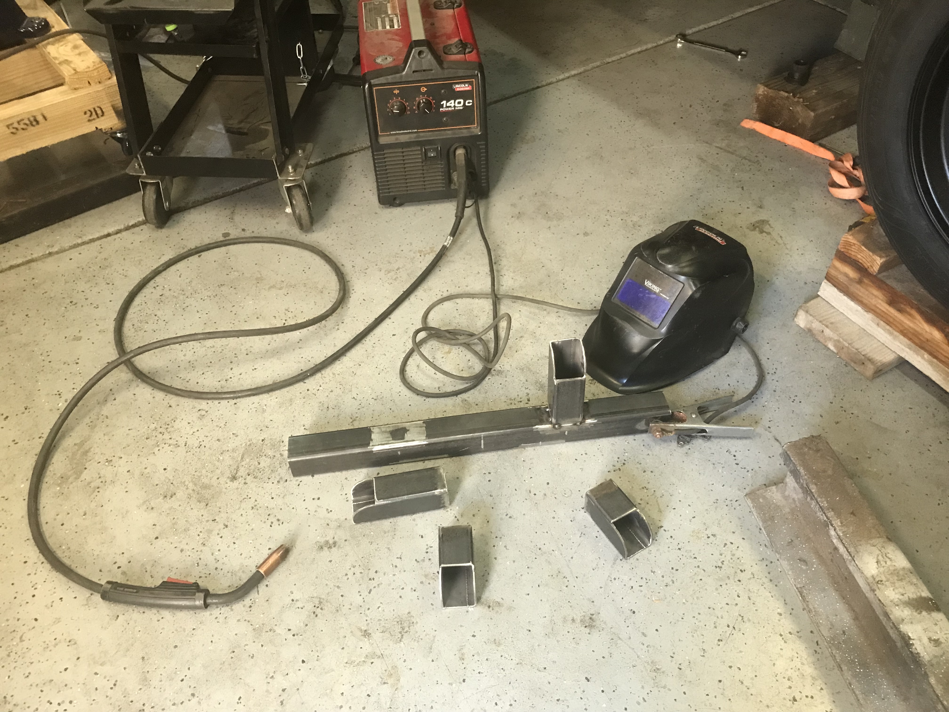

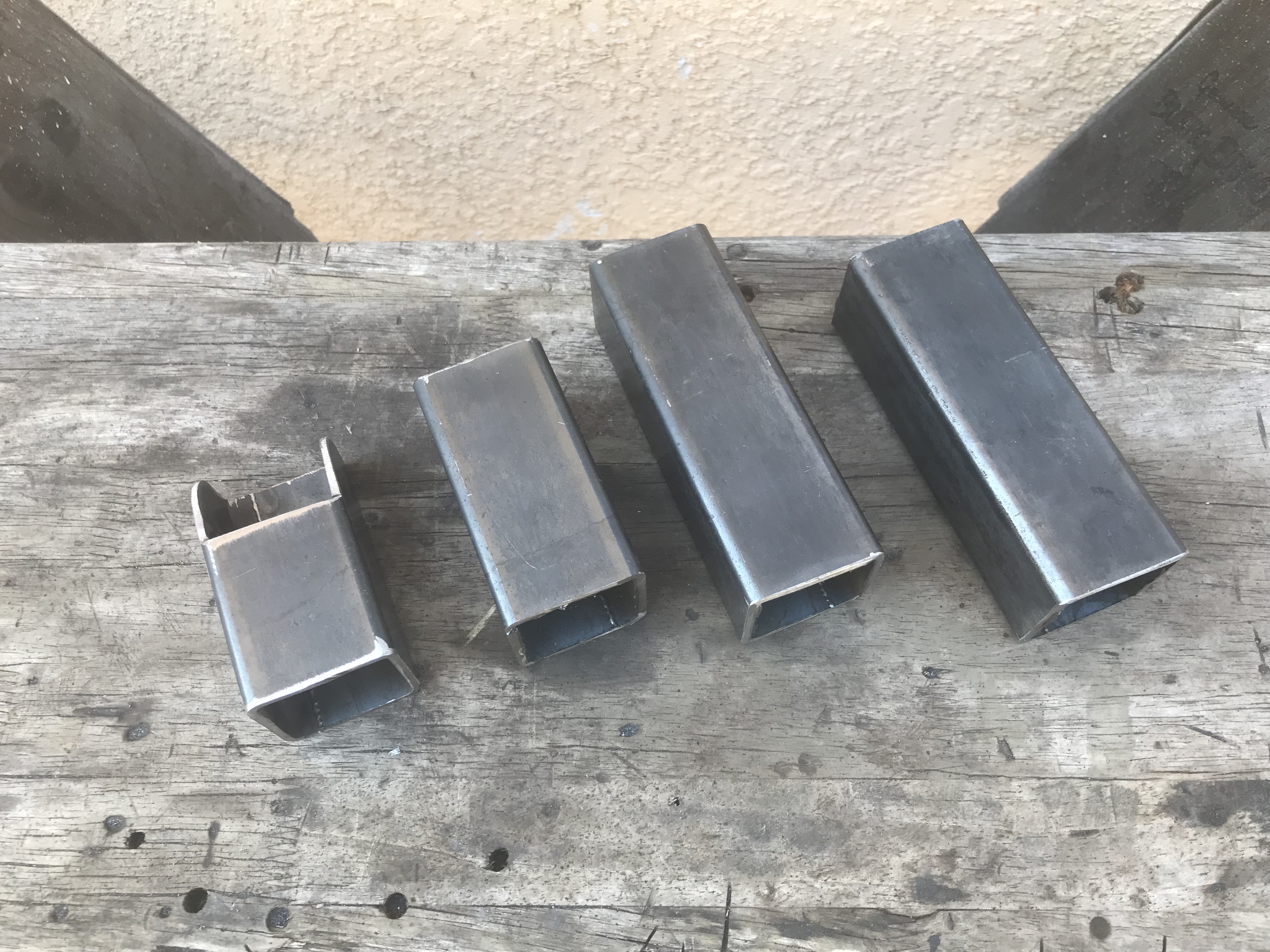

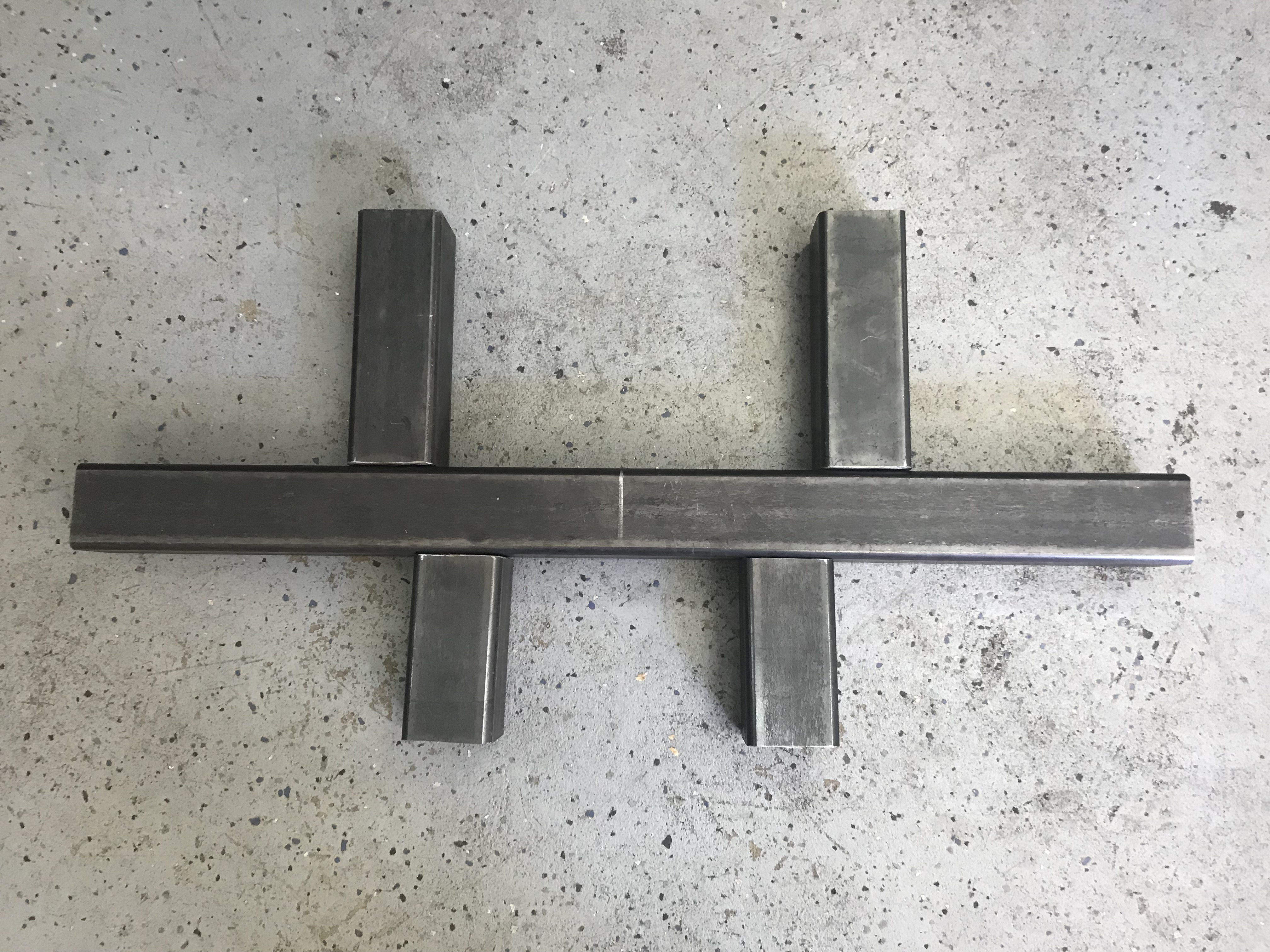

so like most I make big plans in my head and then use what I got layin' around the garage - ie sum random 2" square tubin'
Gregski
Posts: 3160

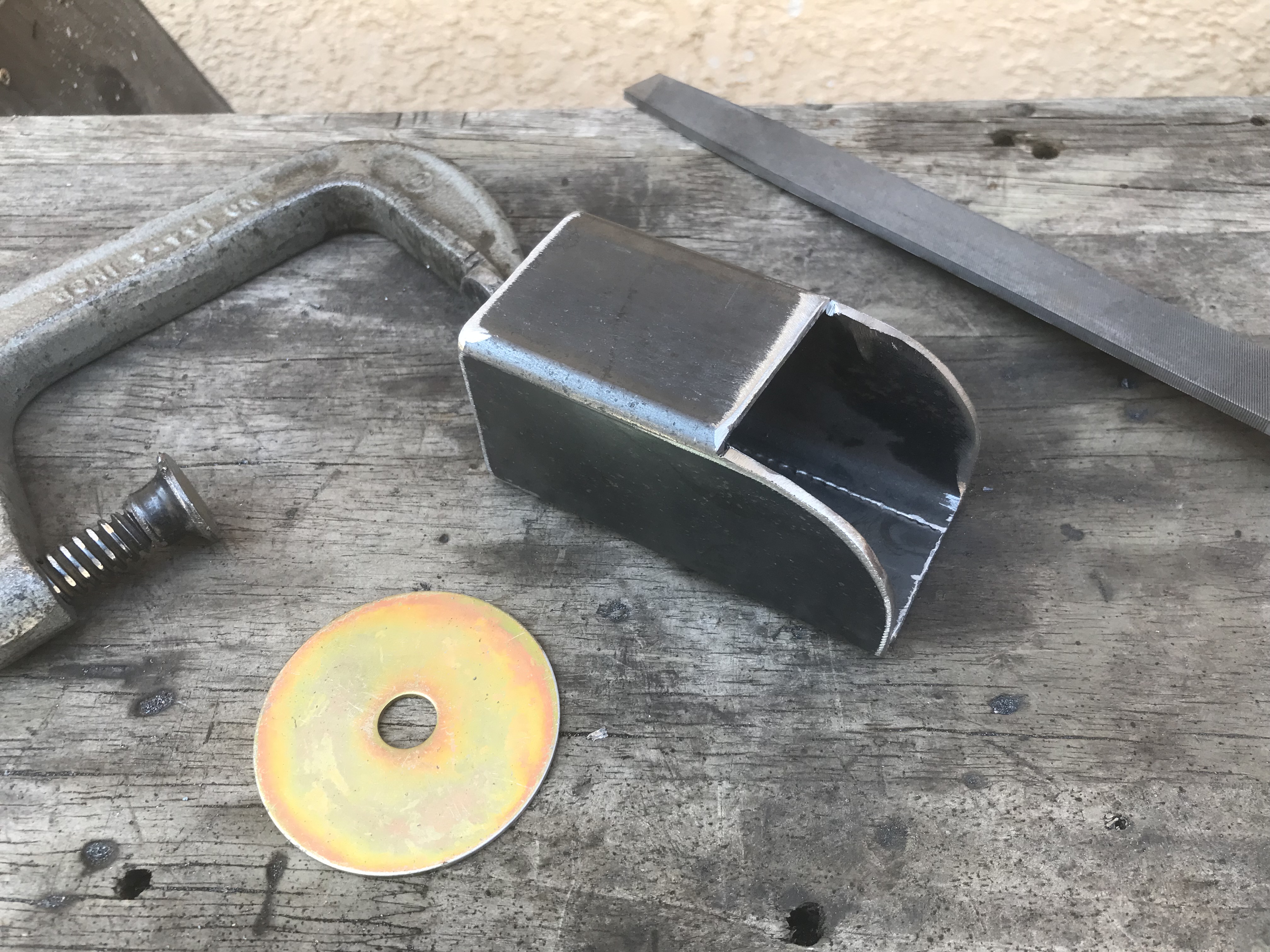

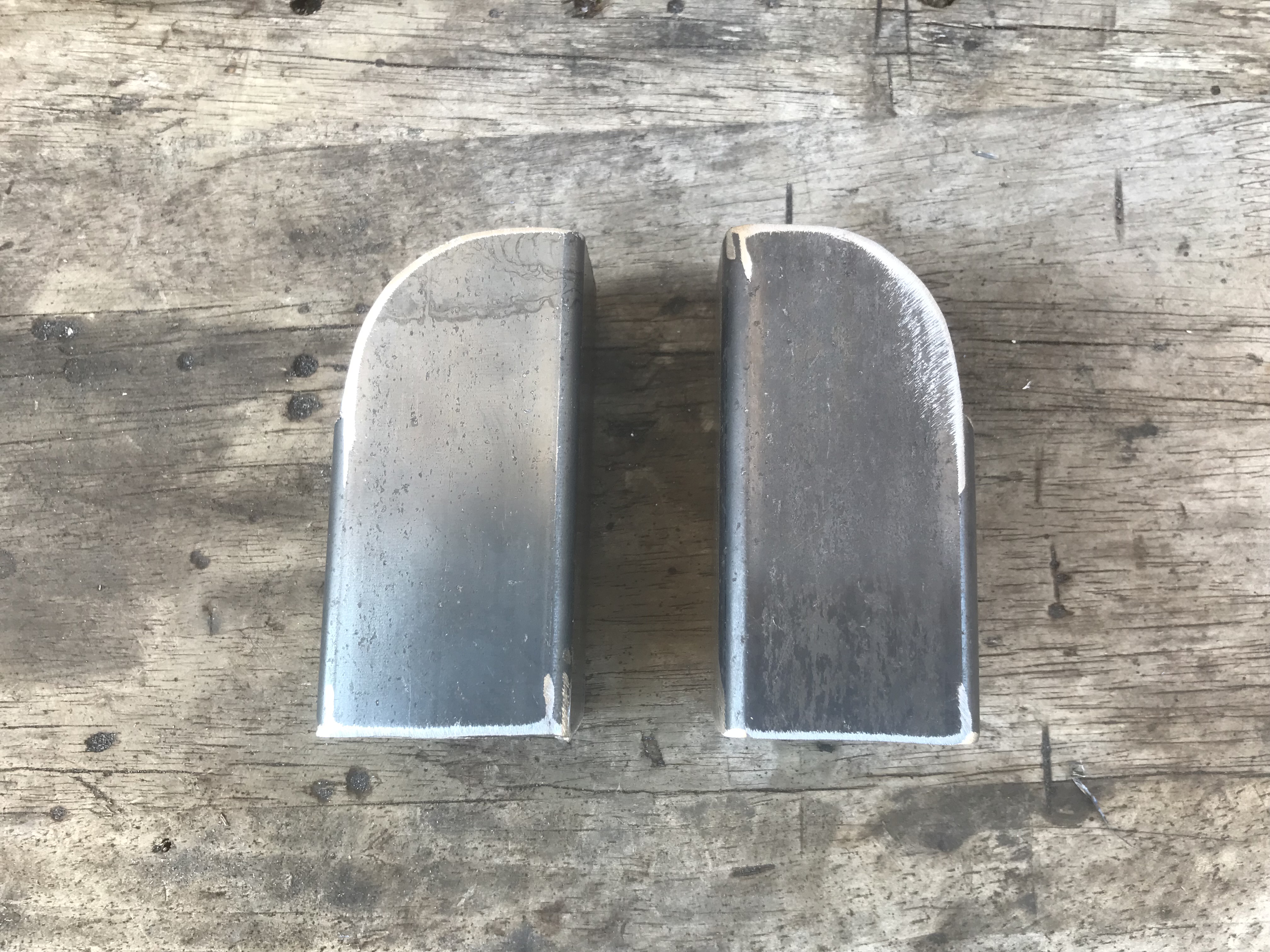

Post by Gregski »
I like to class things up with rounded corners, ha ha

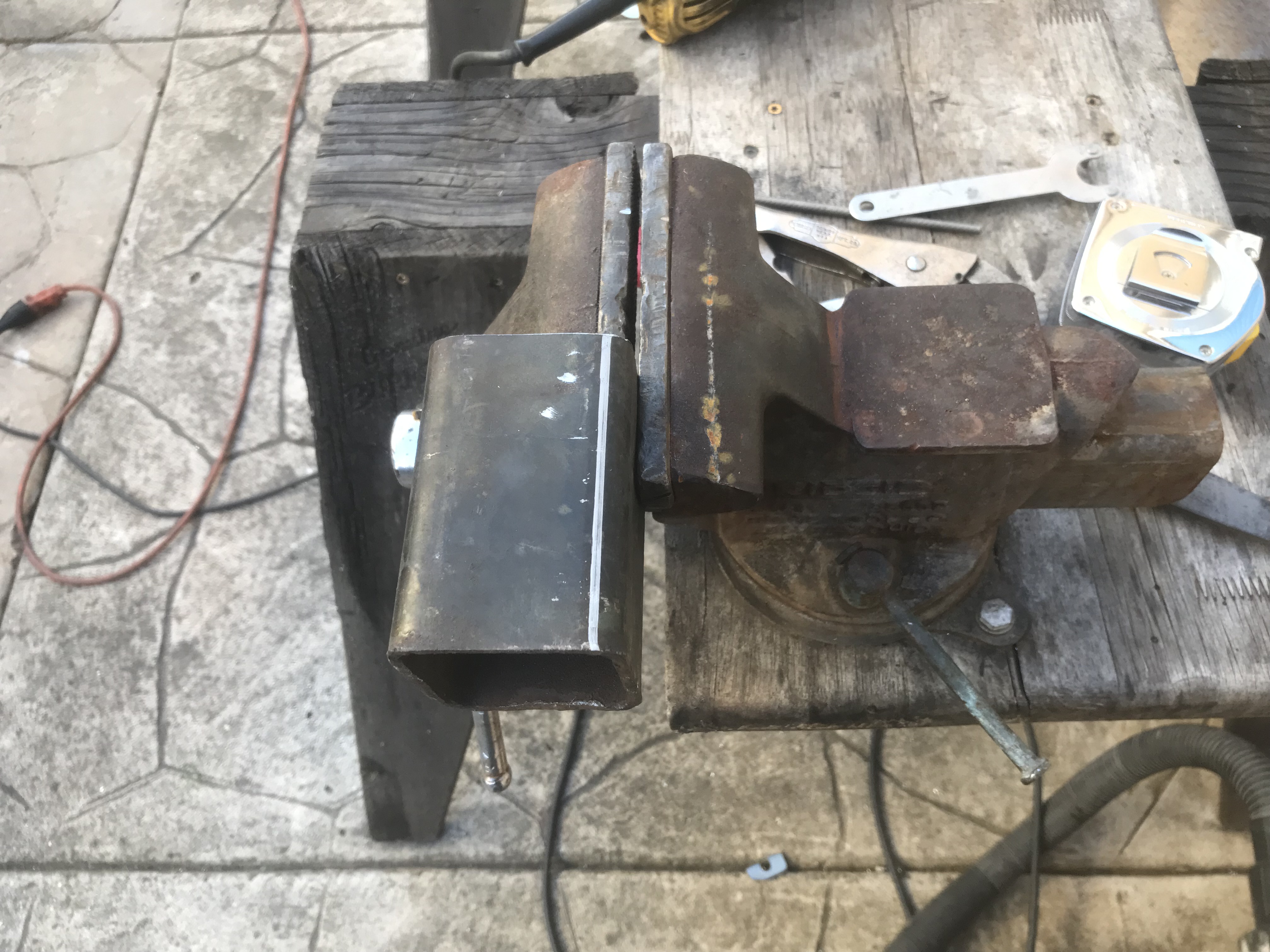

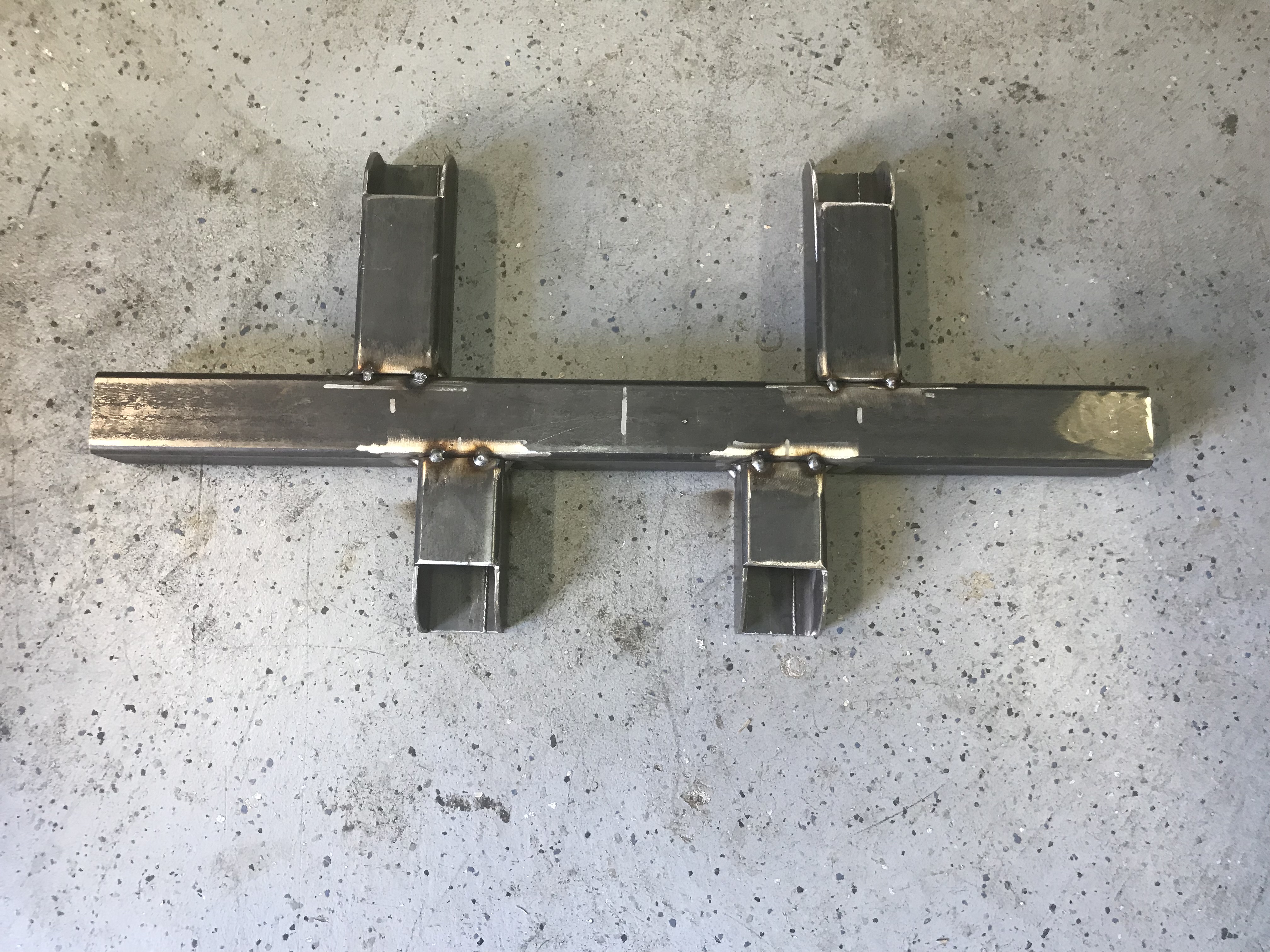

Post by Gregski »
one down three to go
slow is the tempo
Gregski
Posts: 3160

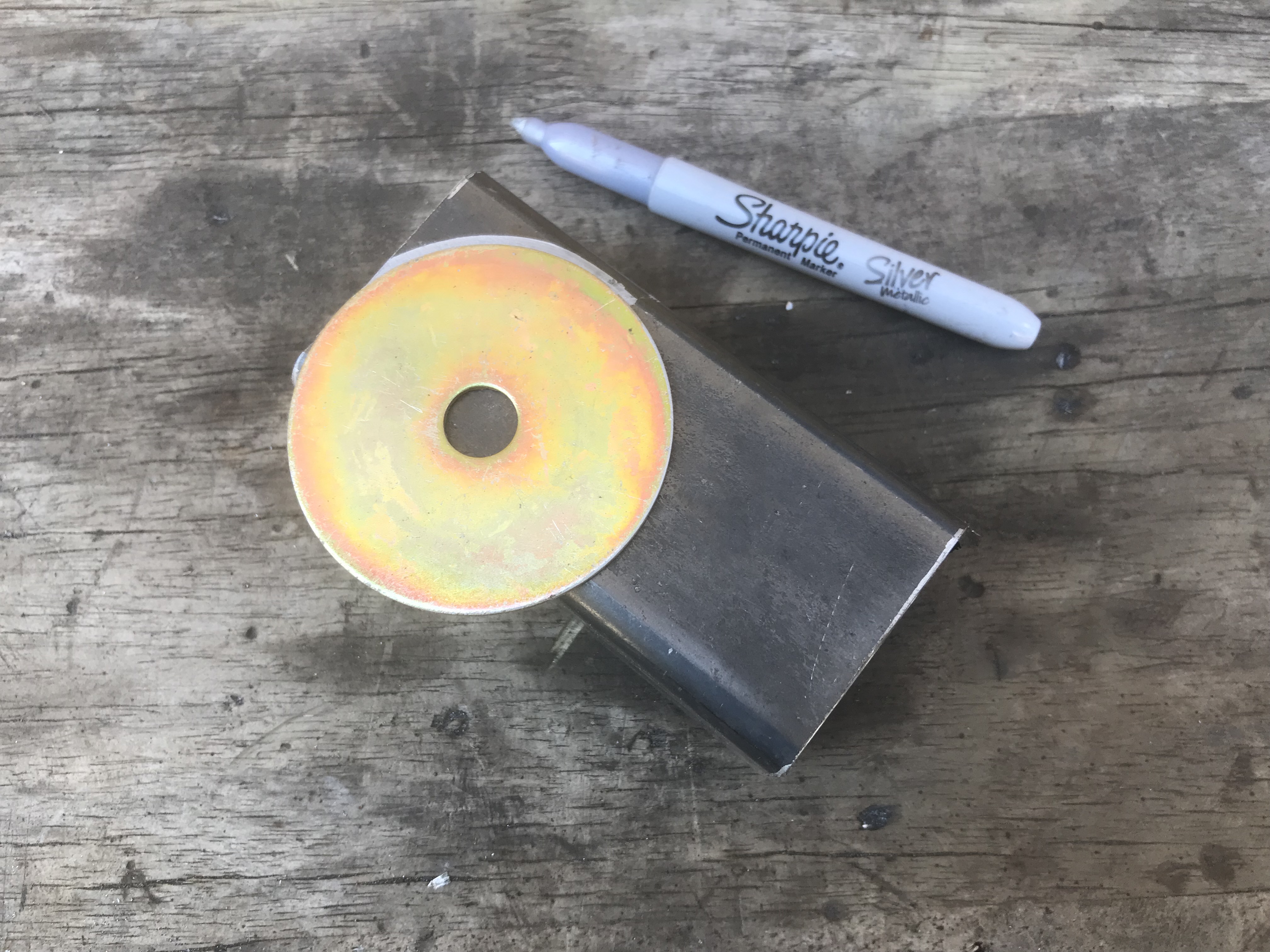

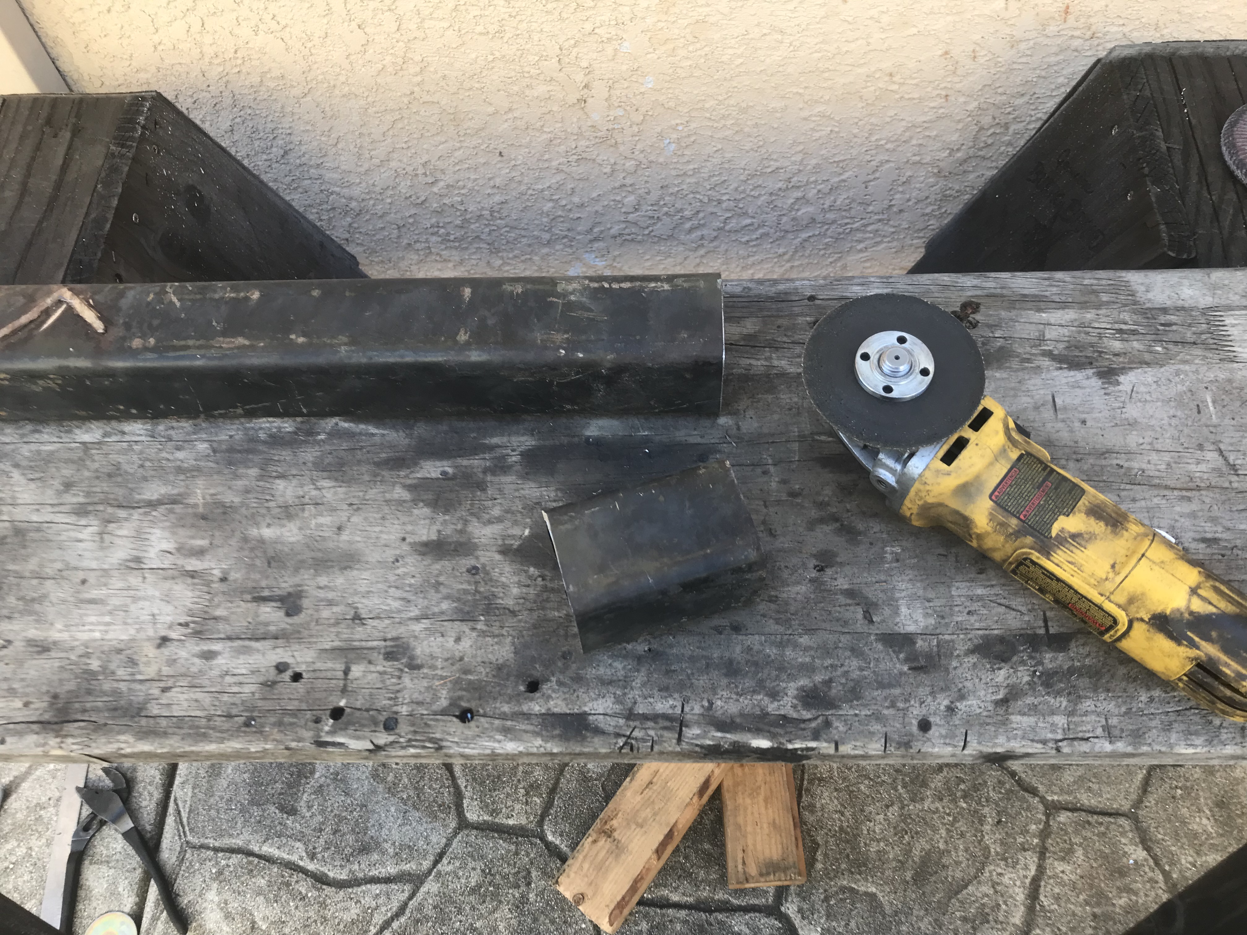

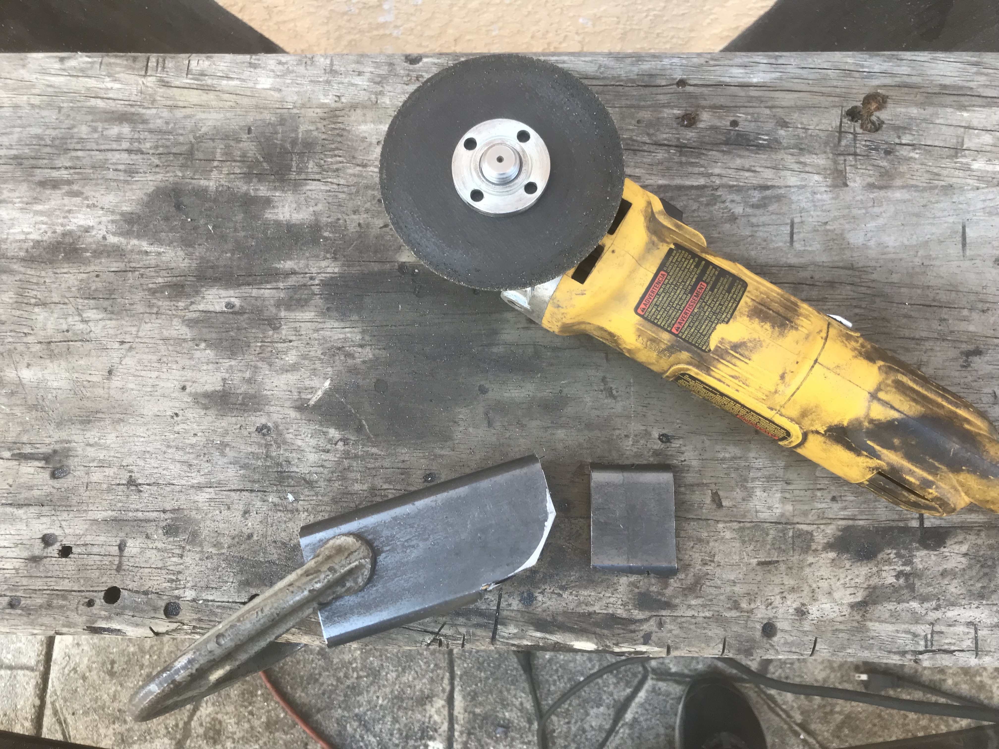

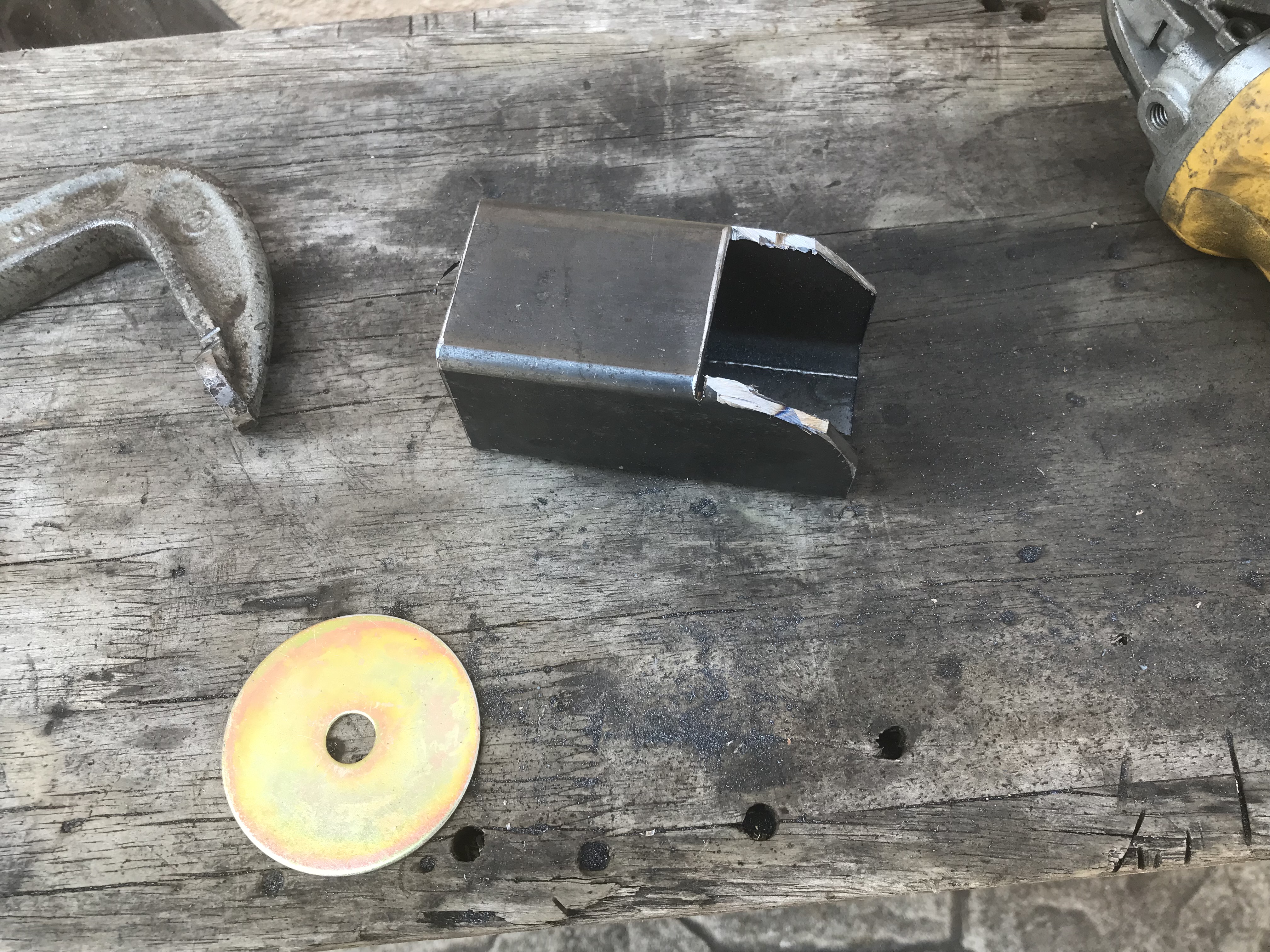

Post by Gregski »
I just trace sum random washer I find laying around
and I do two passes, first one is a ruff cut with a cutoff wheel
Gregski
Posts: 3160

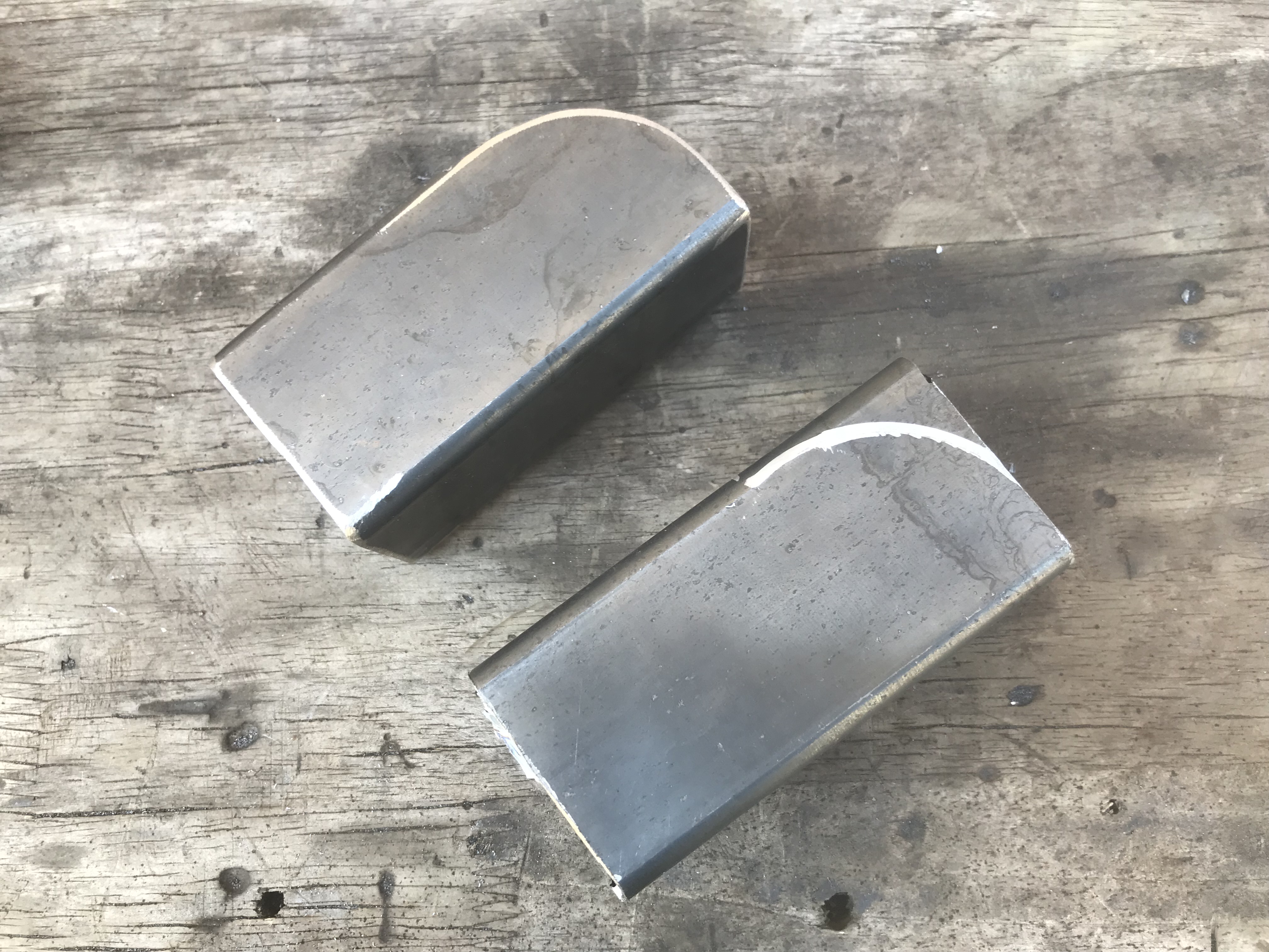

Post by Gregski »
and the second pass is with lap sandpaper discs (I never use grind stones, they suck)
Gregski
Posts: 3160
Post by Gregski »
and that gives us this

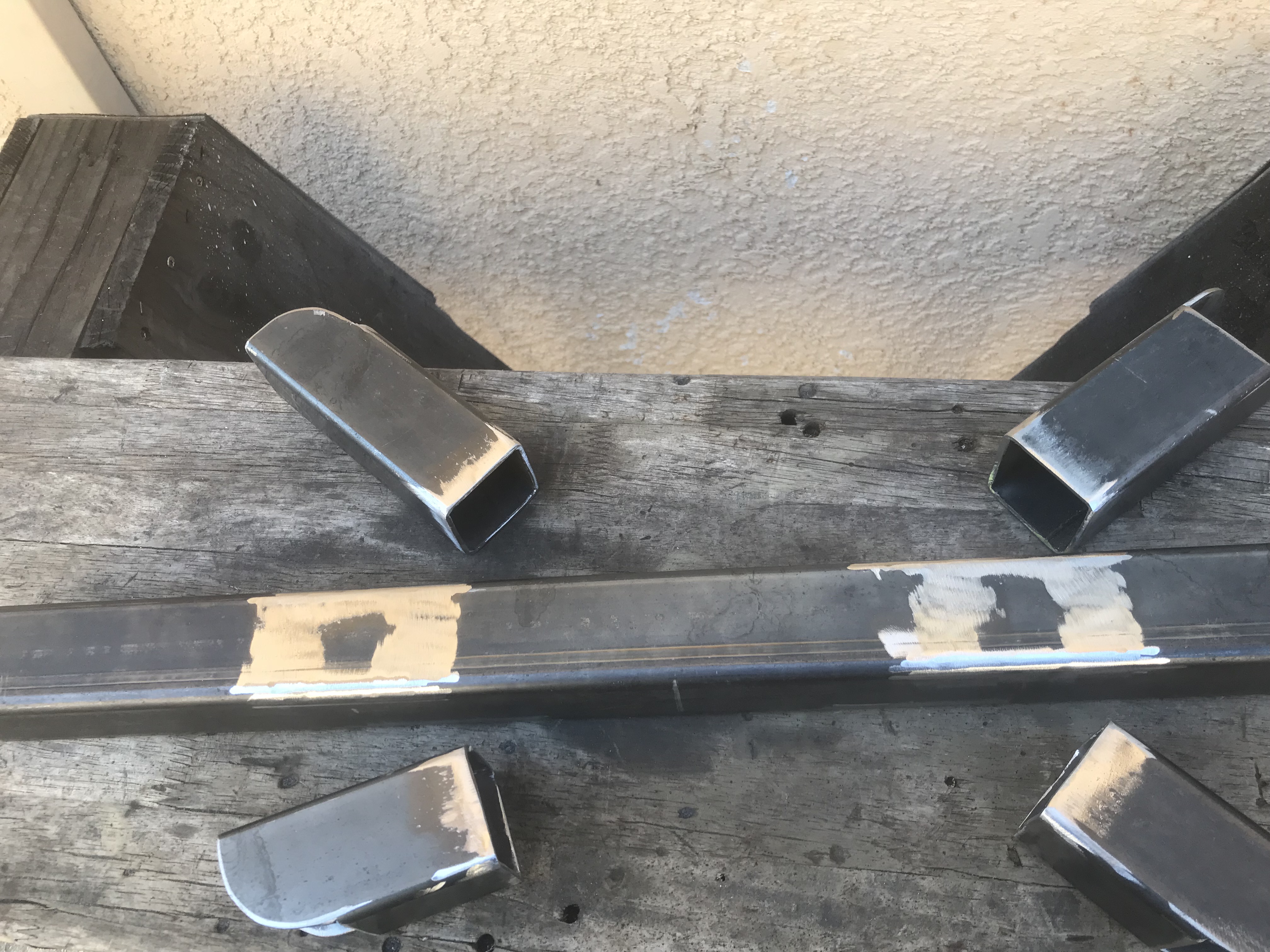

Gregski
Posts: 3160
Post by Gregski »

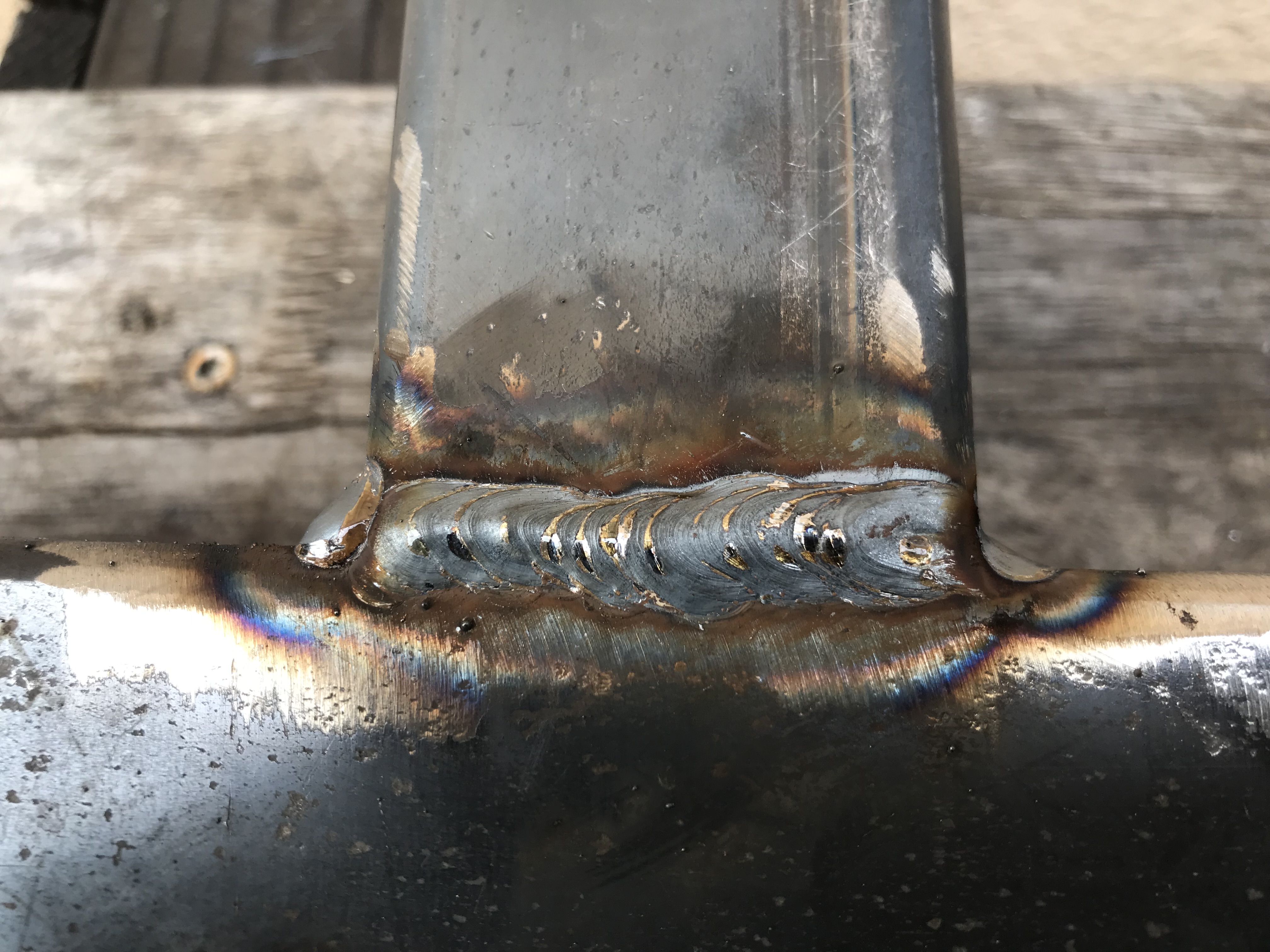

which we make shinny for some JB Welding...
Gregski
Posts: 3160
Post by Gregski »
tacking like a Boss !

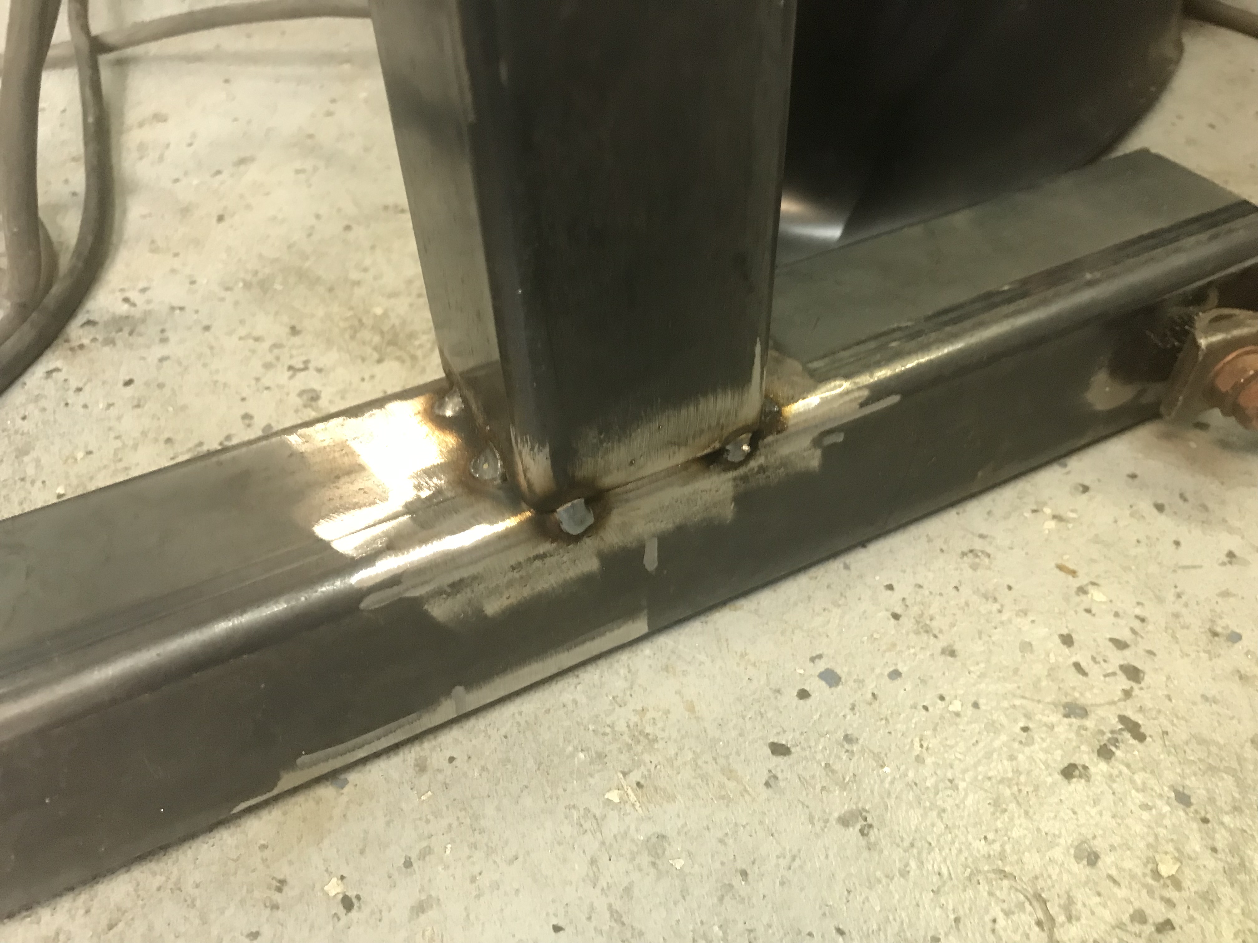

Gregski
Posts: 3160
Post by Gregski »
transferrin' dem holes!
Gregski
Posts: 3160

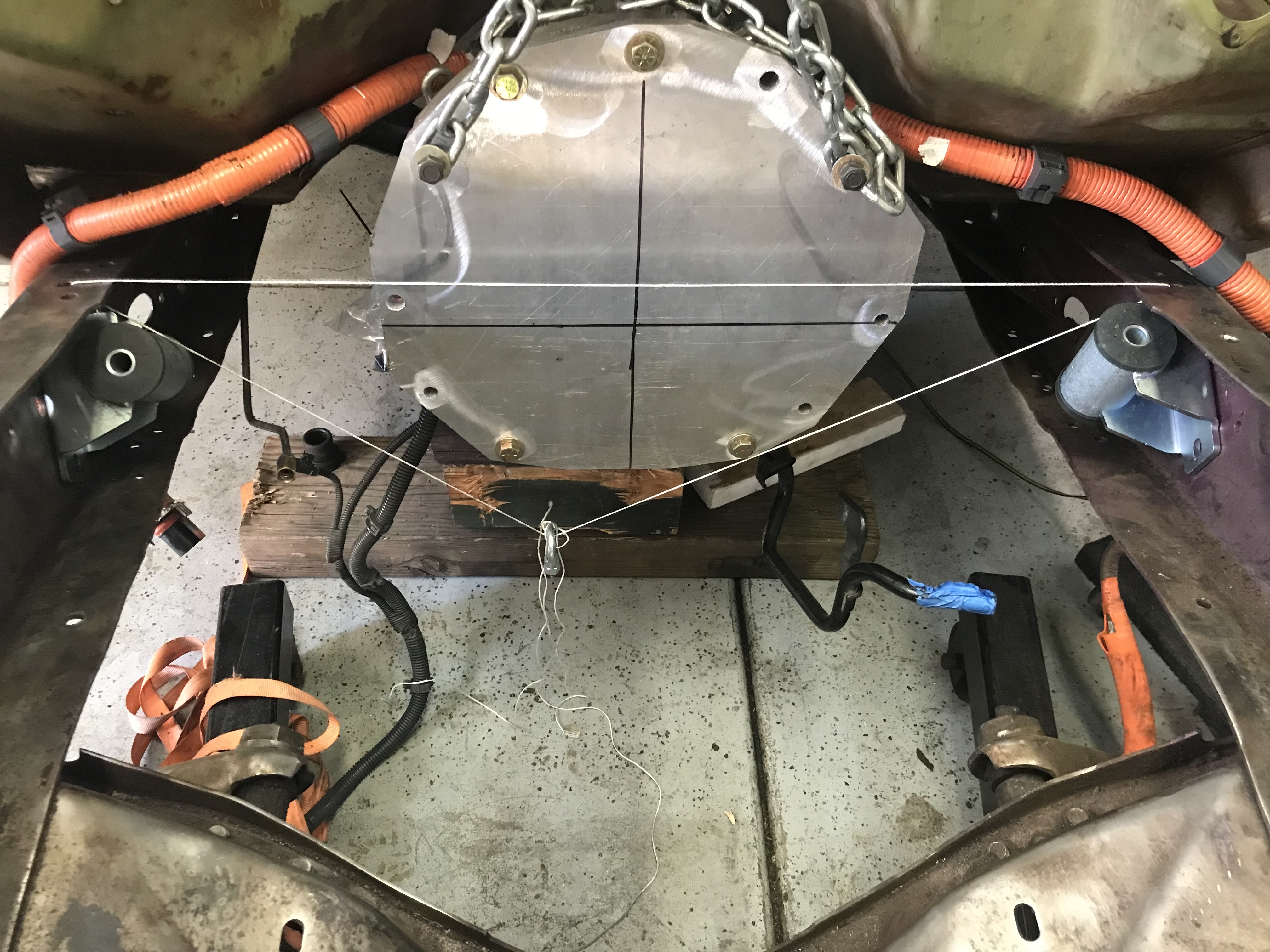

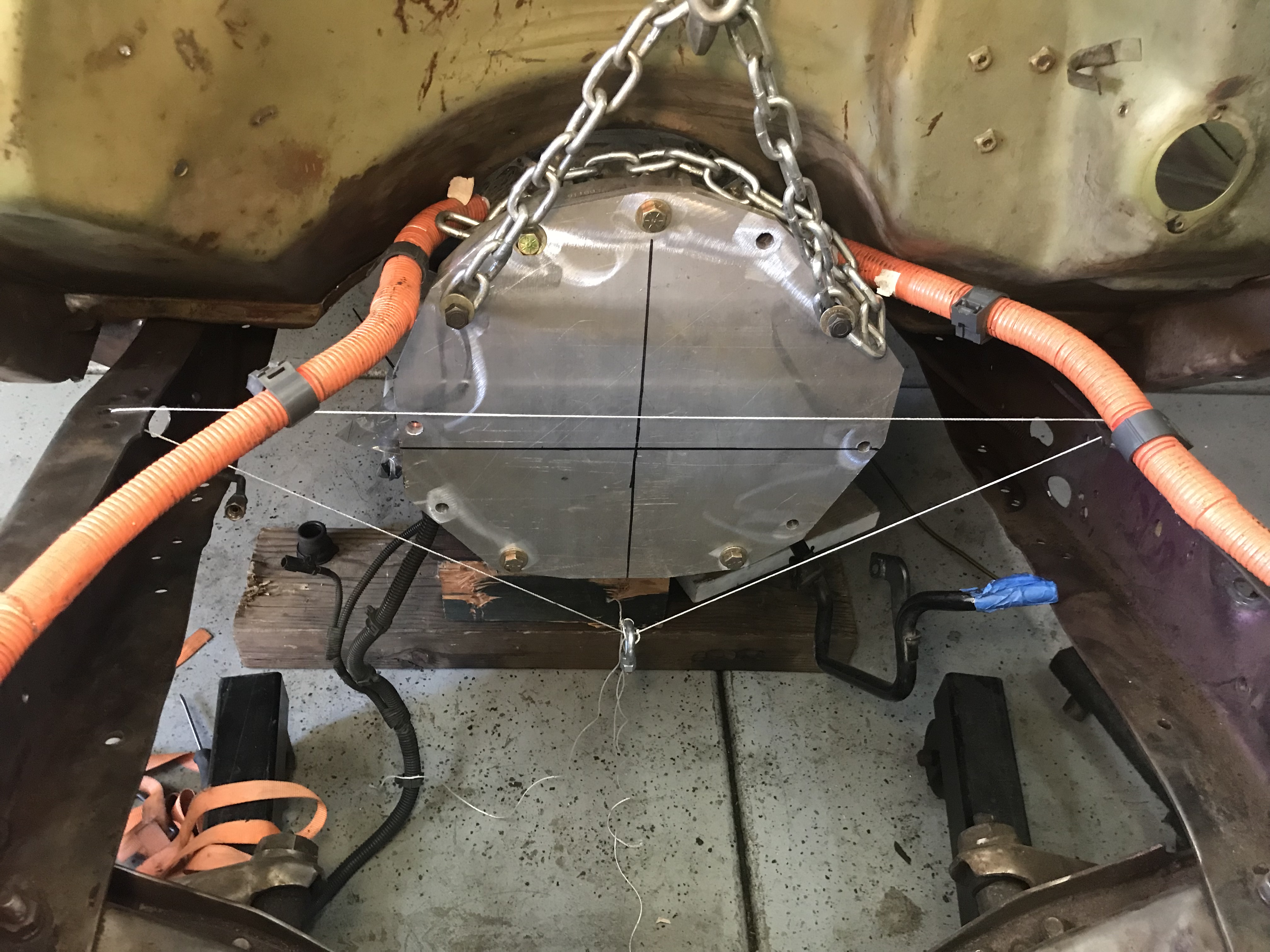

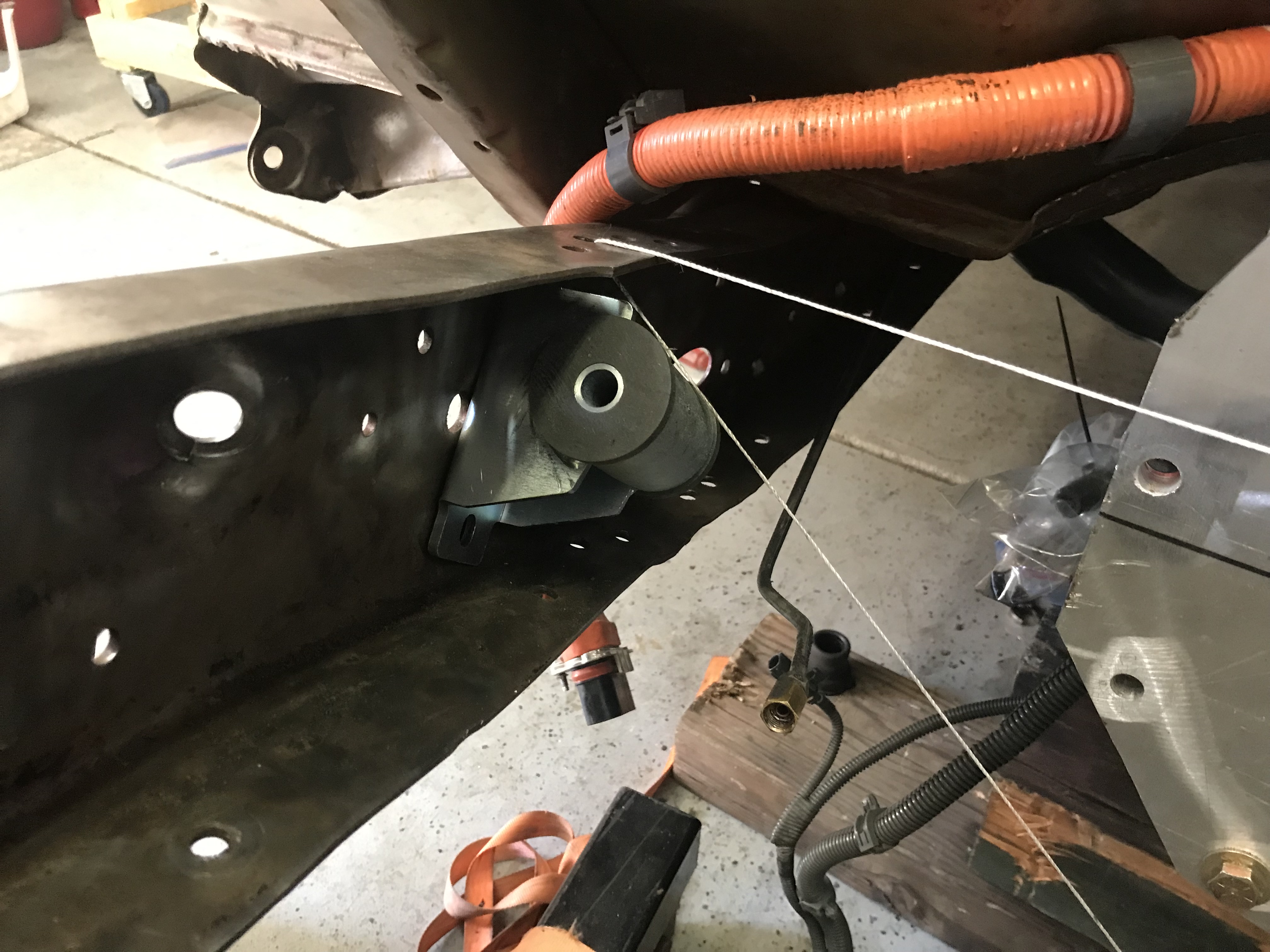

Post by Gregski »
and time for the eyecrometer test
Been thanked: 1914 times
Wow, that looks really nice, I mean erm good enough of course ;) I do like the symmetry here.
Gregski
Posts: 3160
Post by Gregski »
johu wrote: Wed Mar 30, 2022 9:22 amWow, that looks really nice
hey you take that back!
johu wrote: Wed Mar 30, 2022 9:22 amI mean erm good enough of course ;)
OK, that's better.
johu wrote: Wed Mar 30, 2022 9:22 amI do like the symmetry here.
my brotha from anotha motha, thanks, me too, it was really difficult to design while building and I had to put my symmetrical brain on hold for most of it as it's all pollywhompus, take these ends for example they want to mount where the frame goes down, and in, and turns

Post by Gregski »

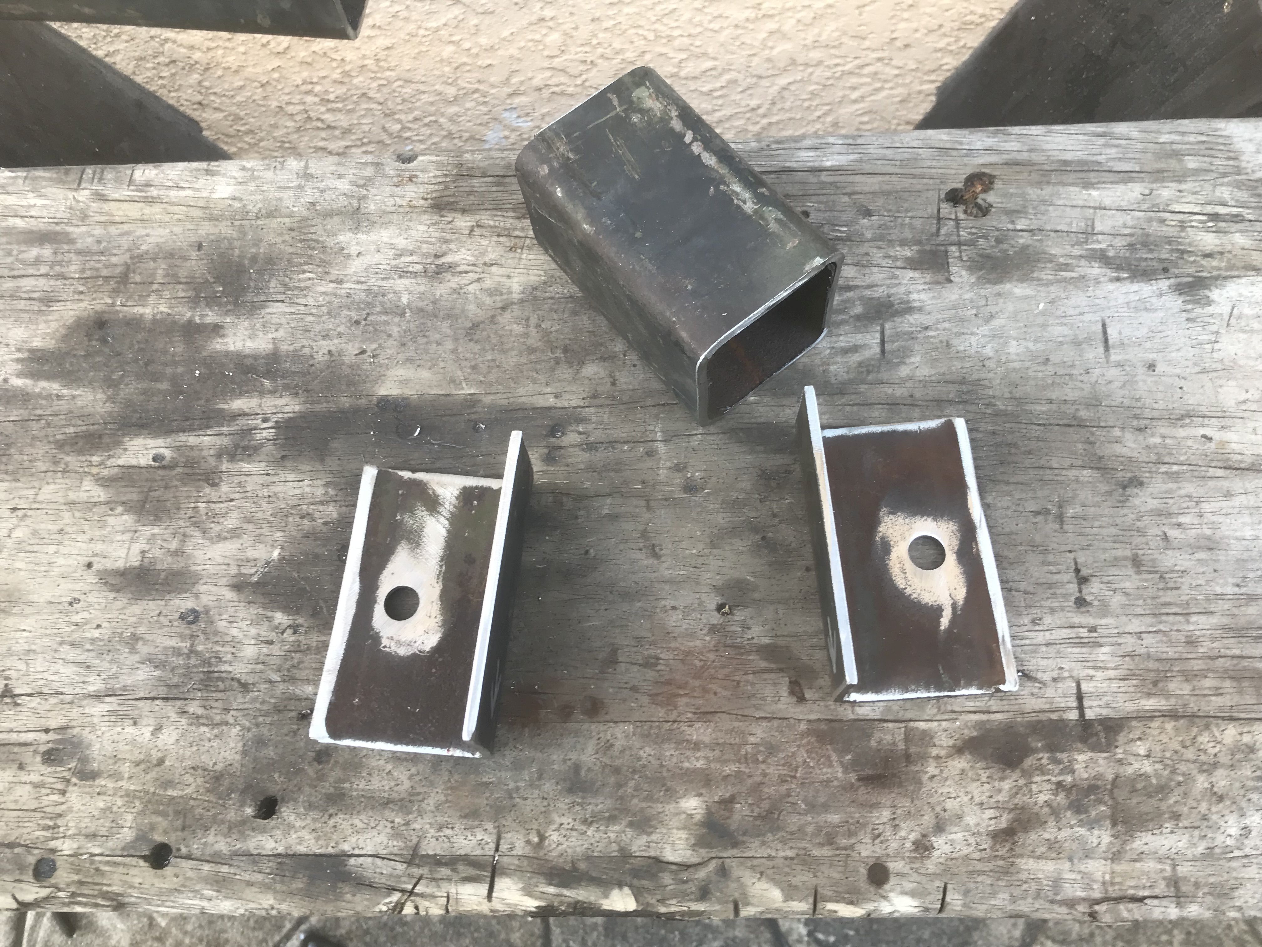

I seriously found this metal piece sitting at a side of a dumpster a few years back, that's the quality of parts we are dealing with here people
it wasn't quite wide enuff so it got split and will get reweldered
Gregski
Posts: 3160
Post by Gregski »

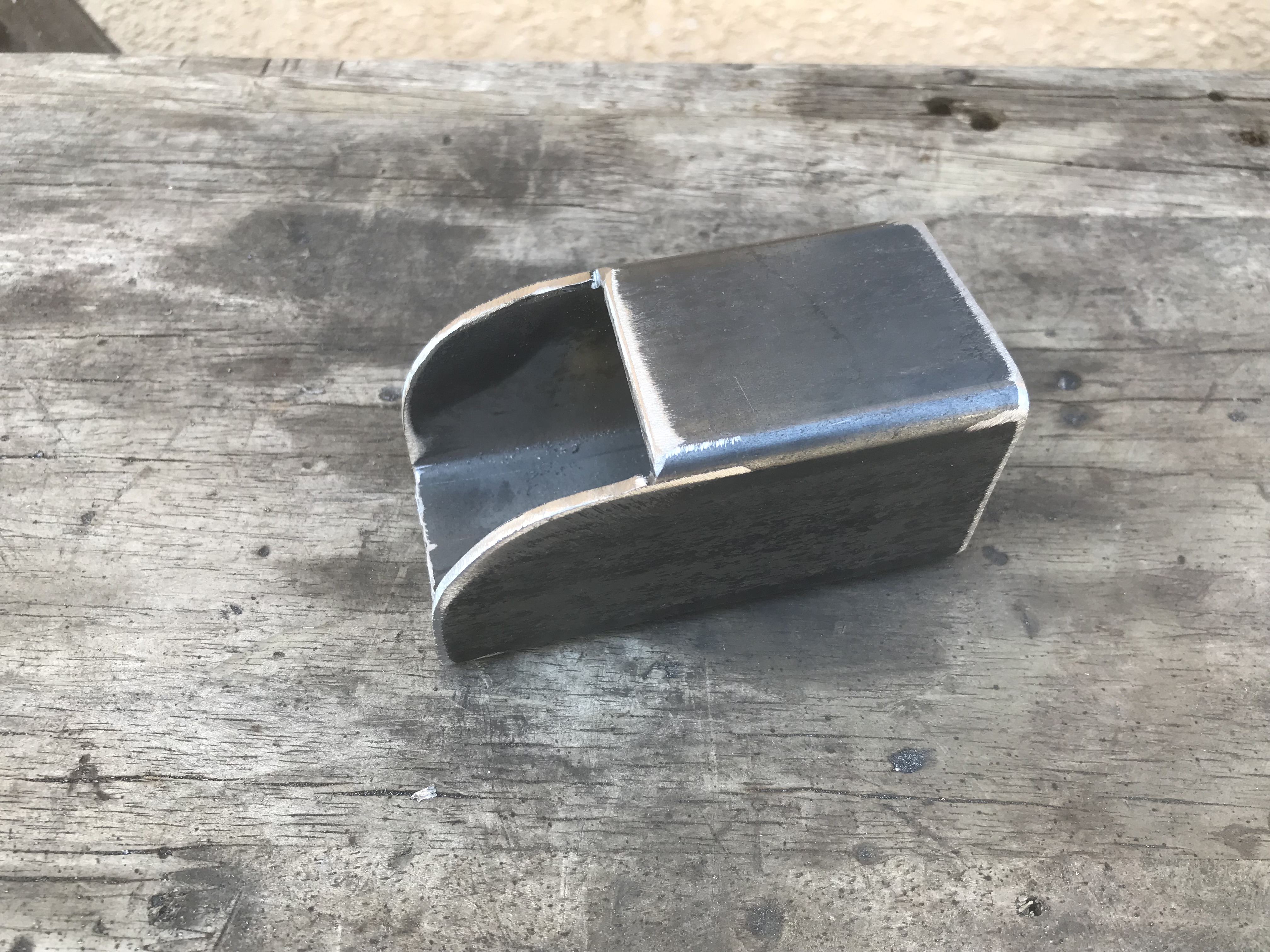

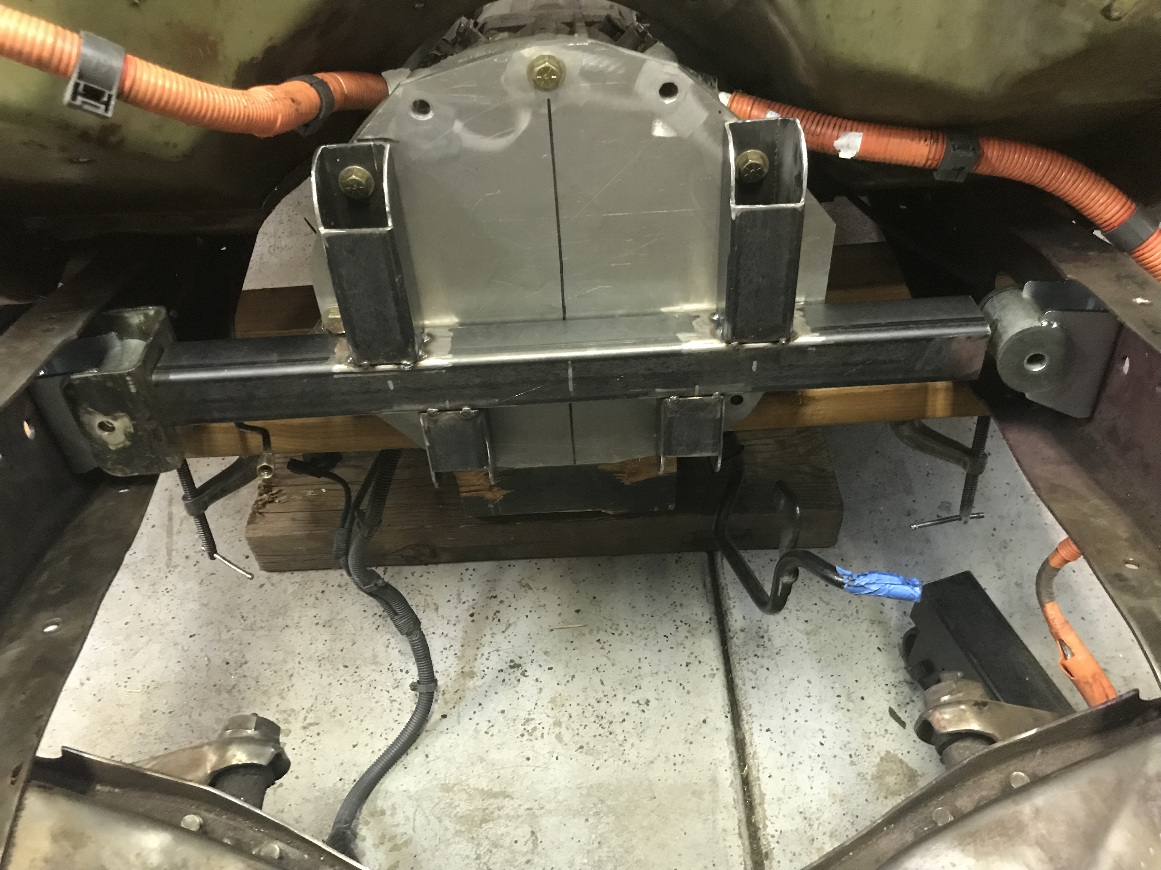

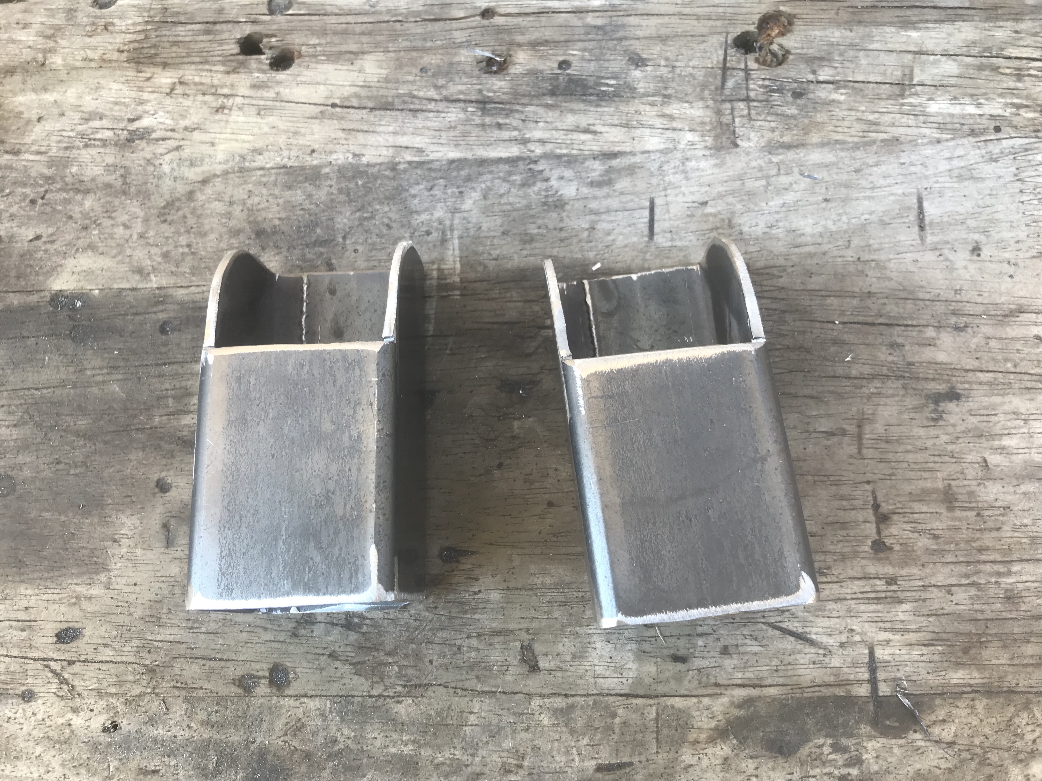

so this is what we are going for at the ends, sort of a clam shell design
Gregski
Posts: 3160
Post by Gregski »

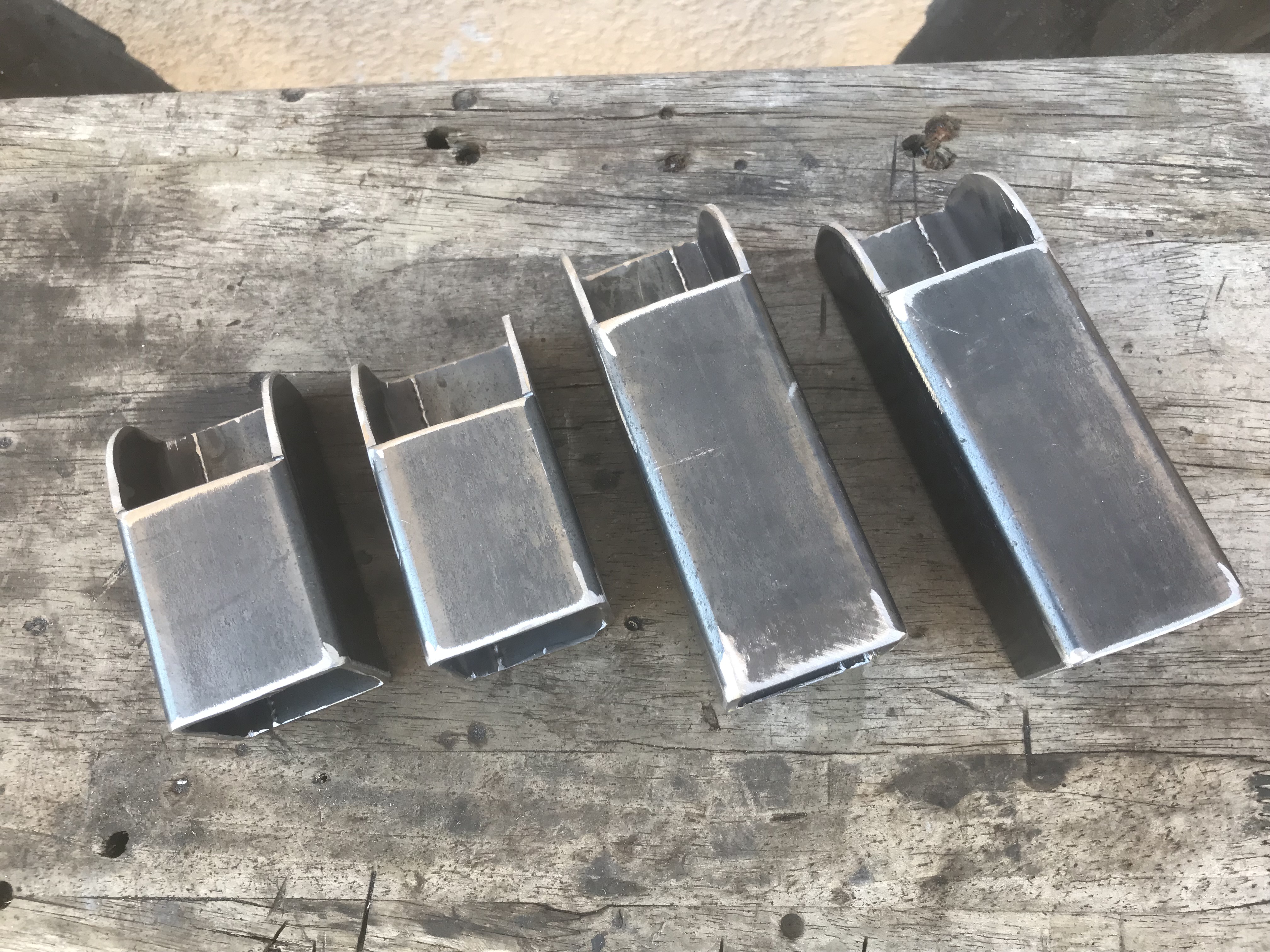

here is what one side will look like, still needs some trimming, nipping, and tucking but you git the idear
Gregski
Posts: 3160
Post by Gregski »
and the mandatory stare and compare from 5 feet back, whilst sippin on a cold one, [noddin' yer head, like yeah I made that]

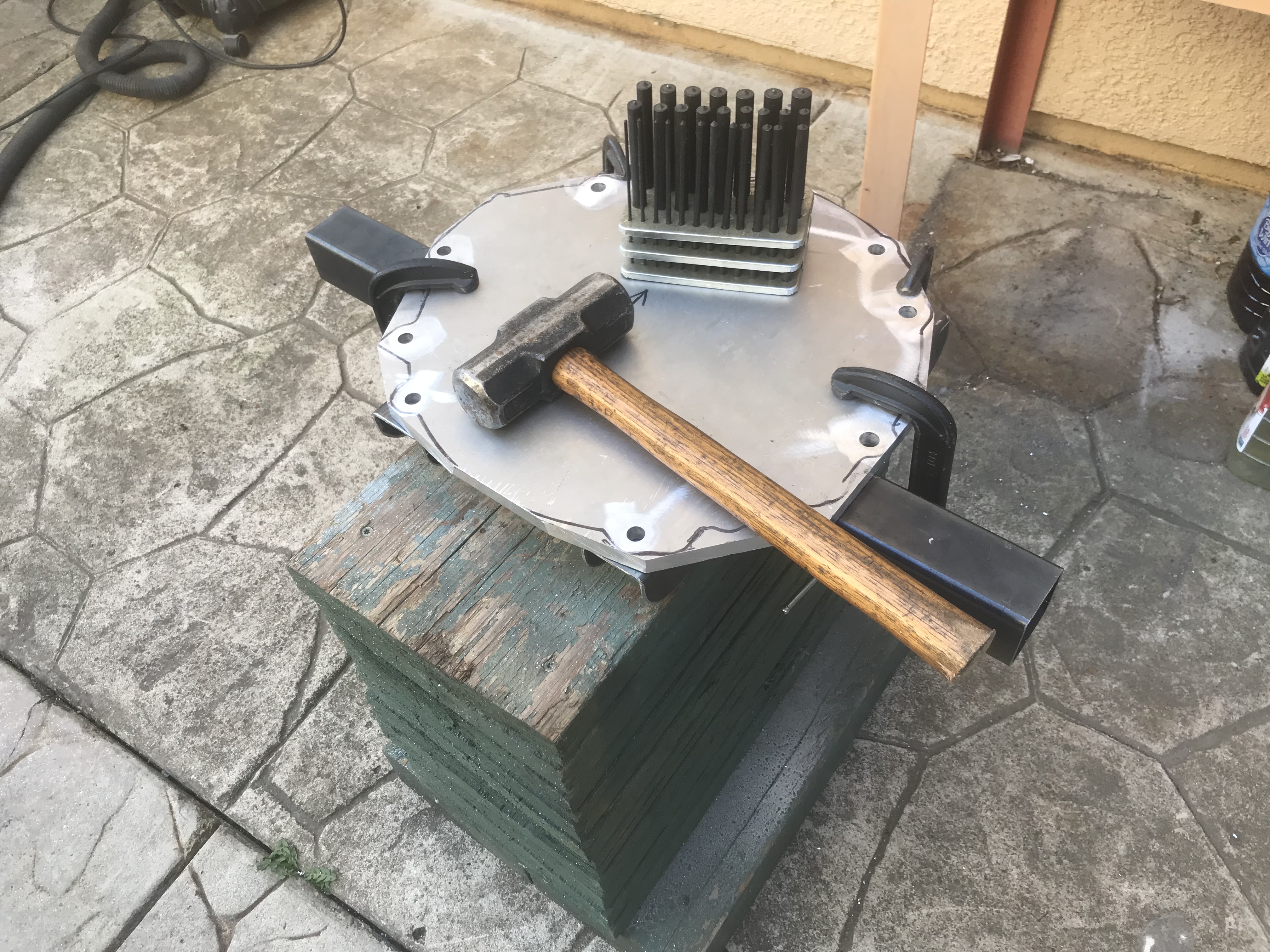

Post by Gregski »
so let's crack on

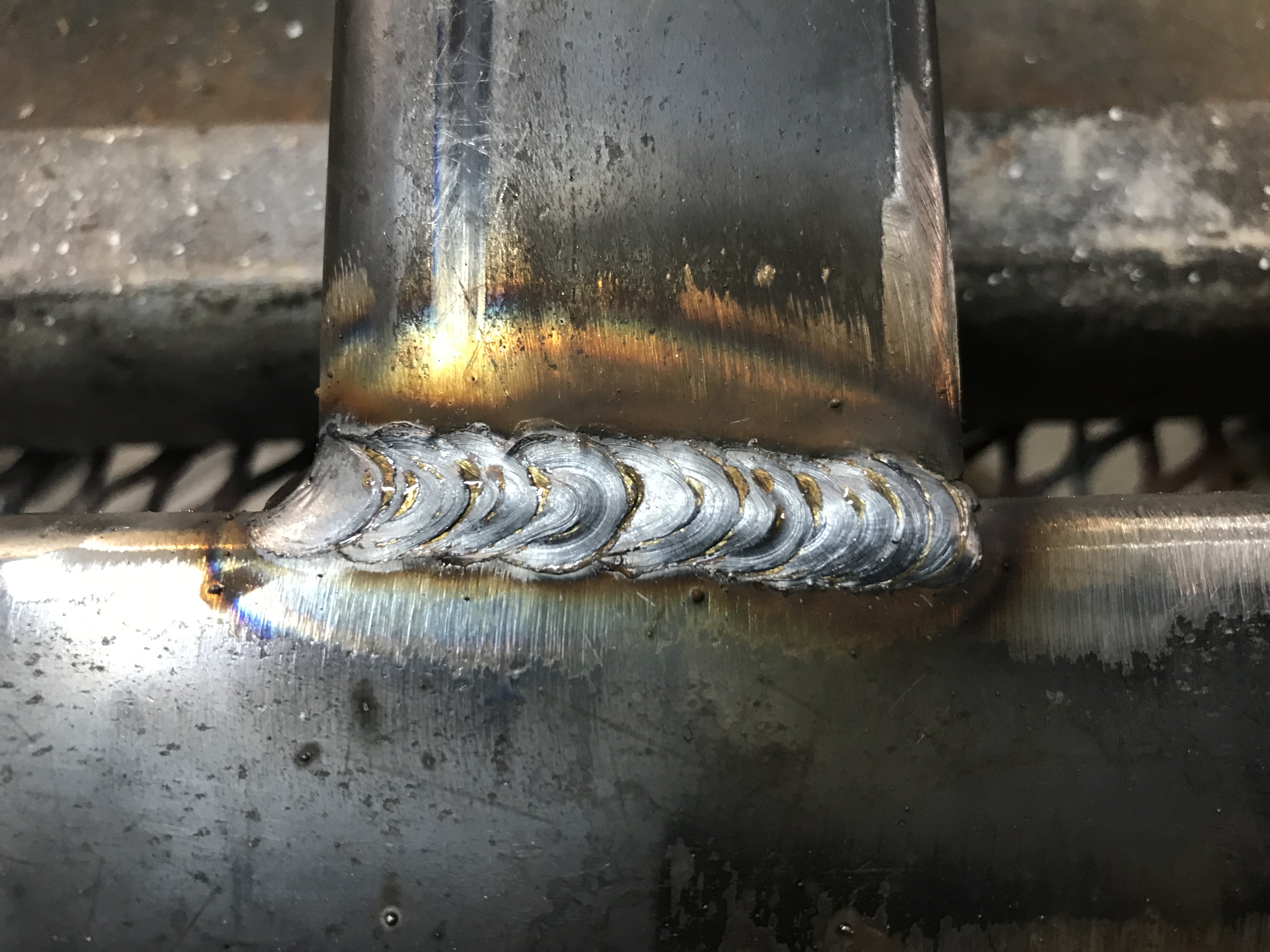

here's me doing the wax on wax off for what I hoped to be the 900th and final, (and I mean it this time) final time before a weldin'
Gregski
Posts: 3160

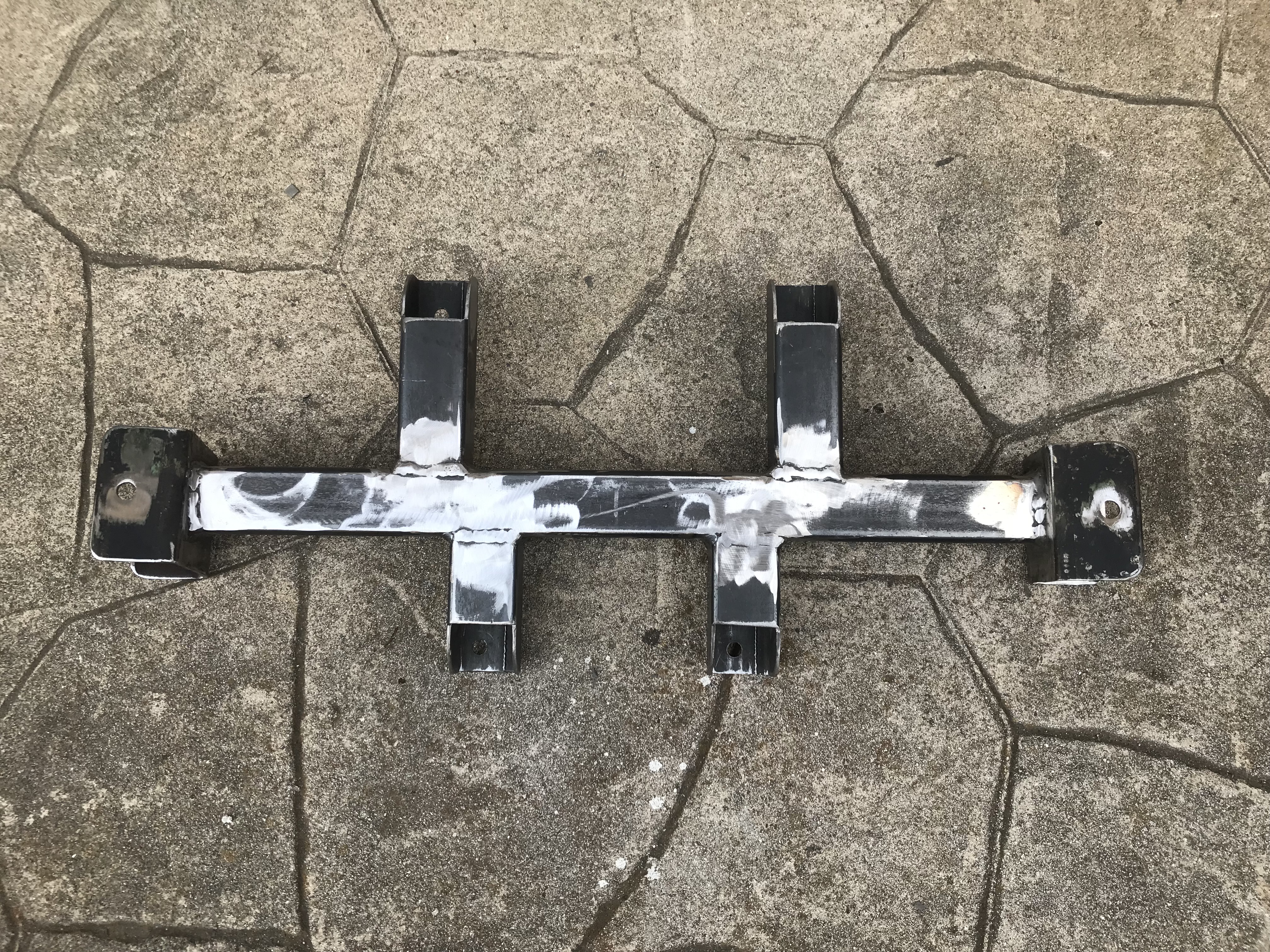

Post by Gregski »
layin' down them dimes, [well, and nickels, some pennies, but mostly dimes...]
and it's totally straight if you turn your head to the side a little bit... ok, a little bit more
Gregski
Posts: 3160

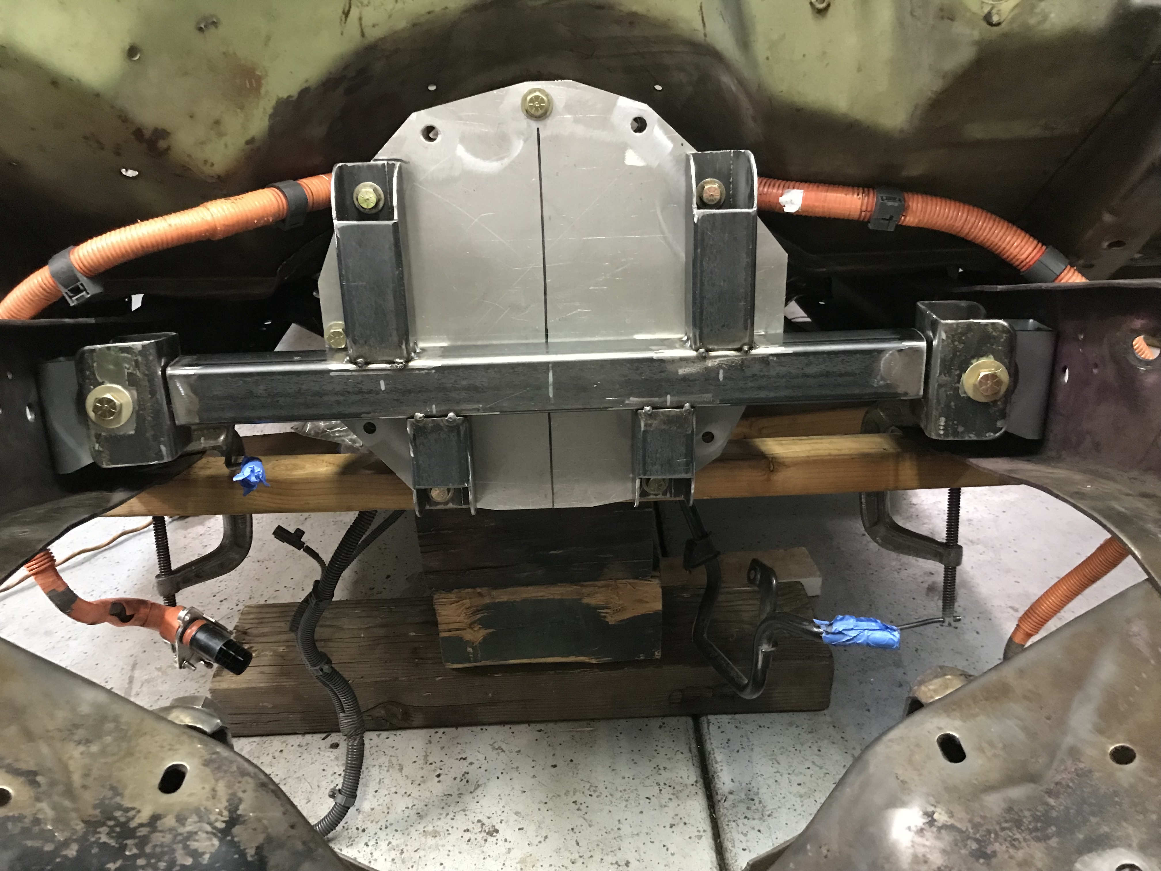

Post by Gregski »
you know what they say: "Grinder 'n Paint make me the welder I aint!"
seriously though, the back side had to be ground flat to mate with the trans bell housing plate, feel me?
the front was ground to hide the crappy welds!

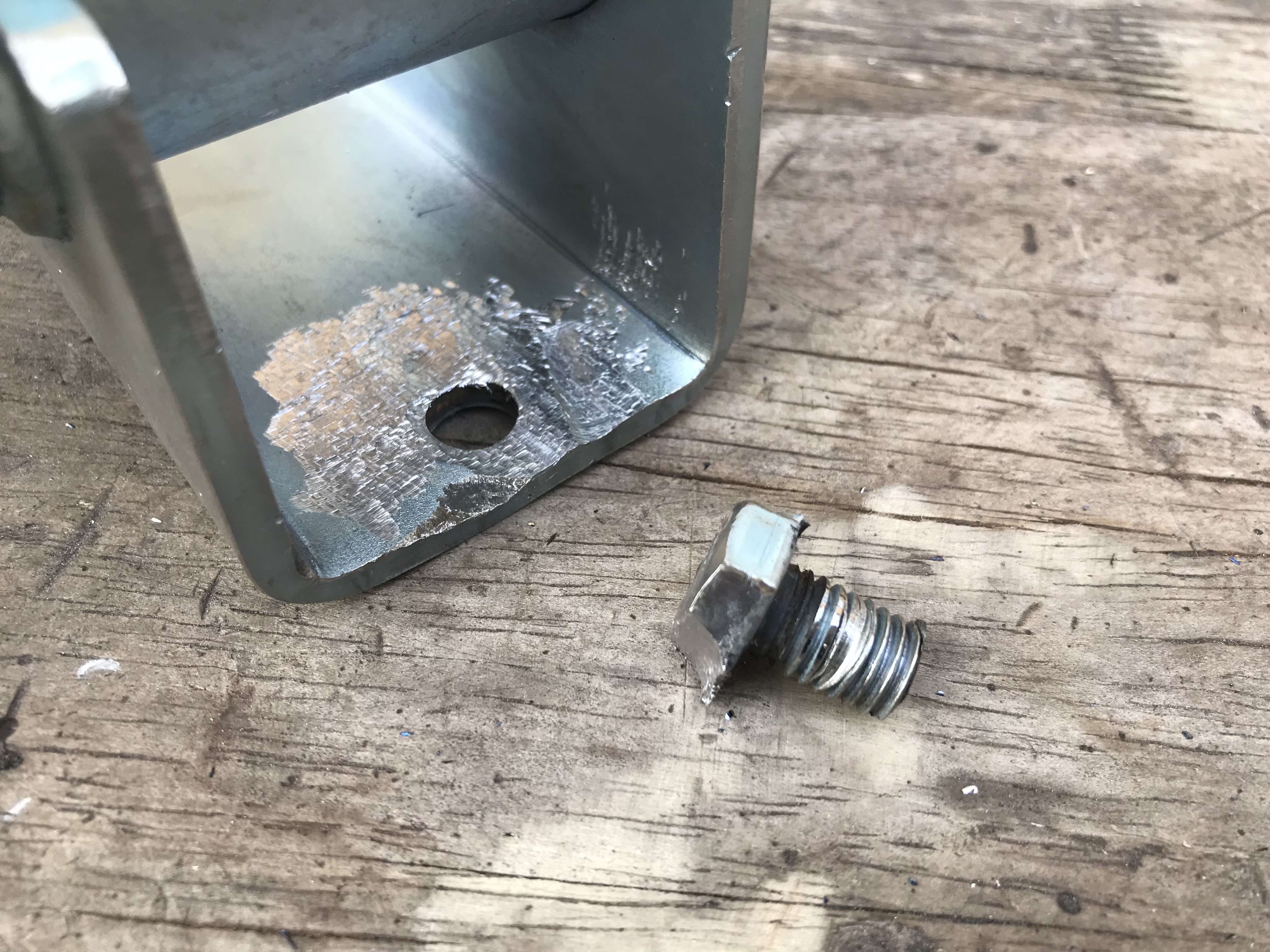

Gregski
Posts: 3160

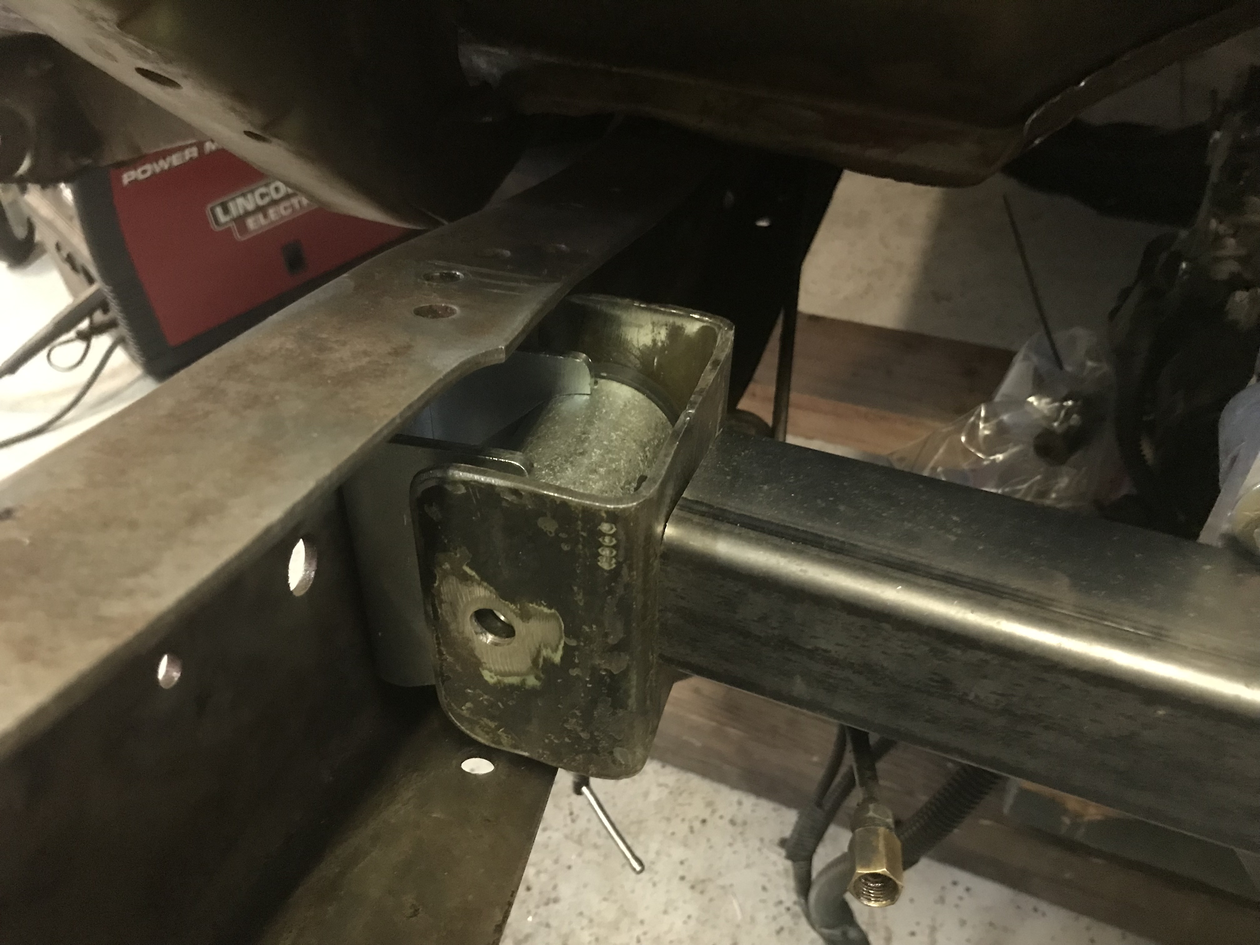

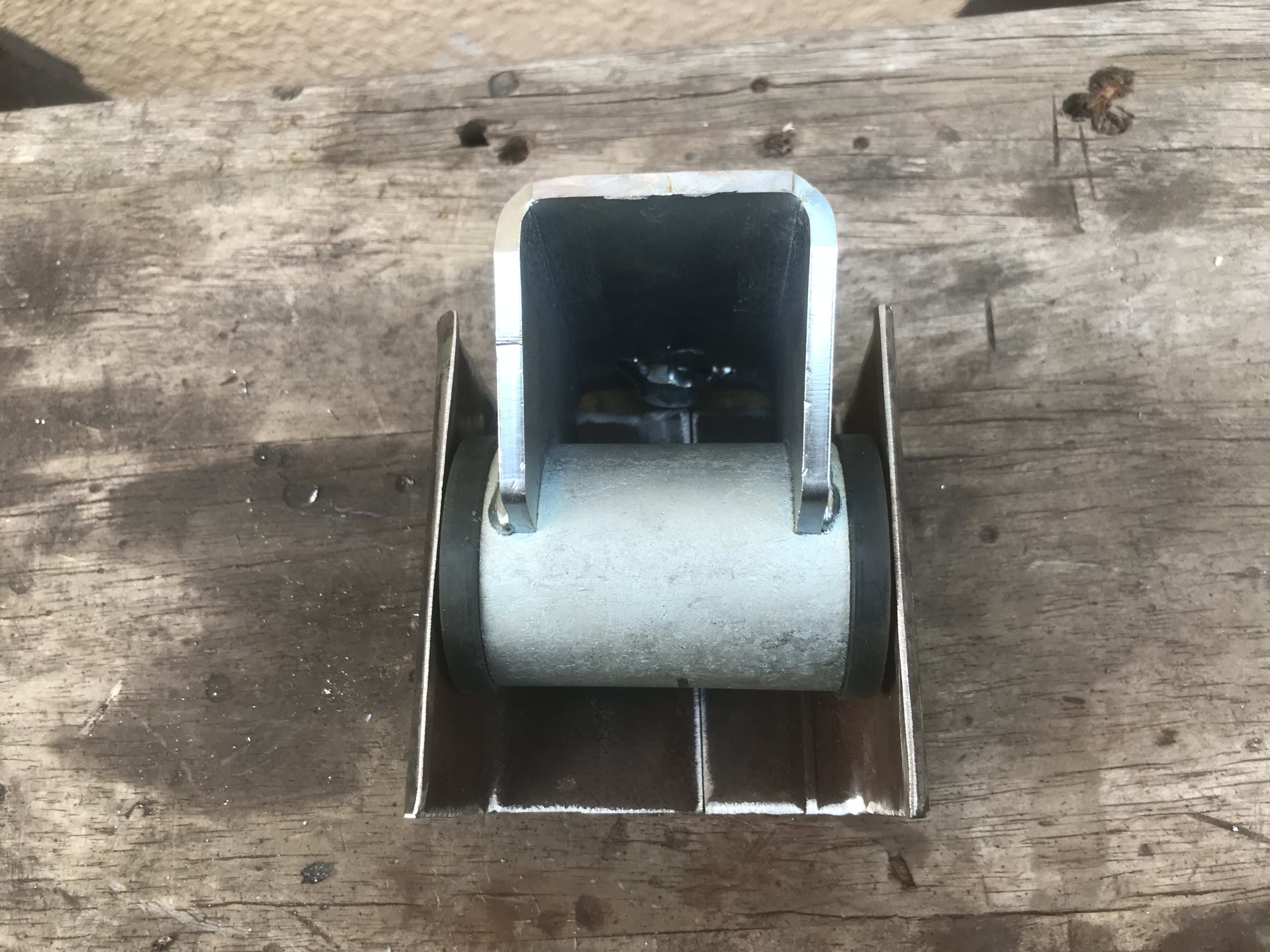

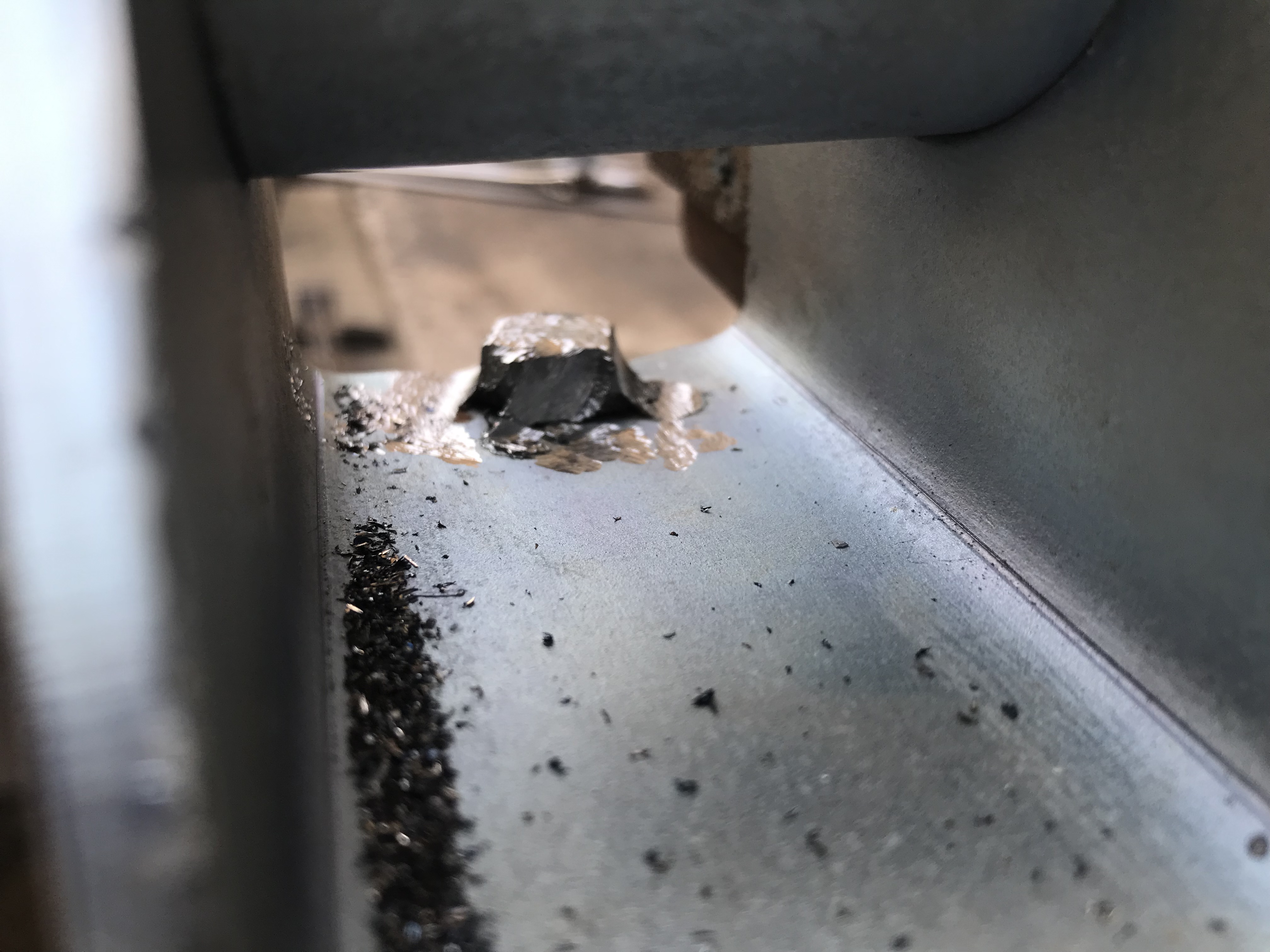

Post by Gregski »

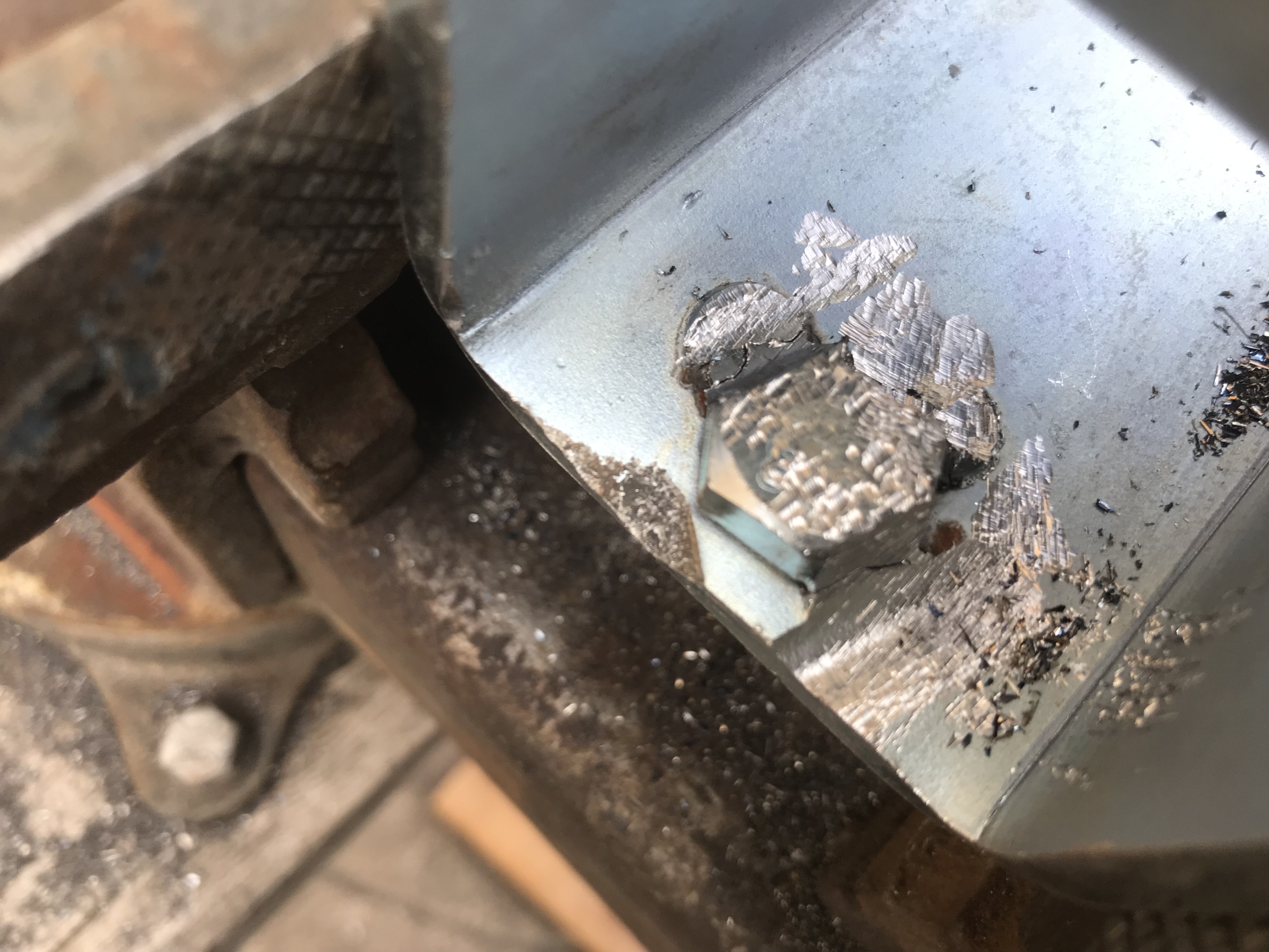

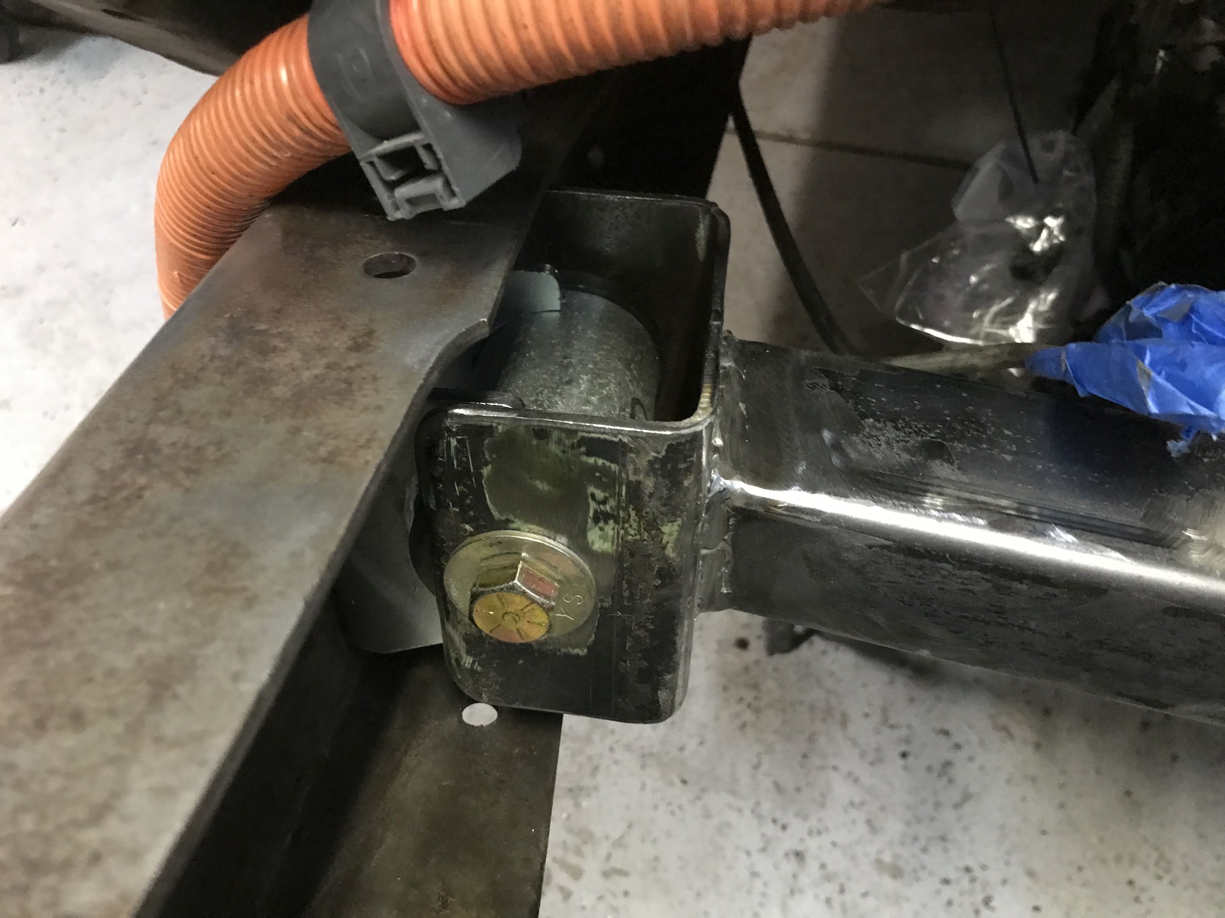

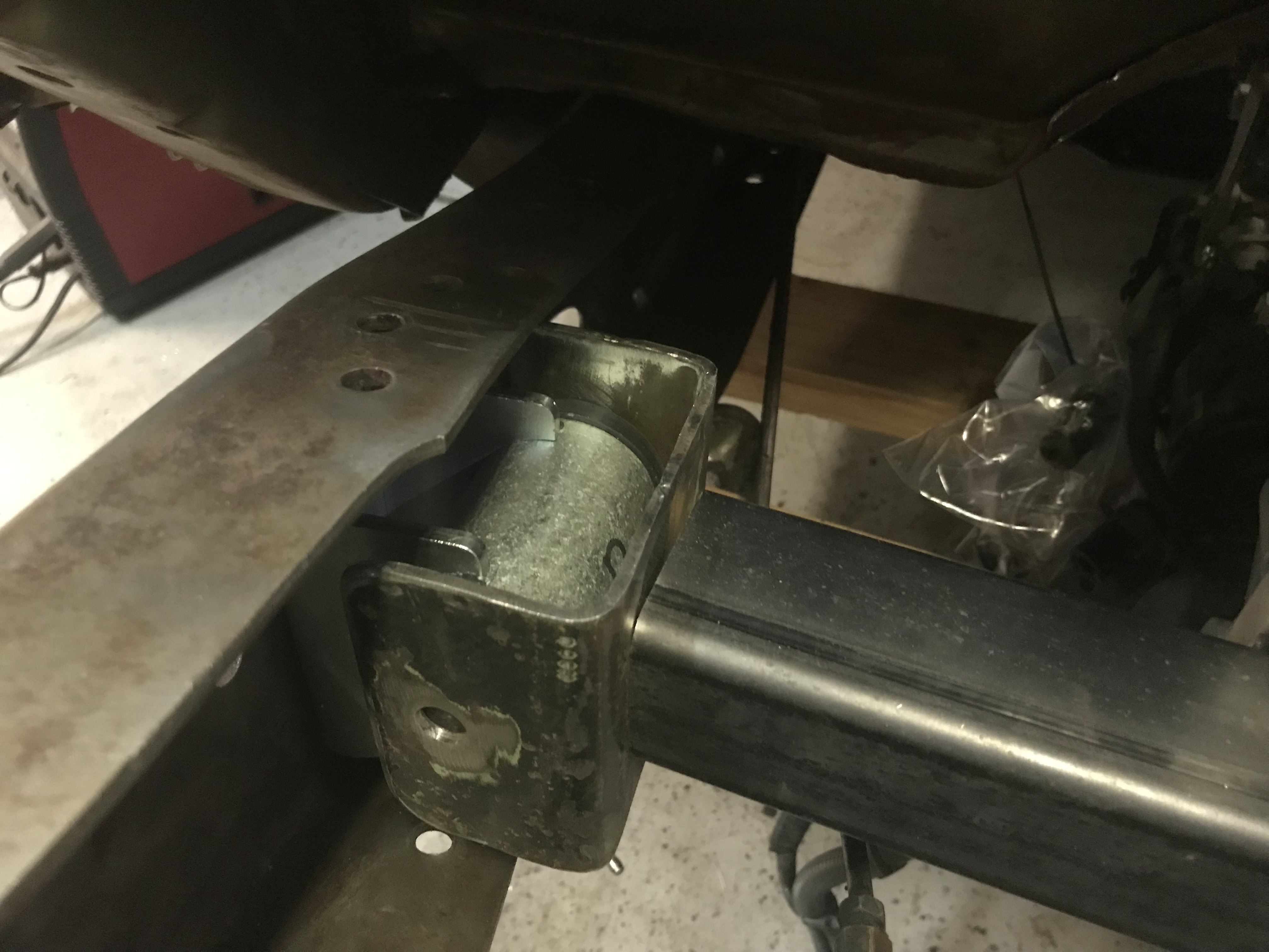

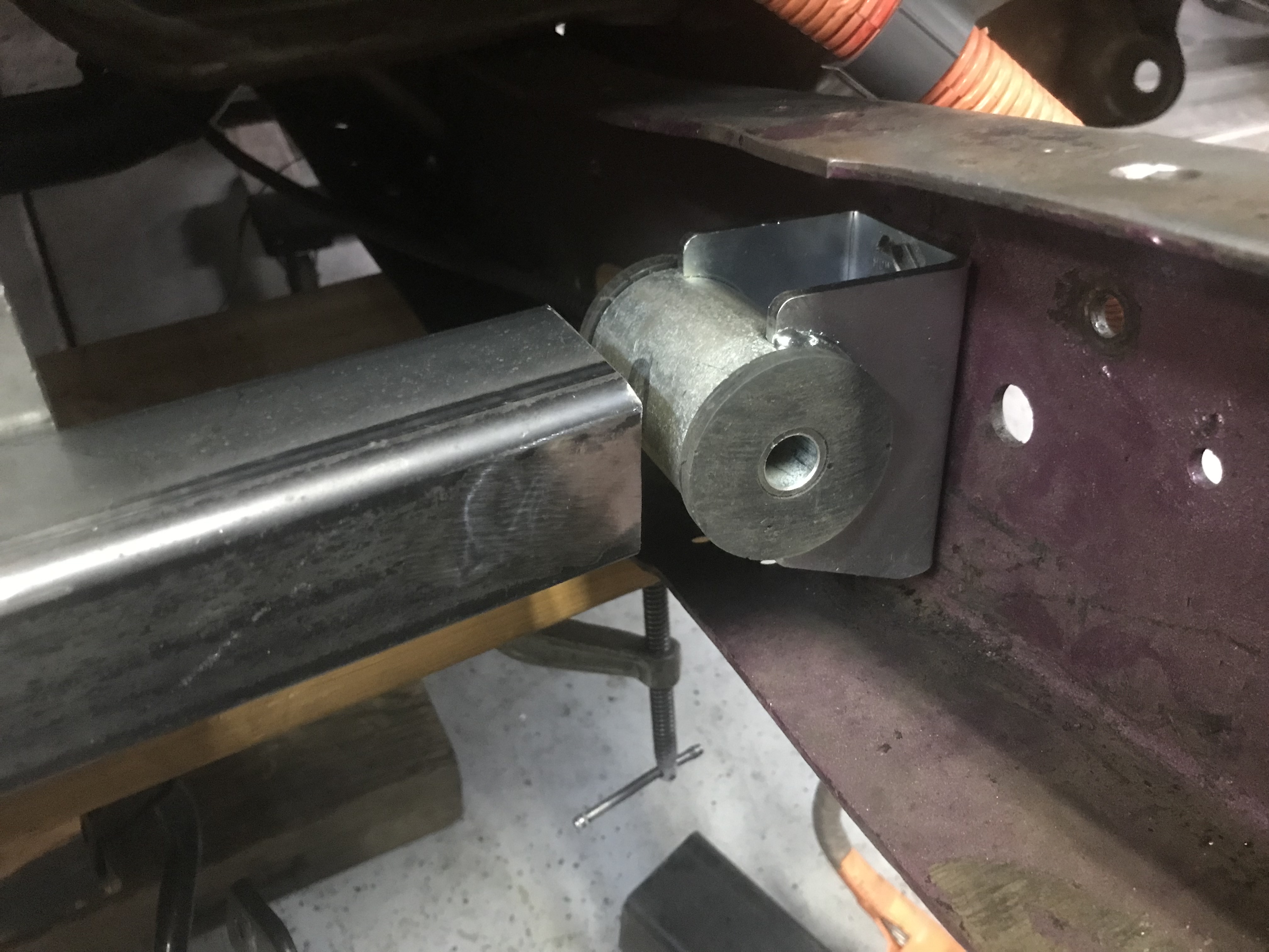

well dem ISOFORMA USA Amazon vendor peeps did us no favors weldering that stud aka bolt in there like that for us, shhh don't tell but gosh darn it was impossible to extract this contraption in it's current native state, so these bolts had to be liberated, thank you for using cheap easy to grind grade 5 hardware
and don't we all just luv buying new parts, just so that we have to modify 'em!

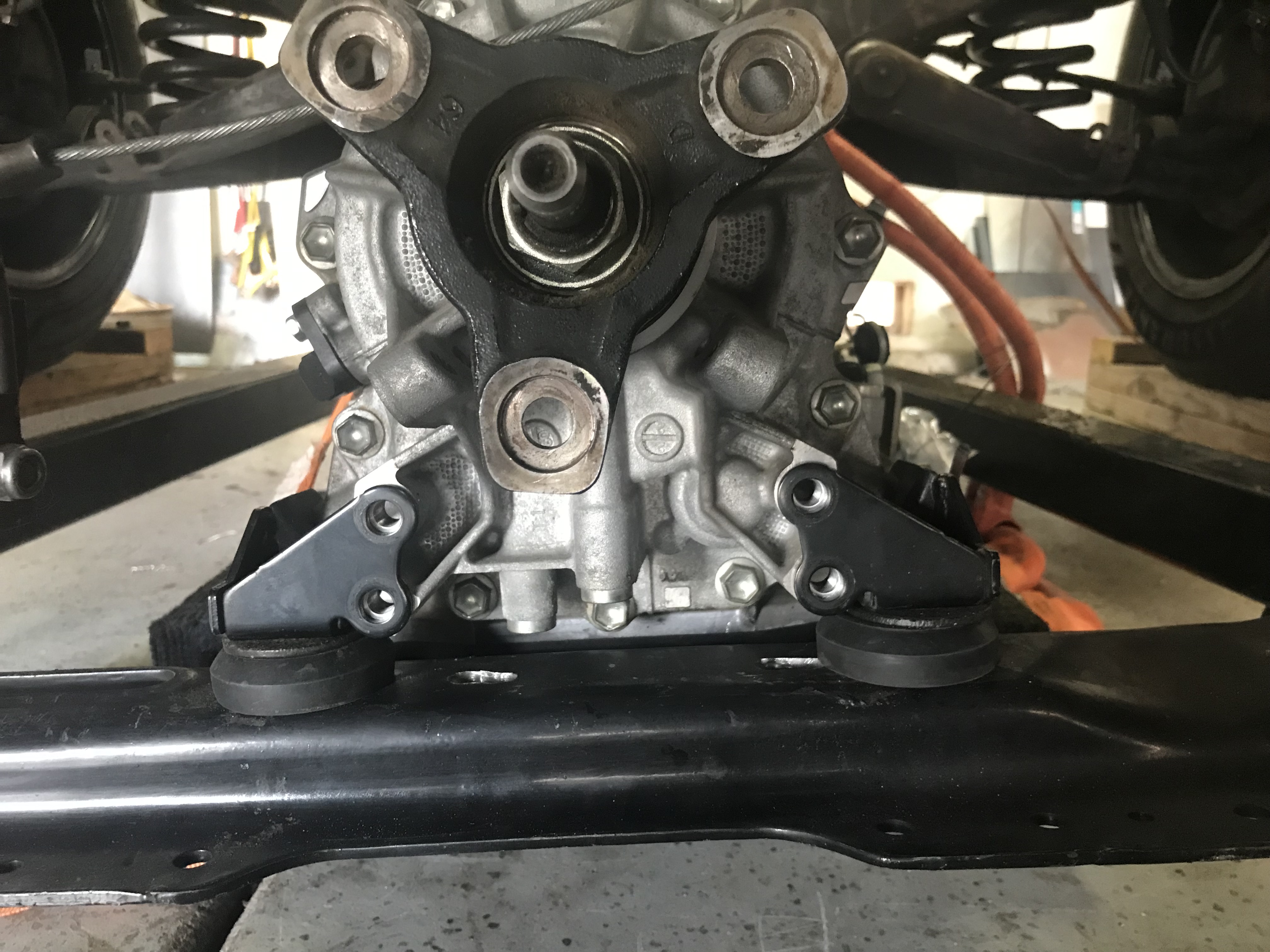

Gregski
Posts: 3160

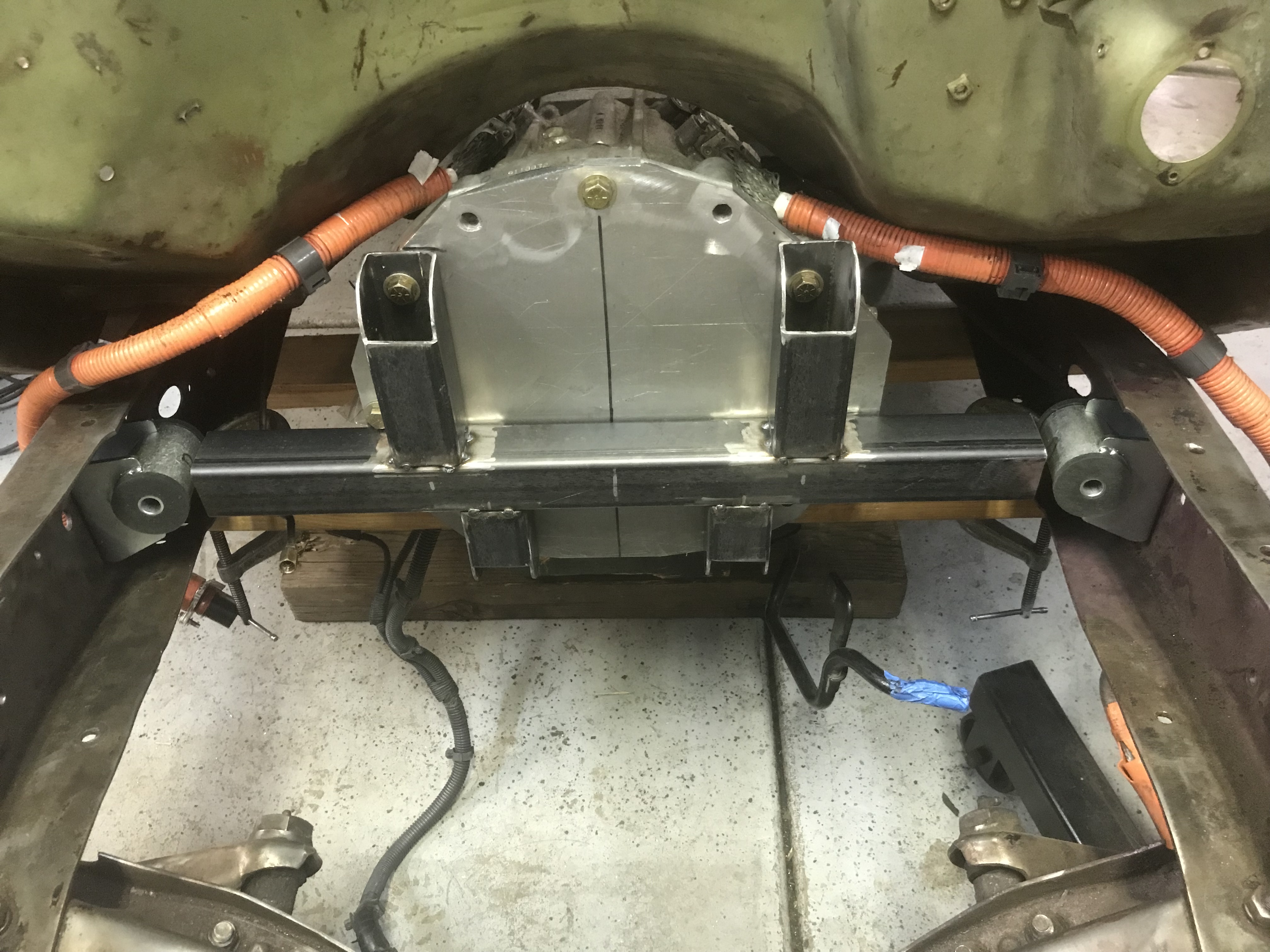

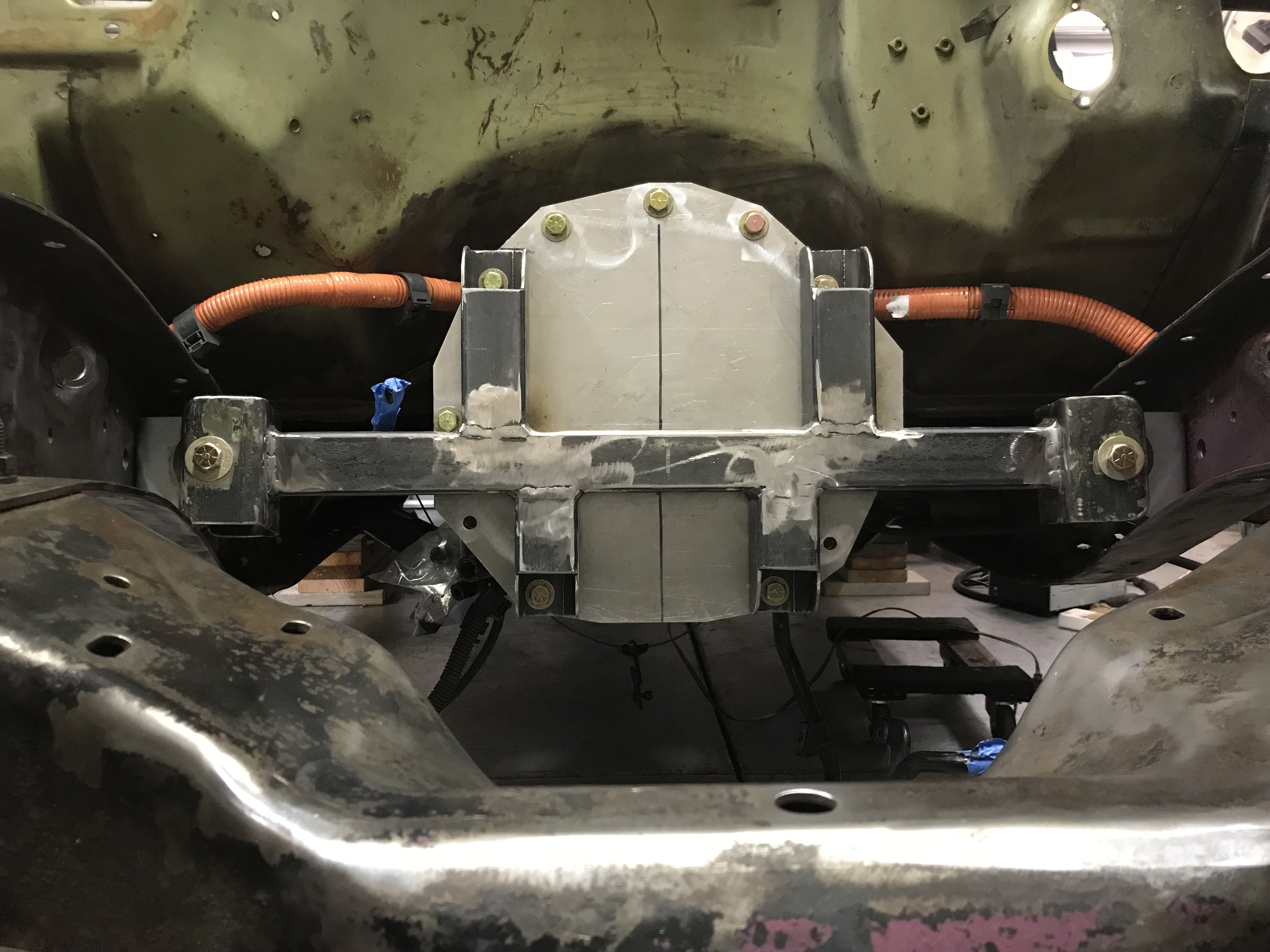

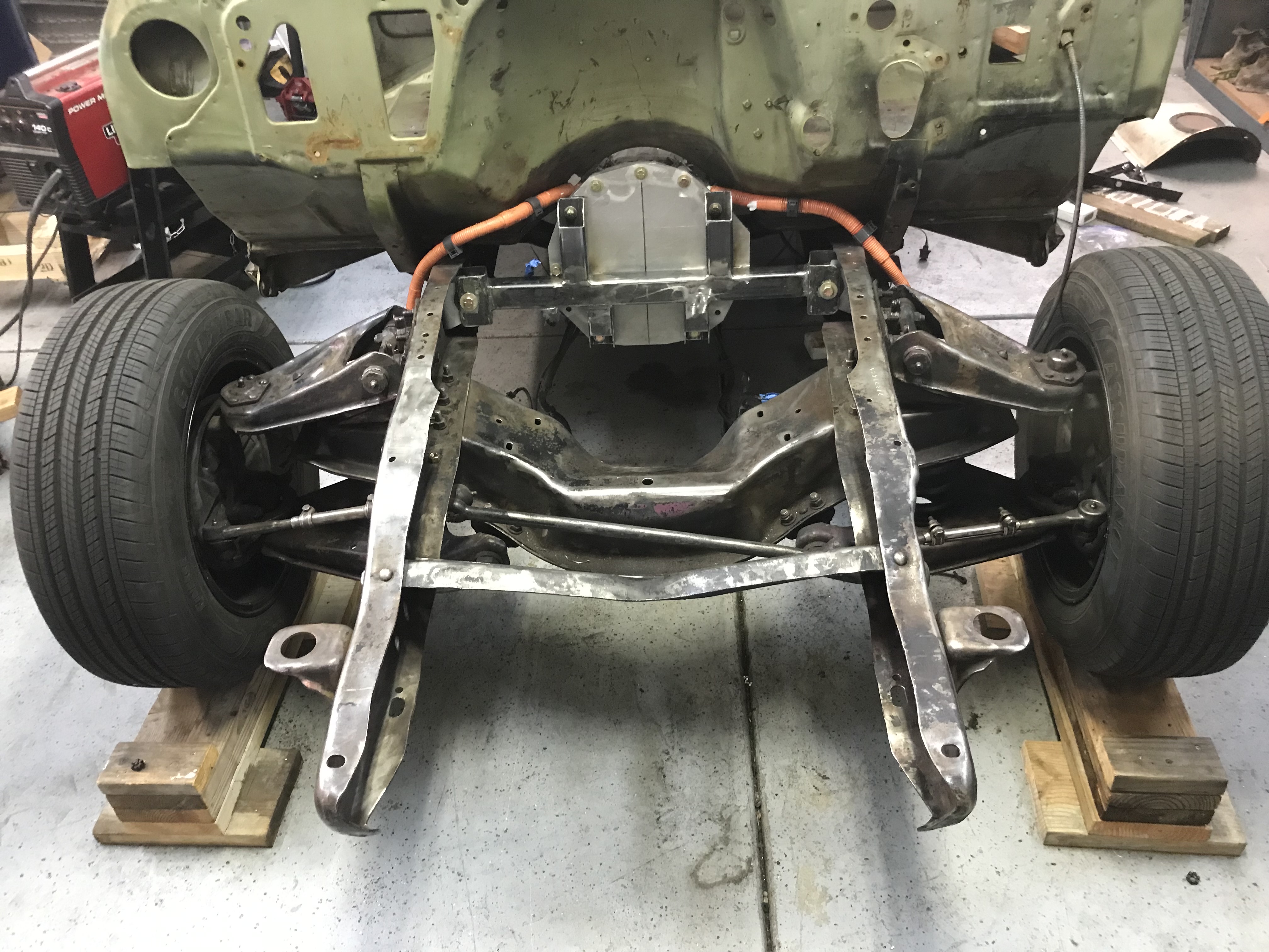

Post by Gregski »
alright there it is, the transmission supported by a custom rubber mounted bracket, I won't lie it was a massive amount of work, but I am very pleased with the result - whacha all think? be gentle I have very thin skin (that's why I post on the Internets, ha ha)
