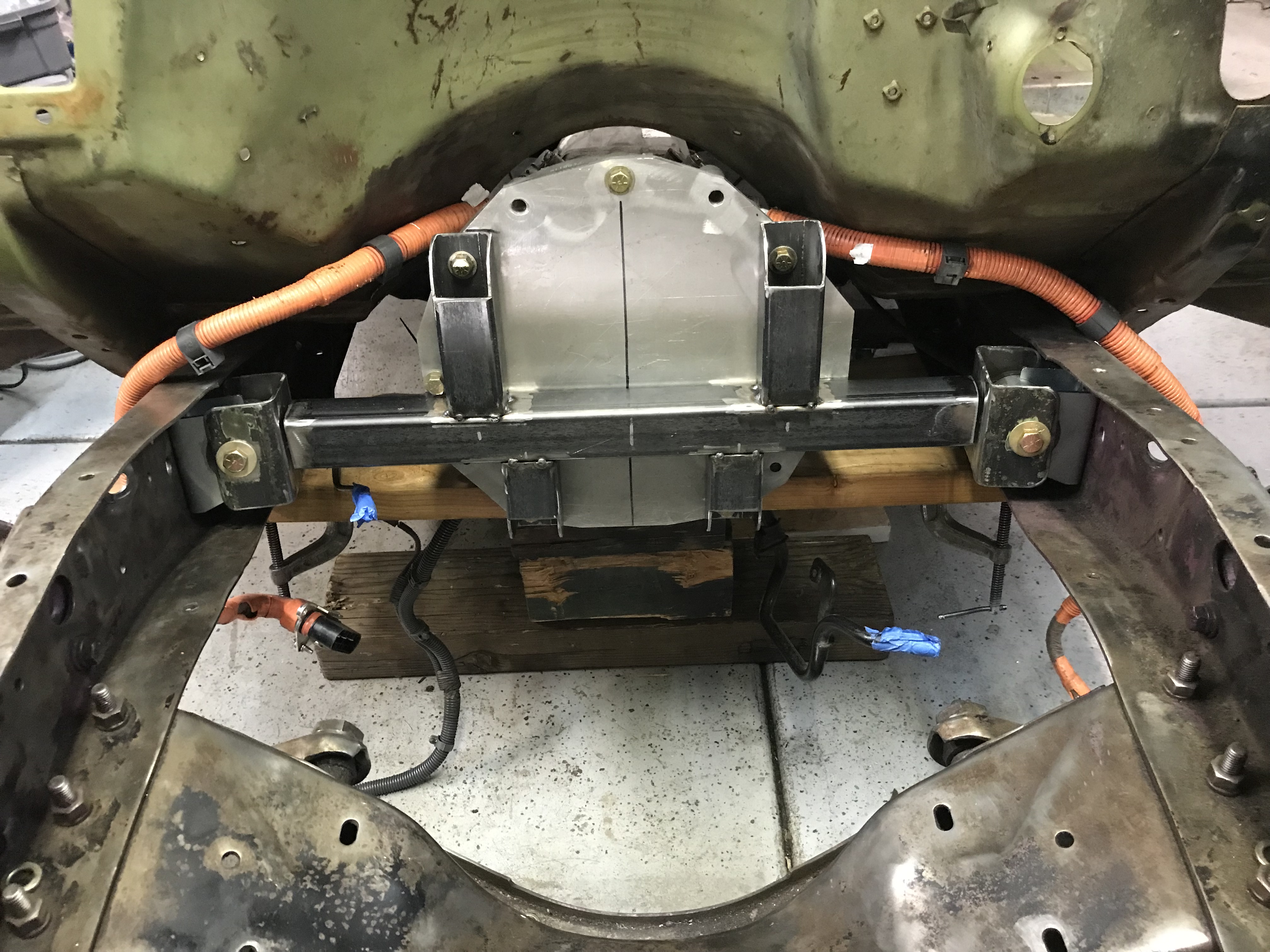

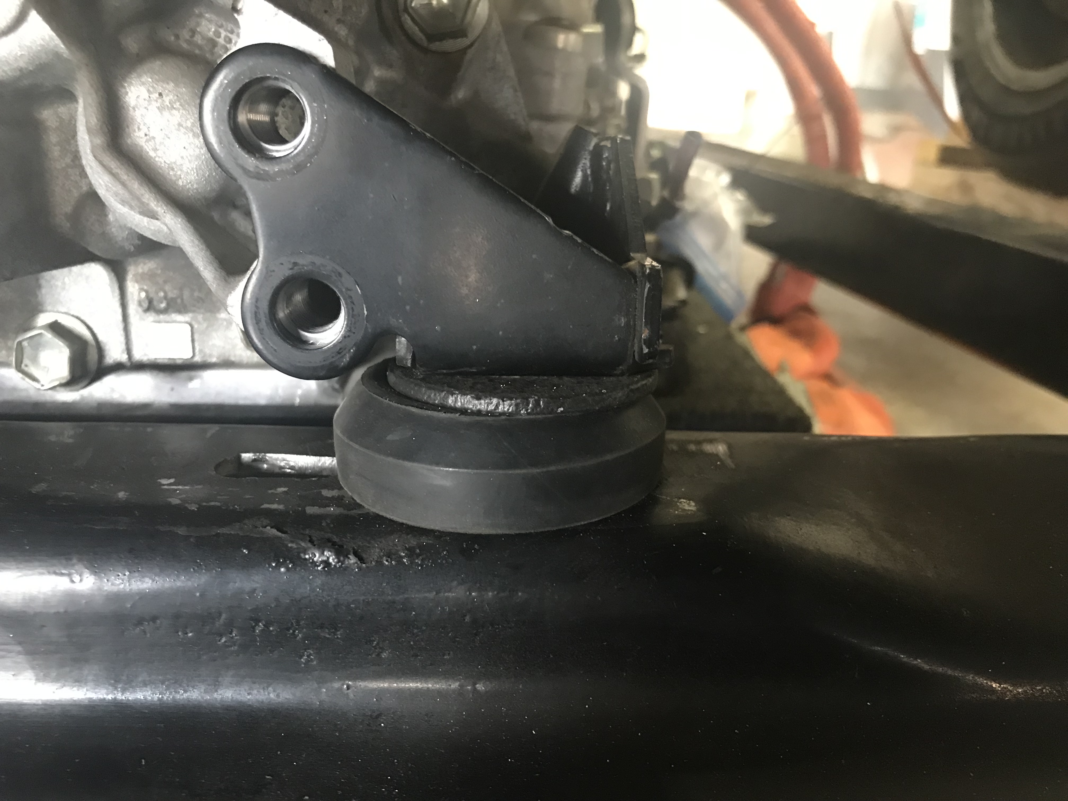

having eliminated the original crossmember that held the Turbo TH350 transomatic in place in the first place, I moved on to one with some drop, using rubber feets from my stock radiator core support (run what you brong!)

mounting the transmission is by far the biggest job on this project

Post by Gregski »
I'm going with these Jeep like AMAZON motor mounts, figuring if they was strong enuff to hold an engine they ought to hold a transmission
now hang on to your comments as this is all just spit ballin' mock up, and that frame's got more twist and turns than you know it

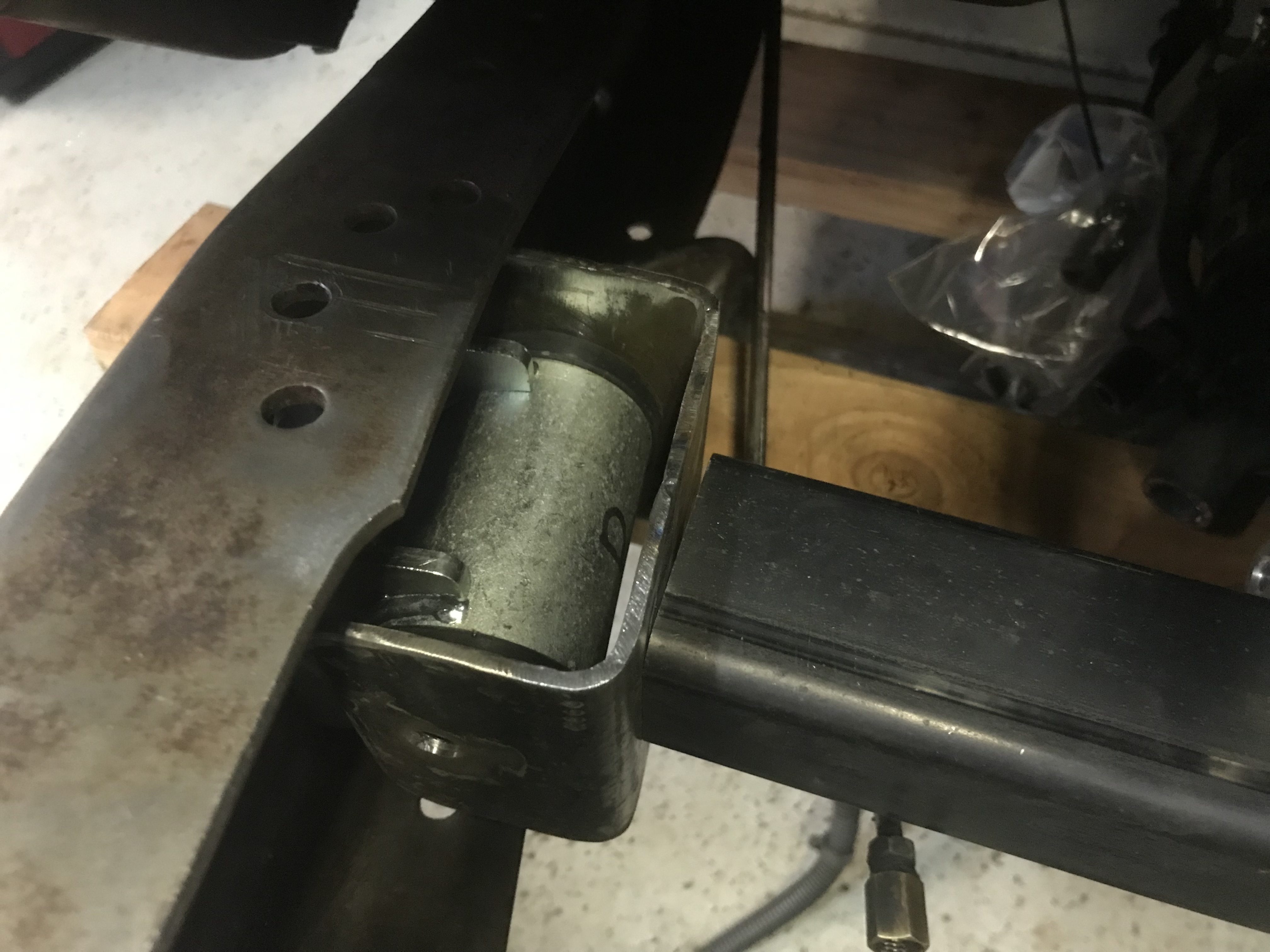

so this is what we are going for at the ends, sort of a clam shell design
Gregski
Posts: 2753
Has thanked: 505 times
Been thanked: 957 times
Post by Gregski »
here is what one side will look like, still needs some trimming, nipping, and tucking but you git the idear

Post by Gregski »
layin' down them dimes, [well, and nickels, some pennies, but mostly dimes...]
and it's totally straight if you turn your head to the side a little bit... ok, a little bit more
Gregski
Posts: 2753
Post by Gregski »
you know what they say: "Grinder 'n Paint make me the welder I aint!"
seriously though, the back side had to be ground flat to mate with the trans bell housing plate, feel me?
the front was ground to hide the crappy welds!

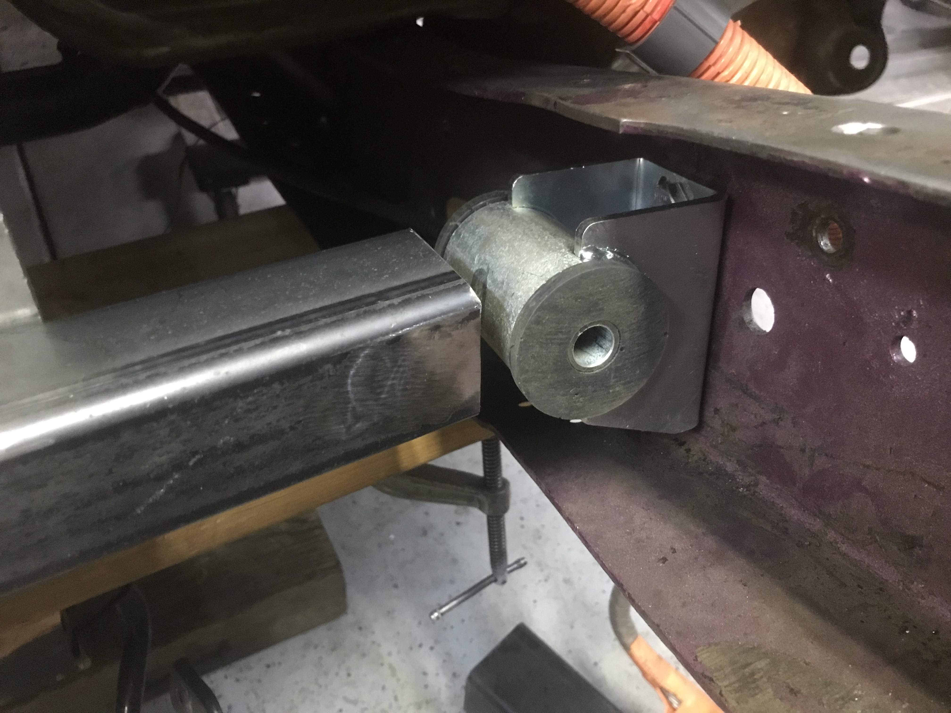

Post by Gregski »
well dem ISOFORMA USA Amazon vendor peeps did us no favors weldering that stud aka bolt in there like that for us, shhh don't tell but gosh darn it was impossible to extract this contraption in it's current native state, so these bolts had to be liberated, thank you for using cheap easy to grind grade 5 hardware
and don't we all just luv buying new parts, just so that we have to modify 'em!
Gregski
Posts: 2753
Post by Gregski »
alright there it is, the transmission supported by a custom rubber mounted bracket, I won't lie it was a massive amount of work, but I am very pleased with the result - whacha all think? be gentle I have very thin skin (that's why I post on the Internets, ha ha)
