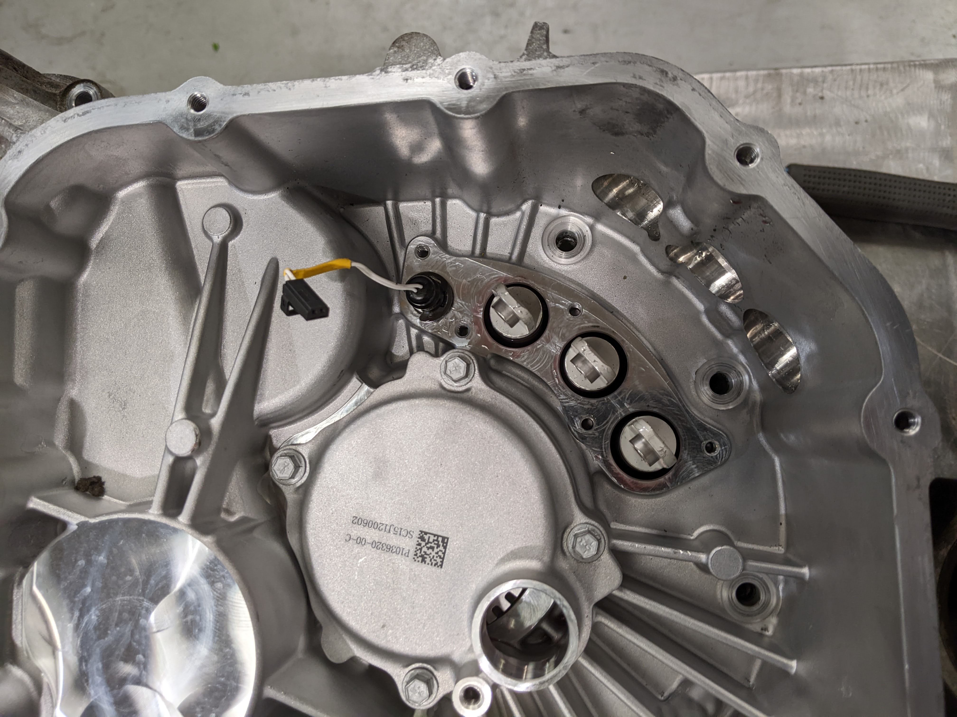

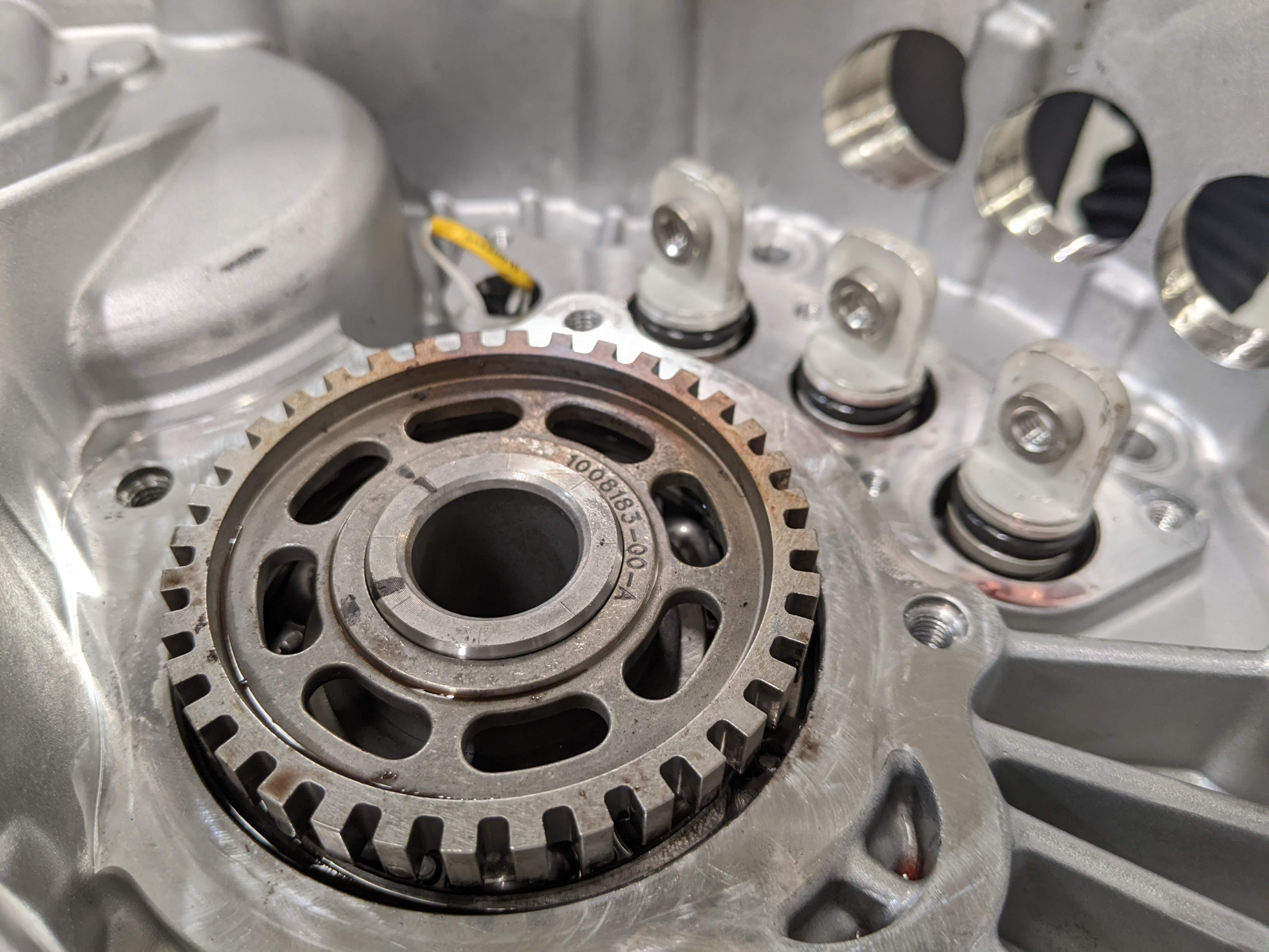

Do we have a picture of how that wheel is fitted?
That's indeed not allot.

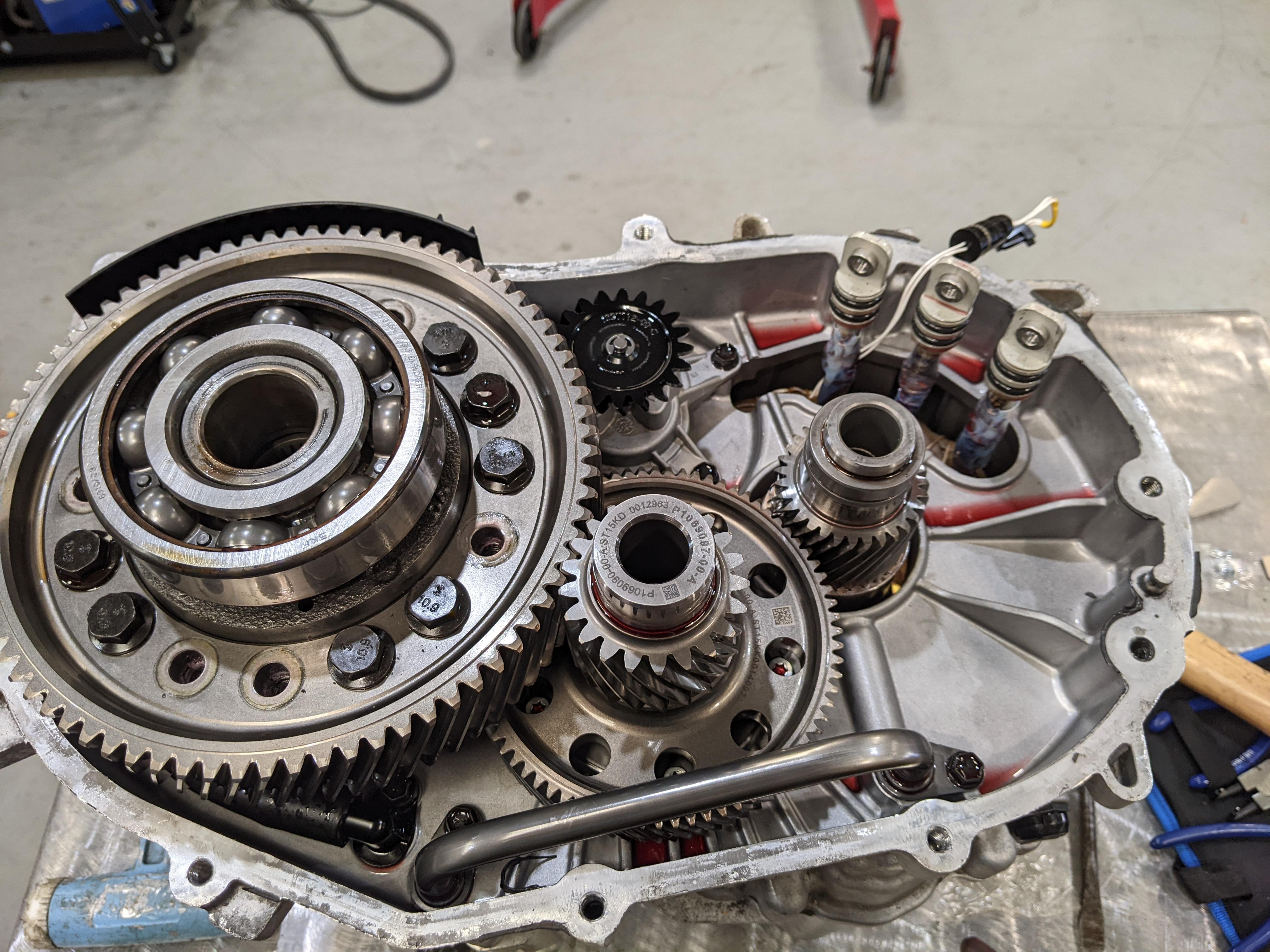

EV_Builder wrote: Sun Apr 17, 2022 5:16 pm Do we have a picture of how that wheel is fitted?
It's literally just pushed onto the end of the motor shaft. Here's a teardown of mine.
