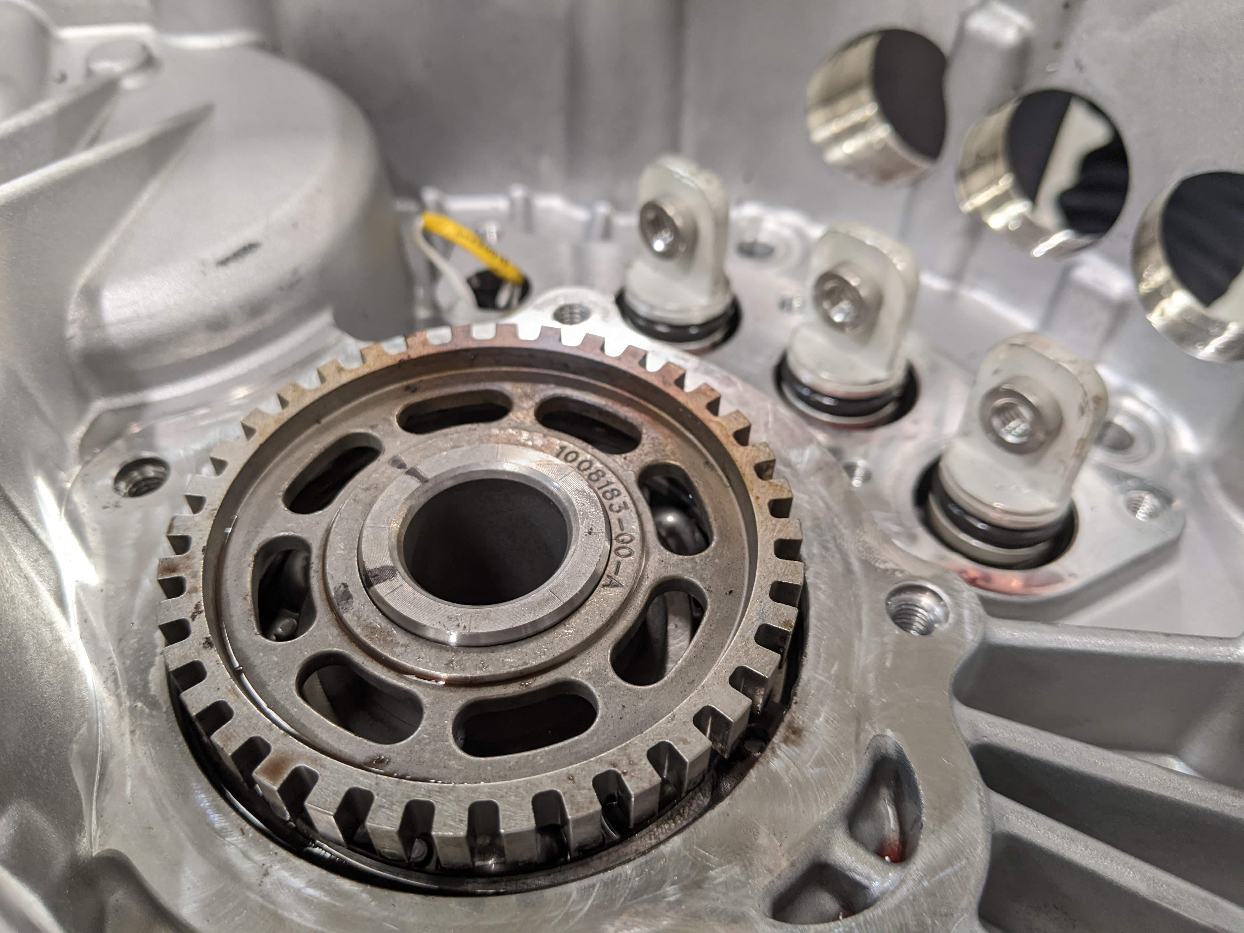

See https://openinverter.org/parameters/view.html?id=15
This confirms that the SDU encoder it's 36 PPR. This isn't great but it's definitely enough, depending on how you process it. Unfortunately my previous experience was with a *600* PPR encoder, so I'm having to put a lot of thought into how to properly use this instead.
I will go ahead and look at adapting my code to vary slip with throttle, but decouple voltage a bit.
I strongly suspect that what I end up with at that point will basically be what Johannes did!
My main desire is to get rid of the idea of an fslipmin and just make it completely linear.

Do we have a picture of how that wheel is fitted?
That's indeed not allot.

It's literally just pushed onto the end of the motor shaft. Here's a teardown of mine.

You could map the throttle to it.
It's how a basic VFD ramps. With a acc. of x Hz/sec increment.
When above 300rpm's we blend in slip control.
So 100% Throttle becomes x amount of maximum slip.
P.D. if I'm right it's a openloop control method.
My implementation is both V/Hz and "slip control". The throttle controls slip. Voltage is then set according to the total output frequency.
The only thing I've not yet added is "boost". The intent there will be to add a fixed voltage proportional to throttle, regardless of frequency.
- catphish
- Posts: 961
- Location: Dorset, UK
- Has thanked: 98 times
- Been thanked: 195 times
Re: Induction motor control strategy
I think it'll be nothing short of a miracle if my code work fine. This is (right now) nothing more than an idea. The fact that it's so simple suggests that it will certainly require some tweaking before it has any chance of working well, but it's a good way for me to learn and share ideas.
- EV_Builder
- Posts: 1205
- Location: The Netherlands
- Been thanked: 37 times
Slip control I call that you measure rotor speed and depend Hz setpoint on that plus requested torque. The more requested torque the more you add. That will induce current because the motor tries to follow (maybe combined with V increase??).
But below a certain speed I would fallback on sensorless control.
