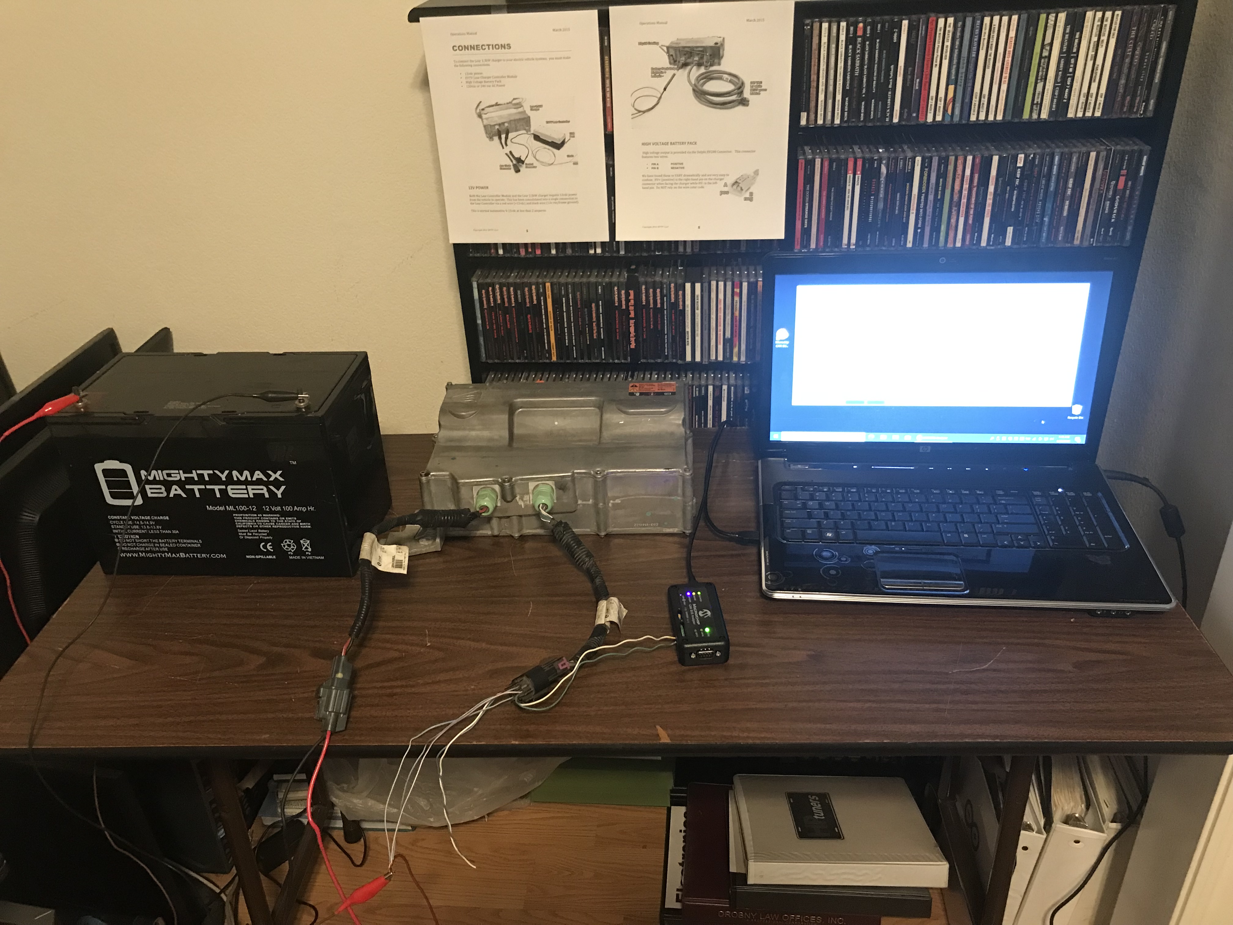

and just like that we were back to where we left off, but with a different CAN Bus analyzer tool, hopefully a more better one (at least this one has a manual)

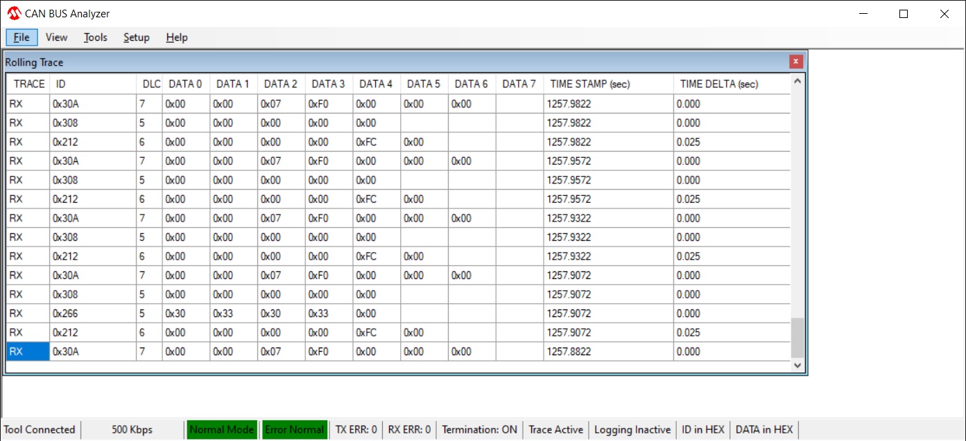

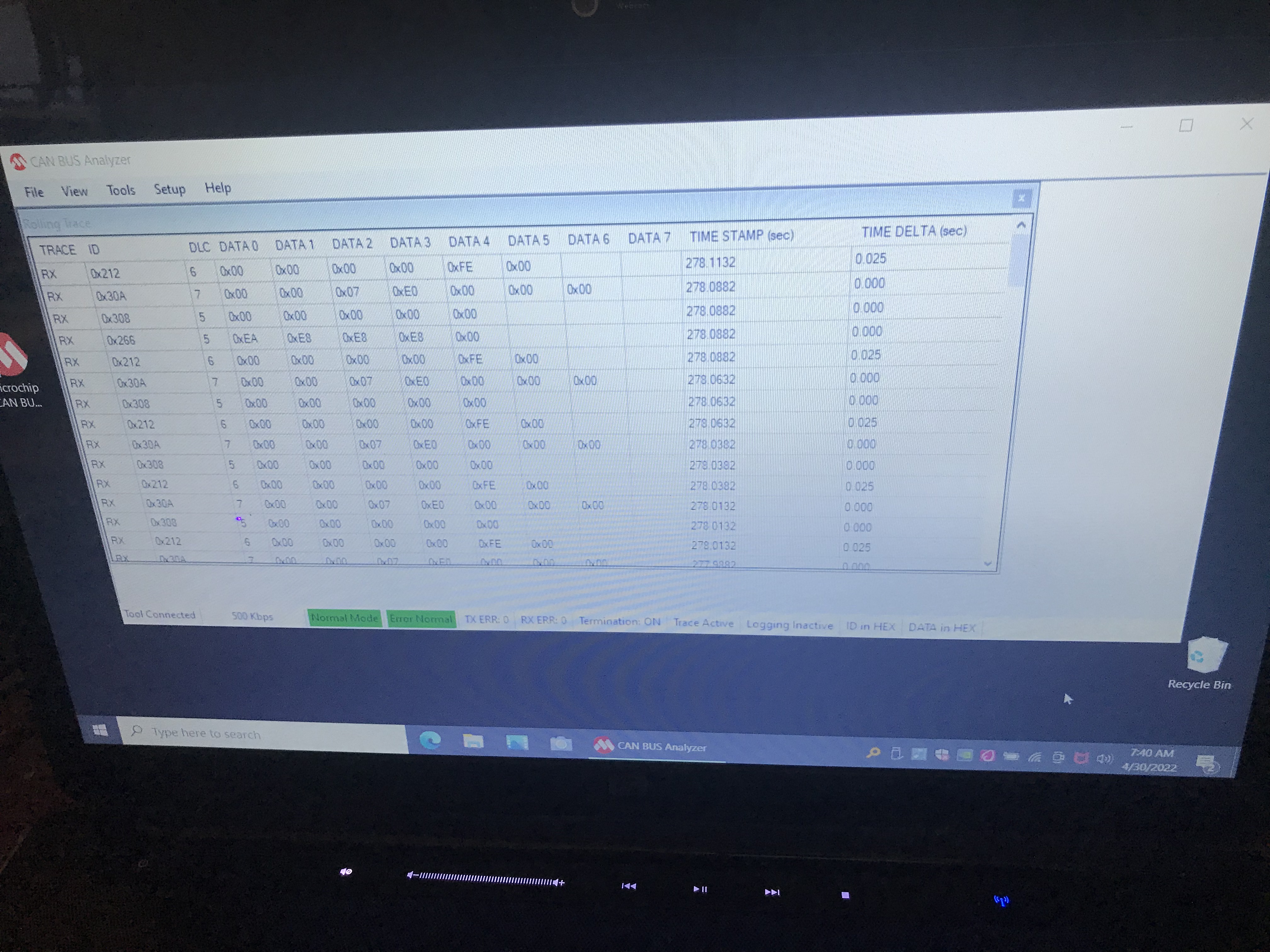

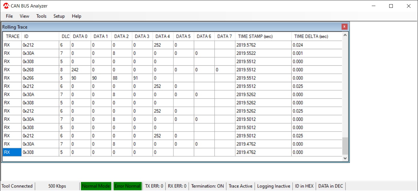

from what I gather so far this tool has two different pieces of software, we will start with the first which seems pretty generic and pretty basic, but already I like the layout better than the CANalyst-II one, so let's take a look at the screen and then we'll break it down

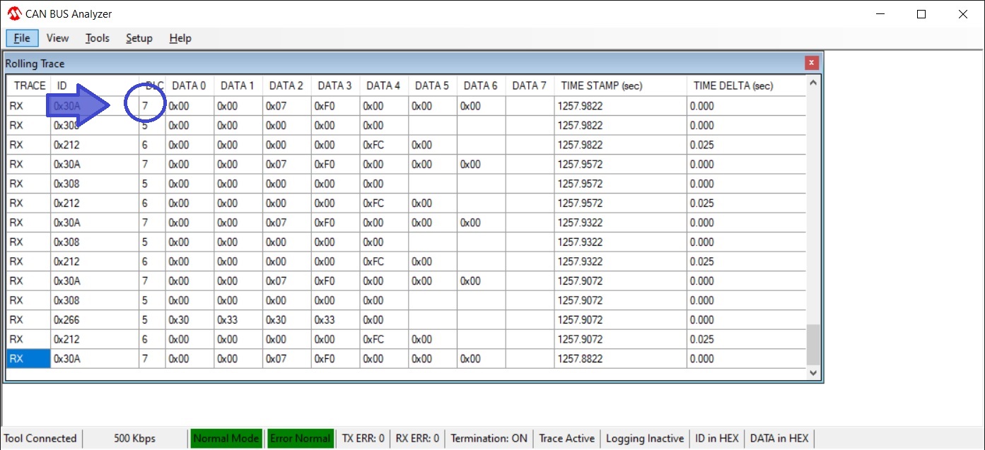

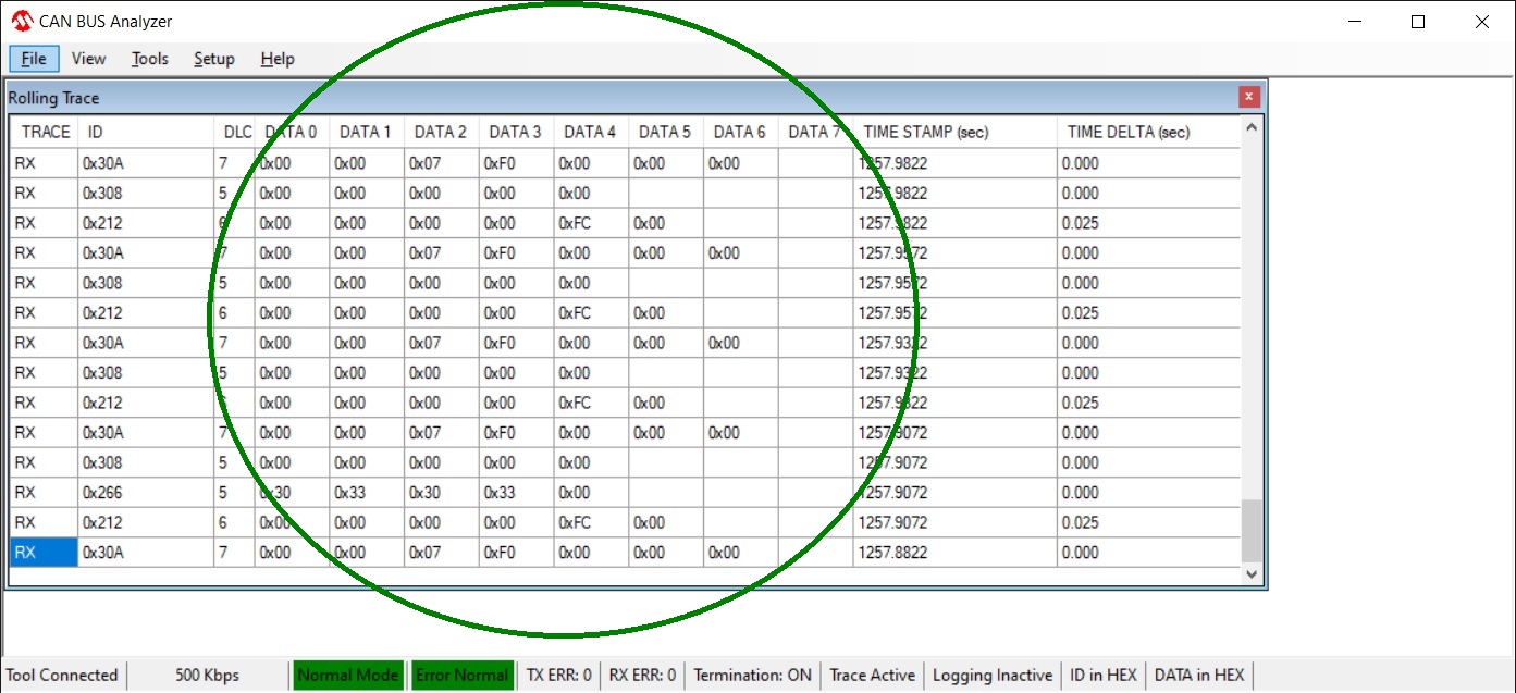

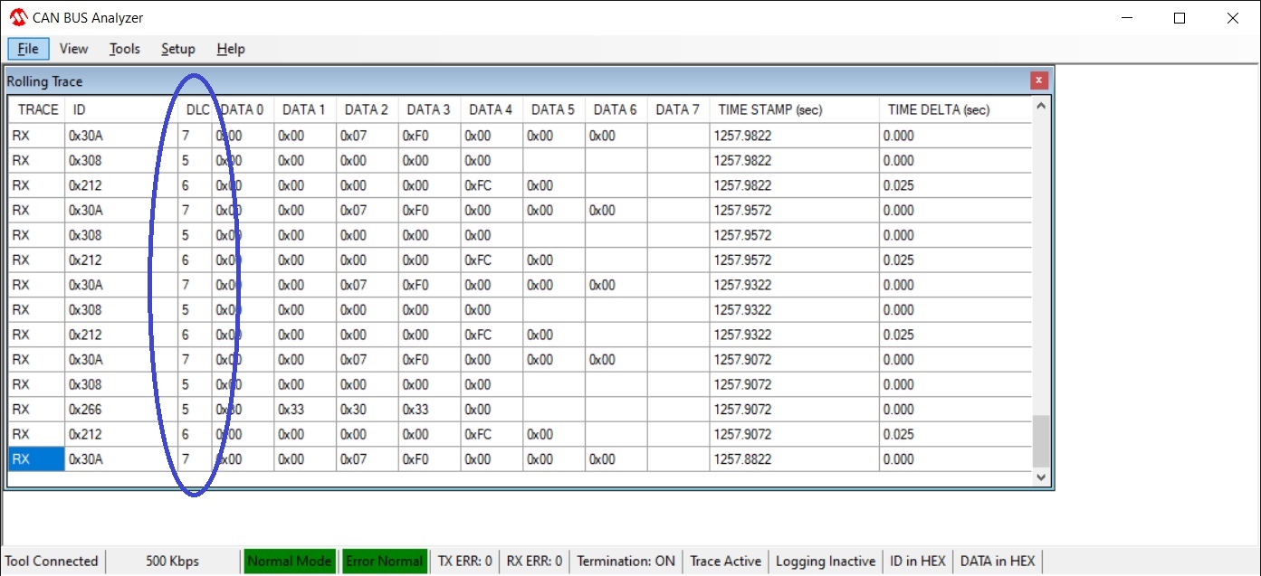

I really like how this tool splits the data into columns that my pea size brain can understand

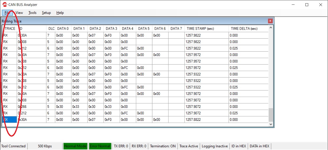

the first column called TRACE tells us if we are RXing ie Receiving or TXing ie Transmitting or sending the commands

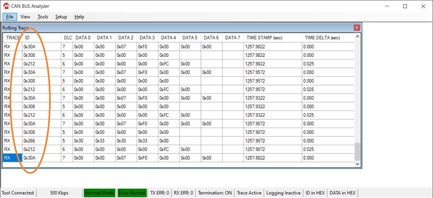

the next column is the ID column which is self explanatory (I think lower IDs take precedence in terms of execution, more on this later, maybe)

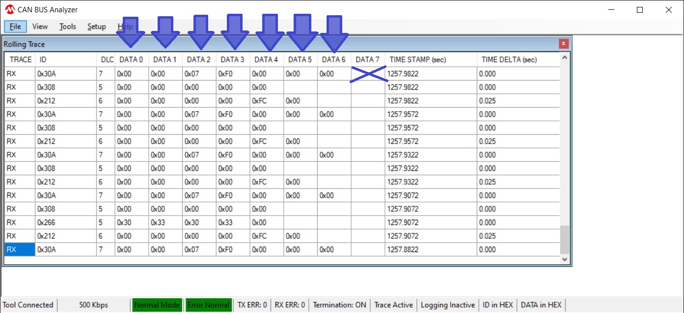

the next column called DLC tells us out of the 8 buckets we can send data in, how many actually will have stuff in them, don't let the DATA 7 column throw you off, this is programmer math so we start counting at 0, so 0,1,2,3,4,5,6,7 (equals 8) kapish
then we have the DATA column aka the meat and potatoes

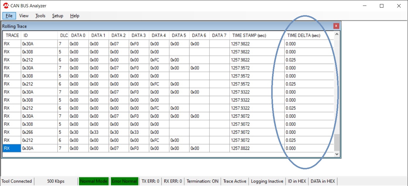

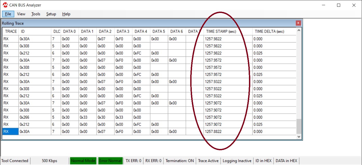

Then the Time Stamp column which I'm sure comes in handy when troubleshooting as you look at the last thing that executed before the smoke appeared
and finally the Time Delta column which delta means difference but I have no idea what it means in this context if I'm being honest

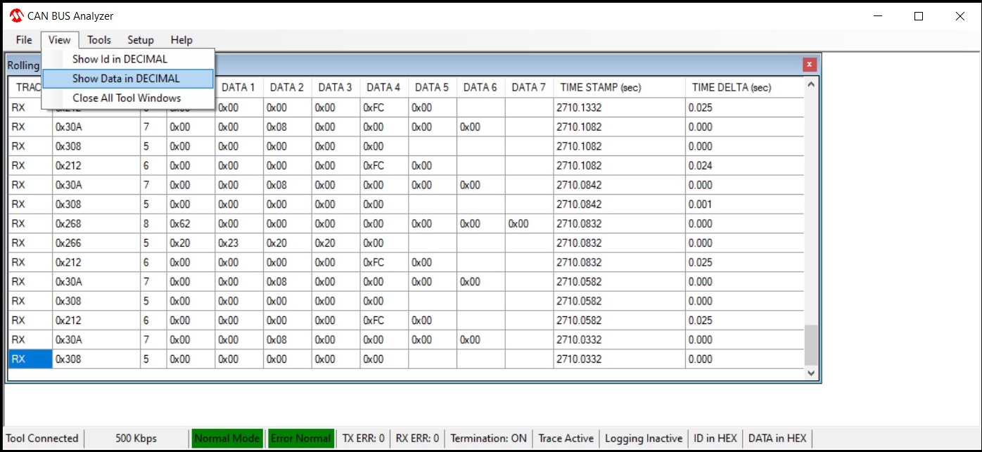

OK, let me share another cool feature of this interface, it allows us to change the view from Hex (pronounced: crazy talk) to Decimal
now this really helped me understand what is going on a bit more, allow me to use a silly analogy, think of the CAN bus message, we'll call it a datagram as a train, a train with 8 passenger cars, each one can be empty ie 0 or full carrying up to 255 passengers, that's what our CAN message can hold up to eight buckets full to the brim with 255 max value "so 256 characters technically" each, type of deal, except to add confusion they write it in HEX (blah)
here is the same data just in decimal formation if you will, so instead of numbers and letters in them boxes all we see is human numbers of 0-255 ha ha

now lets revisit that DLC column thingie
Example 1: in this example our train conductor, aka the DLC announces that only 7 out of the 8 cars or buckets will have passengers aka data values, the last one will be empty

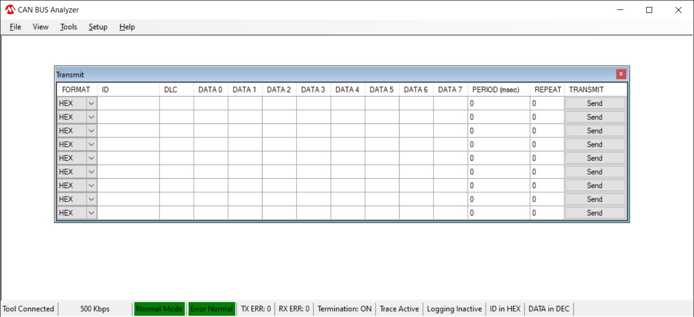

Good question, here's what the Transmit interface looks like

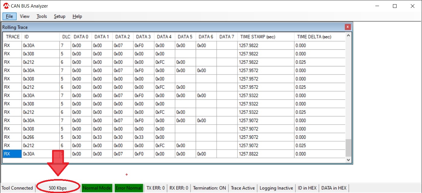

this is a good time as any to remind ourselves that different CAN buses can speak at different speeds, it's like traveling across your country to some places where they speak very fast, and to others where they speeeeaaaakkkk soooooo slllllooooowwwwllllyyyyy
this is measured in killabits or Kbps, and Mr. Kramar reminds us that "The Lear operates CAN at 500Kbps."

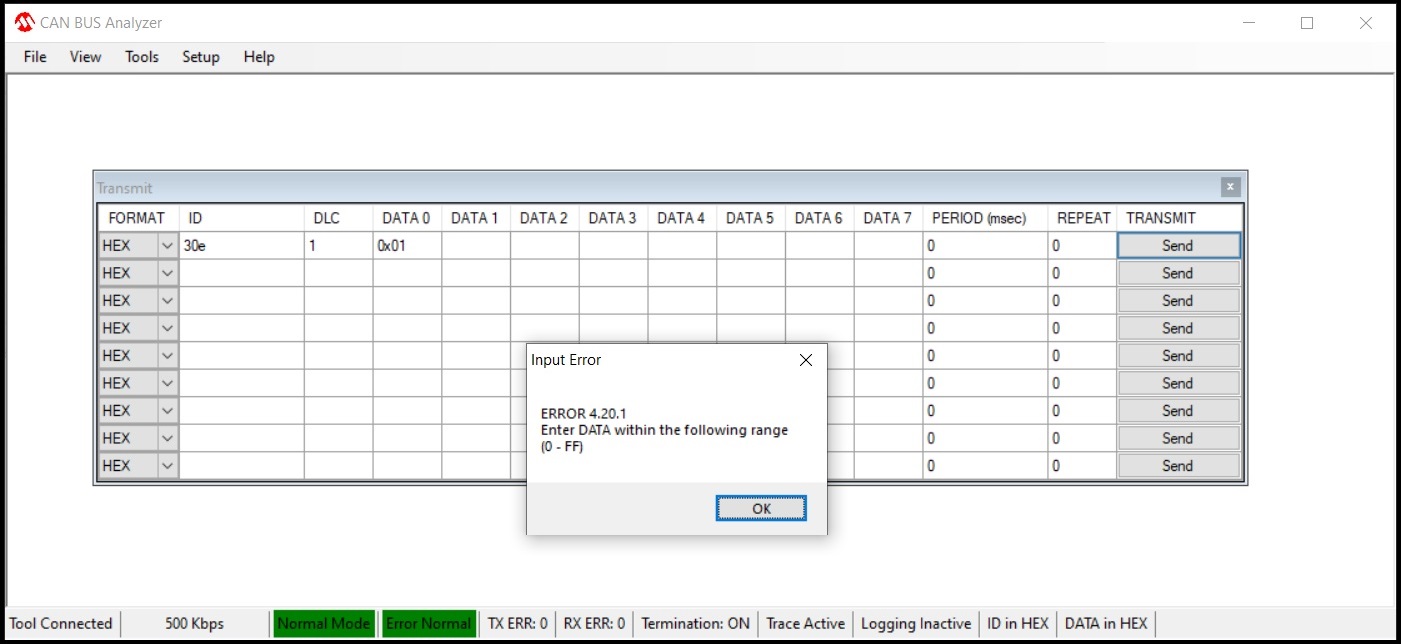

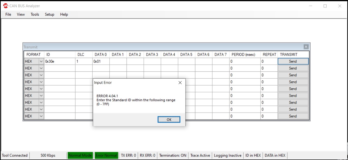

alright here we got we are going to try to send our first CAN message, ready set go
first let me shove the command into a table just so it aligns perfectly with the header row
Address DLC Data0 Data1 Data2 Data3
0x30E 1 0x01
Turn on aux12vdc (this was just a comment) basically in English all we want to do is enable the 12 volt charger inside of this dual charger (it is essentially two chargers inside of one box, one for 360 volts or so and the other for 12 volts type of deal, pretty cool design
so since we are learning, let me share with you the good, the ugly, and the bad, after all we learn from our mistakes
the first thing I tried was very literal, I mean who wouldn't right? and I was greeted with an ID out of range Error message, which might as well been written in hieroglyphs
Gregski
Posts: 3164
Has thanked: 633 times
Been thanked: 1610 times
Re: I think I CAN, I think I CAN...
Post by Gregski »
OK, a few cuss breaks later, I guess when someone says 0x30E in Hex the 0x is silent, kinda like saying knee or tsunami I guess
so we changed the ID from 0x30E just to 30e (note the case does not matter) and it liked that, then it choked on the DATA 0 value, same idea hear, hey I never said I was the smartest crayon in the shed

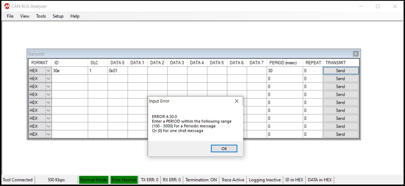

OK, so we gave it a message ID, told it that only one bucket (DLC) has data in it, and honestly just want to send one bit, which brings us to the PERIOD column and this may be a Show Stopper
basically we want our CAN bus gizmo to shout "only charge the 12 volt car battery" every .03 seconds
but this Interface won't allow it to do it that often, it says the best I can do is every .1 seconds
but the manual says: Populate the Periodic field (50 ms to 5000 ms).
Gregski

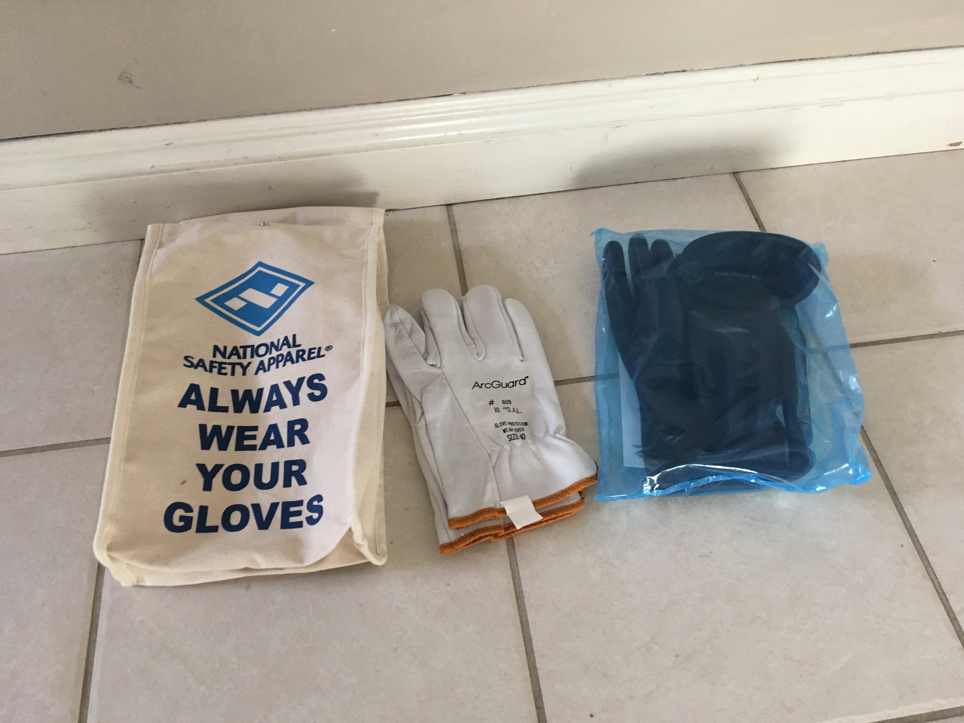

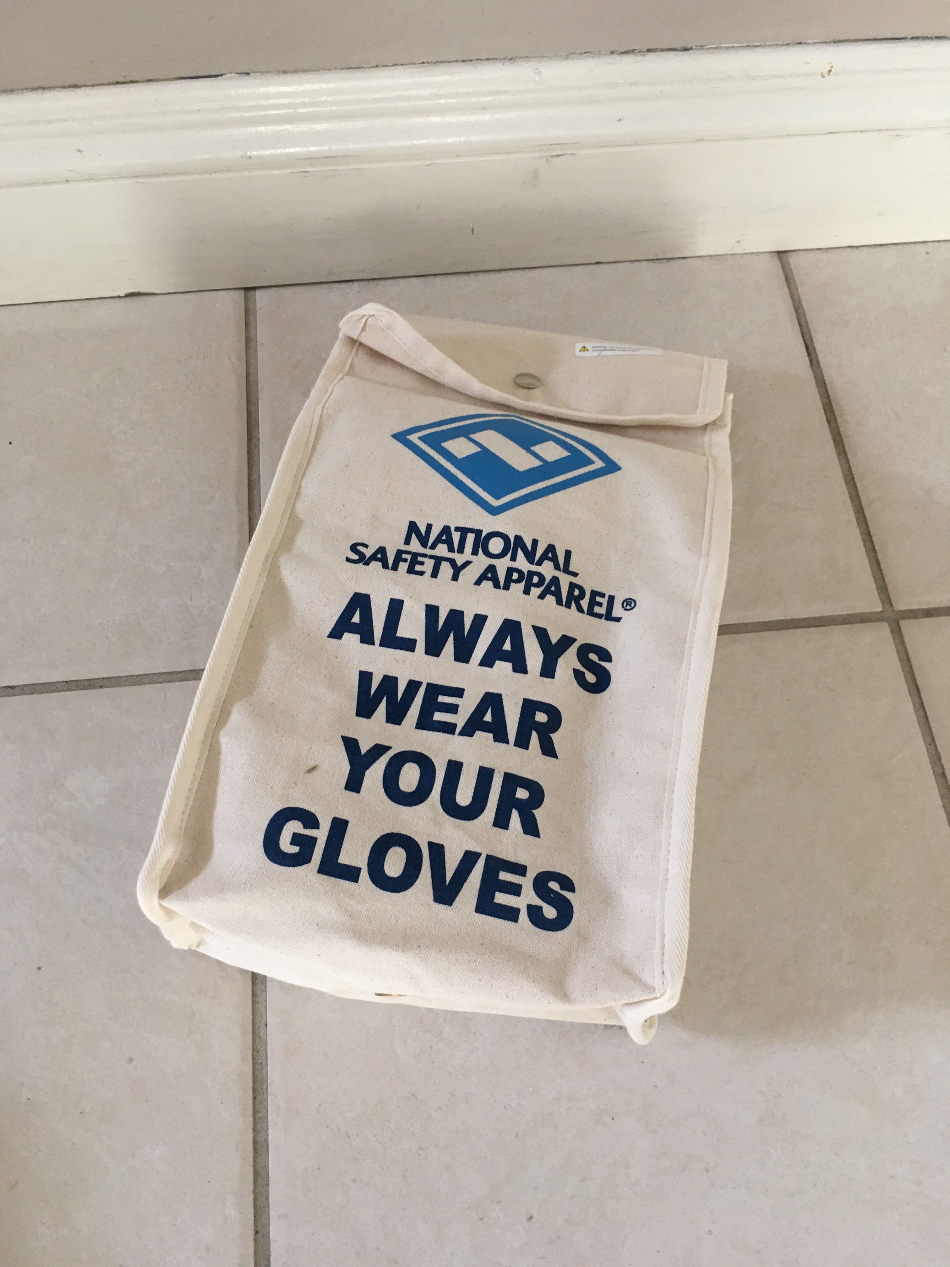

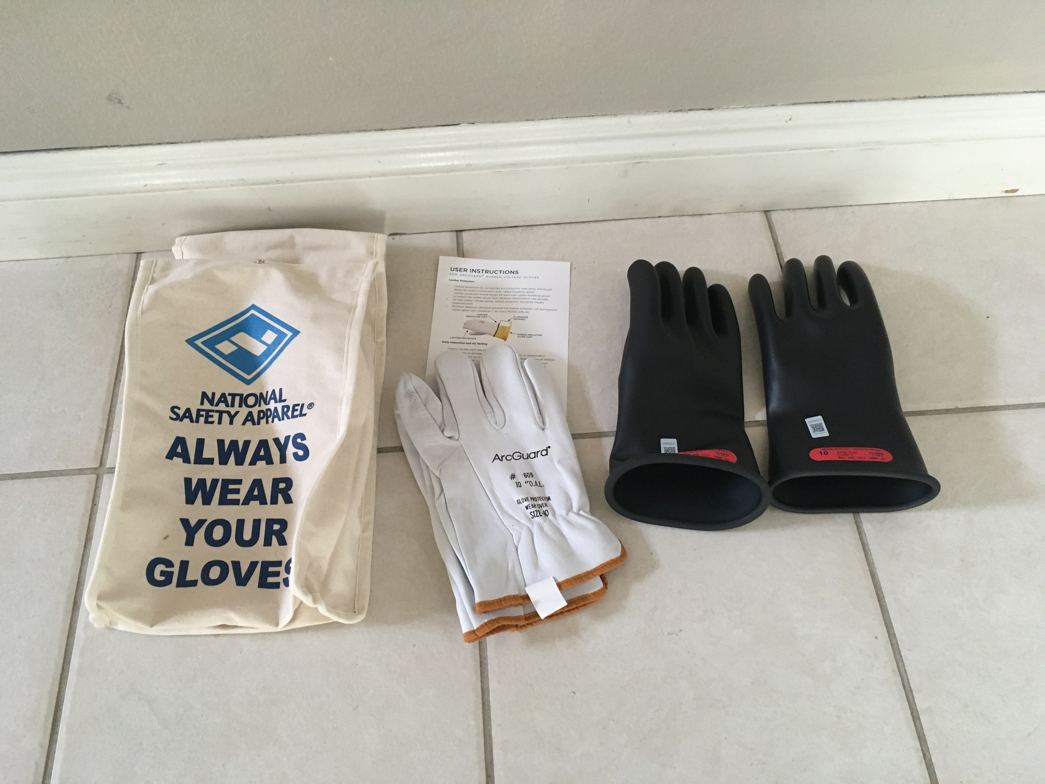

Just send the heartbeat msg with canalyst and send command with microchip. That way you CAN get the charger to work today :).
But for not connecting HV i dont know... maybe it doesnt start with only 12v as a load.
So hook up HV battery first, then 12V and then AC input.
Be carefull when connecting DC HV, wear leather gloves when plugging connector. There could be a chance charger could be faulted and inrush current could melt HV connector. Dont ask me how i know...

arber333 wrote: Sat Apr 30, 2022 7:35 pmBe carefull when connecting DC HV, wear leather gloves when plugging connector. There could be a chance charger could be faulted and inrush current could melt HV connector. Dont ask me how i know...
message received

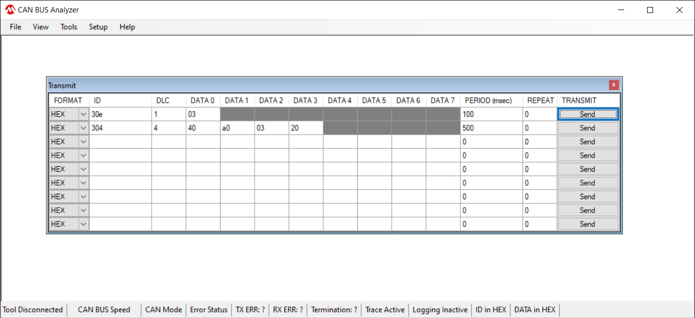

arber333 wrote: Sun May 01, 2022 7:46 am1st msg should be sent at 30ms interval. I dont know if 100ms will work.
I concur, and the only reason I tried 100ms is because that's the lowest this black MICROCHIP gadget allowed me to go
Period Error 2.jpg (18.43 KiB) Viewed 7105 times

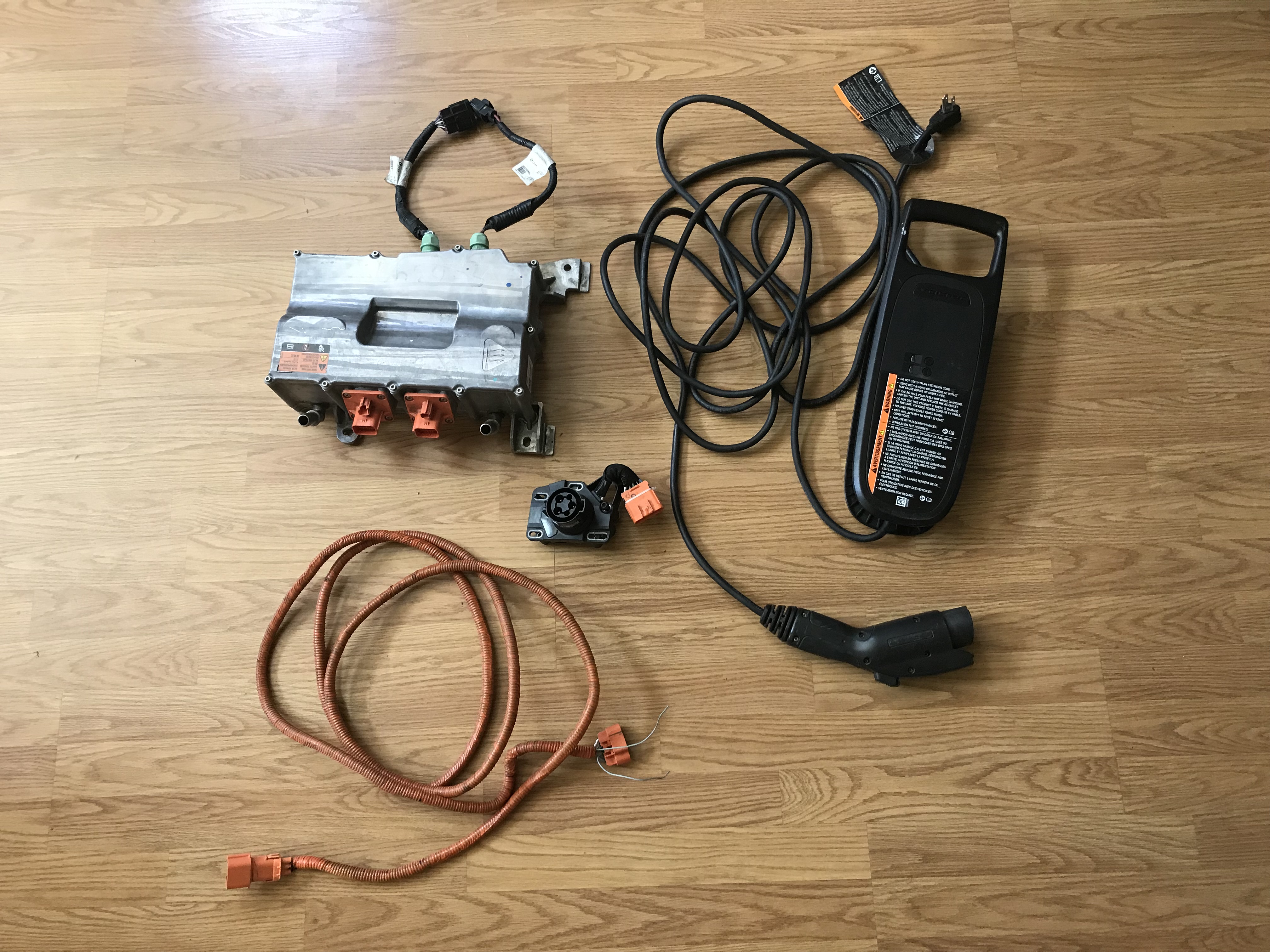

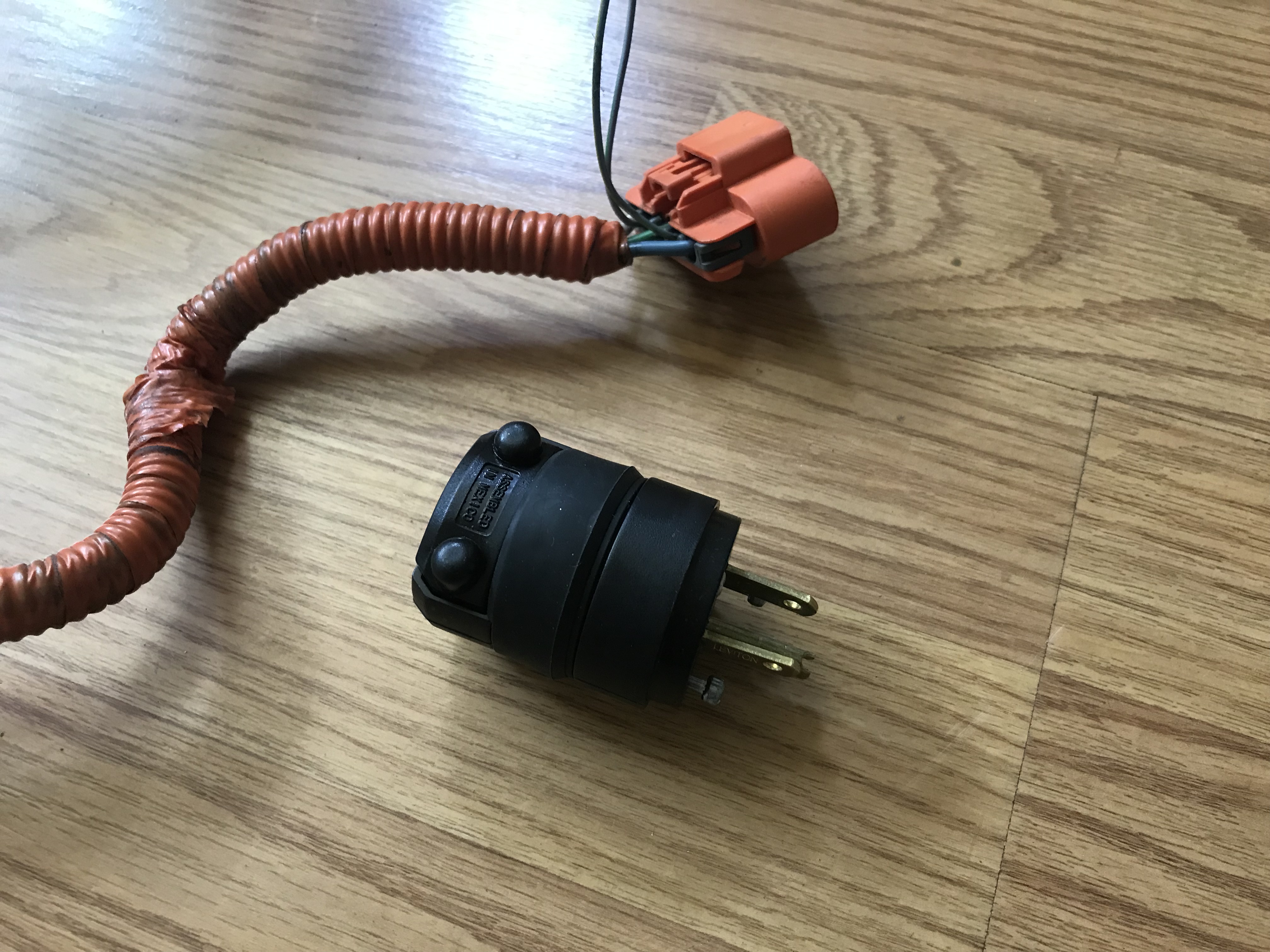

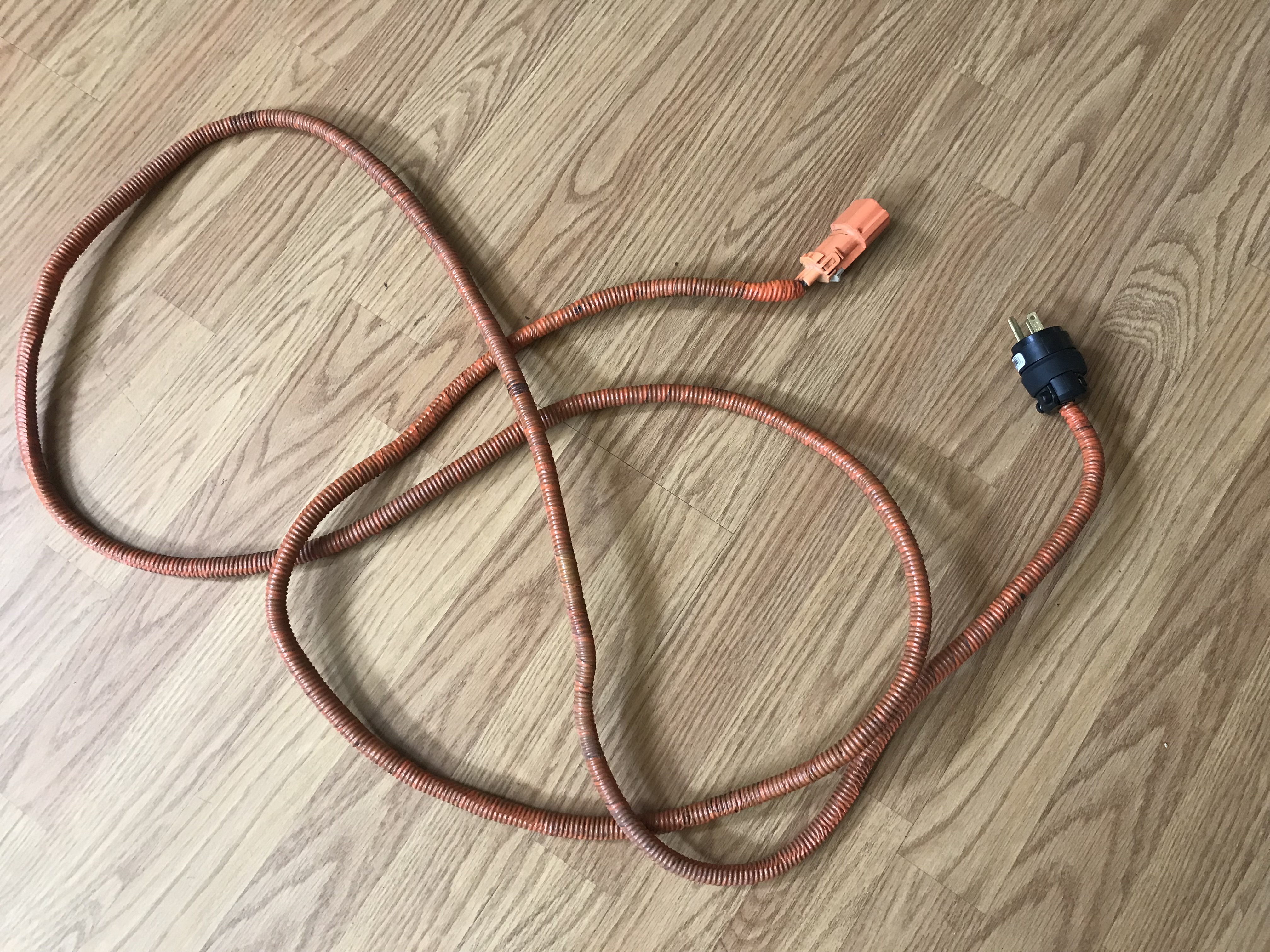

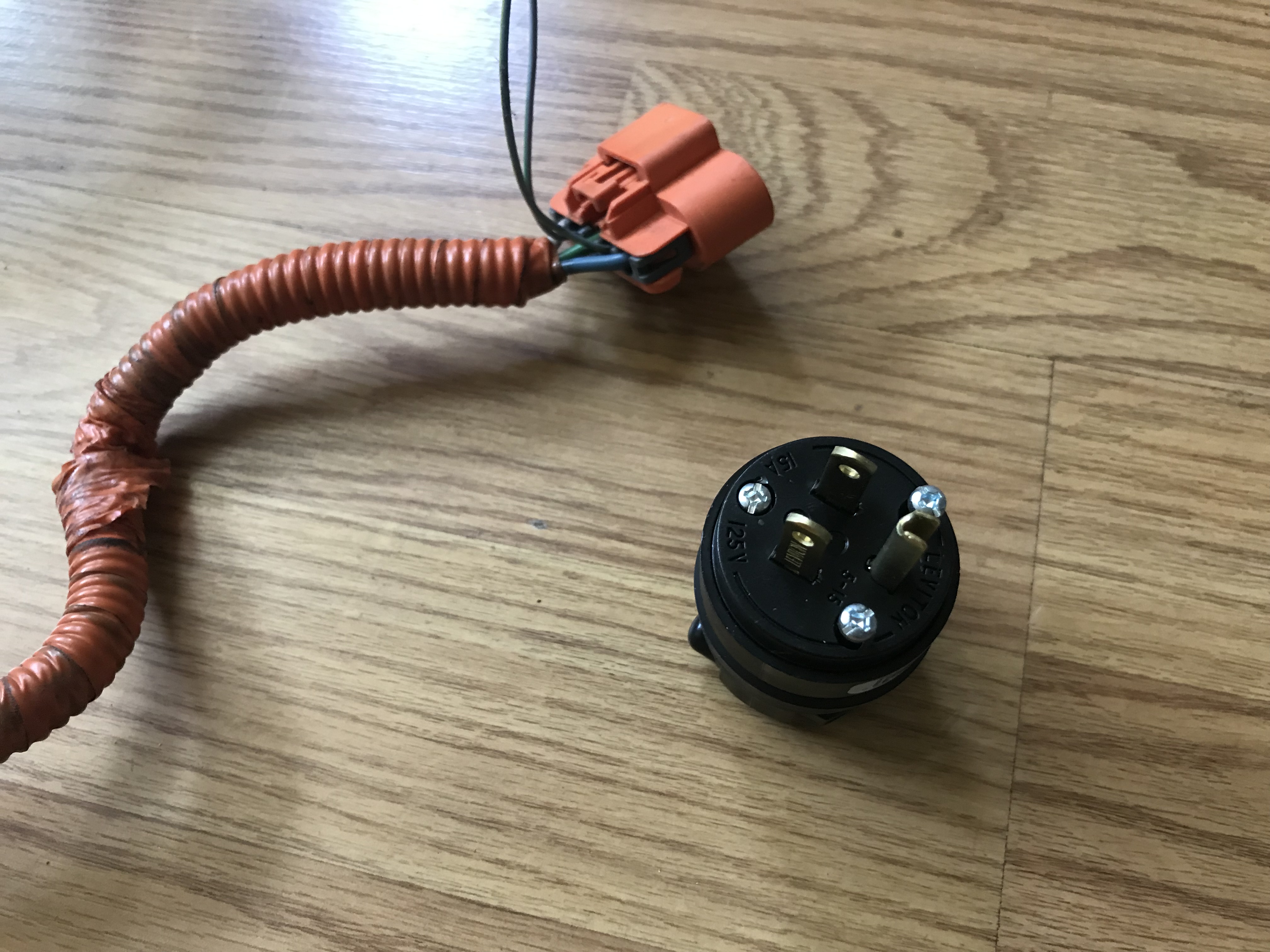

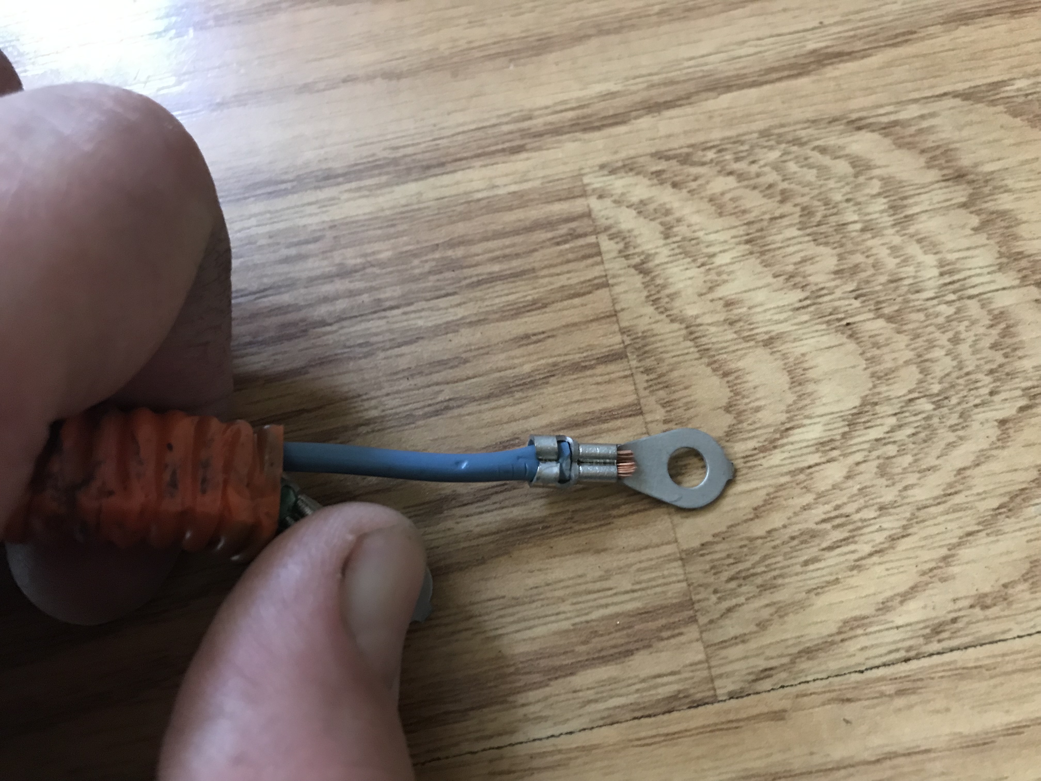

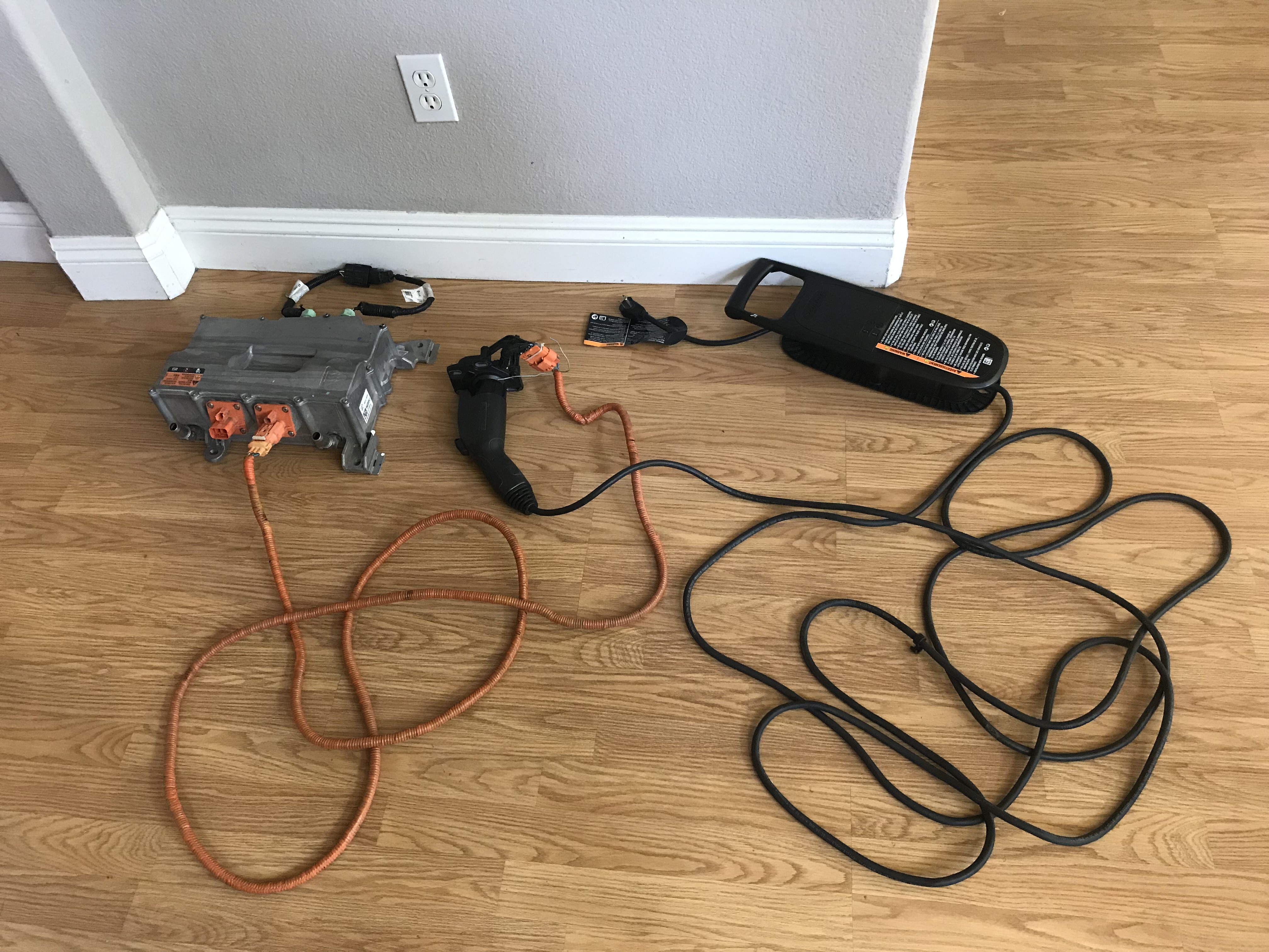

LESSONS LEARNED
In the spirit of full disclosure thinking I would go out and buy a complete OEM Chevy Volt first gen J1772 charge port and wall charger, seemed like a good idea at the time, but i soon discovered it just complicates things, actually makes it impossible to control the charger, as the silly charge port or wall charger needs to be controlled itself do to the Pilot and Proximity connections
Posts: 3796
Been thanked: 413 times
I would assume there is a VCU section of HPCM2 module (under the driver seat) which senses PP signal from charge plug and starts to output heartbeat for the charger. If it just needs HV charging it will go for 01 but if it also needs to charge aux battery it will show 03. Then another section requests power from the charger.
Another notice... charger has 2x CAN ports. I never tried them both but others said those are not the same line.
Gregski
Posts: 3164
Post by Gregski »

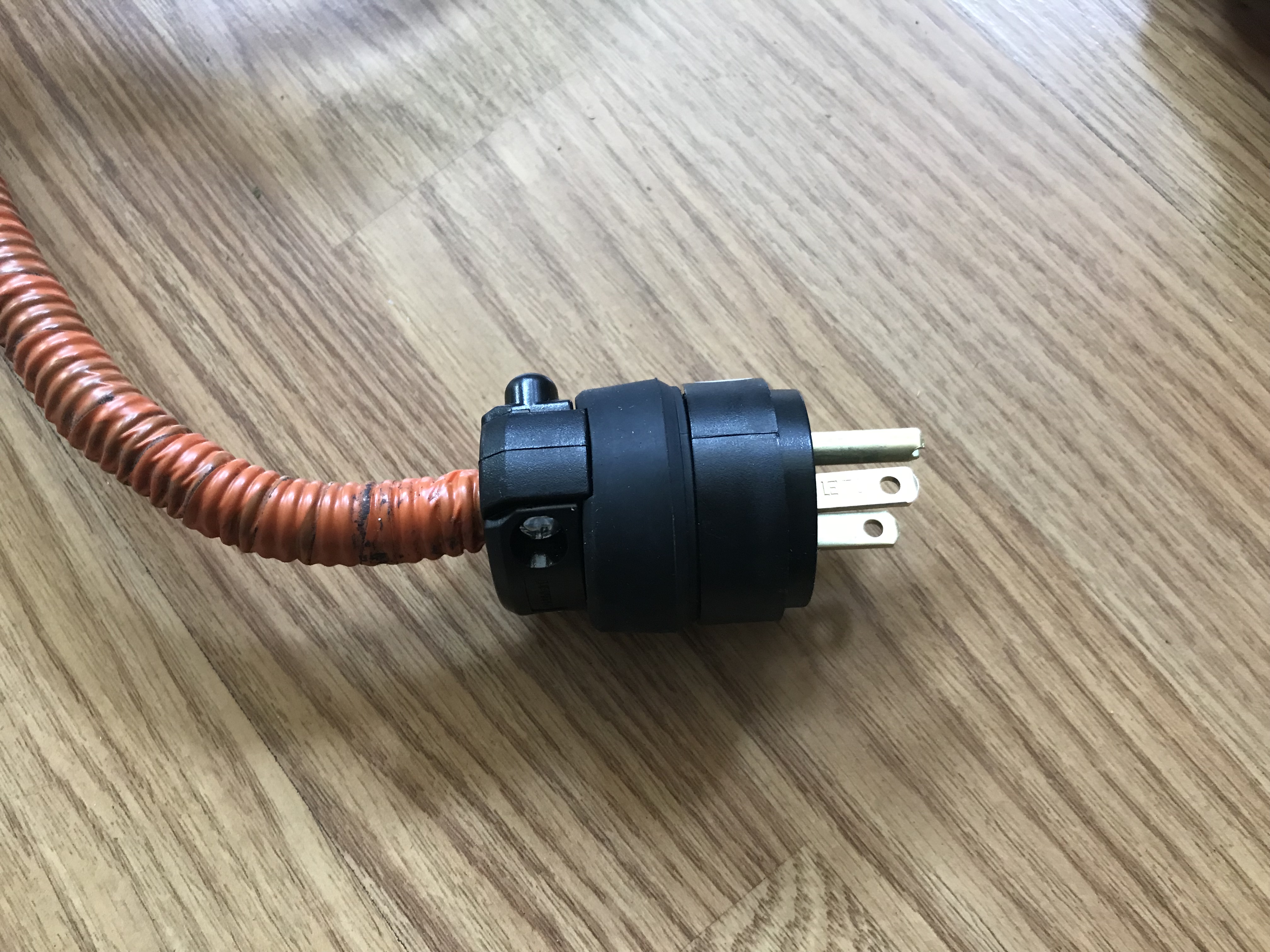

Gregski
Posts: 3164
Post by Gregski »
oh no he didn't....
