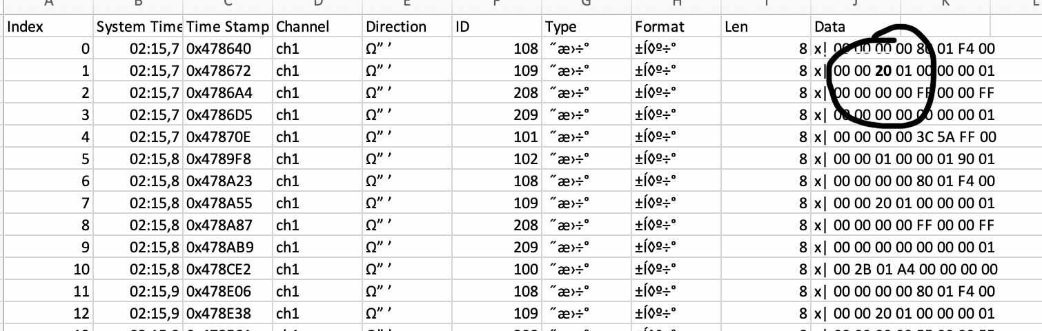

OK my CAN log is attached...
I finally managed to get the EVSE charging.
1. Of course i needed to add simple ID flag
2. I managed to solder 1K 12V pullup to wrong VCU pin :? I had to resolder it. Now i just pull 12V from input via 1K resistor to IN2 pin (large connector pin no. 6).
Of course now that i corrected both mistakes EVSE pulls contactors in and starts to charge, YAY!
NO... after 24A ramp EVSE throws a flag. It says current request mismatch. When i connected to USB i got 20A provided for -20A VCU request.
I tried to charge several times and later i tried to set reverse current inside the code, but i dont know how...
@Bigpie how is your ISA shunt connected in reference to battery voltage?
@Isaac96 can you help me with the code? How would i reverse the ISA (or VCU) CAN reporting so EVSE would see positive current request?
tnx

No matter what i set in current request (20A, 30A, 12A) it will allways result in termination at the same time after charg innitialization.
What i am thinking of is multiplying "Sensor.Amperes" by *-1. Would that change anything in the overall chademo report? Obviously my VCU is requesting -20A... But if i enter request for AMAX=-20 i would actually get 240A :twisted:

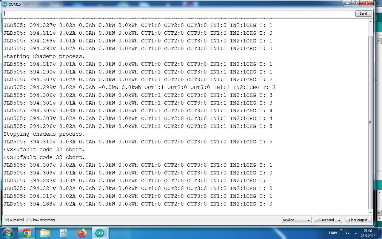

I tried on another EVSE and this time i wouldnt even get contactors pulled. Just error 32! See csv file and serial report.
Strange... I will now turm ISA around so it will sense current the other way. No problem doing that...

Is the timing of the messages you are sending correct? Data update rate needs to be 100 ms for each message.
And do you know what the 0x208 and 0x209 messages are?

Still cant pull contactors in. Just error 32.
I have no idea about 0x208 and 0x209. They originate from EVSE which behaves really different than the first one.

Posts: 3795
Been thanked: 411 times
larsrengersen wrote: Sun May 29, 2022 8:33 am Looks like from the beginning, the EVSE says 'Stop'. The question is, why?
Yes, but another EVSE starts charging without any problem. Only later it complains about current mismatch.
Second EVSE seems to be newer combo 22kW AC, 50kW Chademo and 50kW CCS station.
