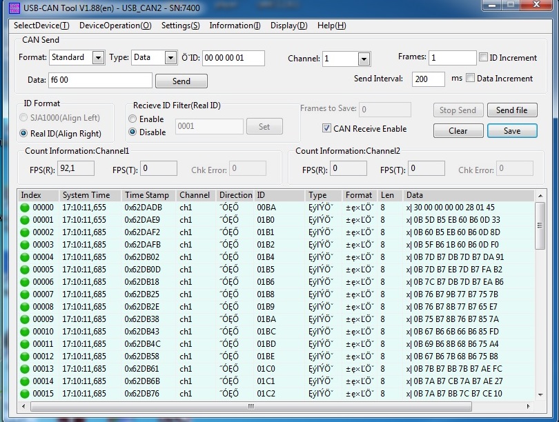

I have connected VW modules via can cables and supplied 12V. When i observe can traffic there is a steady stream of info.
However i noticed 2 problems.

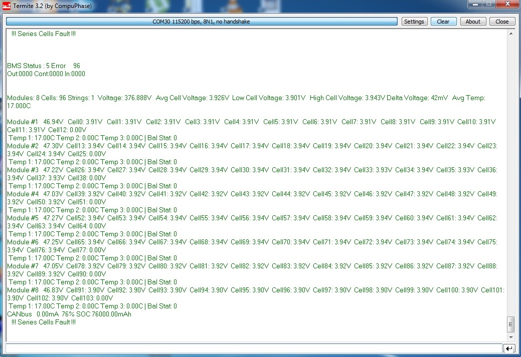

1. When i start simpBMS i get 96 cells and errors! When i observed debugg screen i found system is counting 12 cells and 8 strings as it should, but it also shows cell 12 as 0V. I noticed it starts to count at cell 0?
2. Also i cant get any data from nextion display. I tried to connect to serial1 and serial2, reposition rx, tx wires, but nothing... Can you help me what could be a problem?
I am using latest VW software...
I didnt connect the modules together in a single 96S string yet. Would that be a problem?

arber333 wrote: Sun Feb 27, 2022 4:21 pm 1. When i start simpBMS i get 96 cells and errors!
Please check your settings, you need to setup your battery to say there are 96 cells present. Check in the debug menu if it registered propperly that there should be 96 cells, if not please reset the value by sending the number infront of it.
Also check your serial output settings.

tom91 wrote: Sun Feb 27, 2022 4:48 pm Please check your settings, you need to setup your battery to say there are 96 cells present. Check in the debug menu if it registered propperly that there should be 96 cells, if not please reset the value by sending the number infront of it.
Ok! i see can values and i can read all cells inside terminal. BMS states "ready". But still i dont get any serial from LCD. How do i check my serial settings?
EDIT: Yes i am dumb!!! I managed to swap my GND and RX connection to LCD. Now i have everything working, yay!
tnx
