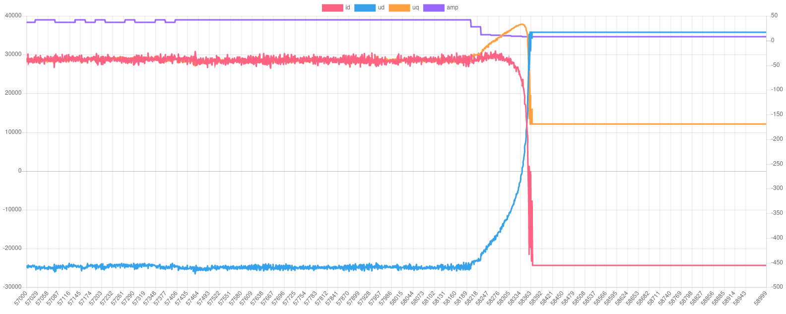

Re: suggestions for the next release 5.17 -> 5.18
Did some more testdriving myself today using the "evil" firmware from above. Indeed as soon as field weakening is requested the car starts to accelerate on its own also not obeying the rev limiter. The torque it still produces at 8000 rpm and above (that's where my rev counter stops) is amazing. Unwanted though.
I then dialed down fwkp=10 and fwki=0 to make it less scary. The unwanted acceleration is still there but quite weak. Something strange can be noticed: as soon as FW kicks in ud reacts accordingly. But then the reaction to that is more iq! WTF
At that point I come completely off the throttle, id remains at its 40A set point but iq, which is supposed to be 0 is not 0. It slowly decreases with speed. What does this tell us? Behaviour seems similar with different values for syncadv.
Just switch in an appropriate resistor into the throttle line, that will limit maximum throttle without any software change. Sorry, I don't currently have time for bells and whistles. Maybe somebody on the forum wants to quickly add that in and post it here.
EDIT: Wait a minute.... it actually exists! You can use the BMS input for that. You can set a throttle limit, both regen and acceleration when BMS input becomes high
Alright, back to the high speed topic.
I switched off FW and just set idiqsplit to 70%. I also added another filter to limit slew rate of throttle command.
It doesn't really help. You can see when I come off throttle suddenly id starts dropping down to the current limit. The regulator tries to counteract that by shooting up to maximum possible amplitude. Also uq drops off quickly, not sure if that's just normal. It's hard to say what causes what.
Isn't something fundamentally going wrong here?

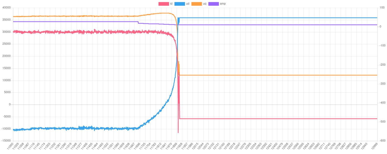

More testing today and one other culprit located.
It's the part that maps very large or very small duty cycles to full on or full off. Works great with the simple sine code but with current control loops that kind of non-linearity is deadly. With that removed and maximum amplitude restricted I can at least spin up to around 6500 rpm with FW disabled and no weird oscillations.
I have also moved the FW controller to the slower 10ms task to make it less springy.
I was kind of tired to test FW again, could someone please take that over? Parameters also attached. They lower ocurlim to 400A to make things less harsh. Be prepared that the FW algorithm makes the car take off by itself as soon as it steps into action. It needs a well tuned syncadv to not do that. I guess I should also back-port the duty cycle change to the "old" FW controller and see what it does.
So whoever tests this should first tune syncadv until the FW controller no longer causes unwanted acceleration and then tune fwkp/fwki for good high speed operation
Source: https://github.com/jsphuebner/stm32-sin ... fw-control
