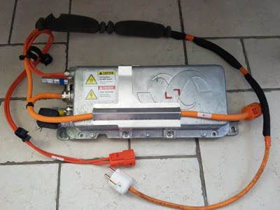

I'm looking for multiple Volvo / Eltek chargers for a boat project on a budget...
Volvo IP67 charger can be found under those PNs
31394702
30659929
31453939
must include the water cooling baseplate.

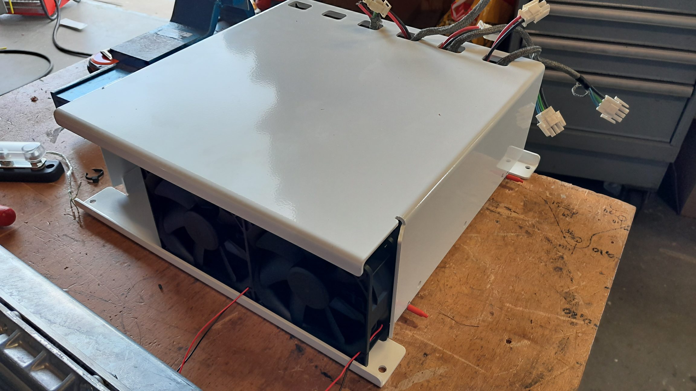

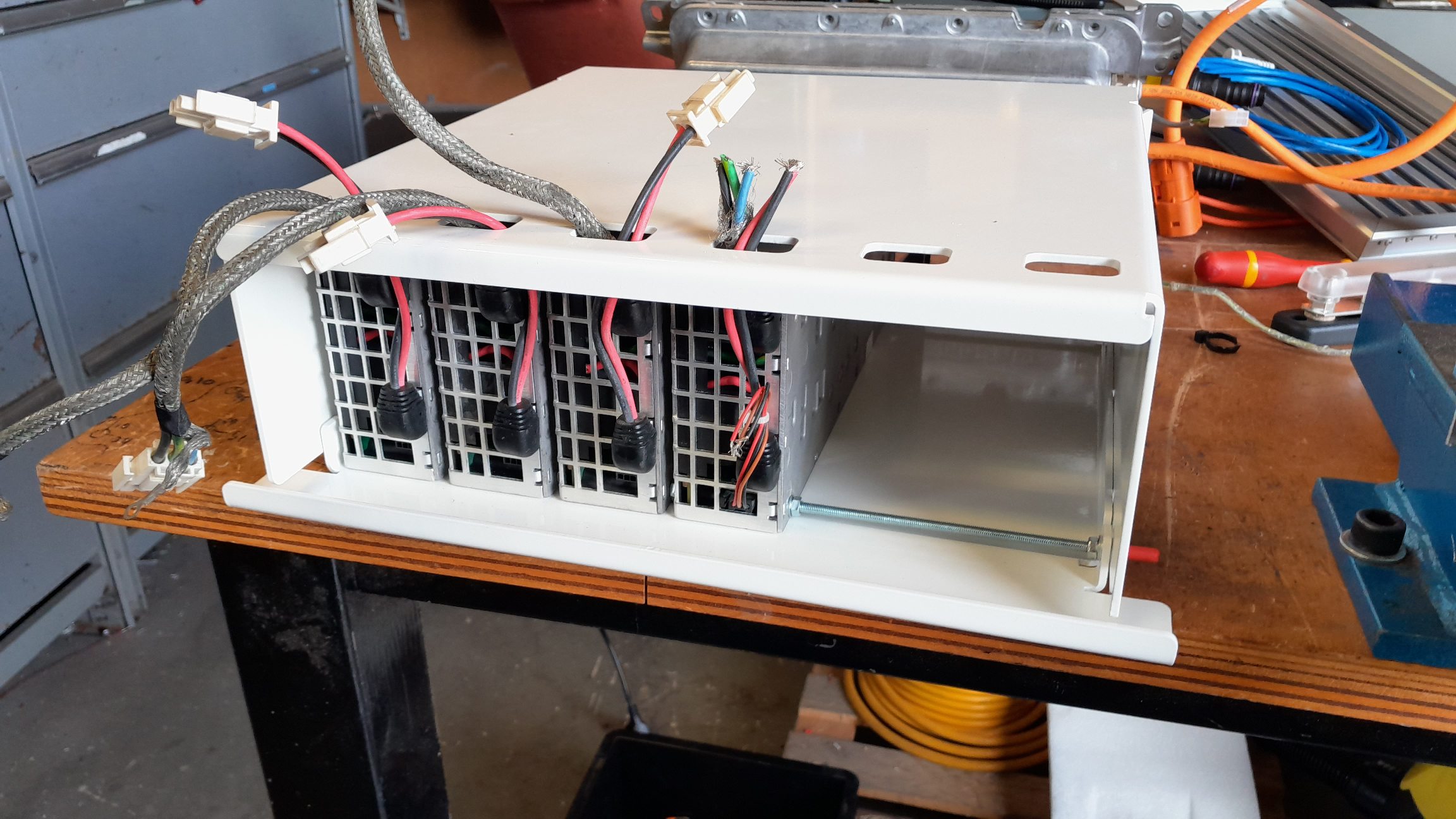

Unfortunately I was only able to buy 4 of the air-cooled chargers trough ebay / aliebaba
It seems they all come / came from the same source and there weren't as much available...
Does anyone have charger(s) they are willing to sell? I've already build a nice housing for them :(

Holy smoke! That enclosure is very nice! Great job! :D
What's the plan to talk over CANbus with multiple Elteks with the same IDs? Can they be reprogrammed to other addresses?

I would advise you to put one alu collant block between chargers 2 on top and 2 in the bottom. That would be perfectly capable of keeping them cool.
Then you can go and completely close the box for IP68 standard.

Yes, can't do that myself but I have some people in mind to hire for that job ;)

in this case the location they are mounted is dry, so no problem with aircooling.
