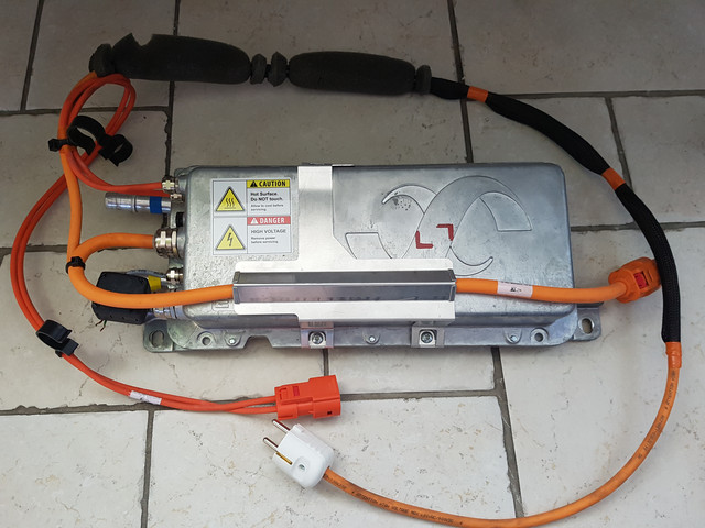

Re: Wanted: Volvo / Eltek chargers
You could get the IP20 version here:
https://www.aliexpress.com/item/1005002 ... mainSearch
And make your own base plate for two of them, put a watertight lid over them from each side. That was my first thought.
That way you could use 4 of them...
Well if you read both instructions closely you will notice that minimum energy dissipation is the same for IP20 as well as IP67 version. Both are cooled out via side alu plates towards lower alu plate. About the only trick is how to seal out the moisture.boekel wrote: ↑Tue Feb 15, 2022 10:05 am Thanks again, didn't look for air cooled ones
ordered some of these:
https://www.aliexpress.com/item/1005002802794429.html
I literally put the ip20 module into ip67 box... with some milling... and it works!

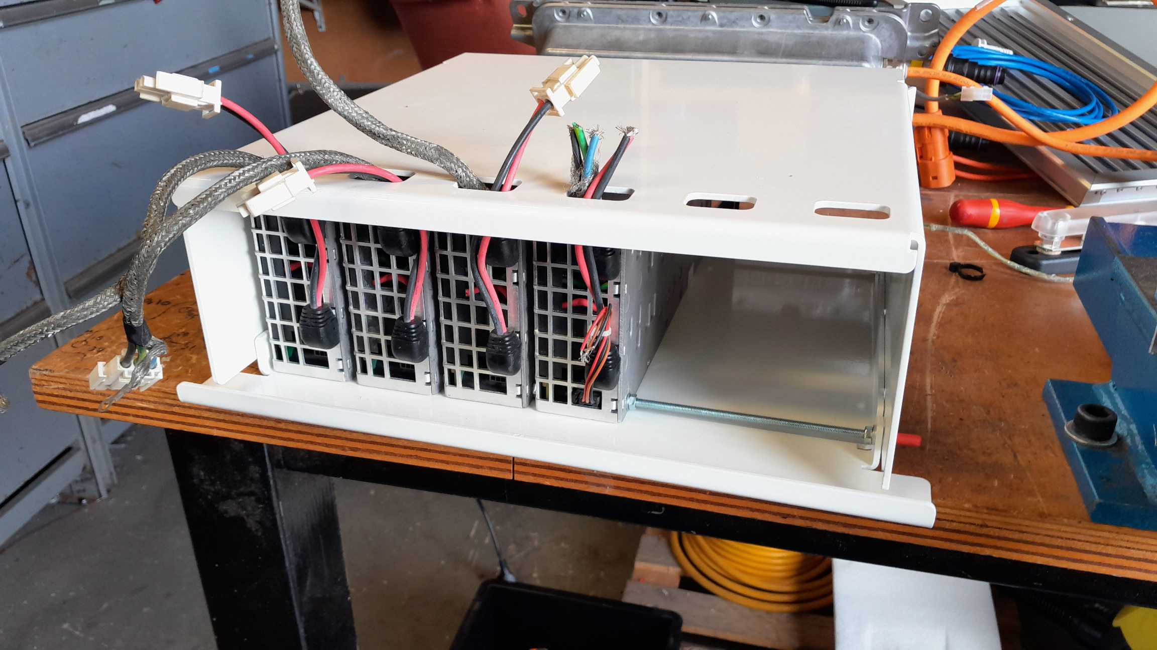

Unfortunately I was only able to buy 4 of the air-cooled chargers trough ebay / aliebaba
It seems they all come / came from the same source and there weren't as much available...
Does anyone have charger(s) they are willing to sell? I've already build a nice housing for them
Holy smoke! That enclosure is very nice! Great job!
What's the plan to talk over CANbus with multiple Elteks with the same IDs? Can they be reprogrammed to other addresses?
I would advise you to put one alu collant block between chargers 2 on top and 2 in the bottom. That would be perfectly capable of keeping them cool.boekel wrote: ↑Sun May 29, 2022 6:13 pm Unfortunately I was only able to buy 4 of the air-cooled chargers trough ebay / aliebaba
Does anyone have charger(s) they are willing to sell? I've already build a nice housing for them![]()
Then you can go and completely close the box for IP68 standard.
Yes, can't do that myself but I have some people in mind to hire for that job
in this case the location they are mounted is dry, so no problem with aircooling.arber333 wrote: ↑Mon May 30, 2022 1:00 pmI would advise you to put one alu collant block between chargers 2 on top and 2 in the bottom. That would be perfectly capable of keeping them cool.boekel wrote: ↑Sun May 29, 2022 6:13 pm Unfortunately I was only able to buy 4 of the air-cooled chargers trough ebay / aliebaba
