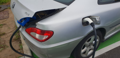

I managed to charge on ABB charger at some Lidl store.
I set up the ISA in reverse to confirm my suspicion.
First i connected chademo and i could go up to 46A, which is a limit imposed from Lidl EVSE.
Chademo faithfully drew amps while i inspected the protocol in debug mode. See doc file attached...
Then i had almost nothing to do but observe BMS. Cell temp went up from 19°C to 24°. About 1K per 5 minutes! I think i will need that cooling after all.
Some seconds later i was looking at AC plug... what if...? NO...it cant be that simple...
I connected the plug and got my 9kW chargers working. I got to 60A 400Vdc!!! 24kW, pretty good considering fast charger is limited to about 17kW.
Now i just need to inspect what is wrong with my protocol so that the other EVSE refuses charging...
EDIT: I have noticed VCU reports everything in negatives while EVSE reports in positives.
First i will go and reprogram ISA so it will measure in reverse. Then i will try again...

I have successfully charged at 4 different EVSE types. 2x ABB, 1x Ionity and one unknown type. 8-)
https://leafdriveblog.wordpress.com/202 ... ademo-box/
Though this Petrol proprietary ultra fast EVSE is still giving me grief. It is the newer model that can provide 100kW :shock:
Messages x201 and x202 are unknown to me.... maybe if i just copy them from x101 and x102?

In other news i managed to fast charge on a multitude of CHADEMO stations YAY! :P
Only Petrol Delta ultra fast charging station is making trouble. Like i said it seems it still needs some CAN command because it pulls in contactors but then stops. https://www.deltaww.com/en-US/products/EV-Charging/4865
Now i have a real obstacle with battery heating up really fast. With OAT at 30°C and 30kWh session of 60% charge temperature got as high as 47°C!!!
I really need to setup some kind of battery box cooling system for while charging and driving.
There are stations where i managed to charge via CHADEMO port AND L2 Mennekes plug! On a parking lot of Lidl stores... Just for fun...
Of course you need to be present if someone would need to charge from the other connector :).
