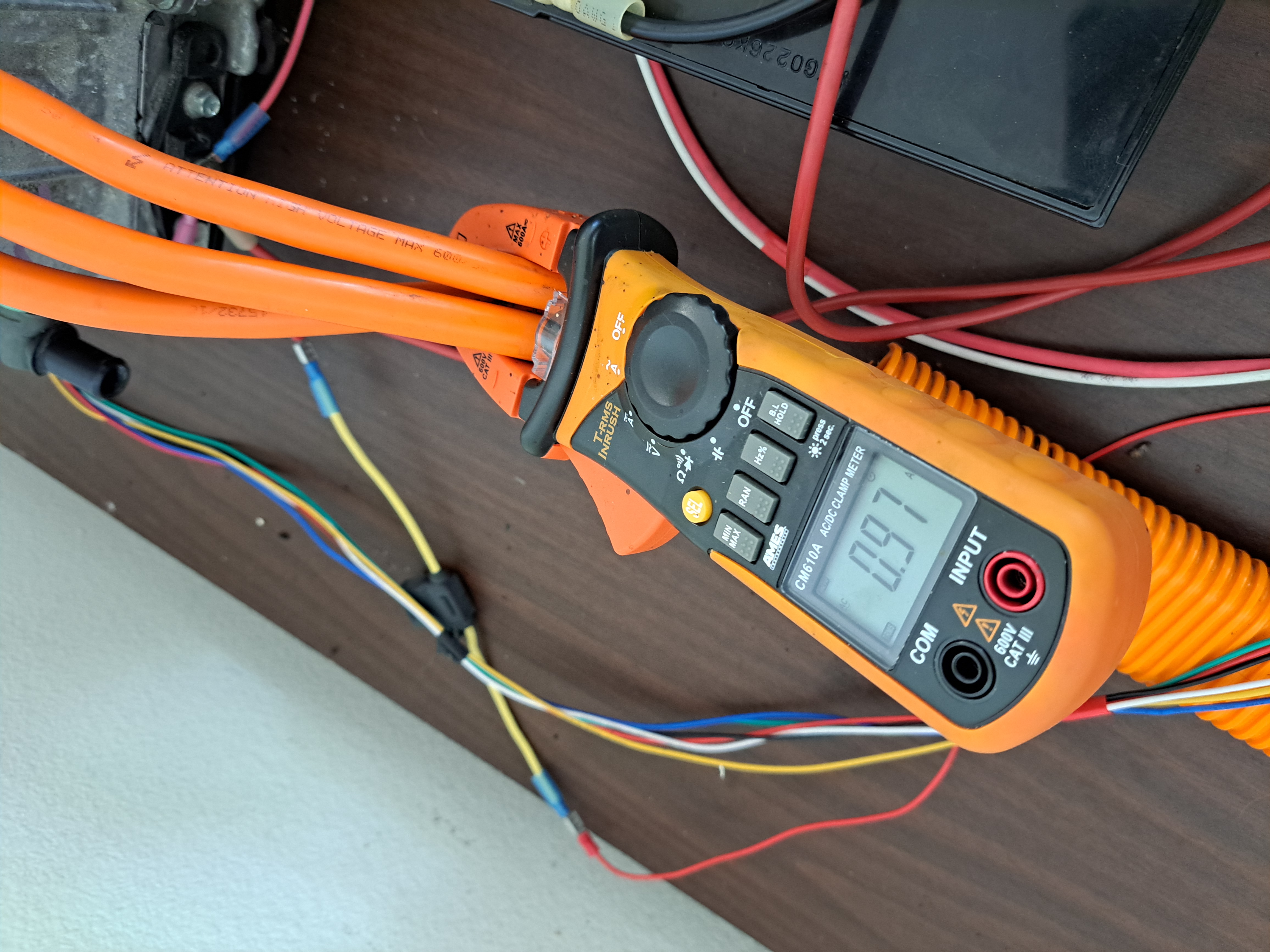

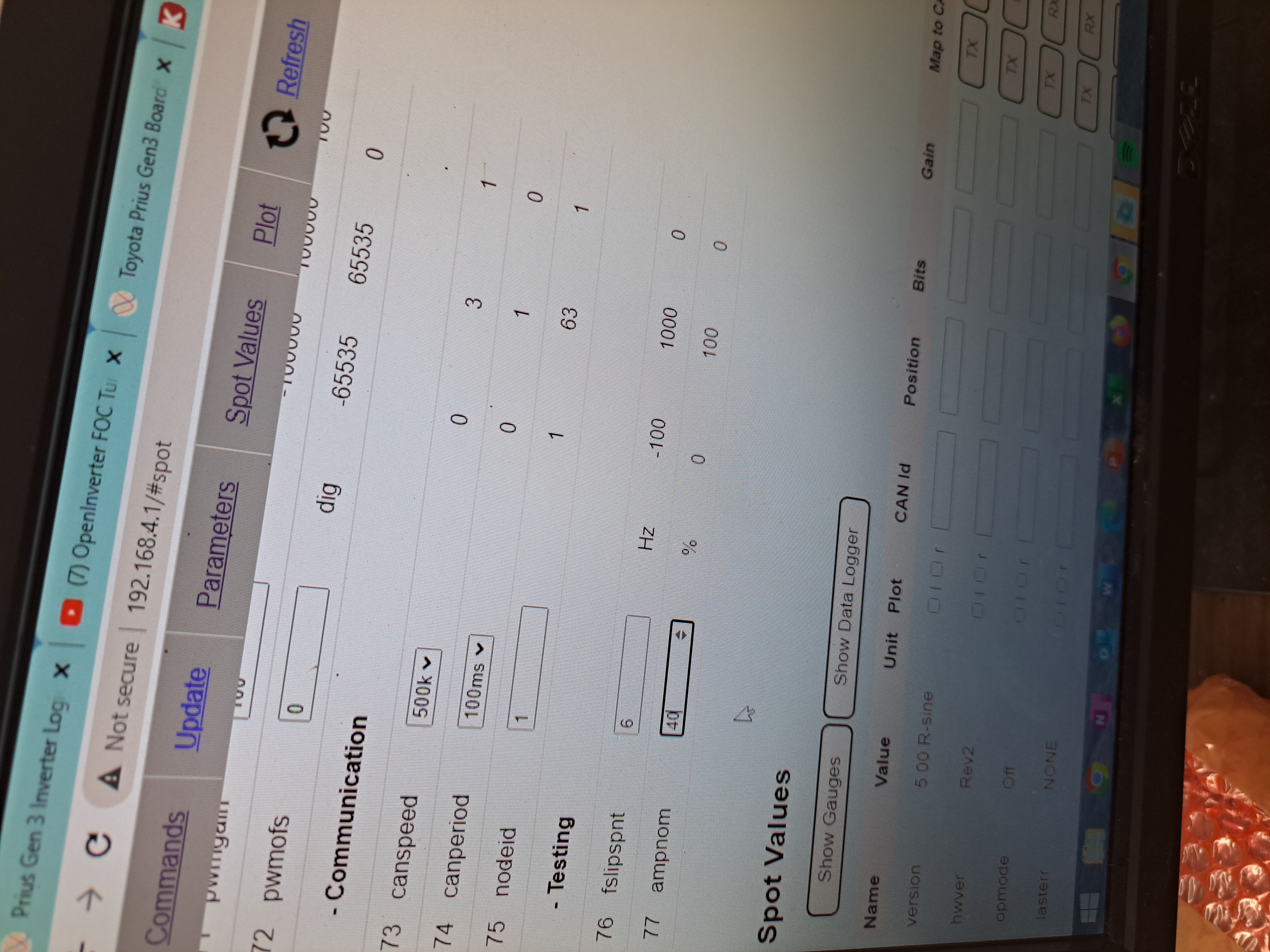

andrewjenkins34
- Posts: 57
- Joined: Thu Dec 17, 2020 1:48 am
- Been thanked: 15 times
Re: 330e Hybrid Swap
Brought it back down to the 110v and I still get an overcurrent error. Pictures show conditions when it happens. Motor runs longer but still triggers overcurrent.
