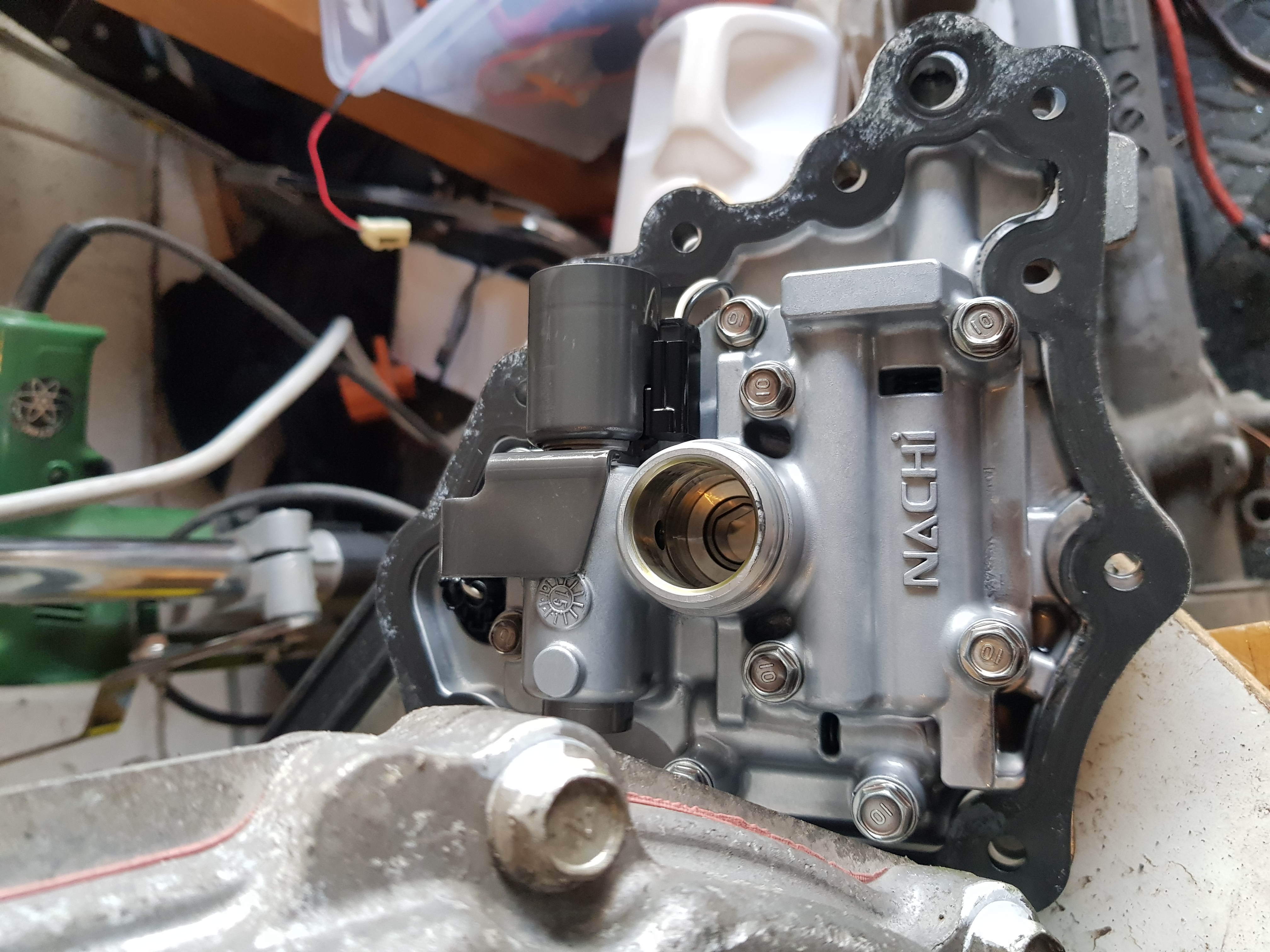

Posts: 1777
Has thanked: 82 times
Been thanked: 426 times
Re: Outlander front transaxle and inverter 3D scans?
Popped the side cover off for a look, not a lot to see.

Posts: 1777
Cracked open the main gearbox today. Will try to get in to the clutch a bit further.

The gearbox looks nice and clear inside. Tiny clutch, even my little 125 looks like it has a larger dia clutch, although this will have more plates and probably more clamping pressure. And probably doesn't have to manage any slip. Could even be a cone clutch? A good way of transmitting more torque in a small space, but wears quicker when slipping. So does it look like the clutch itself is mechanically activated? Or are there hydraulics inside do you think?

I was just thinking, if it's actually mechanically operated (external solenoid/piston pressing/pulling the central pin on the bearing only side) it might be possible to hold it locked with a simple spacer or similar. Or actually, it looks like there's a flat on the shaft? Perhaps locked/unlocked by turning it. Might be able to drive the stock actuator with an external pump.
EDIT: No, duh.. The flat must drive the hydraulic pump, and I think I can see ports both within the actuator and clutch shaft (between the o-rings) so it'll be hydraulically actuated internal. Makes sense. Should be able to lock it by applying hydraulic pressure to that port (probably not that much pressure either, can't transfer much power with a small flat on that shaft)
Posts: 1777
I think you're right, the shaft drives the pump, it looks to be internally activated. I think it'll be similar to a motorbike clutch pack. I don't have a press to remove the gears if that's required to get in.
Might get someone with a tig to have a go at welding it up while it's out.

I think I might be tempted to attack the pump instead of the clutch. If you can drill into the pressure line from outside...
