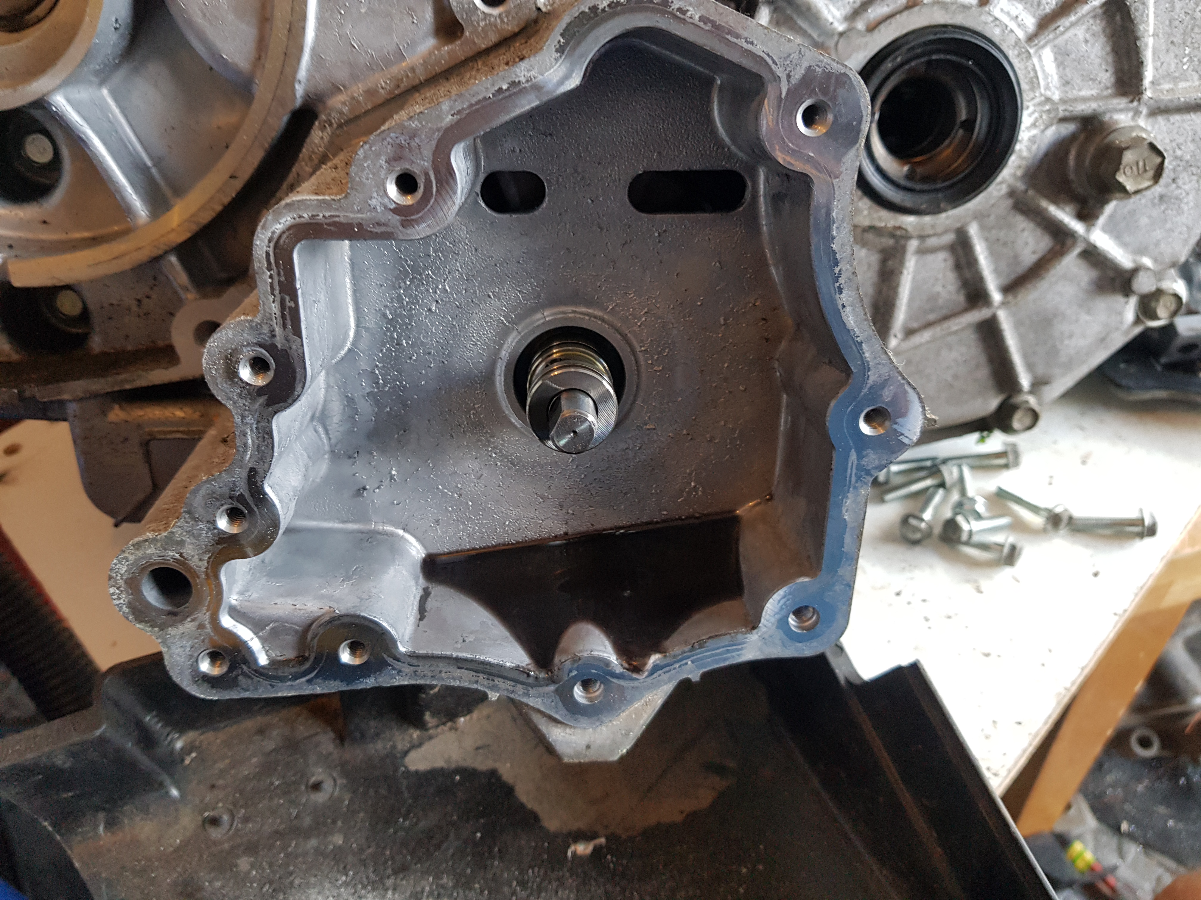

Popped the side cover off for a look, not a lot to see.

- Posts: 1779
- Has thanked: 83 times
- Been thanked: 428 times
Re: Outlander front transaxle and inverter 3D scans?

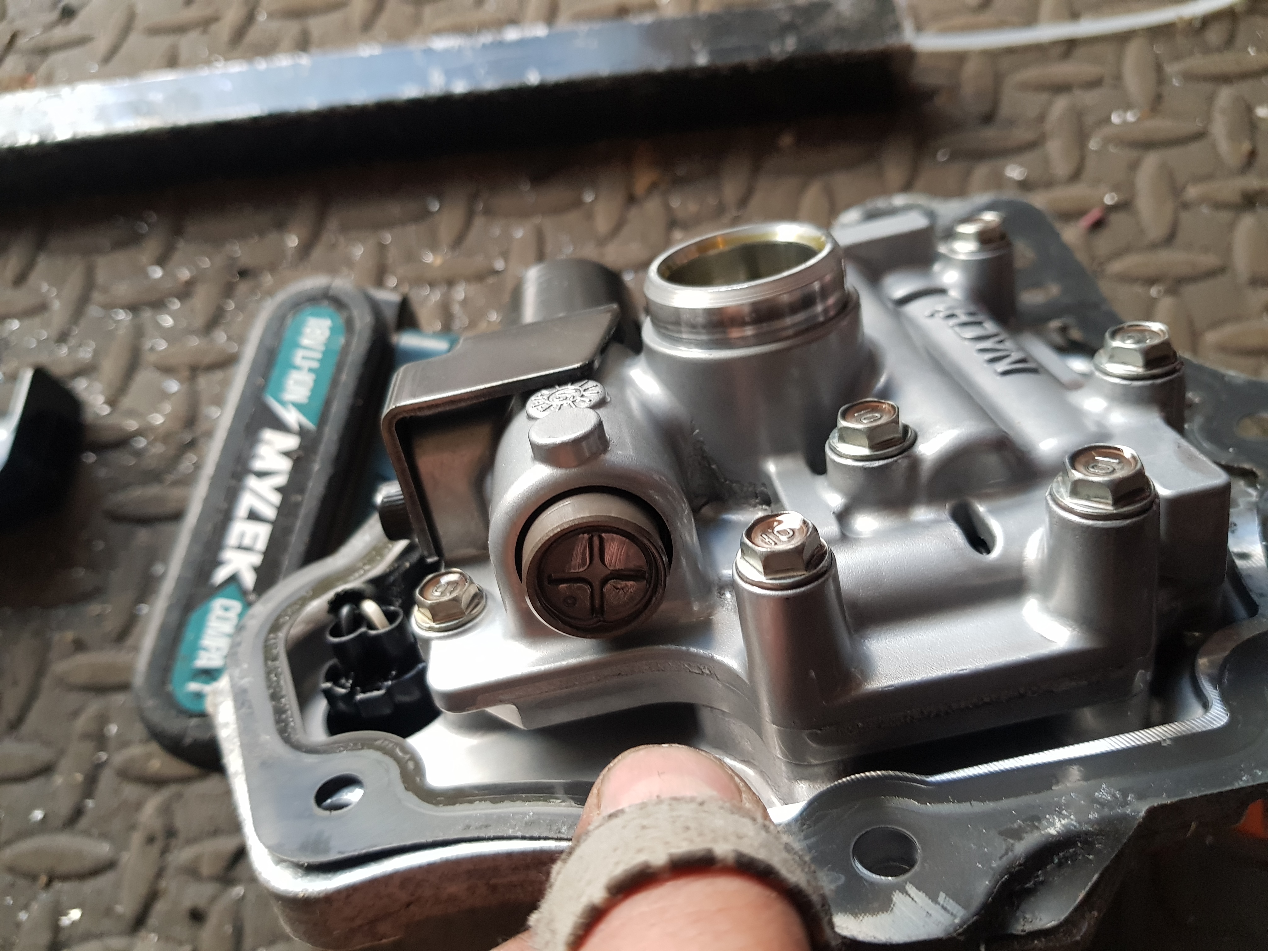

Cracked open the main gearbox today. Will try to get in to the clutch a bit further.
Thanks for those models
I like your Panda CAD too!
The gearbox looks nice and clear inside. Tiny clutch, even my little 125 looks like it has a larger dia clutch, although this will have more plates and probably more clamping pressure. And probably doesn't have to manage any slip. Could even be a cone clutch? A good way of transmitting more torque in a small space, but wears quicker when slipping. So does it look like the clutch itself is mechanically activated? Or are there hydraulics inside do you think?
Not yet worked out how to get inside. Will update further when I'm in
Might have to remove those gears, could be a pain
I was just thinking, if it's actually mechanically operated (external solenoid/piston pressing/pulling the central pin on the bearing only side) it might be possible to hold it locked with a simple spacer or similar. Or actually, it looks like there's a flat on the shaft? Perhaps locked/unlocked by turning it. Might be able to drive the stock actuator with an external pump.
EDIT: No, duh.. The flat must drive the hydraulic pump, and I think I can see ports both within the actuator and clutch shaft (between the o-rings) so it'll be hydraulically actuated internal. Makes sense. Should be able to lock it by applying hydraulic pressure to that port (probably not that much pressure either, can't transfer much power with a small flat on that shaft)
I think you're right, the shaft drives the pump, it looks to be internally activated. I think it'll be similar to a motorbike clutch pack. I don't have a press to remove the gears if that's required to get in.
Might get someone with a tig to have a go at welding it up while it's out.
I think I might be tempted to attack the pump instead of the clutch. If you can drill into the pressure line from outside...
