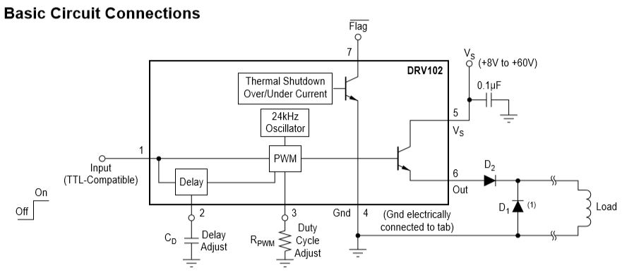

Re: Simp BMS
iirc the Tesla contactors don't have an economiser and will burn up pretty fast.
Re: Simp BMS
I have used tesla contacors. But you need to use the PWM fuction in Simp BMS.Kevin Sharpe wrote: ↑Wed Nov 13, 2019 10:09 am iirc the Tesla contactors don't have an economiser and will burn up pretty fast.
Another option I have tested with Tesla contactors is the DRV102:
You need a capacitor for timing and a resistor to set the hold PWM.
- Kevin Sharpe
- Posts: 1339
- Location: Ireland and US
- Been thanked: 10 times
Re: Simp BMS
AFAIK the OP is planning on using the inverter for contactor control (which is also recommended practice from Damien), so...
Looks good
Re: Simp BMS
It's not so good option if you have a microcontroller. Then you can do the timing in software.Kevin Sharpe wrote: ↑Wed Nov 13, 2019 1:26 pm Looks goodI've added that to GitHub as a wish list item for consideration on future versions of the inverter controller hardware.
Anyway you need one mircocontroller pin for the contactor, so you might as well use a PWM pin.
The DRV102 is intended to use with dumb systems that only have on/off. And in this kind of systems it works really well.
