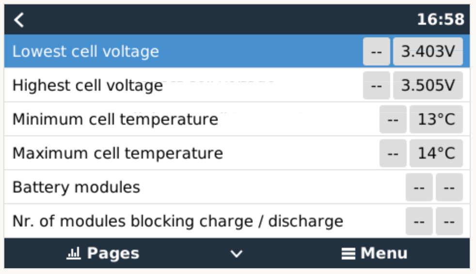

Re: Simp BMS
I just updated Simp BMS Tesla to Firmware Version : 200115, have the same settings as before:
0 - Slave strings in parallel: 1
a - Cells in Series per String: 0
But i get " !!! Series Cells Fault !!! "
Can I just ignore it, or are my settings wrong?
Readings looks like before.
BMS Status : 1 Ready 84
Out:0000 Cont:0000 In:0000
Modules: 14 Cells: 84 Strings: 1 Voltage: 306.309V Avg Cell Voltage: 3.647V Low Cell Voltage: 3.644V High Cell Voltage: 3.652V Delta Voltage: 9mV Avg Temp: 18.590C

Serial console show low temp:18.85C and high temp:19.11C
CAN bus show same temp on high and low:
373 8 39 e 42 e 24 1 24 1
LOW_CELL 3.641
HI_CELL 3.650
MIN CELL TMP 18.85
MAX CELL TMP 18.85
- Posts: 2754
- Location: Bristol
- Has thanked: 264 times
- Been thanked: 717 times
Re: Simp BMS
I will make a test setup for this as the code makes this implausible really.
Wait, its only a difference of 0.26C, so due to it being a full number, no decimals it makes sense. So you need deltas of 1 degree to show up.
Victron screen, not the missing decimal
Re: Simp BMS
Delta 1C is good enough for me, it's only for controlling the water pump.
Voltage is correct, that's what matters.
