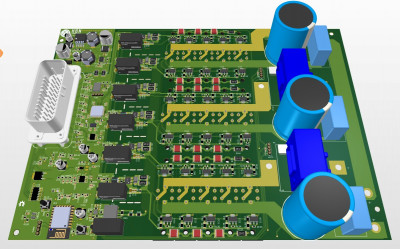

haliltepedelen
Posts: 28
Joined: Sun Apr 24, 2022 10:38 pm
Re: all in one board for open inverter project
Post by haliltepedelen »
Romale wrote: Sun Jun 19, 2022 9:05 pm But I don't know the whole scheme that you use, it can also be good. I would prefer a circuit with a locking transistor, for example Q_off IRFL9110TRPBF, pull_down 4.7K, D_on any schottky per 1 ampere
Hi
The design is done i shared the pdf files if there is no further update i will upload to github

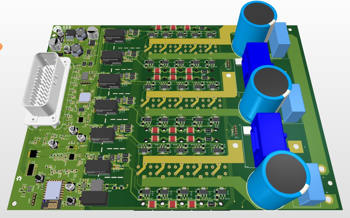

schall-in-one-board-for-open-inverter-project--main.pdf
schematic
(2.32 MiB) Downloaded 414 times
layout
(8.24 MiB) Downloaded 487 times
3d
3d
3d
3d

haliltepedelen wrote: Wed Jun 22, 2022 12:50 pm
Hi

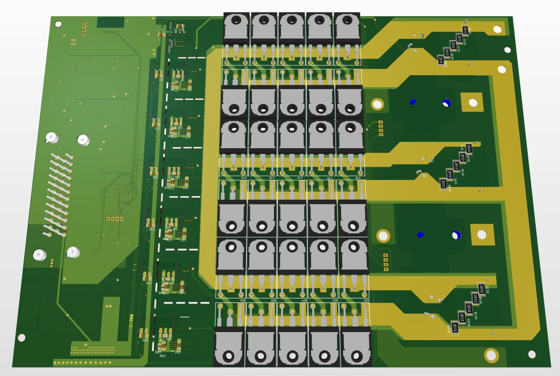

Hello. I think everything is fine. I can try to make
evil neodymium :twisted:

The only clarification is that all layers should be made as thick as possible, at least 75 microns, but it is better if 100 microns

I noticed the absence of this place. how to program?

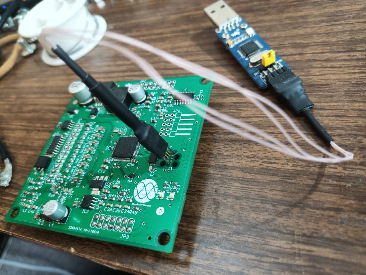

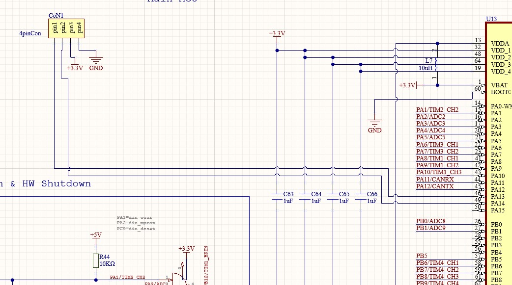

Romale wrote: Wed Jun 22, 2022 3:03 pm photo_2022-06-22_18-01-44.jpg
Hello
I placed 4 pin header close to the microcontroller also can be programmed via esp8266

Romale wrote: Wed Jun 22, 2022 2:40 pm The only clarification is that all layers should be made as thick as possible, at least 75 microns, but it is better if 100 microns
Ok i will make layer stack table for manufacturing

haliltepedelen wrote: Wed Jun 22, 2022 5:00 pm
also high power path not painted can be supported vıa solder ıt will be reduced the board price

haliltepedelen wrote: Sat Jul 02, 2022 9:19 am Hi
The BOM file is done.

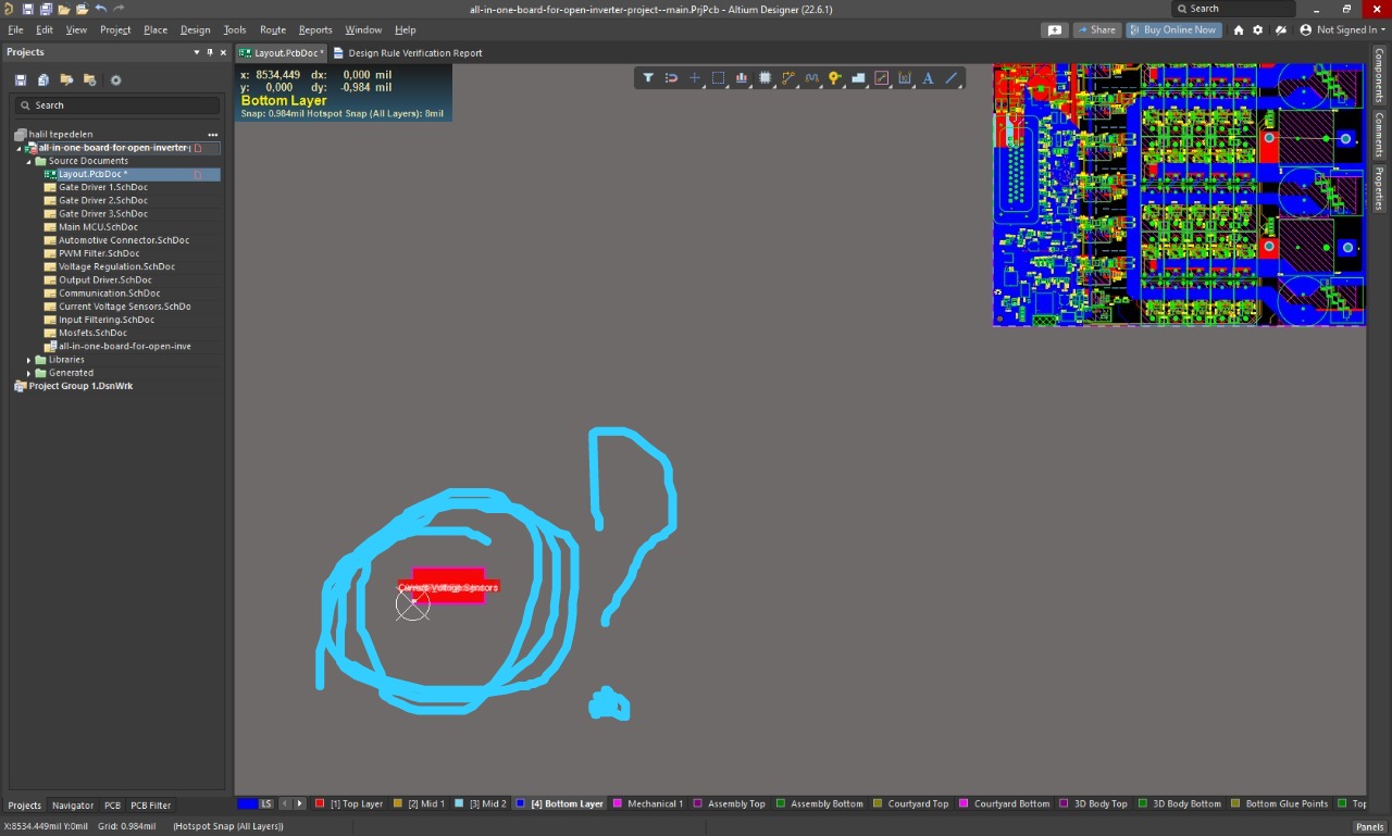

hello. could you give an explanation on this "thing"
haliltepedelen
Posts: 28
Romale wrote: Sat Jul 16, 2022 1:15 pm
Hello
This is room for every sheet you can delete it or it can stay

haliltepedelen wrote: Tue Jul 26, 2022 6:47 am
Hello
hello. I have a few questions. what voltage should c130-c153 be at? and also how to replace the sr2803 chip? I can't buy it anywhere. preferably something that can be bought in China

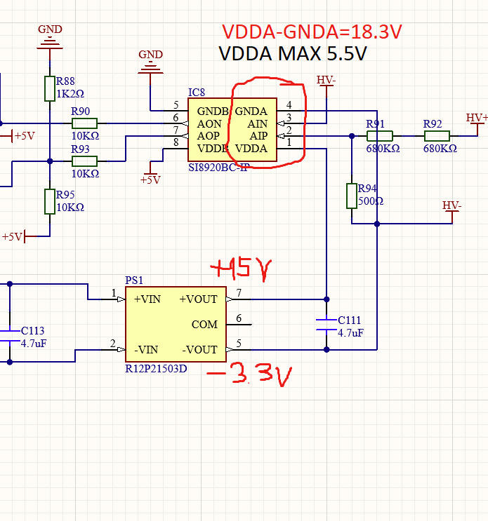

Something is wrong in the scheme. The output of the DC-DC has a voltage of 18.3, and the chip that it feeds is powered by 5V. Maximum 5.5.

I also could not find the ratings of these resistors:
R56,R57,R133,R134,R135,R136,R137,R153,R154,R155,R156,R157,R167,R168,R169,R170,R171,R178,R179,R180,R181,R182,R189,R190,R191,R192,R193,R200,R201,R202,R203,R204

Romale wrote: Tue Aug 09, 2022 9:35 am Something is wrong in the scheme. The output of the DC-DC has a voltage of 18.3, and the chip that it feeds is powered by 5V. Maximum 5.5.
Most likely there should be a dc/dc converter with an output of +5v
