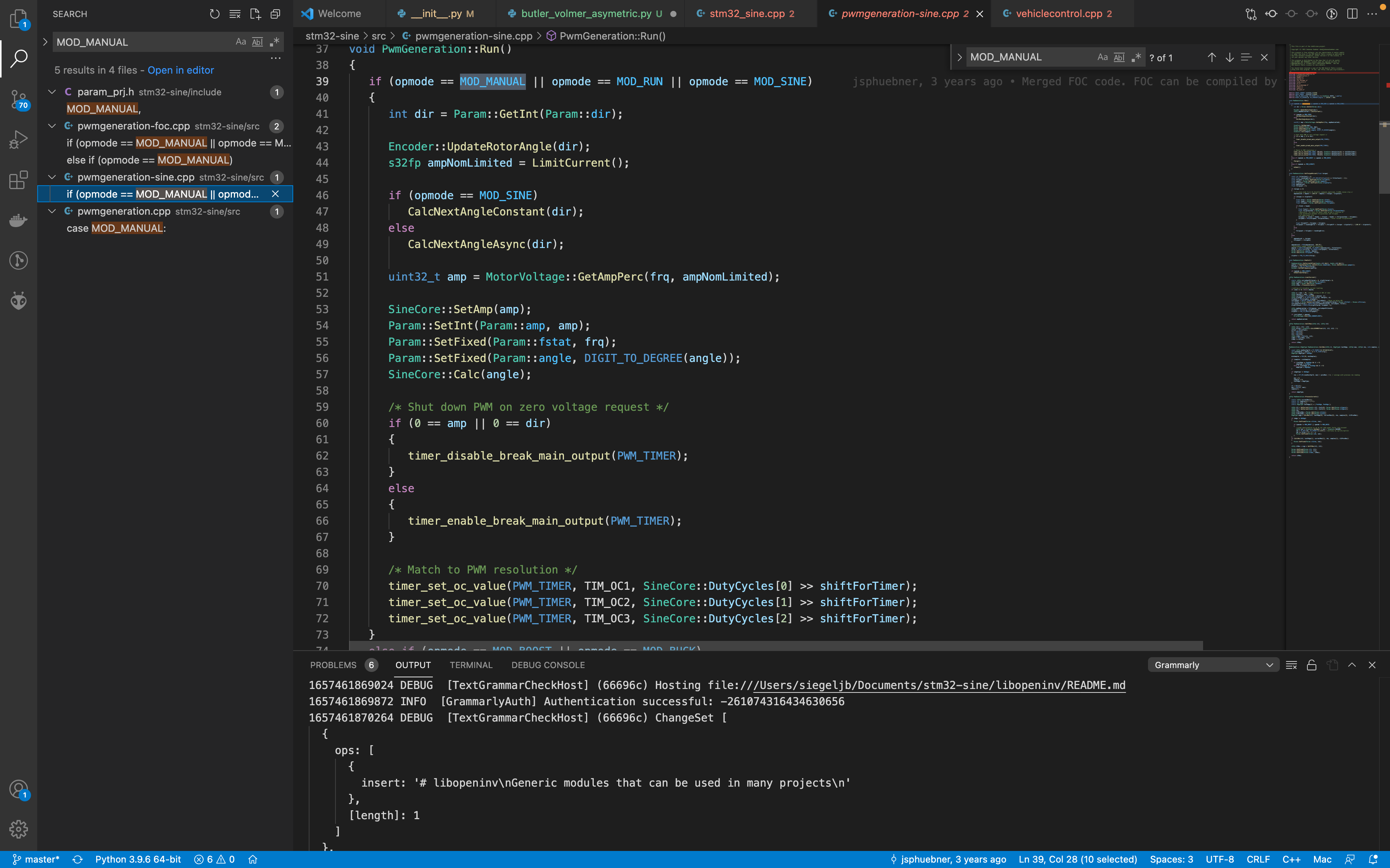

it looks like this also affects manual mode. which might explain why I can't get any PWM output when testing in manual mode. I will try connecting the forward signal and report back.
1988 Porsche 911 targa with warp11 motor. Soon to be Tesla SDU.
Posts: 6765
Has thanked: 383 times
Been thanked: 1584 times
Re: Behaviour in neutral
Oh indeed, in manual mode you also need to select a direction

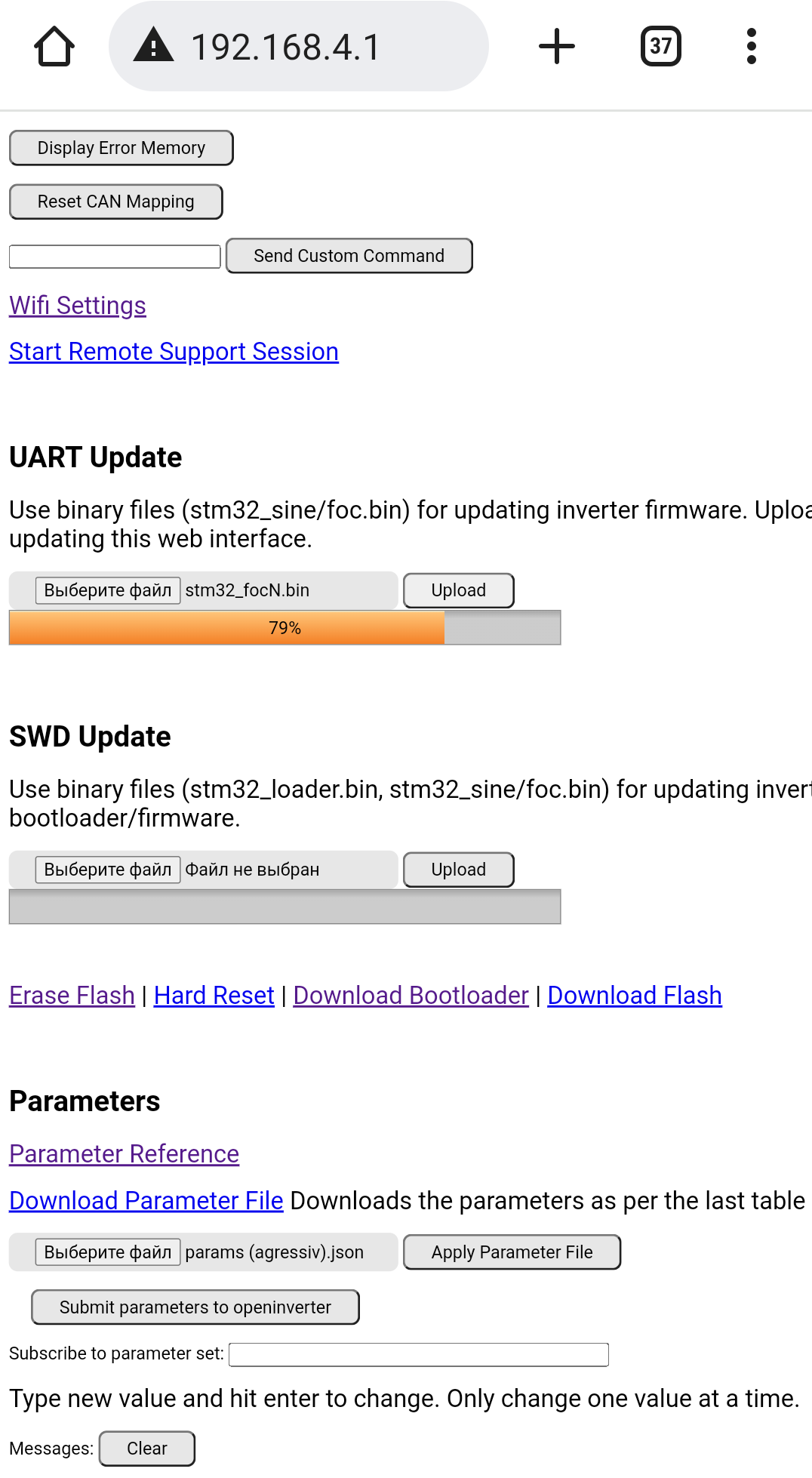

Romale
Posts: 530
Location: Romania
Has thanked: 314 times
Been thanked: 81 times
Post by Romale »
johu wrote: Wed Jul 13, 2022 6:19 pm Please check if it works.
It looks like I have the worst memory chip for wifi. it is constantly hanging at this stage
