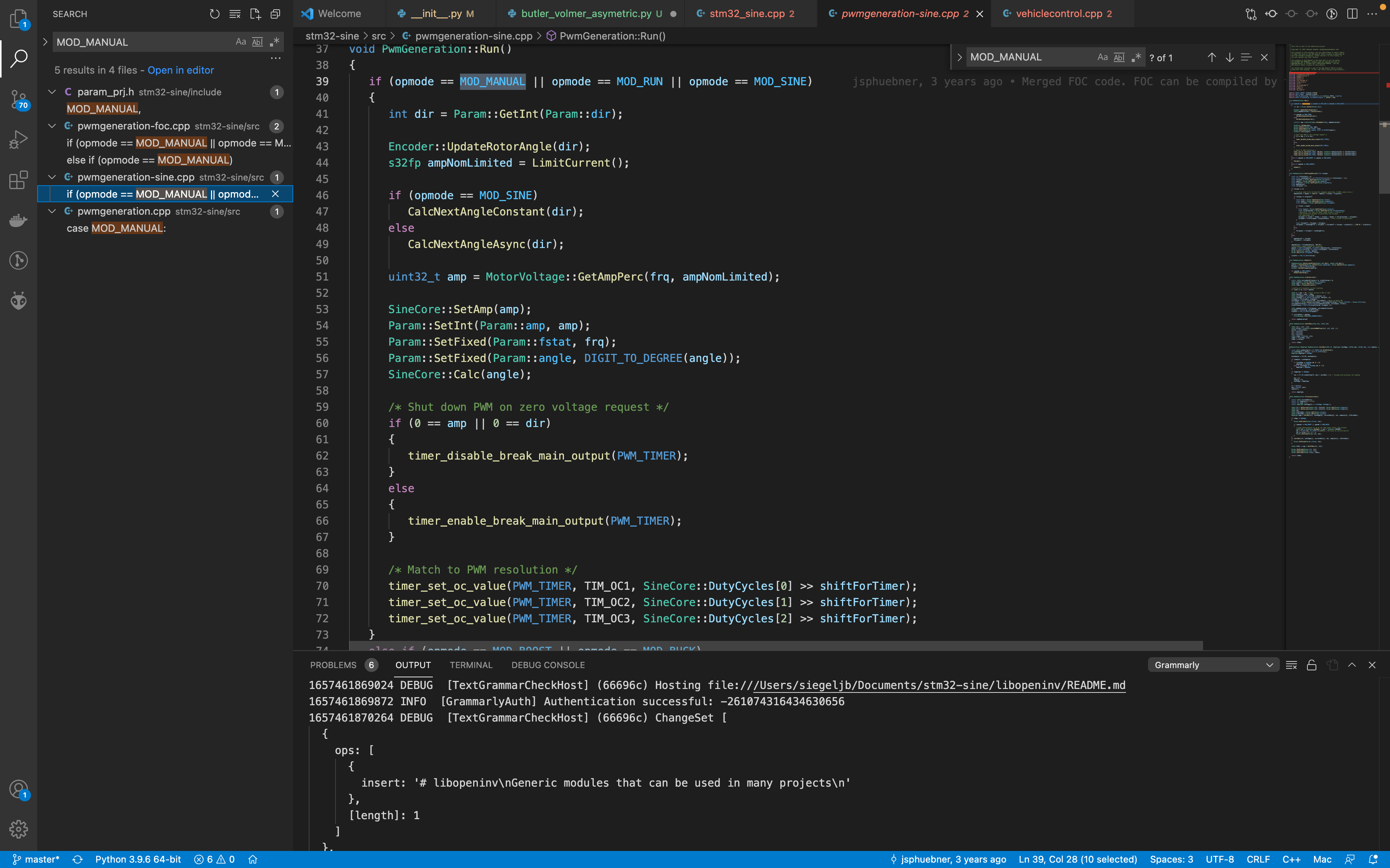

js1tr3
Posts: 43
Joined: Thu Jun 13, 2019 11:28 am
Location: A2 usa
Re: Behaviour in neutral
Post by js1tr3 »
it looks like this also affects manual mode. which might explain why I can't get any PWM output when testing in manual mode. I will try connecting the forward signal and report back.
1988 Porsche 911 targa with warp11 motor. Soon to be Tesla SDU.
Been thanked: 1918 times
Oh indeed, in manual mode you also need to select a direction
