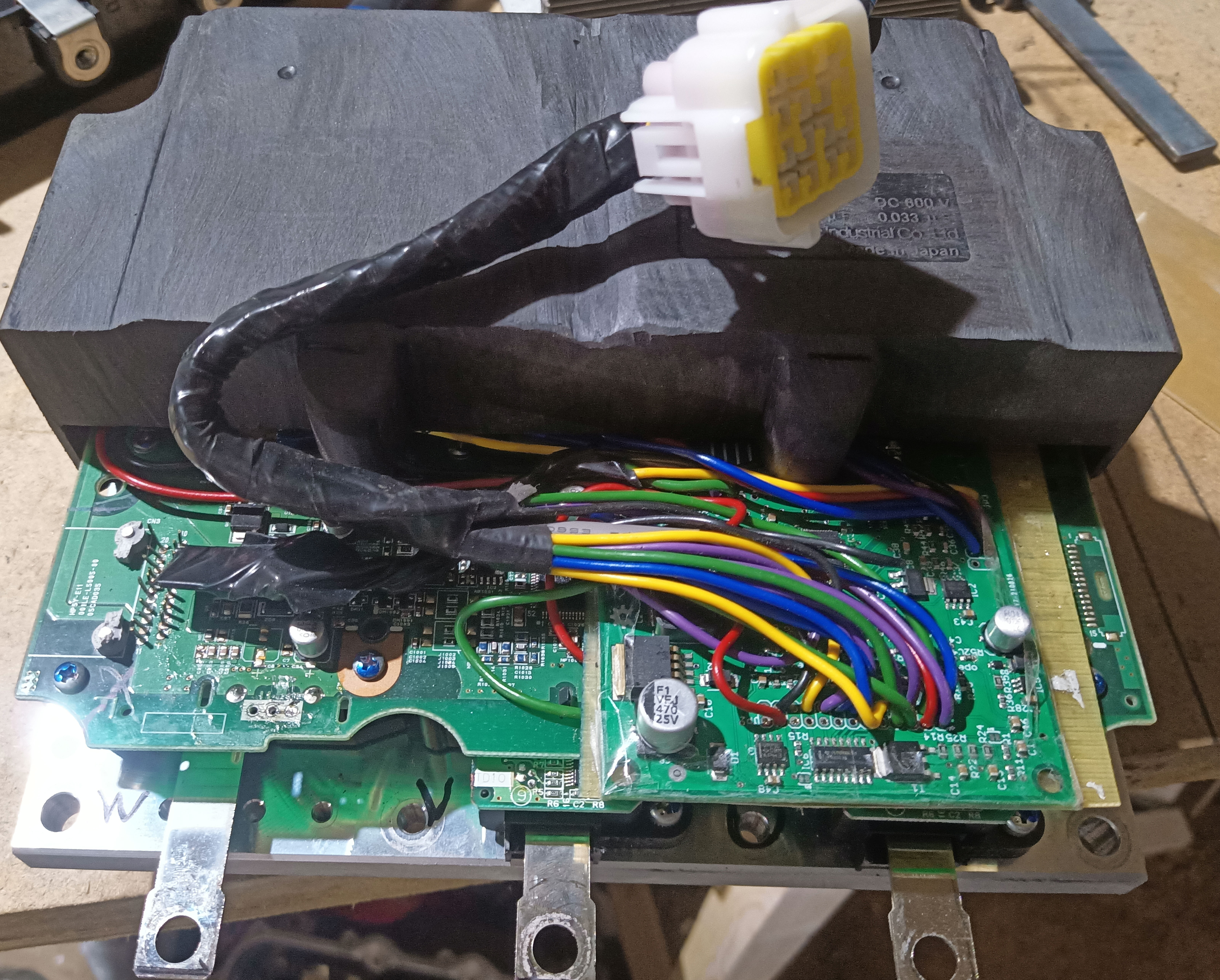

I finally did it!
The Honda IMA is running and powered by the V3 board.
evil neodymium :twisted:

Not everything is as good as it seemed. The Honda Ima inverter worked perfectly at a voltage of about 70 volts, but as soon as I added 6 more cells and the voltage rose to 96 volts, overcurrent often began to hit. If the voltage is even higher (130 volts), then the motor does not start at all, it makes several turns and stops with a current error.
I used the current sensors from nissan leaf gen2 and its own proven setup for these sensors.
Voltage measurement was not carried out at all.
Who has any thoughts on this?

Romale wrote: Tue Jul 12, 2022 9:52 am Not everything is as good as it seemed. The Honda Ima inverter worked perfectly at a voltage of about 70 volts, but as soon as I added 6 more cells and the voltage rose to 96 volts, overcurrent often began to hit. If the voltage is even higher (130 volts), then the motor does not start at all, it makes several turns and stops with a current error.
If i remember correctly we used 4K7 pulldown resistors on current sensor lines. But that was with Lebowski drive.
IMA should be good up to 150Vdc.
Try it maybe it works for you too.

arber333 wrote: Tue Jul 12, 2022 10:21 am
is it on the output line relative to +5 volts or relative to the gnd?
Posts: 3570
Has thanked: 134 times
Been thanked: 339 times
Re: prius gen2 mg1 + leaf invertor gen2 + honda ima
Romale wrote: Tue Jul 12, 2022 10:24 am is it on the output line relative to +5 volts or relative to the gnd?
No, from each sensor output you put one 4K7 resistor towards GND. Preferably as close to the sensor as possible to pull down on the noise.

Now I took the second Honda ima inverter, left the native driver power board and native current sensors on it, connected only the brain board v3 and it works fine without errors at a voltage of 130 volts!
Probably the first inverter in which I replaced the power supply of the drivers with dc/dc 2 watts, the power supply is too weak.
