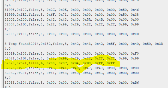

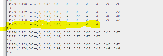

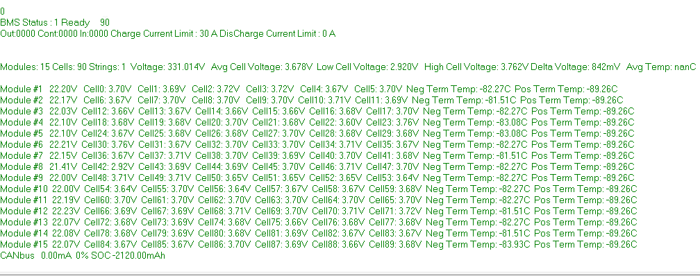

Hi Tom,
I have looked everywhere trying to get my Board to work with the IVT
I think i got it working but obviously there is a config issue.
I got a new Sensor connected and initialized by using Damien's script,
and i can get reading out of it from CAN receiver and it is working precisely as it should
Now I'm trying to get it to play nice with Simp but cant get it it work.
here is my system
It is SIMP ( BMW PHEV ) rev = 220531;
Every thing is working great with the Battery Pack i got all the info correctly and all 96 cells are reporting voltage Temp and delta.
it is connected to the can Wires where the BMW slave BMSs are.
Resistance between Can Hi and Can Low is 61 Ohm so it is terminated correctly.
When i toggle the can debug i can see the Current sensor frames both when there is no current and when there is 10 A going through it.
see attached Pictures.
my settings for the current sensor is obviously CAN Bus and the current sensor is IsaScale
but nothing shows on the Current debug nor the Current number on the screen.
So what im doing wrong ?
What parameters i need to initialize ? like what can speed the Current sensor needs to be ? it is now at 500K
Current message id is 0x521 which matches the code, i checked the source file and it is working.

7yatna wrote: Wed Jul 06, 2022 3:03 am I have looked everywhere trying to get my Board to work with the IVT
Karim
Karim, Thank you for pointing this out a coding error slipped in. I was calling for the wrong canbus message structure in this version. rxBuf instead of inMsg.buf
Will check and update all versions where required.

Hi Tom,
Glad that we found the culprit, i did actually found couple of minor little things and fixed them on the fly as well but it was not affecting the Functionality of the BMS it was more of cosmetics and related to the screen data, but i didn't want to play with the CAN commands and was pretty sure that critical functions are solid and way above my head.
For instance the Status was not updating on the Screen due to an extra termination Command for the Nextion Display was added which some how affected only the Status Variable,
as well the balance variable wasn't updated at all so i figured a way to show me if the BMS is balancing or not on the screen.

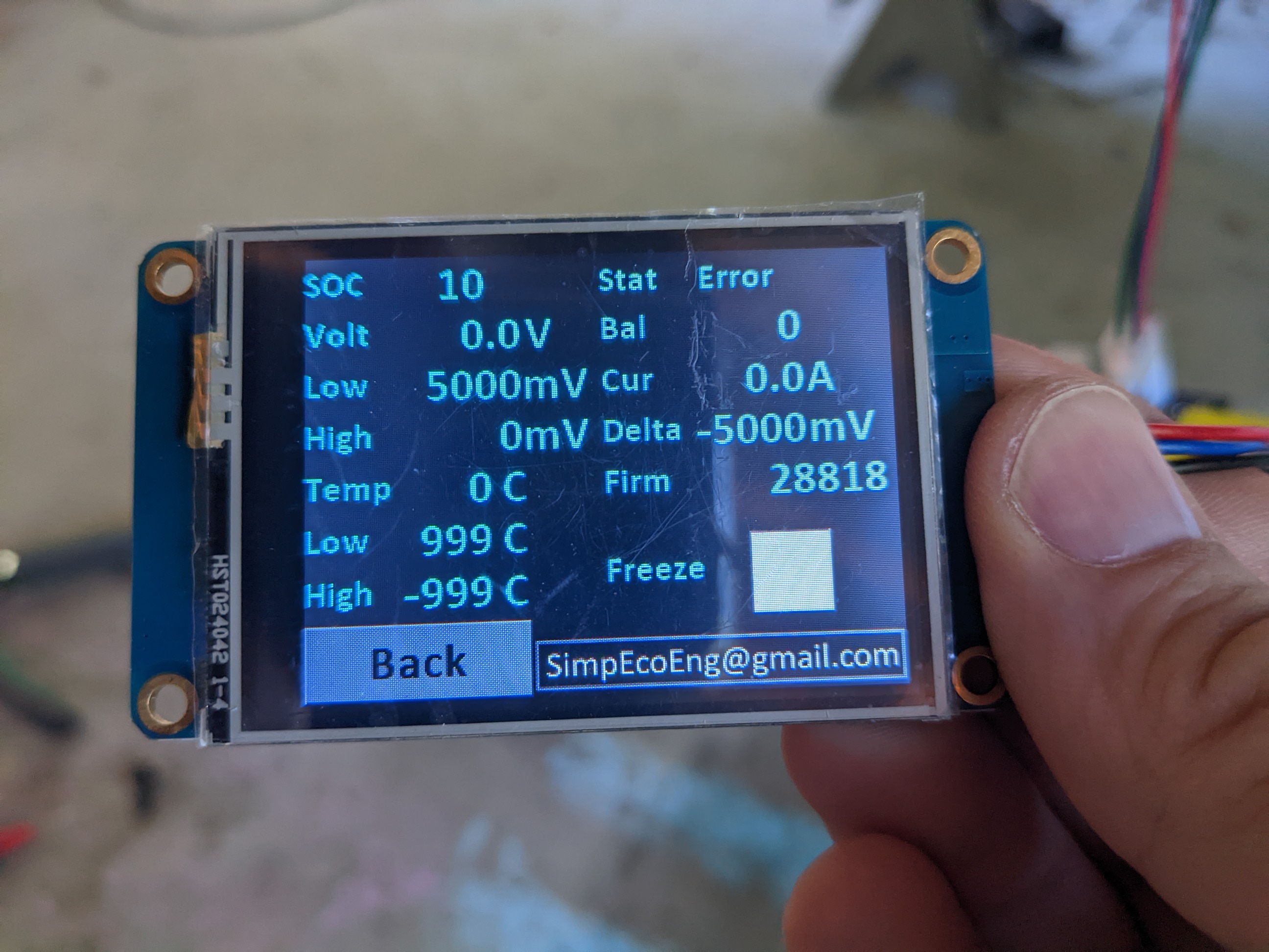

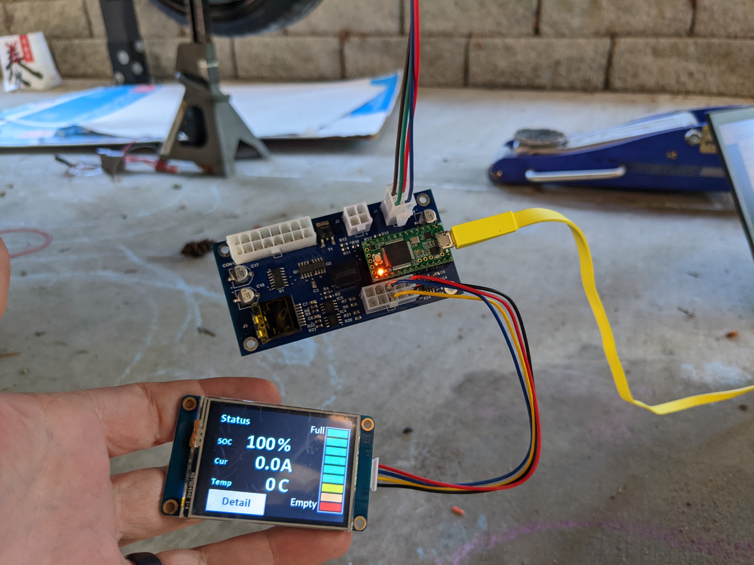

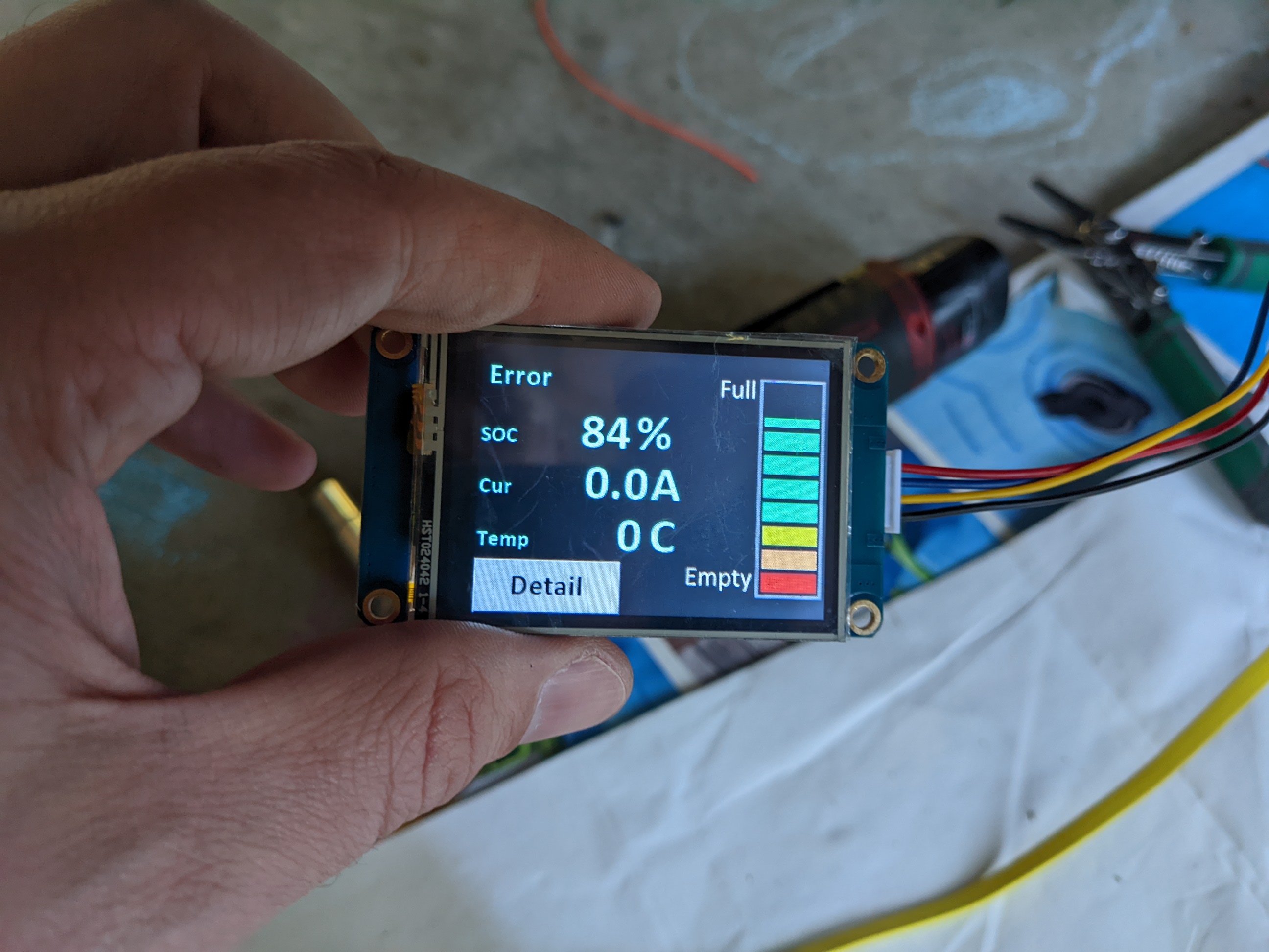

Was expecting this would be a good test:
Can I not run the SimBMS off the usb alone? That's by best guess as to why i can't get out of status 5. I have 5v on the Tesla connector and have triple checked the Tx Rx connections. As well, I've configured the BMS with correct cell counts and such.
I am not using any temp sensors so i've set those limits to -200-200C. maybe that's a bad idea.

Re: Simp BMS
You check the serial debug first?
Try swapping TX and RX for the display.

Post by vwbrady »

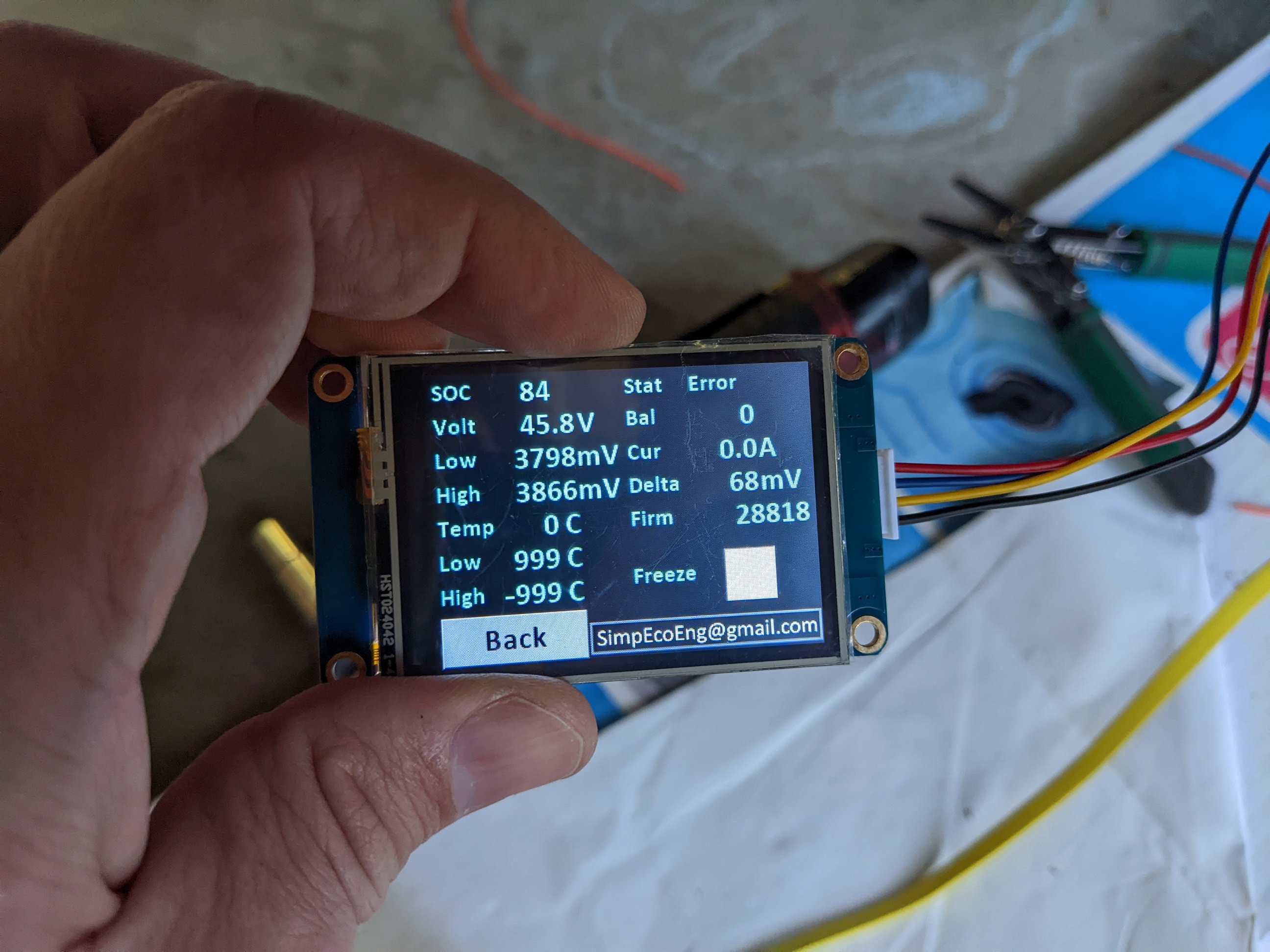

i think after referencing the wiring for the 30th time. the Rx and Tx might be switched. i'll be checking that soon.
now im sure i have the module boards wired with 4/9 = In, and 2/7 = out. the swapping wire colors i think threw me off :?
but if i just switch them, i'll be reading cells 7-12, then 1-6. would that still work? I feel like you should be reading them sequentially.

tom91 wrote: Tue Jul 12, 2022 8:23 pm You check the serial debug first?
I did check the serial debug and there were a bunch of 0s. i can't say i paid a ton of attention to it so far :oops:
swapped the display serial connections and, yes! it's clearly reading the BMS now. i did this with a USB powerbank, but i'll get my lap top out there next.
i'll also re-wire another set of boards to correct the Tx Rx there.
thanks for your help Tom!

Post by vwbrady »
Success! Now for 84 more cells

Figured out the missing temperature feedback value on the canbus.

This probably isn't anything to do with the SIMP bms. But I thought I would try here first.
I have simp BMS running on 15 tesla Model s slave boards. Getting communication with all boards minus temperature. However I am getting one cell reading very low (cell 42 in module 8, 2.92v) which is a bit confusing. When I measure the cell manually with a multimeter I get 3.69v just like all the other cells around it. I have also taken readings from the pcb board of the tesla board just in case there was a dodgy connection between the cell wire and the board, same value of 3.69v.
Oddly it isn't showing any undervoltage errors which it should I think as the under voltage limit is set at 3v.
I'm guessing maybe the tesla board itself is the issue. I'm thinking of putting some charge into it or running the motor a small bit. Maybe a change in voltage will jog it, but that seems unlikely. Has anyone else come across this sort of thing before?

1)First step is the wireing inside the tesla module itself.
measure on the BMS board all voltages instead on the cells.
2) Try swapping the BMS board with another one. Does the issue move allong with the board?
