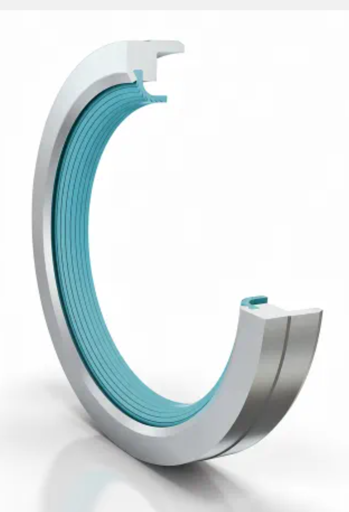

Guess what: SKF actually showcases "SLX"(?) PTFE seals with concentric cuts (as in my Tesla DU, see my previous msg) here on their website, repeated here:
So maybe SKF is the supplier after all. Or not, who knows. Also: "The majority of PTFE radial shaft seals from SKF are made to order to meet the demands of each application." - Source p.98.

I think that most of SKF's PTFE seals are custom made to order. The closest SKF off-the-shelf catalogue seal that matches the desired dimensions and is able to run at 12,420RPM is the rubber(!) seal model HMS5 V, but that one is "designed for oil or grease lubricated applications" (source). The problem is that the viscosity ("thickness") of coolant is much lower than oil/grease so the seal and shaft surface roughness asperities may contact each other, leading to fast seal wear. However if the shaft is smooth enough, it may work "for a while". Anybody wants to test this out, or does anybody have a reference with info that dismisses this proposal?

This guy bought a replacement seal from HybridRevolt. I contacted both the youtuber and HR, but no reply yet.

What seal are you using?
SuperV8
Posts: 162
Has thanked: 67 times
Been thanked: 14 times
Post by SuperV8 »
Vsevolod wrote: Tue Jul 12, 2022 7:30 pm
SuperV8 wrote: Tue Jul 12, 2022 6:19 pm
Johan wrote: Sun Jul 10, 2022 10:38 pm Maybe we just have to live with a bit of a leak and install a drain and 12V pump it back to the coolant reservoir (drill small hole next to reluctor wheel etc etc).
Also check a good related thread on ENG-TIPS.com. From this thread (FWIW):
We have seen this before!: FKM is a fluoro rubber, and the SKF seal "HMS5 V" lip is actually made of this. This gives some hope that this seal may work. An advantage of a rubber may be that it is more forgiving for small shaft eccentricities w.r.t. PTFE.
This is my thought. I think I would be looking at drilling a weep hole with suction pump, or pipe and suction pump - so when this seal leaks again it doesn't matter and cause catastrophic damage.
I re-built my centrifugal supercharger (basically a belt driven turbo) which destroyed its high speed bearing - 80,000max RPM! (though I found the bearing they used only had a 20,000max rating!! :x ) I was able to eventually find a ceramic balled very high speed bearing from Barden which I could buy individually - though rather expensive (£100 each)! but I could not find a seal for sale anywhere (PTFE high speed rating) which I suspect you will find here with this Tesla DU. You can find the seal's in catalogues BUT they (SKF/Saint Gobin/Trelleborg etc..) are not interested in selling 1 to an end user - the best I found was an MOQ of something like 100! at £10 piece price!
I had to use an off the self rubber type seal - and just increase my maintenance checks on the oil. So far its holding up well - though it doesn't spend much time at 80000 if ever!
Got my Barden ceramic bearing from:
https://alpinebearing.com/
And got the seal from
https://928motorsports.com/ (- they specialise in superchargers so probably have a limited sizes.)
The seal was a GST seal
https://www.gstracing.co.uk/bearing-seals/
