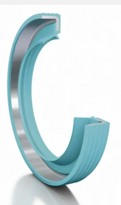

Guess what: SKF actually showcases "SLX"(?) PTFE seals with concentric cuts (as in my Tesla DU, see my previous msg) here on their website, repeated here:
So maybe SKF is the supplier after all. Or not, who knows. Also: "The majority of PTFE radial shaft seals from SKF are made to order to meet the demands of each application." - Source p.98.

I think that most of SKF's PTFE seals are custom made to order. The closest SKF off-the-shelf catalogue seal that matches the desired dimensions and is able to run at 12,420RPM is the rubber(!) seal model HMS5 V, but that one is "designed for oil or grease lubricated applications" (source). The problem is that the viscosity ("thickness") of coolant is much lower than oil/grease so the seal and shaft surface roughness asperities may contact each other, leading to fast seal wear. However if the shaft is smooth enough, it may work "for a while". Anybody wants to test this out, or does anybody have a reference with info that dismisses this proposal?

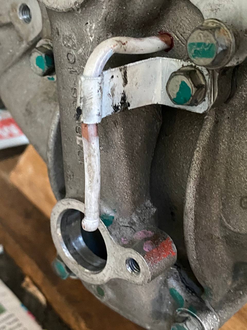

Yes, that's what I'm talking about. In order for the new seal to last longer, it is necessary that the surface of the rotor be in a normal state, and if there are grooves and irregularities, then the new seal will quickly fail
I made a drainage hole with a tube (screwed in) to make it harder for debris and moisture to get in from the outside, and the antifreeze itself is quite fluid and will have to come out (in theory)
drainage hole
drainage hole

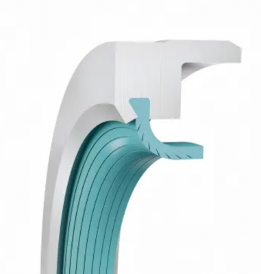

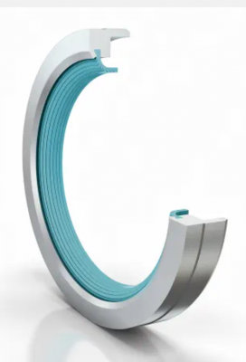

Johan wrote: Sun Jul 10, 2022 6:11 pm @Boxster EV: O no! Thanks for the update!
Threaded sealing lip which pumps the media away from the seal:
https://www.omniseal-solutions.com/comp ... lip-seals
As noted in the specifications, this should only be used in lubricating media. It looks like this could be a big reason that the original seals fail consistently. If a seal was used that was designed only for lubricating media, it makes perfect sense that it would not last long.
Higher speed seal with better leak-proofing:
This part of the line appears to be for higher speeds (although the speed listed looks about the same) and is described as being long-life, low maintenance, and super leak resistant.
All of these product lines (10 to 90) are listed as "catalog" products not custom solutions, so there should be some way to get a hold of a distributor. However, it does not appear that any of these are made for bi-directional operation.

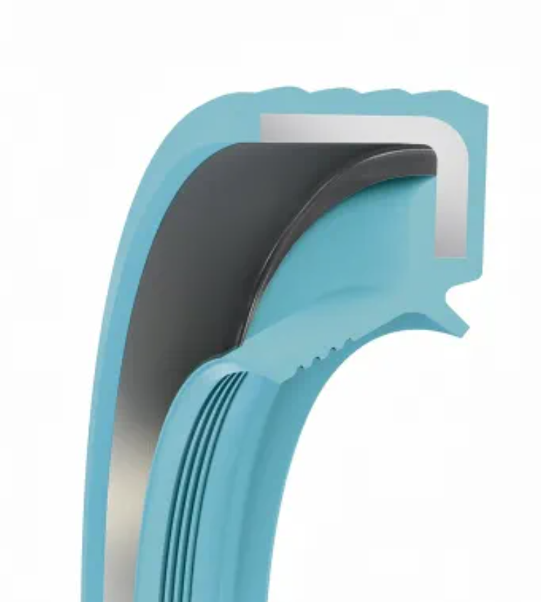

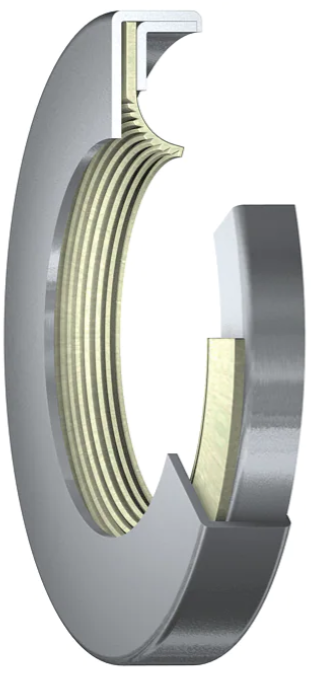

Found the Holy Grail... this might be exactly what we all need to get our hands on:
https://www.trelleborg.com/en/seals/pro ... in-pdr-rt
https://www.trelleborg.com/en/seals/pro ... spin-hs40
You all would know more than I would about the specific needs of the application though, as to which one would suit the needs better between these two. I haven't taken my motor apart yet.
