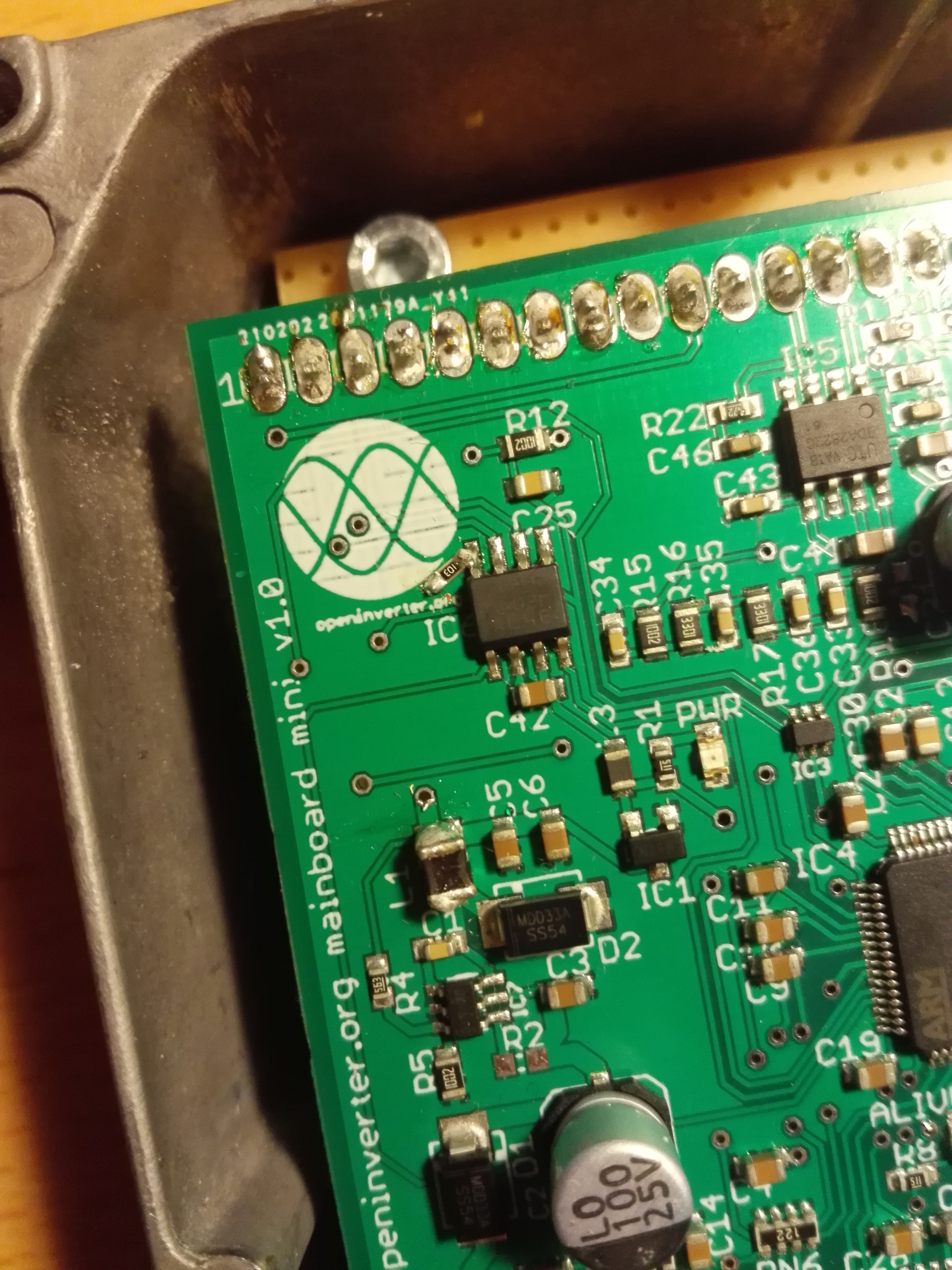

I think there is an error on the mini mainboard resulting in lack of CAN communication. The slew rate pin is floating but needs to be tied to ground with a resistor. I scratched the GND plane a bit and soldered in a 10k resistor. Can be any value from like 0R to 20k whatever is in your parts bin (the value controls the slew rate)
Re: Lack of CAN communication new Nissan Leaf adapter board
Hi @johu, I believe you fixed this already in your git for the mainboard-mini.sch and mainboard-mini.brd (however the PDF File of the schematics is not updated).
pdf updated
I usually publish gerbers on patreon earlier. Not planning to publish manufacturing data just yet. But gerbers are easily generated with freeware eagle
Here it is https://github.com/llange/openinverter- ... board-mini .
I tried to stress it in the README - there are certainly errors introduced during the conversion. I tried my best but don't have that much experience using KiCad nor designing boards.
I also tried to express the fact that it's a modification of your work @johu - so that any issue with this repository will not negatively impact the original design.
I'm interested in all review / criticism / issue opening / merge requests / etc... that can allow this converted design to be as close as possible as the original one.
(And if one day @johu you want to "adopt" this as you main source it'll be my pleasure to transfer the repository to you.)
