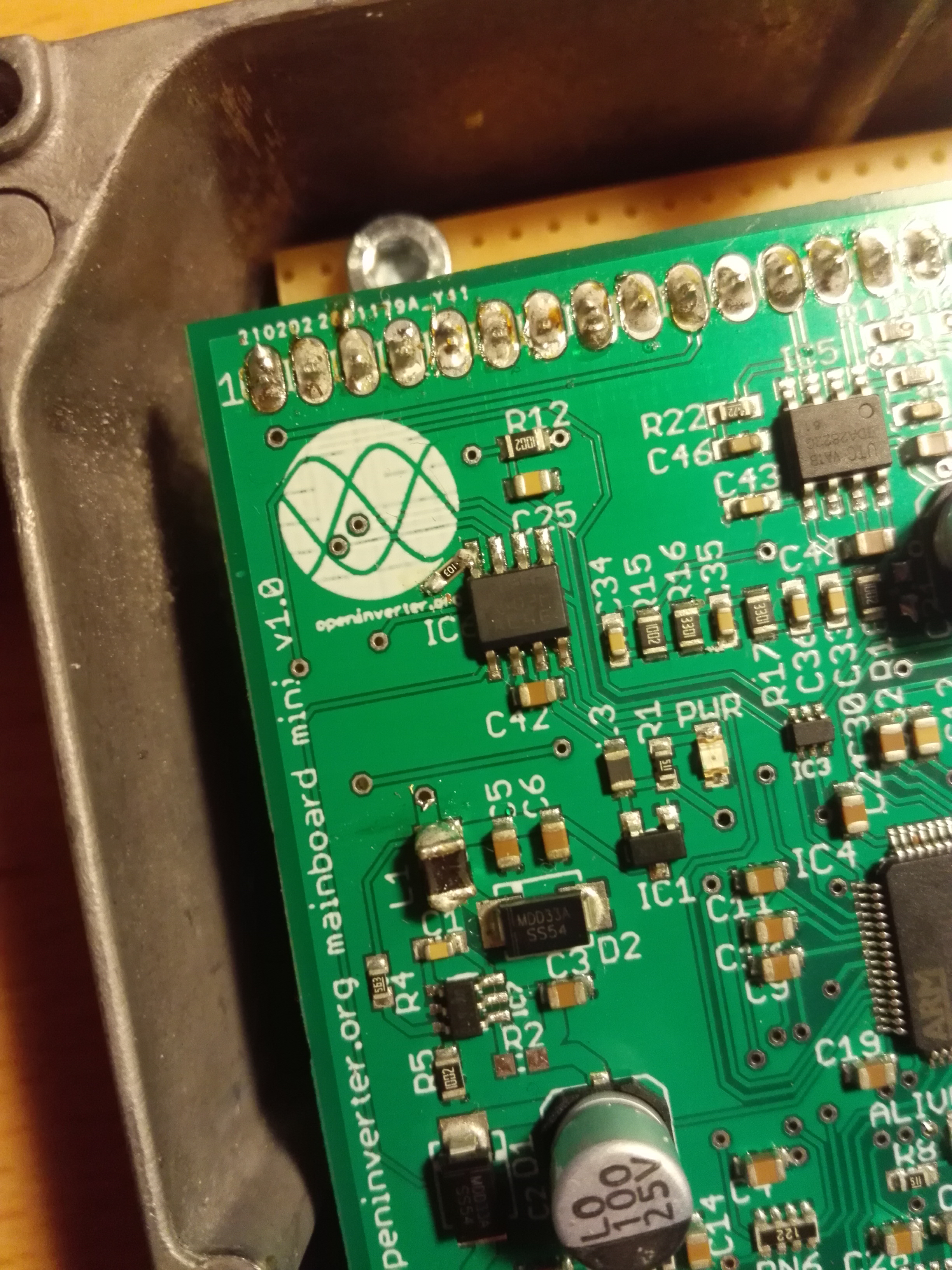

I think there is an error on the mini mainboard resulting in lack of CAN communication. The slew rate pin is floating but needs to be tied to ground with a resistor. I scratched the GND plane a bit and soldered in a 10k resistor. Can be any value from like 0R to 20k whatever is in your parts bin (the value controls the slew rate)
Re: Lack of CAN communication new Nissan Leaf adapter board
Hi @johu, I believe you fixed this already in your git for the mainboard-mini.sch and mainboard-mini.brd (however the PDF File of the schematics is not updated).
Would it be possible that you also share the Gerber files, BOM and Placement file ? I was wanting to convert this schematic/board from Eagle to KiCad, and having those would help me compare the expected result and make sure that my conversion was correct.
Another related question : are the adapter boards (for Nissan Leaf Gen2 ; for BMW i3 ; may be other) open hardware or not ? If so I was not able to find the related schematics / boards and was wondering if you could point me in the right direction.
pdf updated
I usually publish gerbers on patreon earlier. Not planning to publish manufacturing data just yet. But gerbers are easily generated with freeware eagle
The files are eagle 6.4.0 which didn't have any registration nonsense going on
Maybe 6.6.0 doesn't either? http://eagle.autodesk.com/eagle/software-versions/10
Yes KiCAD is preferred! Just hadn't switched to it for this design. So yes please publish it.
So in that case I might as well attach gerbers here
Here it is https://github.com/llange/openinverter- ... board-mini .
I tried to stress it in the README - there are certainly errors introduced during the conversion. I tried my best but don't have that much experience using KiCad nor designing boards.
I also tried to express the fact that it's a modification of your work @johu - so that any issue with this repository will not negatively impact the original design.
I'm interested in all review / criticism / issue opening / merge requests / etc... that can allow this converted design to be as close as possible as the original one.
(And if one day @johu you want to "adopt" this as you main source it'll be my pleasure to transfer the repository to you.)
