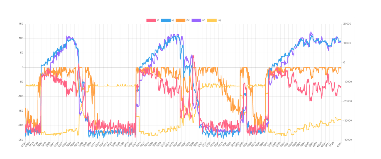

We tripped the overcurrent limit at 65mph today when removing foot from the throttle.
Got -180A, thats -64kW of braking @ 356V!
ChaDeMo is -50kW I suppose, so we are vaguely within battery params, but I would like to reign it in regardless.
johu wrote: Tue Jan 25, 2022 10:30 pm What rpm are you running at said speed?
I'd reduce regenramp to 0.3 and also choose a slow throtramp. Like 4 or less.
I see, I thought I had it start at 3% but it's 5. Of course the comment is wrong, it starts slow ramping below 5 or whatever you put into the preceding if statement.

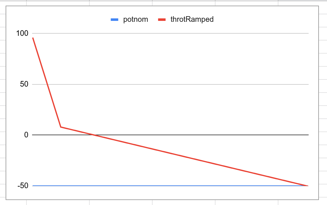

Ok I just ran the code locally & made a plot to make sure I understand what is going on.
I just compiled 5.17R and we will try it out. I am not sure if changing 5 to 10 will make much difference, as the inflection point is firmly in the throttle region already like this, but we will try it, as well as regenRamp=0.1 instead of 0.3, which I have higher hopes for.
I now wonder how OEMs initiate regen smoothly at high speeds! A delicate operation.

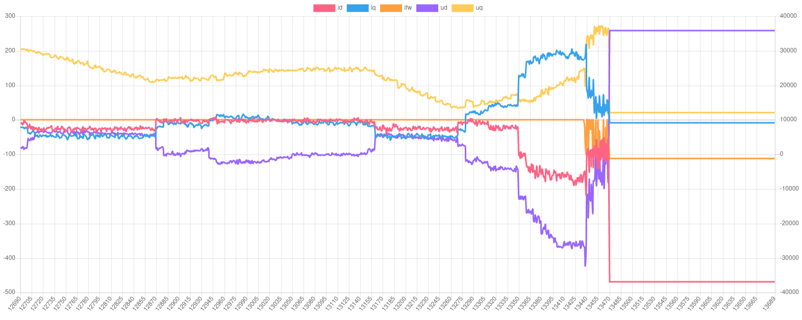

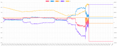

Maybe worthwhile posting my plot of the event here:
and the text
johu wrote: Thu Jan 06, 2022 5:39 pm During the test drive I had completely disabled regen, so it's pure "phantom" braking. At least the plot now shows what I expected: excessive negative q-current of -550A (0A is control target!). The FW controller tried to counteract by commanding -280A field weakening current on top of the MTPA current. Indeed id reaches -400A but apparently that is not helpful. Remembering that mystery post that was deleted after a few hours, too much id might actually no longer result in field weakening.
fwkp was at -300.
The idea is: if I slowly come off throttle all is good. That's what I want to mimic.

Problem still occurs with 5.17R-foc and the settings below @ ~65mph
Let me know what changes you want us to try, I can change params & try again, as well as make small code changes.
inverter.json
(13.47 KiB) Downloaded 287 times

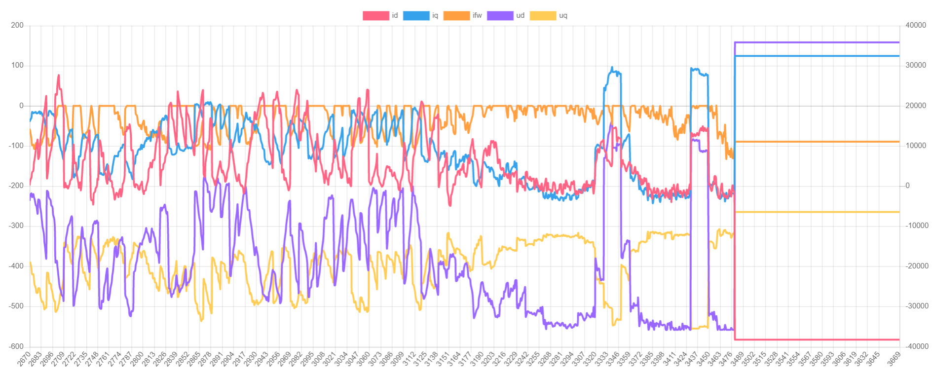

this previously happened at 60mph for us, now yesterday it only happened at 80mph, info from the test drive:
RegenRamp at 0.1%
managed to get to stall around 80mph once, couldn't seem to recreate, but not sure I got up to 80mph again. The plot attached is trying to get it to stall, but not the actual stall.
It's not great to drive when regen ramp is this low, eg. press the brake and nothing happens for a couple seconds, then it kicks in. I think I will try again tomorrow but with 0.3% regenramp. I suspect it will be slightly easier to stall it with that.
I also want to get a plot of when the throttle vibrates at low throttle position, from just a glimpse it looked like a few weird things were going on with the plot.
This is with 5.17 & the throttle.cpp:132 modification:
 else if (potnom < throttleRamped && throttleRamped > 10)
(stalling = ocurlim hit)

My new testing strategy is to dial down throtcur (3) and ocurlim (500) so when things go wrong it's not as harsh.
So I could accelerate happily into the rev limiter (7500 rpm) but as soon as I came of throttle, same old old I'd think: id shoots up from -100A to almost -500A, PI controller tries to counteract by pulling ud to full positive and that's it, over current. Maybe with higher ocurlim it would have resulted in uncontrolled regen, I don't know. It seems to happen at the moment that iq crosses 0. Why oh why?
