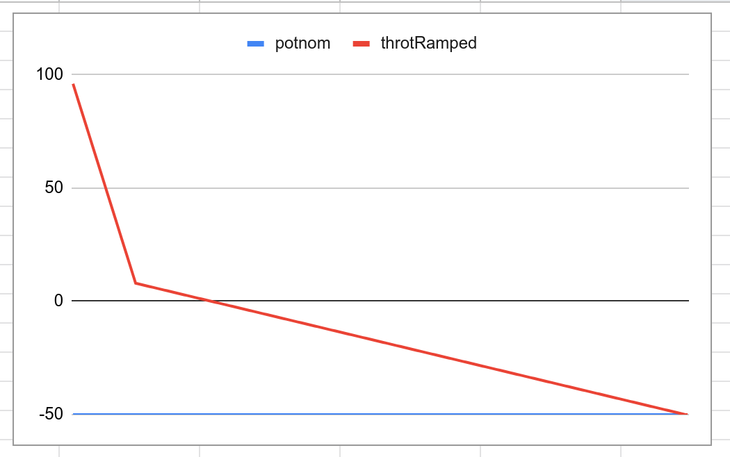

Ok I just ran the code locally & made a plot to make sure I understand what is going on.
I just compiled 5.17R and we will try it out. I am not sure if changing 5 to 10 will make much difference, as the inflection point is firmly in the throttle region already like this, but we will try it, as well as regenRamp=0.1 instead of 0.3, which I have higher hopes for.
I now wonder how OEMs initiate regen smoothly at high speeds! A delicate operation.

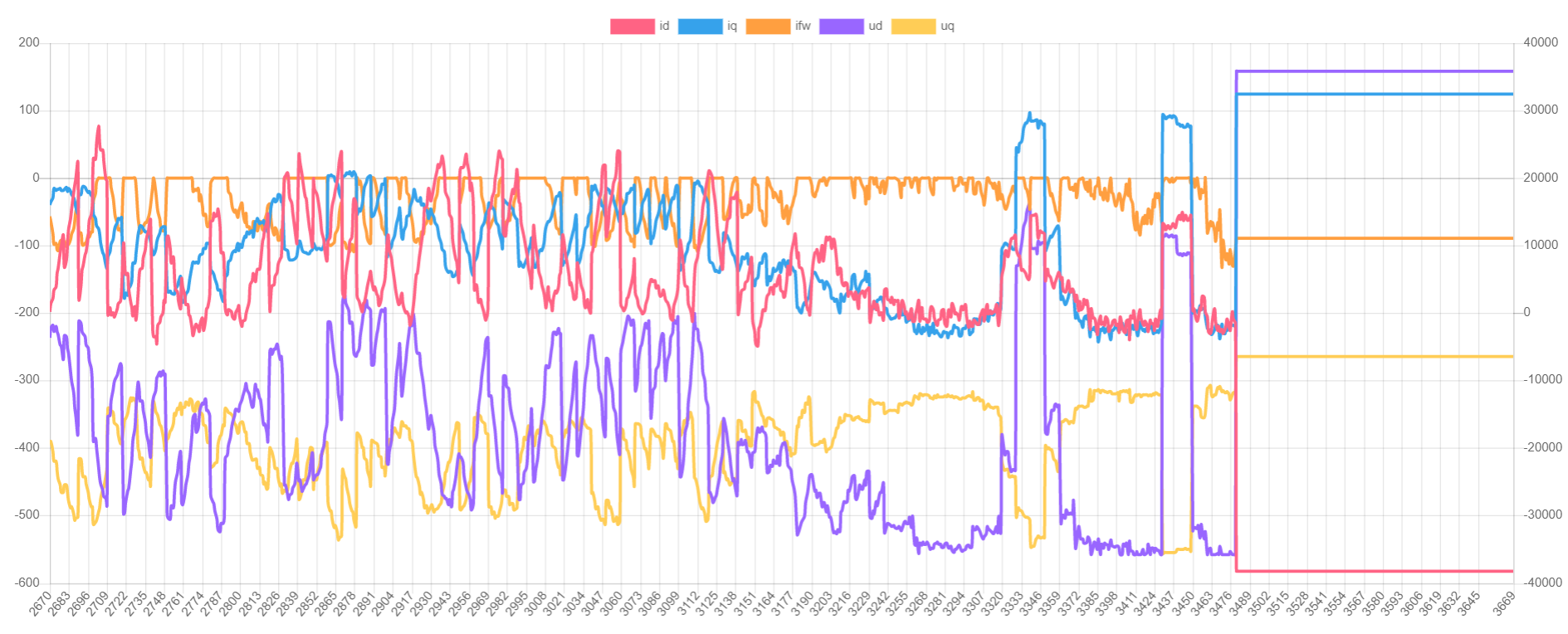

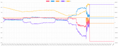

Re: Overcurrent at high RPMs when regen engages?
Maybe worthwhile posting my plot of the event here:
and the text
johu wrote: Thu Jan 06, 2022 5:39 pm During the test drive I had completely disabled regen, so it's pure "phantom" braking. At least the plot now shows what I expected: excessive negative q-current of -550A (0A is control target!). The FW controller tried to counteract by commanding -280A field weakening current on top of the MTPA current. Indeed id reaches -400A but apparently that is not helpful. Remembering that mystery post that was deleted after a few hours, too much id might actually no longer result in field weakening.
fwkp was at -300.
The idea is: if I slowly come off throttle all is good. That's what I want to mimic.

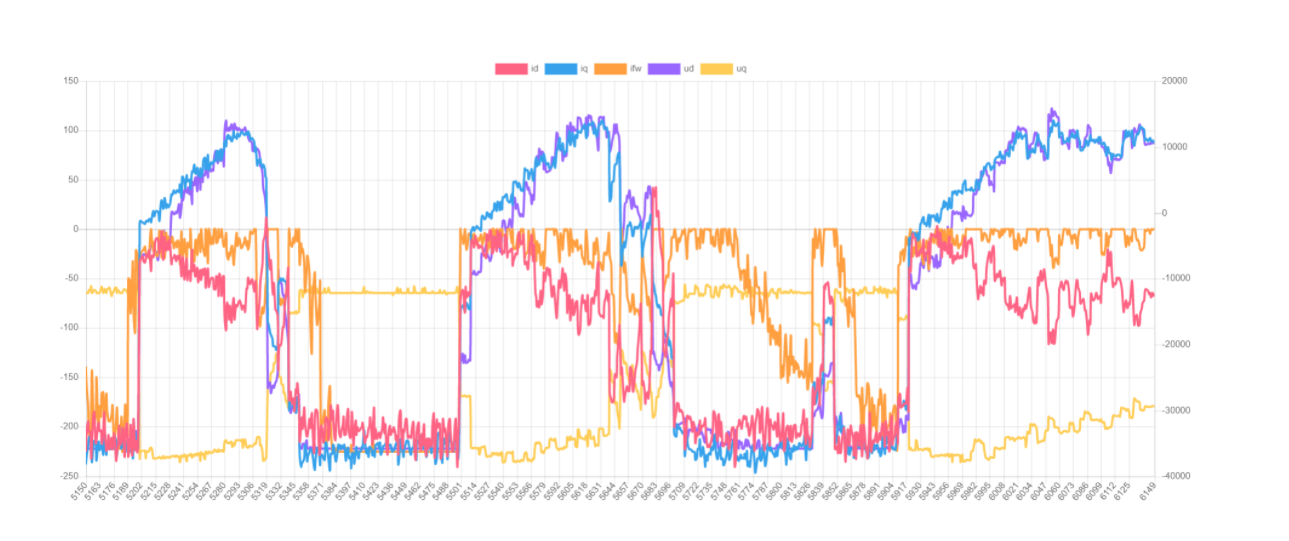

Hello,
this previously happened at 60mph for us, now yesterday it only happened at 80mph, info from the test drive:
RegenRamp at 0.1%
managed to get to stall around 80mph once, couldn't seem to recreate, but not sure I got up to 80mph again. The plot attached is trying to get it to stall, but not the actual stall.
It's not great to drive when regen ramp is this low, eg. press the brake and nothing happens for a couple seconds, then it kicks in. I think I will try again tomorrow but with 0.3% regenramp. I suspect it will be slightly easier to stall it with that.
I also want to get a plot of when the throttle vibrates at low throttle position, from just a glimpse it looked like a few weird things were going on with the plot.
This is with 5.17 & the throttle.cpp:132 modification:

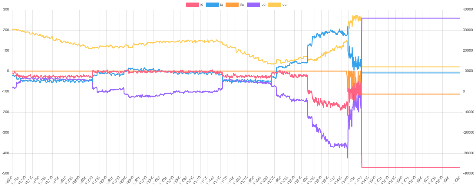

And progress!
https://github.com/jsphuebner/stm32-sin ... fw-control
Not perfect, but getting there. As a consequence of the above finding I now preload the d-current integrator with its negative value when direction of torque changes. This means it no longer takes perhaps many 100 cycles to integrate from +35000 to -35000 but it is sent to -35000 instantly. It is much smoother now in the upper rev range but regen is still stronger than requested. May be a matter of tuning now.
While coasting to a stop on a downhill at about 6500 rpm with the inverter OFF I could see about 20 kW going into the battery. So that's the pure back-EMF that is "passively" generated. I don't think the software really "sees" this current yet, maybe syncadv is wrong and it is not correctly showing up on iq.
Anyway, please test this one starting with the attached parameters (and you custom throtcur and ocurlim of course)
