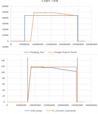

I have been involved with more testing of the BMW I3 CCS controller. Main focus was does the code I modified to listen to more limits given by the SimpBMS work? Also have a Chinese isolation monitoring device that is being tested, which turns out might be causing some issues even before the contactors close.
Two things to note came to light:
  • After Cable test the charger did not return to 0V but hovered around 55V, so tweaked the code so it no longer waits till 0V to count down to proceed. The charger did not mind
  • Has anyone been able to exceed the currently hard coded power limit of 44Kw (set in code can be changed) or seen the following behaviour? the charger seems to overshoot by listening to FC current request and then start backing down to Power Request without indicating any limits on the charger side
Posts: 3668
Has thanked: 12 times
Been thanked: 356 times
Have seen the cable test voltage behavior a few times. Not sure if you are looking at the charger limit flags in code but I can whack the current request through the roof and the charger will roll on until it triggers a flag (either max power or current) and then back down. Seems here in Ireland at least they use the flags when throttling chargers as they will happily report say 125A avail but trip a current limit flag at much less.
