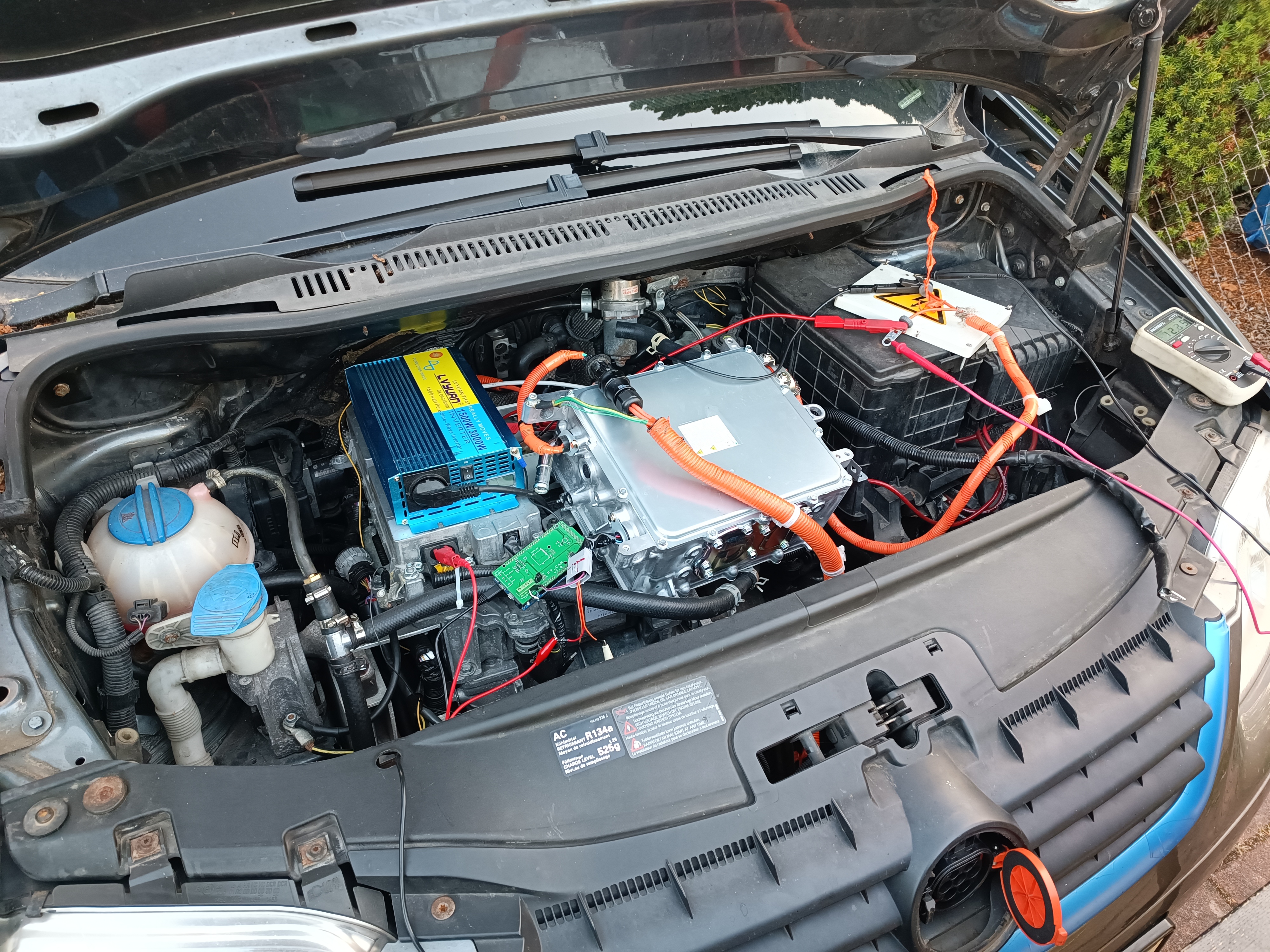

Isolation alarm fixed.
Turns out I had too little clearance between HV and GND on that little prototype PCB that you see on the right. Over time and with moisture this has become an issue.

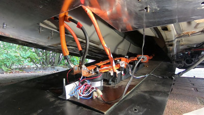

Since I welded the stock Nissan charge port relays yesterday I was forced to get under the car and fix that.
I decided to upgrade. Damien sent me some Gigavac relays a while back, rated 500A. So that is what I now use. Now I can finally take advantage of 100 kW chargers. BMS allows 70 kW up to 45% or so.
I use the aux contact of the one relay to switch on the second one. They safely turn on with 1.3A and 11.9V and then pull 300mA

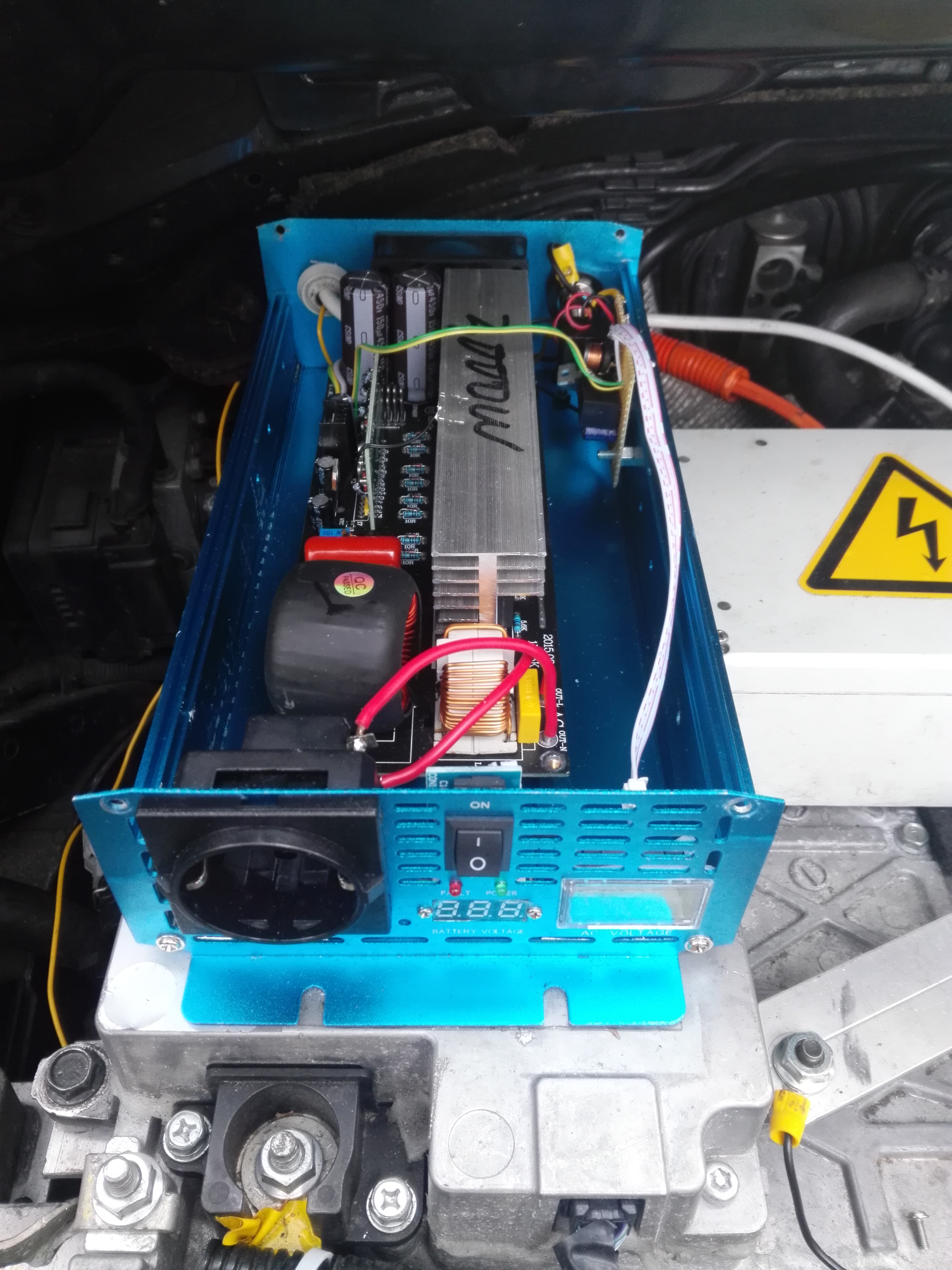

Took Touran to our summer weekend to supply it with electricity. Aaaand - no voltage coming out of Chinese inverter. Ok, returned home, removed the PCB and found the two elcaps rather swollen. Indeed, 0 uF, totally blown. Supposedly "Nichicon" - yeah right. Replaced them with a proper one aaand - still no voltage. Hmm. Wiggled the sine filter coil a bit to find both legs had broken off. Little surprise there actually, it is really heavy and only held down with cable ties.
Fixed that et voila, voltage comes out. Now off to the woods again, lets see how much energy we need.

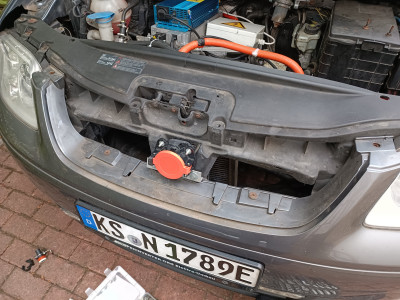

Next modification to Touran will be an actual on board charger. I'm a bit fed up with boost mode home built chargers as I exploded it many times by now, so now I'll rather have a proper one that is built in. I charge the car at home 90% of the time and I charge slowly to make use of the 800W solar + 900W battery system. So a single phase charger will do.
So I bought that Outlander charger the marty had up for sale plus a single phase type-2 port and a granny cable. The charger is supposed to live in the exhaust tunnel and will be permanently connected to the HV battery. There is an unswitched outlet with a 30A fuse on Nissans relay box so I'll use that. That way I don't have to worry about precharge and turning on main relays.
Now, the fuel filler is already taken by CHAdeMO, so needing another spot for the type-2 inlet. Did have to remove the locking mechanism, not too worried about it.

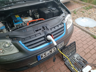

Did a full test run of the charger today and it works a treat! Temporarily mapped the charge current limit from the BMS to the charger modulo 128 but then noticed that ain't gonna work well if lim % 128 == 0. Might have to hard code something.
Also found message 0x38A collides with something already present in Touran but it doesn't seem to disturb. The info in that message is rather redundant and it seems the VW message always wins arbitration as it's only 4 bytes DLC.
I removed the Yakaza connector for AC inlet and mounted a Wieland connector instead.
Now I just need to find out whether it fits into the exhaust tunnel and I'm good to go.

whereswally606 wrote: Sun Aug 28, 2022 11:57 am i would have said that the chademo is best at the front or rear and the type two at the side but i guess this is the path of least resistance once you have already got something else installed.
Right, it is down to the layout. DCFC doesn't go through the main relays but directly into the battery which conveniently is in the back as well.
