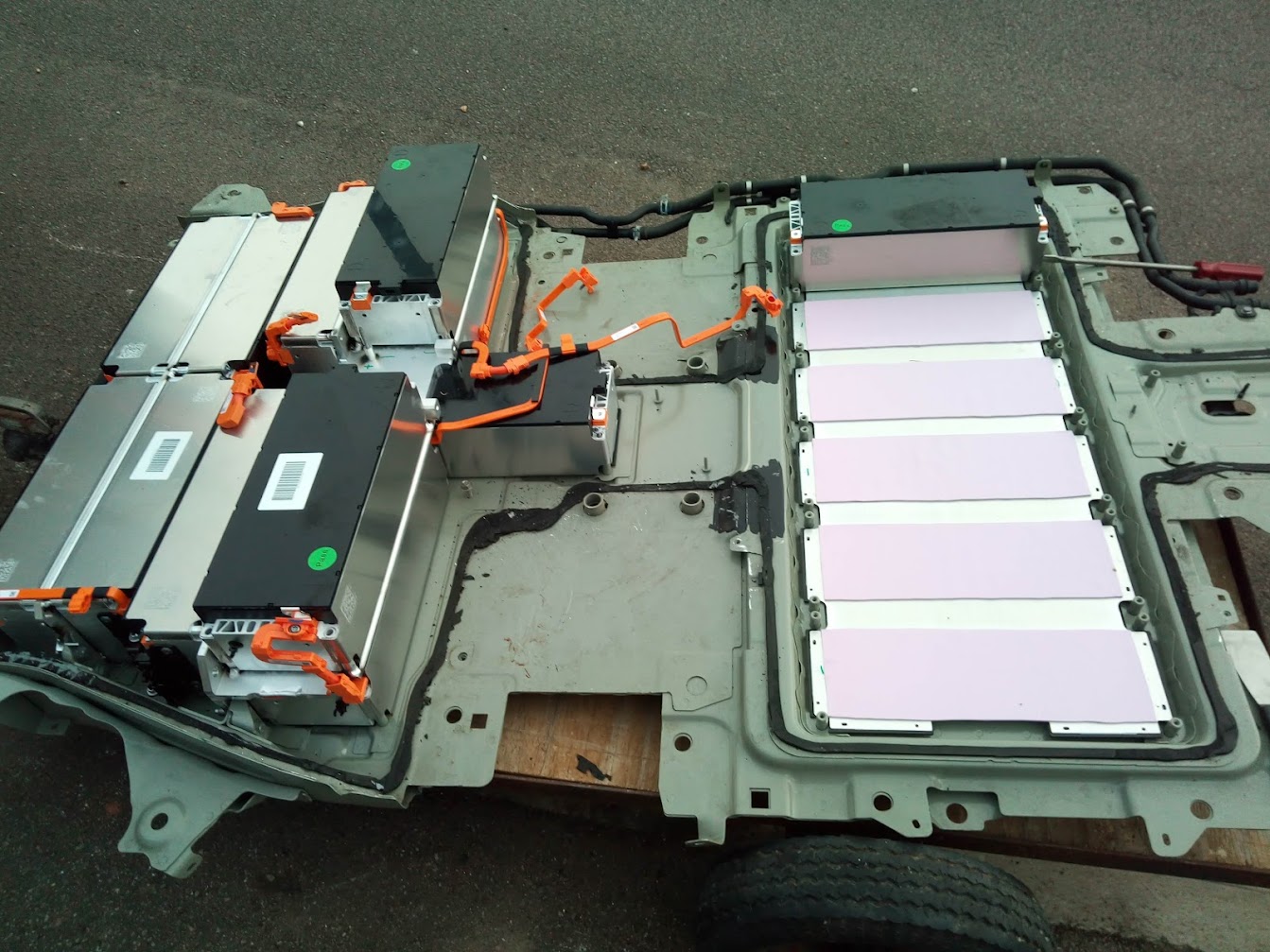

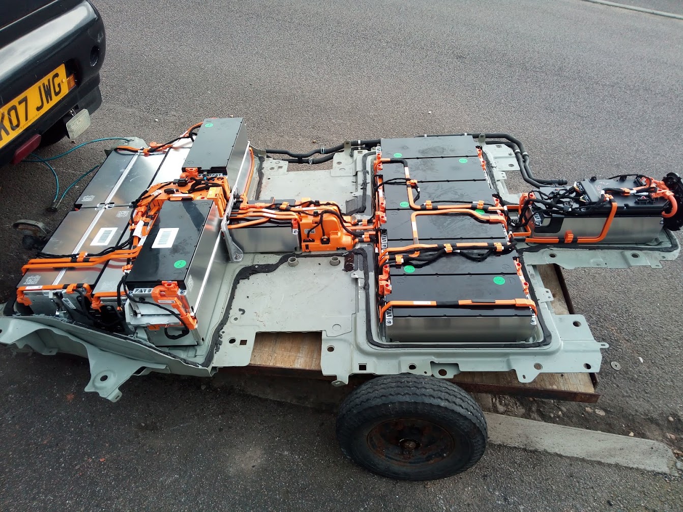

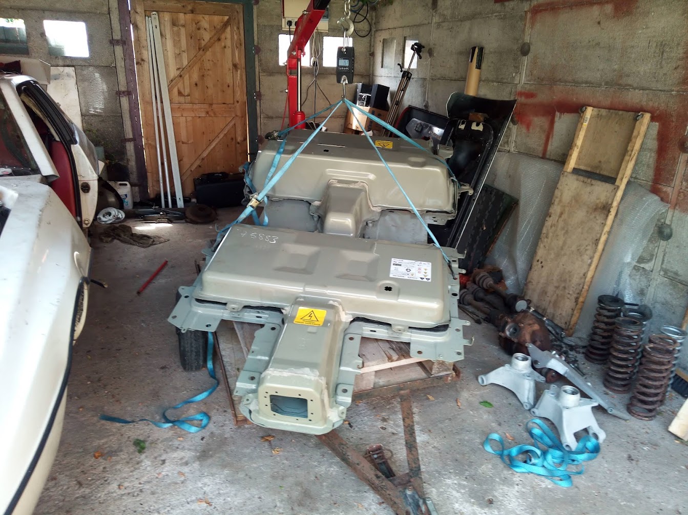

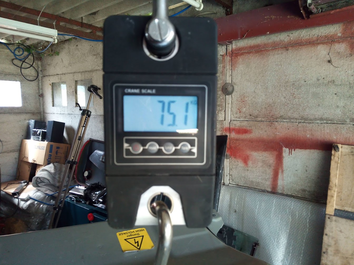

Just took delivery on one of these 50kWh packs yesterday. Had to have it dropped at the kerb and then strip in place.
BMW use a lot of bolts and their packs are easy to dismantle. These packs use only a few bolts, but a lot of strong adhesive and most of the battle was getting the sheet metal cover off, which took several hours.
Quite a complex layout due to the ICE derived nature of the donor.
The 350kg weight shown on the casing is probably the 'lifting wieght', which is the minimum required capacity of shackles, straps and cranes, etc. rather than the actual weight.
I'll try and get real weights on most parts. The stripped steel casing is just a shade over 75kg.

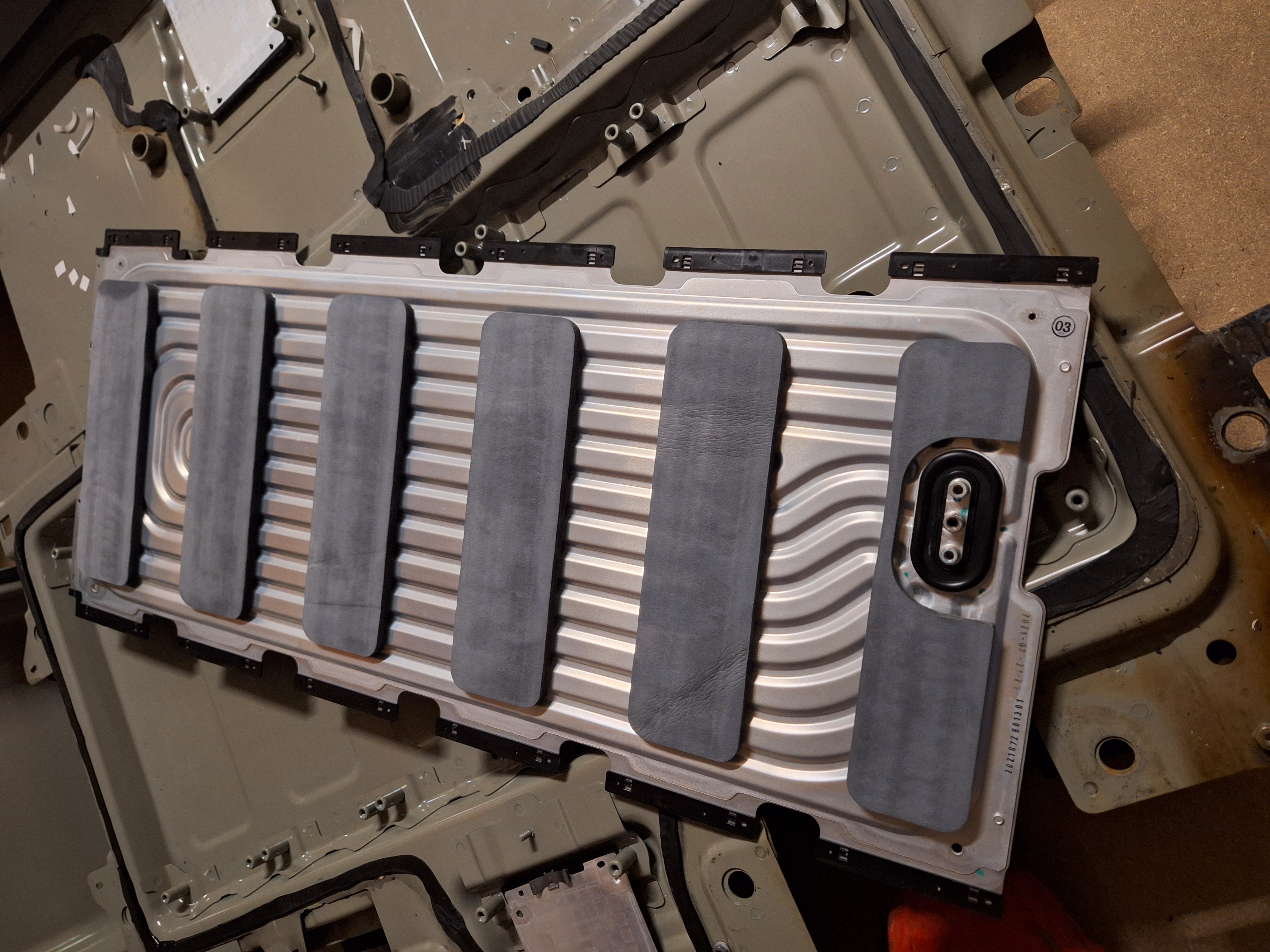

Calb modules, 6S2P, Calb BMS. Mostly solid copper busbars, but some have short sections of round flexible cable. Terminal caps are a nice design that keeps the M6 Torx screw captive.
Cooling plates are interesting. The big 6 module plate is very light, made of embossed sheet metal. The two on the left of the picture, a 4 module and a 6, double up as tructural mounts and are pretty heavy.

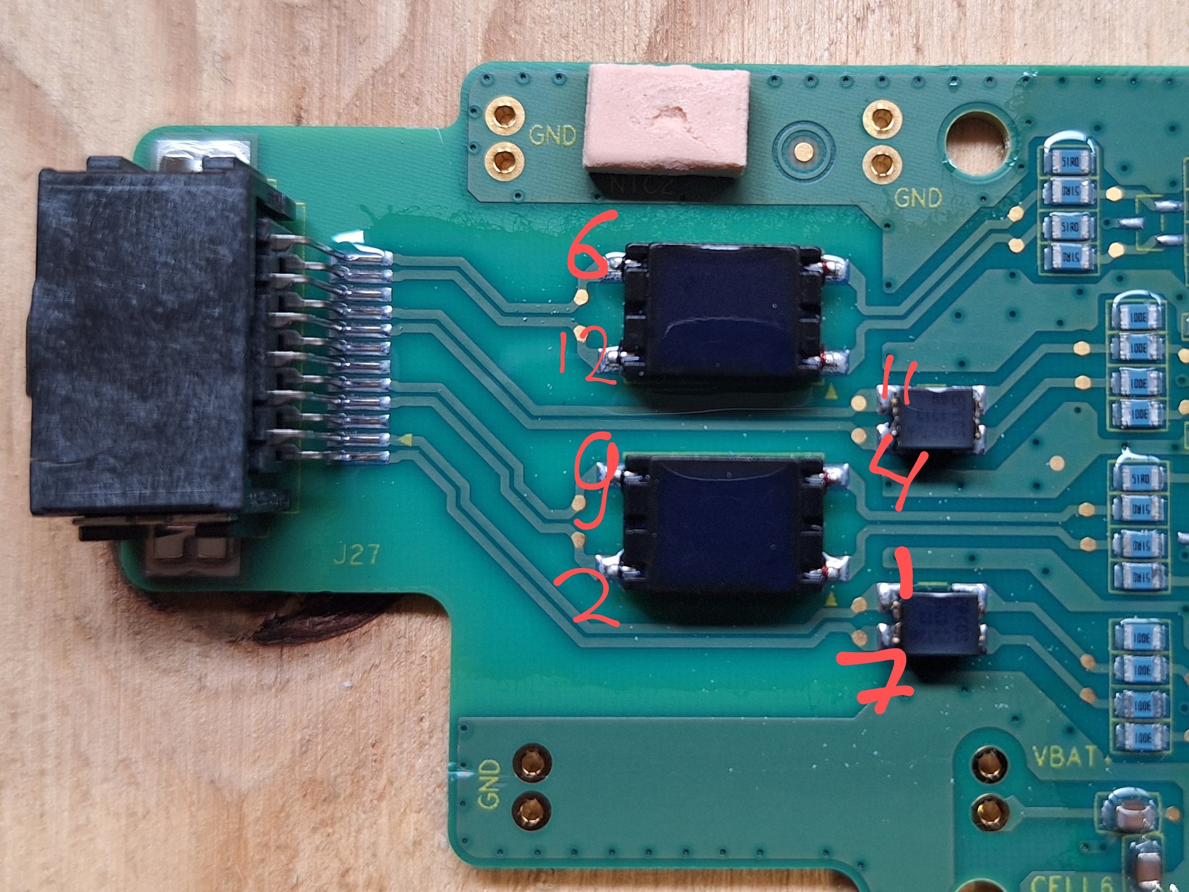

I thought I would put together a list of things I have found out about the Peugeot e-208 CATL modules.
Firstly a big thank you to Clanarn for designing the master board, bexander for the software and chris01290 for software and general advice.
The e-208 modules use the MAX178xx family of devices. e208 modules using Max17823B and the master to control these is MAX17841B as the master controller.
Clanarn has made a niffy little board using the MAX17841B, please bear in mind that this board only uses the 4 middle pins on the TX/RX end.
ie
TXN pin 1 Not Used
TXN pin 2 Not Used
TXP pin 3 is TXN and goes to pin 1 on Module 1 (RXNL)
TXP pin 4 is TXP and goes to pin 7 on Module 1 (RXPL)
RXN pin 5 is RXN and goes to pin 8 on Module 1 (TXNL)
RXN pin 6 is RXP and goes to pin 3 on module 1 (TXPL)
RXP pin 7 Not Used
RXP pin 8 Not Used
Wiring on the Modules, look at the rear of the connector plugged in the module the right way up. Pin 1 Top Left, Pin 6 Top Right, Pin 7 Bottom Left, Pin 12 Bottom Right
Pin 1 RXNL
Pin 2 blank
Pin 3 TXPL
Pin 4 blank
Pin 5 goes to pin 8 on Module 2
Pin 6 goes to pin 7 on Module 2
Pin 7 RXPL
Pin 8 TXNL
Pin 9 blank
Pin 10 goes to pin 3 on Module 2
Pin 11 blank
Pin 12 goes to pin 1 on Module 2
and so on until the end when Pin 5 loops back to Pin 12 and Pin 6 to Pin 10, the end of the daisy chain.
I believe the original wiring harness twists the wrong pairs!

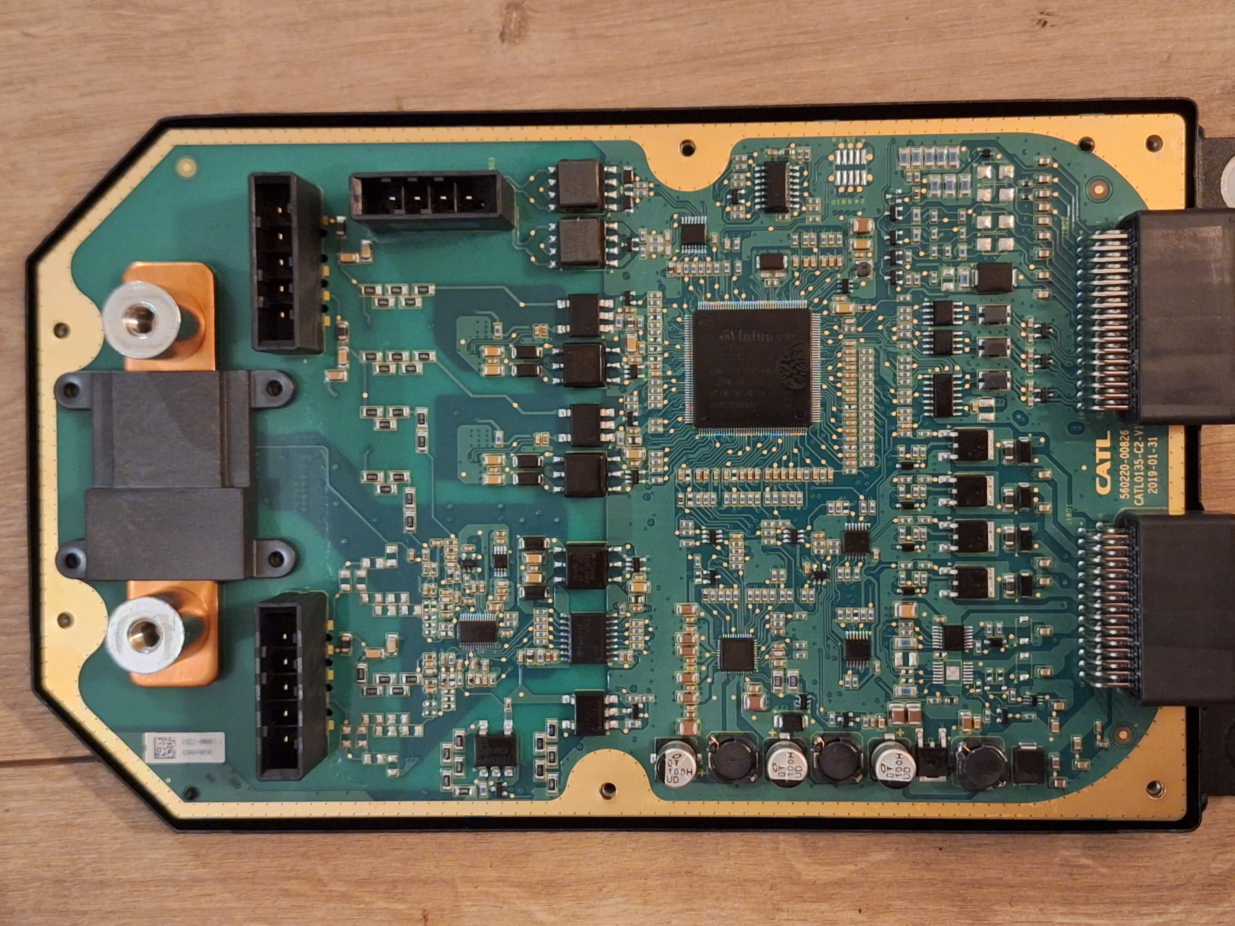

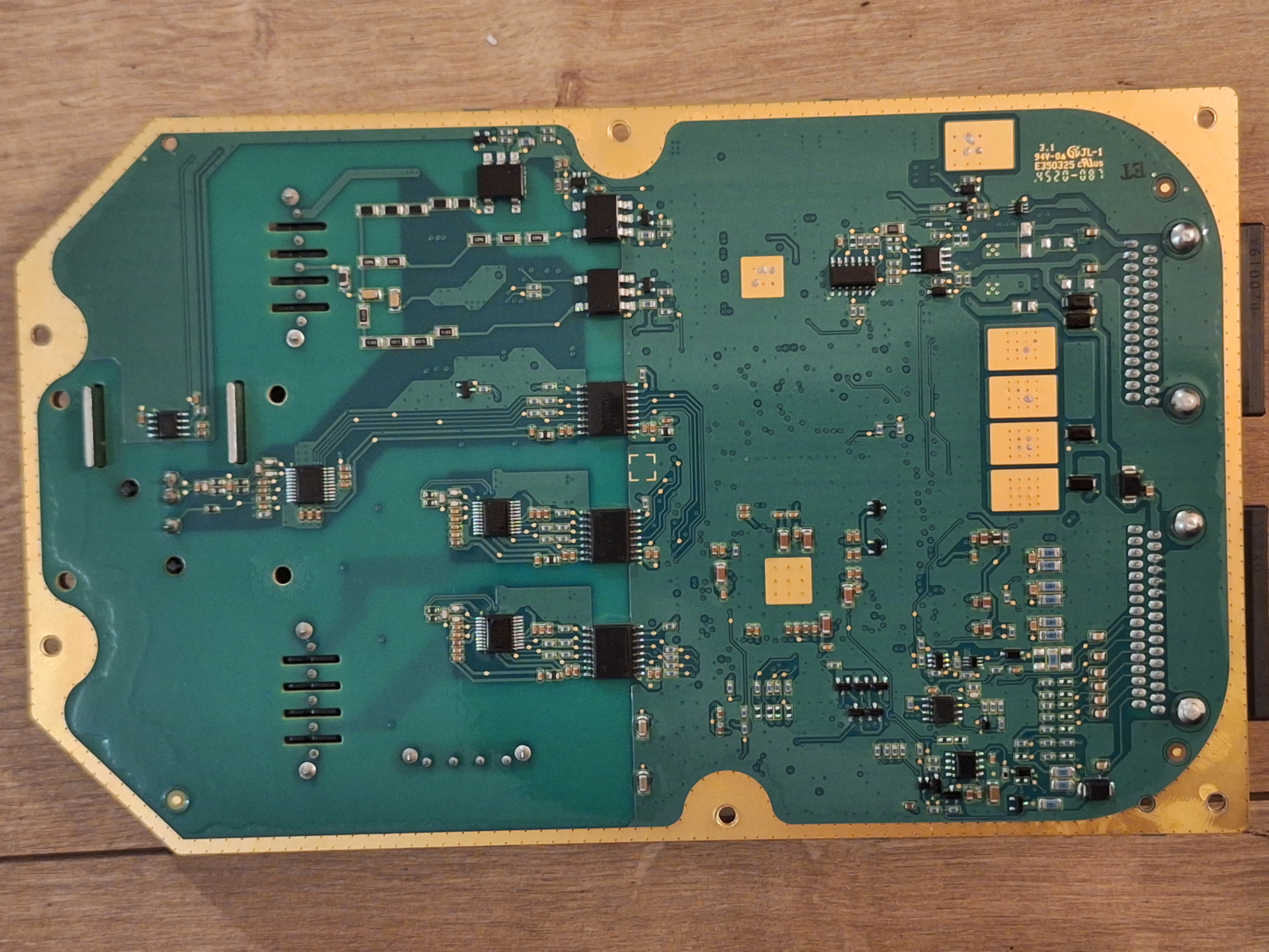

Re: Pugeot E-208, Corsa E, etc. battery pack.
I bought a E 208 pack.
did not see a picture of the battery controller unit. so here it is
if someone is interested in some details let me know
Manny
Manny

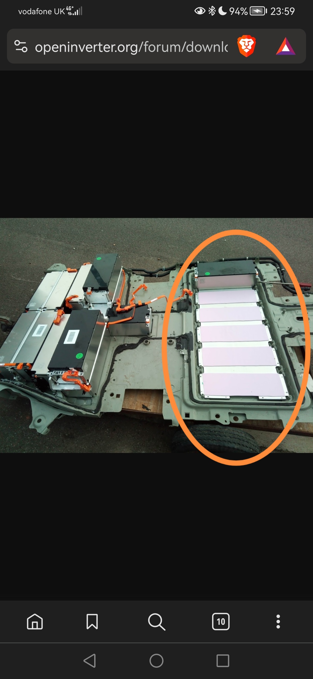

Hi

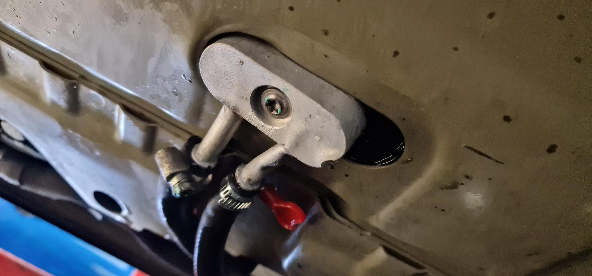

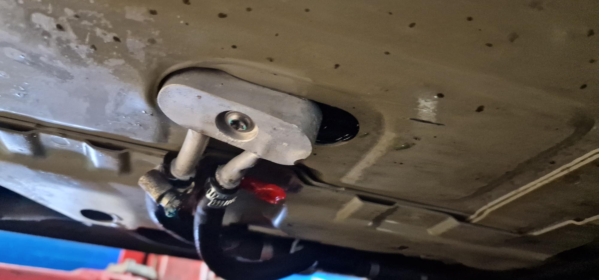

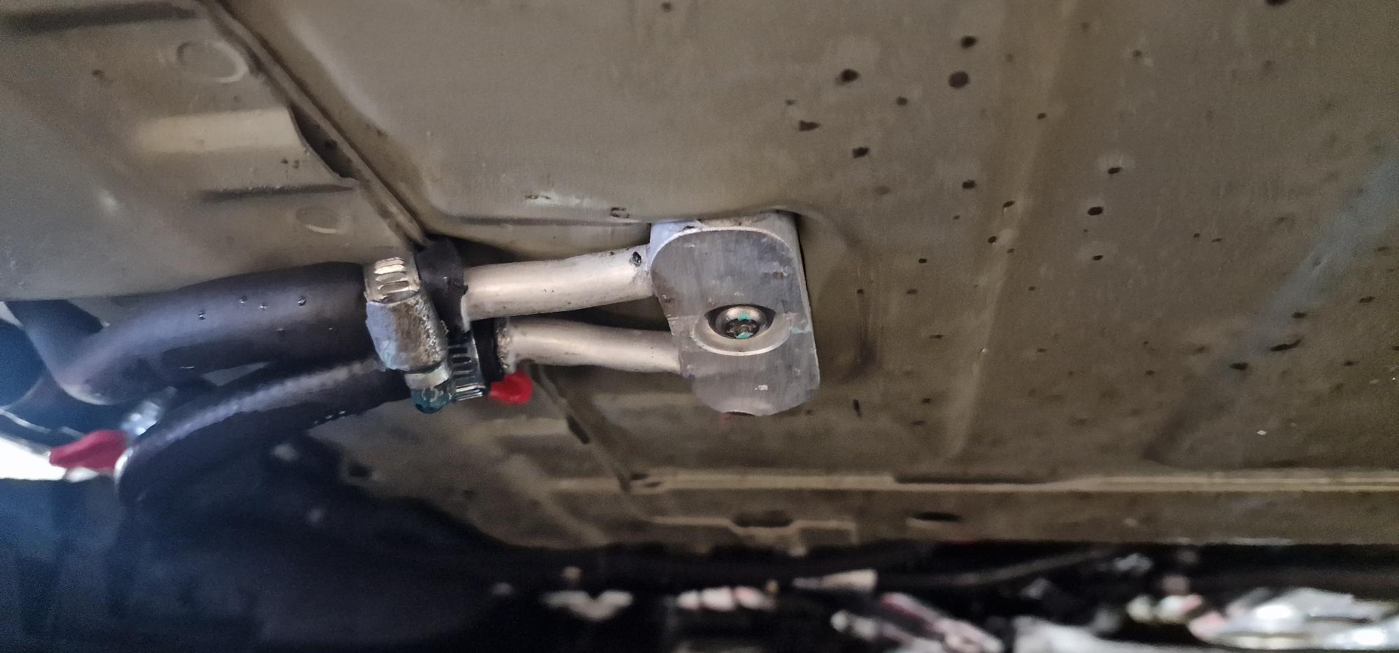

I would like to ask you if that metal cooling plate is a one part? Or this is five connected metal plates?
I bought E Mokka and it has a same battery, I bought it with damaged battery, and that metal part which cooling pipes goes in to are broken. Also probably the metal cooling plate is broken too. Maybe you have it for sale?
- manny
- Posts: 117
- Location: Netherlands
- Has thanked: 28 times
- Been thanked: 85 times
hi
The part you circled is one big part. I have a empty shell with the cooling plates that i am not using.

Still looking for UN38.3 or any other cell level info on the pack.
Would buy this information if available!
Please DM
Please DM

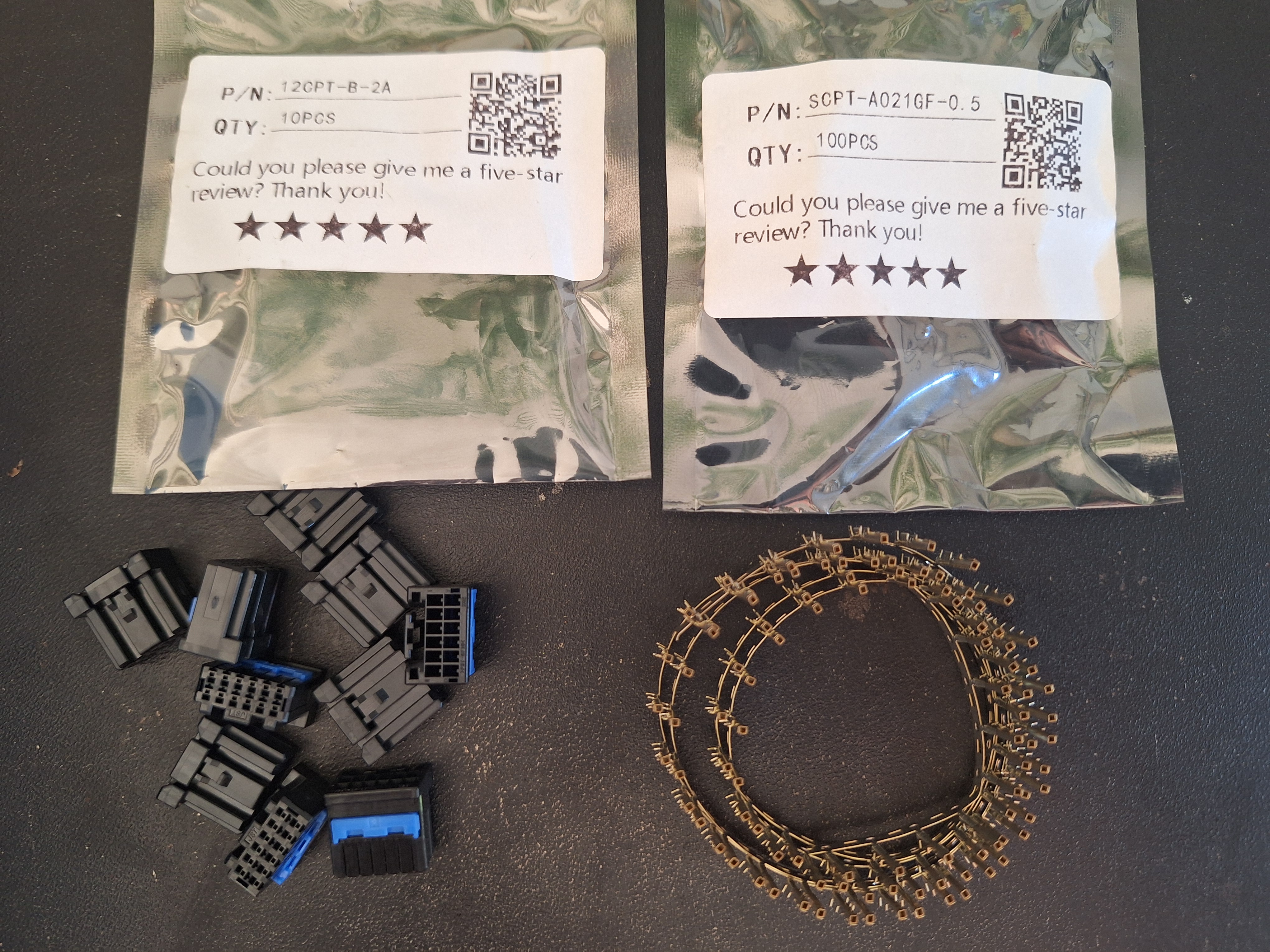

I ordered a set of connectors and pins for the BMS connectors. And they fitt
https://nl.aliexpress.com/item/10050053 ... pt=glo2nld
Part numbers:
12CPT-B-2A (housing)
SCPT-A021GF-0.5 (pins)
Part numbers:

Yes, You are correct the original wiring harness is wrong! unbelievable.
I am working on my bms wiring reusing most of the original wiring. I need to splits it up the harness because i have 2 boxes.
and i could not work out why the twisted pairs did not line up with the first connector.
So the wires from the BMS master to the first module are correct and the rest is wrong!!!
on the first module the twisted pair are:
from master pins 1-7 , 2-9
to next module 4-6 , 11-12
And on all other modules:
from previous module 1-2 , 7-9
