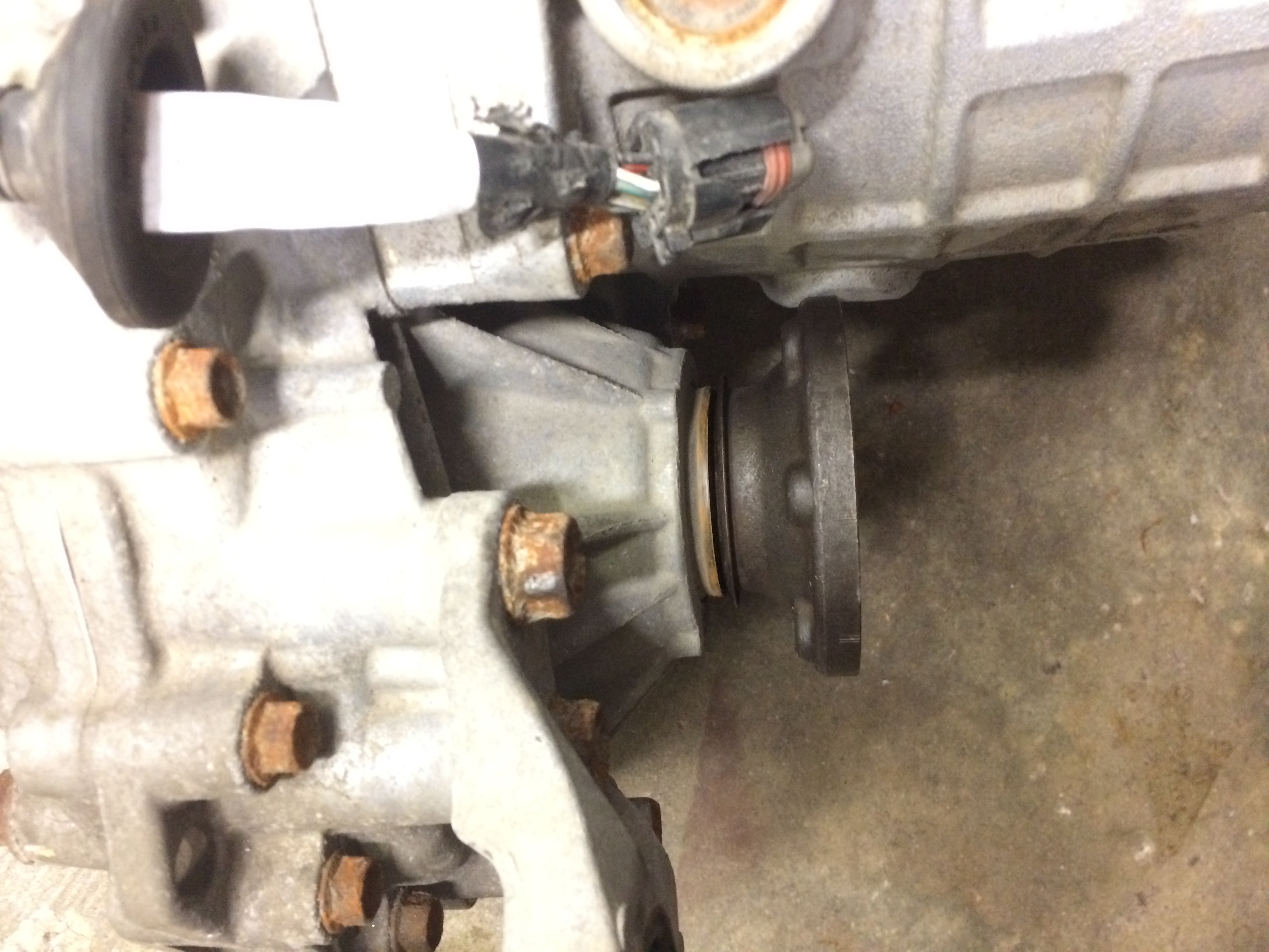

I just picked one of these up in a package deal. Pulled the axle stub... and thought the bearing seal looked close to...
A vw beetle stub flange!
Type 1/90mm will clear the motor. But a extruded boss on the motor comes close
If there’s enough room to shave the extruded boss, then a typ2 (100mm) cv flange should fit.

Bratitude wrote: Sun Sep 18, 2022 6:08 am A vw beetle stub flange!
Type 1/90mm will clear the motor. But a pressed in cap and boss come close A9CEA485-BC91-4585-9C41-0390C9A22ECA.jpeg
If there’s enough room the shave some of it down the n a typ2 (100mm) cv flange will fit.
I am very interested in coming up with a drive shaft/flange solution as getting the shafts is getting difficult.
