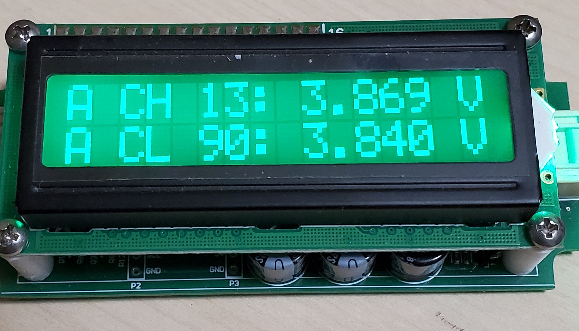

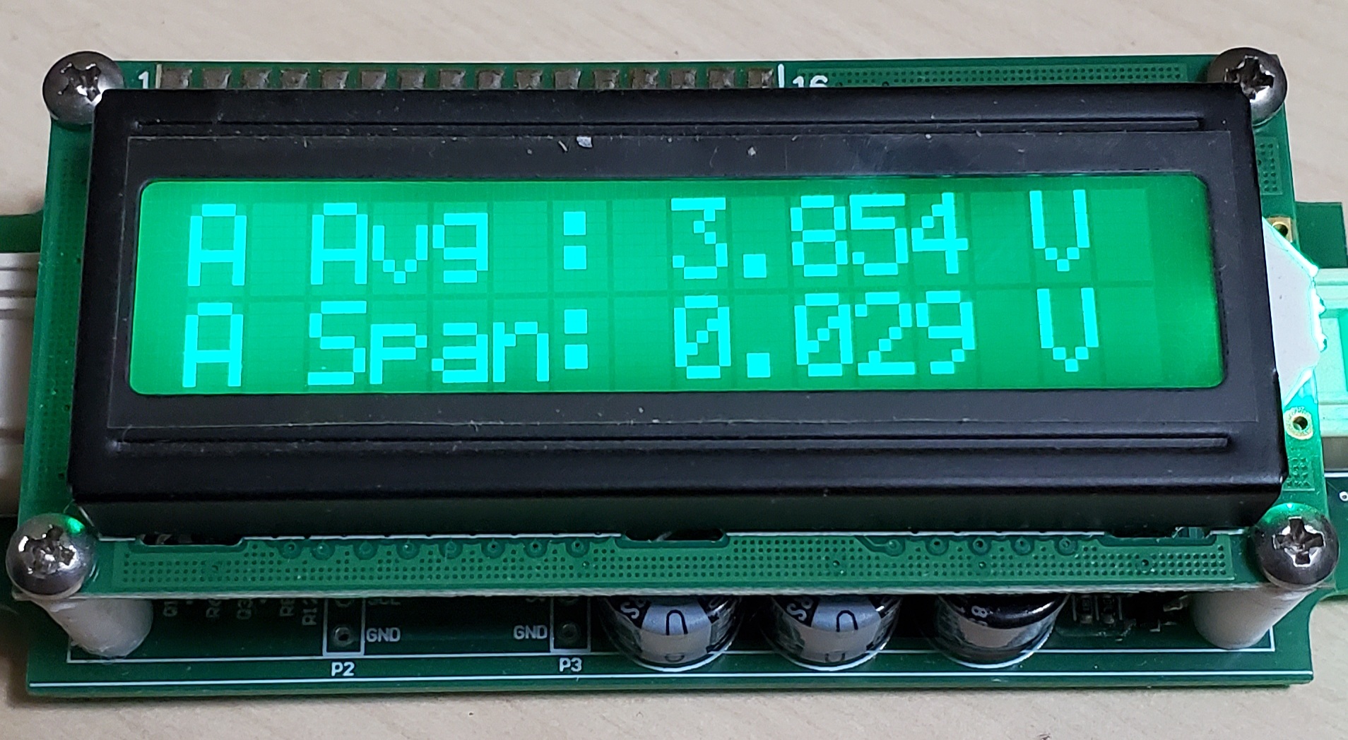

janosch
Posts: 329
Location: London, UK
Has thanked: 98 times
Been thanked: 102 times
Re: Nissan Leaf BMS
Post by janosch »
Cookie6000 wrote: Sun Apr 23, 2023 8:01 am ... I found 2 of the 96 voltage taps in the wrong connector position. Success! ...
viewtopic.php?t=2085
Might be just too late for you now, but I made a gizmo to help you with finding issues like that. Linking here for future readers.
