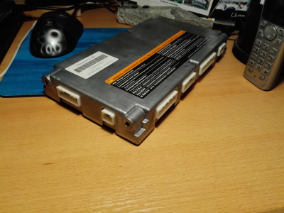

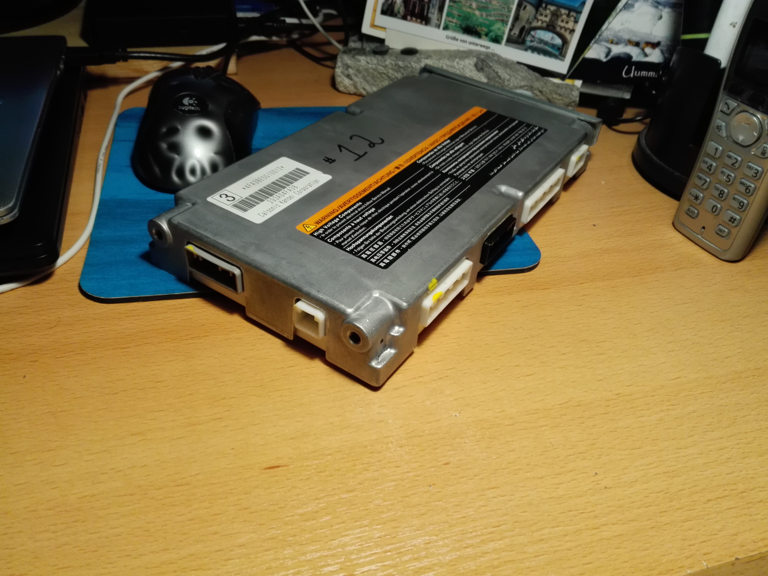

So I think I'm one step further to solving the interlock issue.
The LBC that came with the original pack looks like this The one that SciroccoEV sent me looks like this I had to go to work on the logic connector to make it fit. I found that odd.
So now I put the original BMS back in (with a blown BMS chip) and observed the interlock bit. And indeed, when the safety disconnect is plugged in it shows "1" and "0" otherwise. The new BMS always shows "0". Does anyone know the pin map of the "all white connectors" LBC?

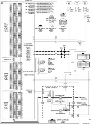

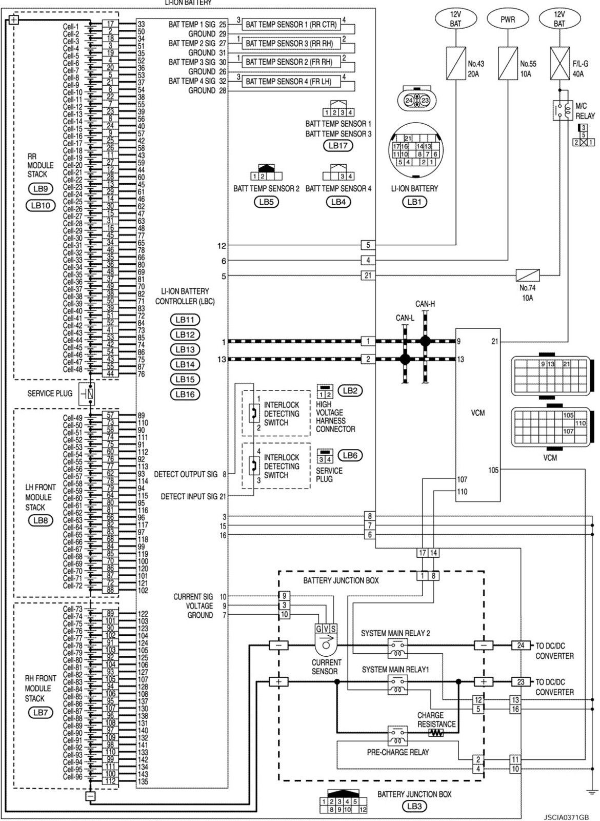

I've noticed a difference between the 'white' and 'grey' versions of the LBC wiring on connector LB11 (top left).
The grey wiring loom has empty slots at pin 4, 11, 16,17,18,19,20,21,22,23,24.
The white wiring loom has empty slots at pin 2, 7,11,14,18,19,22,23,24.
The 'present/interlock' signal is (according the schema) populated between pin 8 and 21.
So pluggin in the white loom in grey LBC (and vice versa) doesnt fully work.
According schema (white LB11 connector) pins are as follows
1 CAN High
2
3 GND
4
5 Charge mode +12V
6 Ignition mode +12V
7 Current sensor GND
8 Interlock output
9 Current sensor voltage
10 Current sensor signal
11
12 +12V Bat
13 CAN Low
14
15 GND
16 GND
17
18
19
20
21 Interlock input
22
23
24

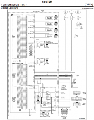

Re: Nissan Leaf BMS
And the wiring loom with grey connector is as follows:
1 CAN High (LB1 pin1)
2 GND1 (LB1 pin8)
3 GND3 (LB1 pin6)
4
5 CHG IGN (LB1 pin31)
6 interlock
7 IGN (LB1 pin4)
8 interlock
9 current sensor Voltage
10 current sensor Signal
11
12 +12V Bat (LB1 pin5)
13 CAN low (LB1 pin2)
14 GND2 (LB1 pin7)
15 current sensor Ground
16
17
18
19
20
21
22
23
24
2 GND1 (LB1 pin8)
3 GND3 (LB1 pin6)
4
6 interlock
7 IGN (LB1 pin4)
8 interlock
11
14 GND2 (LB1 pin7)
16
17
18
19
20
21
22
23
24
evcar
- Posts: 9
- Joined: Tue Dec 31, 2019 6:28 am
- Location: Los Angeles CA (USA)
- Has thanked: 25 times
Re: Nissan Leaf BMS
One method I used to verify that the BMS was hooked-up correctly was with a bluetooth dongle and the LeafSpy app. There's an option in the app to only perform BMS communications. Using the app, you can see all the output data from the BMS. Here are some details:
http://www.electricvehiclewiki.com/wiki/leaf-spy-pro/
I have been wanting to read the balancing signals manually over can-bus, but never got around to doing it. But I do see on LeafSpy that the cells are balanced periodically when the BMS is active.
I believe the all-white connector BMS are from 2011-2012 models, and the ones with white/grey/black connectors are from 2013-2016. I've attached the wiring diagram from the 2013 BMS that I used in my car.
2013NissanLeafBMS.pdf- (438.06 KiB) Downloaded 1427 times
prensel
- Posts: 130
- Joined: Mon Nov 25, 2019 1:36 pm
- Location: Dreumel (NL)
- Been thanked: 4 times
Re: Nissan Leaf BMS
Great, thats valuable information (diagram) for the grey connector version LBC's.
So now we know why Johu gets a different result on the interlock signal when using the white or grey LBC on the same loom because they changed the pins from 8-21 on white to 8-6 on grey.

Oh you're right! That is really strange. When I remove the connection between 6 and 8 the BMS sets the discharge limit to 4.5kW and I think it displays some error. But now I see they just tie pin 6 to 12V - permanently or on ignition? When is pin 5 activated?
prensel
- Posts: 130
Re: Nissan Leaf BMS
I see that according diagram pin5 is enabled by the VCU and i guess when you plug the charging connector it enables the BMS in 'charge' modus and probably onyl then starts to balance ?
