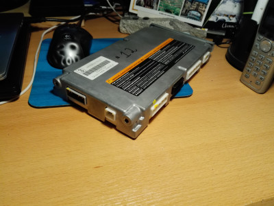

So I think I'm one step further to solving the interlock issue.
The LBC that came with the original pack looks like this The one that SciroccoEV sent me looks like this I had to go to work on the logic connector to make it fit. I found that odd.
So now I put the original BMS back in (with a blown BMS chip) and observed the interlock bit. And indeed, when the safety disconnect is plugged in it shows "1" and "0" otherwise. The new BMS always shows "0". Does anyone know the pin map of the "all white connectors" LBC?
- Posts: 6739
- Has thanked: 380 times
- Been thanked: 1562 times
Re: Nissan Leaf BMS
Magically the Nissan BMS now no longer displays the interlock error. The interlock bit is still low on the CAN bus but DTC is gone. Hmm. Not sure how to figure out whether it balances. People on the web seem a bit unsure. For the Leaf BMS fanboys: I'm reading group 6 but it seems to return all zeros.
Well it's not all magic, I actually traced the interlock signal. It is a 3.3333333Hz 50/50 PWM on the source. It is then routed via the various interlock switches back to the LBC, through a transistor to the MCU. Behind the transistor the signal was swinging between 4.5 and 5V which didn't seem right. So I beefed up the base voltage divider. Now a nice 0-5V swing is generated. Not sure what the deal is.
Anyway I'm getting a meaningful charge and discharge limits now. It's about 1°C outside and when I started I had a 3kW charge limit and a 75kW discharge limit. Just by waiting a bit it climbed to 6kW/90kW.

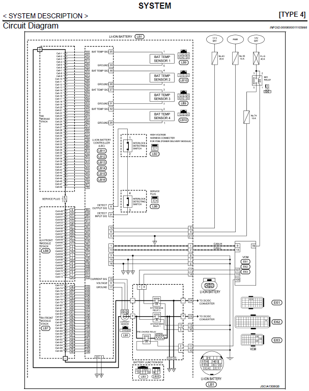

One method I used to verify that the BMS was hooked-up correctly was with a bluetooth dongle and the LeafSpy app. There's an option in the app to only perform BMS communications. Using the app, you can see all the output data from the BMS. Here are some details:
http://www.electricvehiclewiki.com/wiki/leaf-spy-pro/
I have been wanting to read the balancing signals manually over can-bus, but never got around to doing it. But I do see on LeafSpy that the cells are balanced periodically when the BMS is active.
I believe the all-white connector BMS are from 2011-2012 models, and the ones with white/grey/black connectors are from 2013-2016. I've attached the wiring diagram from the 2013 BMS that I used in my car.
2013NissanLeafBMS.pdf
- (438.06 KiB) Downloaded 1309 times

Re: Nissan Leaf BMS
Great, thats valuable information (diagram) for the grey connector version LBC's.
So now we know why Johu gets a different result on the interlock signal when using the white or grey LBC on the same loom because they changed the pins from 8-21 on white to 8-6 on grey.

Oh you're right! That is really strange. When I remove the connection between 6 and 8 the BMS sets the discharge limit to 4.5kW and I think it displays some error. But now I see they just tie pin 6 to 12V - permanently or on ignition? When is pin 5 activated?

I see that according diagram pin5 is enabled by the VCU and i guess when you plug the charging connector it enables the BMS in 'charge' modus and probably onyl then starts to balance ?
