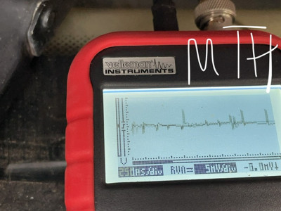

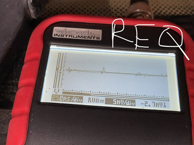

Still having some issues when trying to get my is300h inverter to work:
After every power cycle (remove 12v from zombie and re apply) I have to reselect CAN2 for shunt can, yes I’ve saved parameters, it starts as CAN2, I have to select CAN1, then back to CAN2 for it to work and precharge etc. re-initialising the shunt hasn’t helped
All 4 comms channels have 60ohm resistance and using an oscilloscope I found REQ and MTH seem to have no data on them, just noise (see photos)
My not very accurate current sensor multimeter says Inverter power draw goes from 1.2a when off (which will actually be 0a as it’s not connected to any 12v then) to 2.2a when oppmode is in run. So seems to go up about 1a which seems sensible? Still getting torque commands etc but no spinning
Posts: 3666
Has thanked: 12 times
Been thanked: 350 times
Re: ZombieVerter VCU Support
The CAN2 issue sounds like either a VCU specific code or libopeninv problem. Either way I should be able to replaicate this on the bench and provide a fix. Not seen it myself as my shunt is on CAN1. Just goes to show how valuable feedback and participation is to this project.
Regards the GS300h. 1 amp of 12v draw means the inverter is alive but not initialised. It will draw approx 1.5A when punched up and ready to run the motors. No MTH data can mean : Inverter problem (unlikely) or the CLK signal is not reaching the inverter. The REQ pulse is very narrow so may be missing it with a handheld scope. That said even if REQ were missing you would still see MTH packets. With 60R on all 4 pairs it means you have no open connections but it does not mean the polarity is correct so be sure the + is to + and - to - for all 4 pairs. Just one last random thought : like the 450h the 300h inverter has an inverter disable line. I dont't have it connected to anything on my bench rig but if that were asserted ( i forget its either pulled to gnd or 12v) then that would cause the inverter to display the symptoms you are seeing.

Jack Bauer wrote: Sun Sep 25, 2022 8:50 am The CAN2 issue sounds like either a VCU specific code or libopeninv problem. Either way I should be able to replaicate this on the bench and provide a fix. Not seen it myself as my shunt is on CAN1. Just goes to show how valuable feedback and participation is to this project.
Ok, using bench power supply I can see 12v current draw goes from 0.13a to 2.25a when contactors close and inverter is powered, so 2.1a seems reasonable for contactors and inverter?
Currently only have the connections you have in the video connected, have double checked my polarities are correct and reaching each end (inverter and zombie)
The only difference is 44v battery and using screw joiners for my resolvers (which won’t affect the 4 comms pairs) and not using shielded cable.

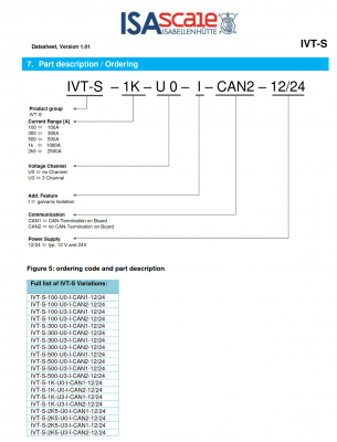

Jack Bauer wrote: Sun Sep 11, 2022 10:26 am Yes the isa shunt is required and I have explained that in the video series and put links in the video description to :
https://www.evcreate.nl/shop/charging/i ... nt-sensor/
Over on the wiki page the videos are even indexed with the specifics of connecting the shunt and the why :
https://openinverter.org/wiki/ZombieVerter_VCU
Hello: Damien
The link for the shunt has this:
Isabellenhütte CAN IVT current sensor with 1000A nominal current. It is a new old stock item. Note, this is the current only version! It cannot measure voltage and (thus) is not usable for the Zombiverter and other VCU solutions developed by Damien Maguire (EVbmw).
I notice that Isabellenhutte has a number of different models.
Is there anything specific we need to look for in a IVT Shunt for it to be compatible to the Zombieverter VCU?
86elcamino
Posts: 64
Joined: Thu Apr 15, 2021 12:06 am
Location: Lake Jackson, Tx
Has thanked: 6 times
Post by 86elcamino »
If the opmode = run, should the INVudc show the voltage at the inverter HV terminals? I have 60V at the inverter, but showing 0 on INVudc, and InvStat = off The inverter also has 12v at the low voltage connector. Where does the uaux (reading 12.65 now)reading come from? I assume the VCU?
I'm getting opmode = on and commanding torque with throttle, but no spin. I also don't hear a whine, but if it's high pitched, I probably won't be able to hear it. I've checked all the wiring again, and everything seems correct. Is there a way to diagnose a bad inverter? Is there any type of fuse in the inverter?
asavage
Posts: 373
Has thanked: 359 times
Been thanked: 118 times
Post by asavage »
FieroJam wrote: Mon Sep 26, 2022 7:48 pm The link for the shunt has this:
[wrong IVT-S]
Generically, the "correct" (probably most commonly ordered/used) IVT-S is IVT-S-1K-U3-I-CAN2-12/24
https://www.evcreate.nl/shop/charging/i ... ge-sensor/
and Lars is selling it at €295. I need to buy one too, but the price is a bit daunting right now. I'm hoping a group buy comes up again.
Depending on your installation, you can change some of those parameters (eg "1K" could be "500", or "CAN2" could be "CAN1", but you'll need to stay with "U3", otherwise the unit doesn't have a way to measure voltage, which the ZV needs.
"I" and "12/24" are the only available options, so they don't change, ever. Click on the image below to be able to read it:
ISAScale IVT-S datasheet
The datasheet (at Lar's website) is https://www.evcreate.nl/wp-content/uplo ... _IVT-S.pdf

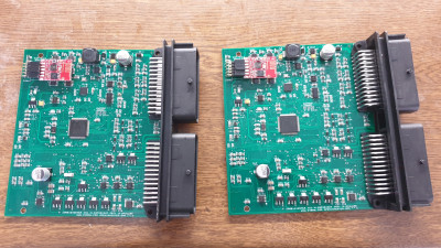

Fully built vcu boards are in progress:) Of course my crappy aliexpress 60v 5a psu decided to go pop this morning...
