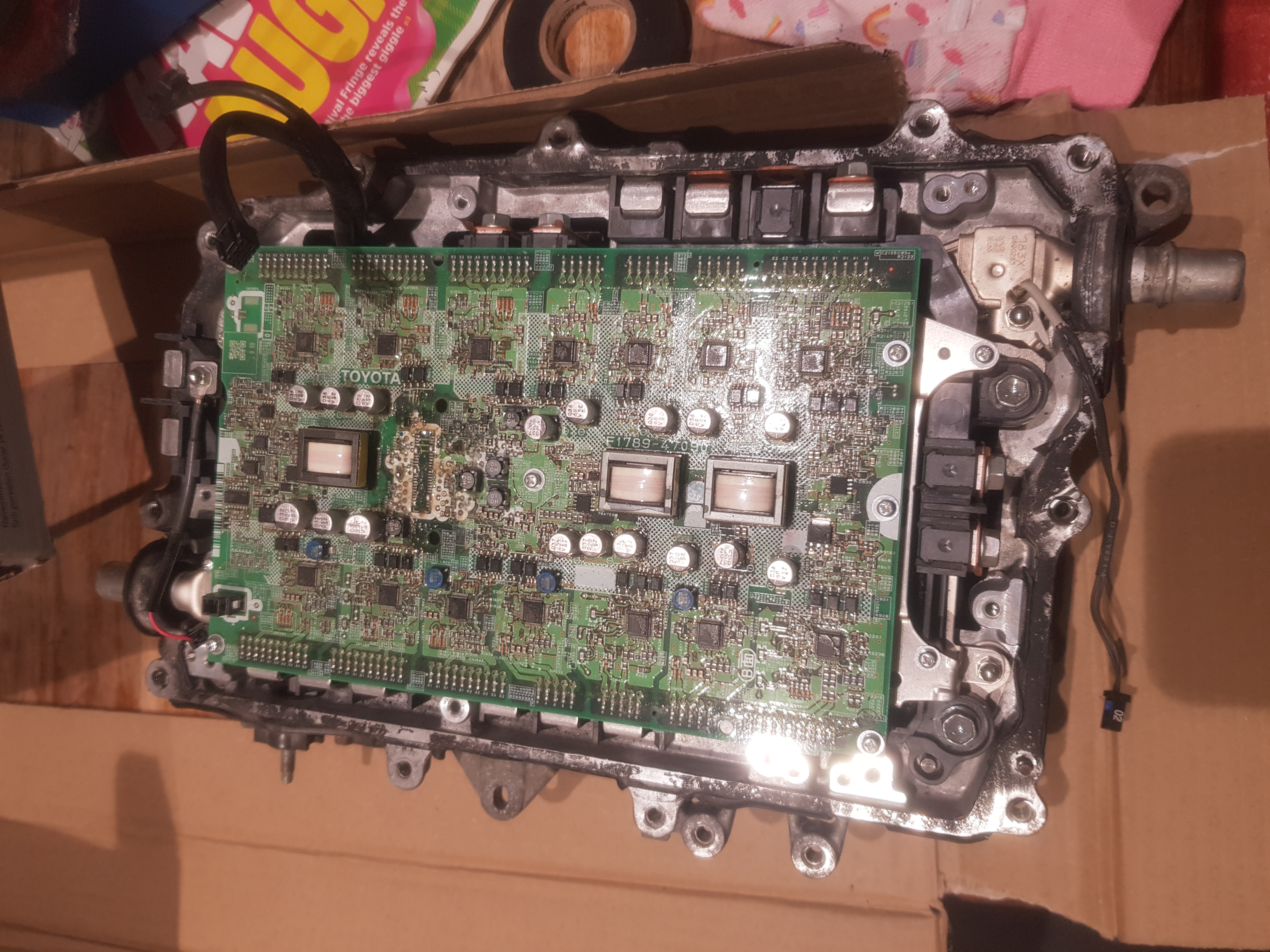

What was the failure mode of the Prius inverter that you had before the Yaris one?

What killed it? My old charging code didnt check the contactors was closed, the outlander charger ignores the voltage and respects the requested current. I did a firmware update while charging, silly right?, contactors opened. Charger filled inverter caps to 420v, voltage was above precharge so contactors closed right away. Blew the fuse and inverter could no longer report voltage hv so precharge error.
Still got the power stage and driver board.

Safe to assume that it was nothing to do with the cutt outs then!
Wonder what failed, the inverter shouldn't have had a problem with 420V, IGBTs should have been off, should have been no current through the boost inductor?
Just one thought, you are powering it direct to the DC bus terminals rather than through the Prius battery input connections aren't you?

Direct to dc bus.
Didn't spend any time looking in to why. My only thought was the rapid discharge damaged something.

Thought it would be but it just occurred to me that the boost inductor in series could explain the dead Prius inverter and possibly even the cutouts so worth mentioning just in case.
Bargain on the Yaris inverter! Don't bin the Prius one, may well be some bits worth salvaging.

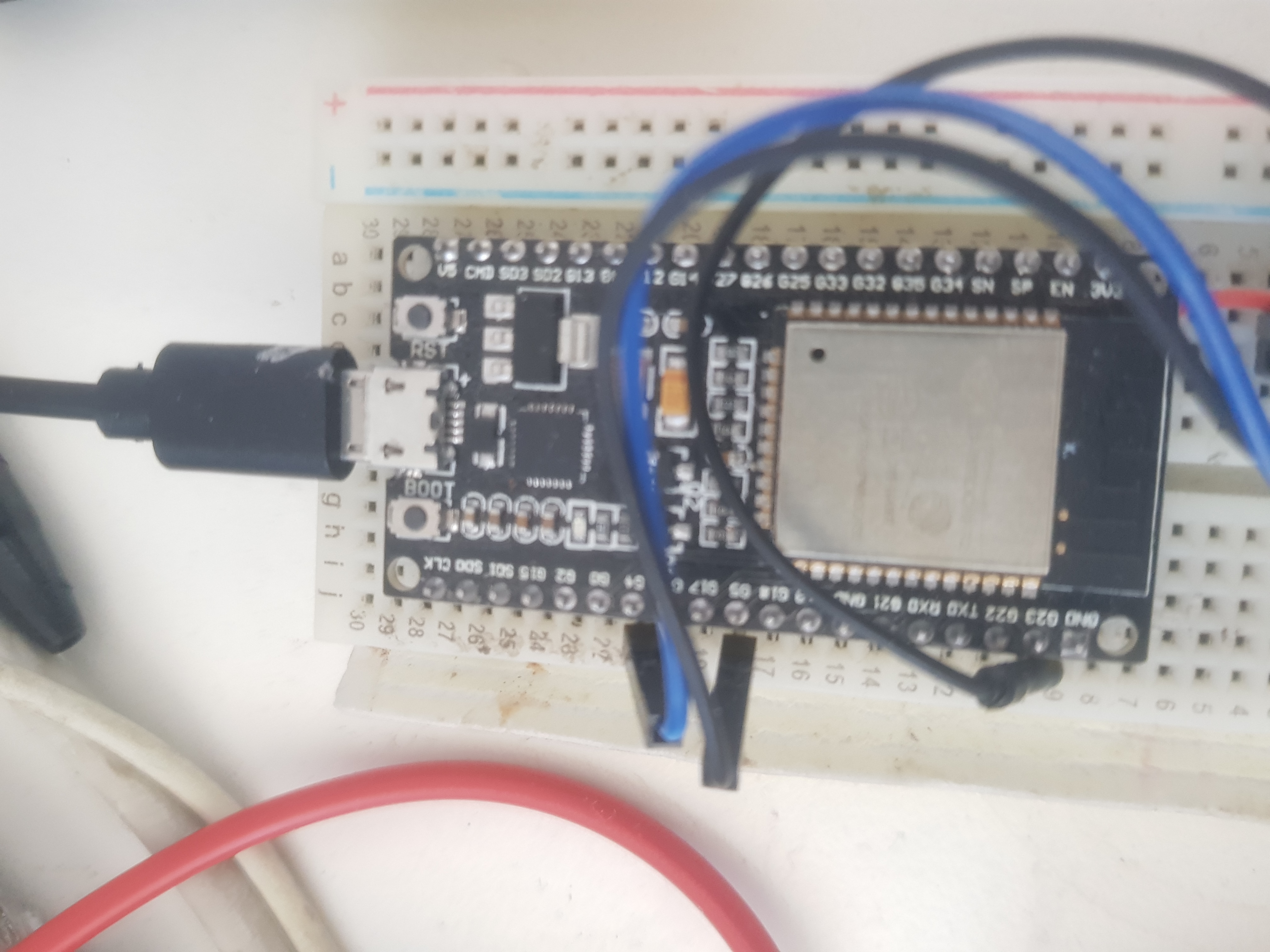

Ok, the module Ive gone for has a ESP32-WROOM-32E on it and Im going to try and get the card working in sdio rather than spi mode so anything compatible with those should work fine. Will start a new thread for it once the bits turn up.
- Posts: 1787
- Has thanked: 83 times
- Been thanked: 431 times
Did you get a dev module with built in sdcard or a separate one? Got a link?

Couldnt find one with an integrated SD so went for one of these https://shop.pimoroni.com/products/adaf ... kout-board, should be here tomorrow.

Got a few pretty similar on desk next to me atm. Just need to pickup an sdcard breakout.

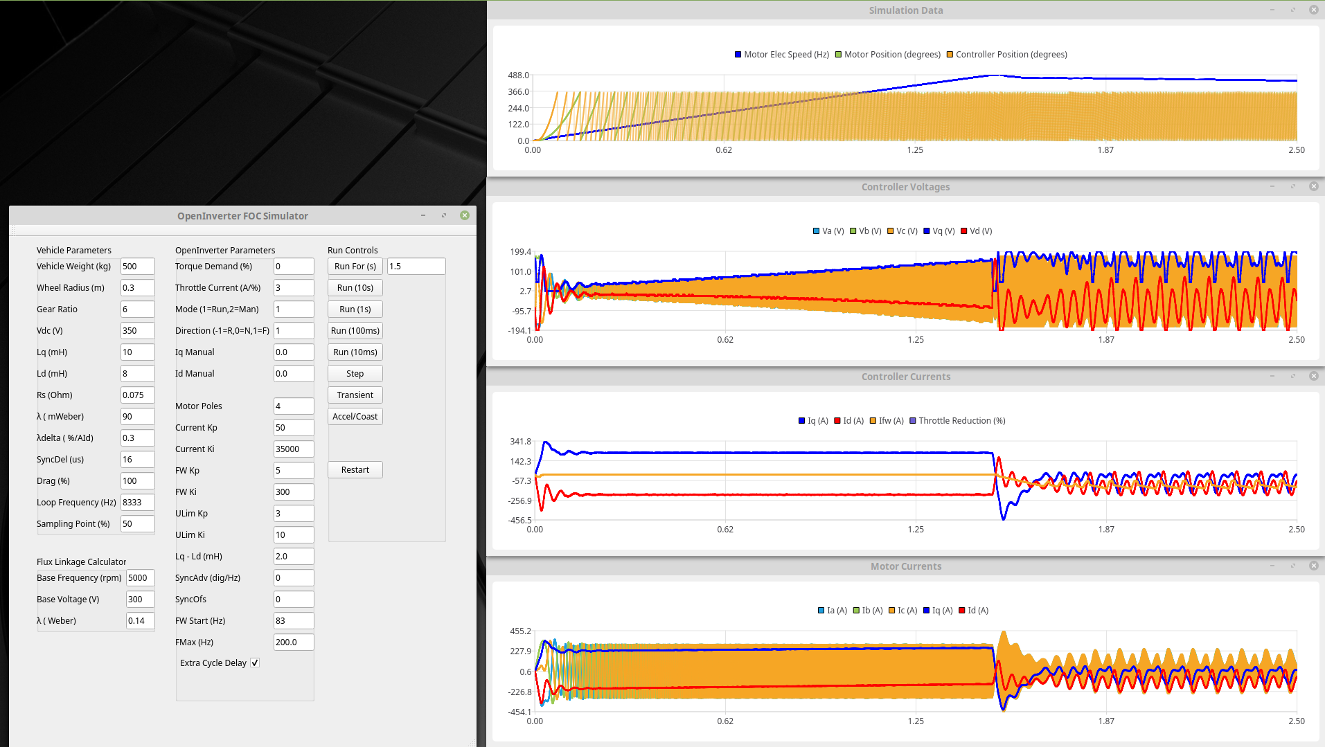

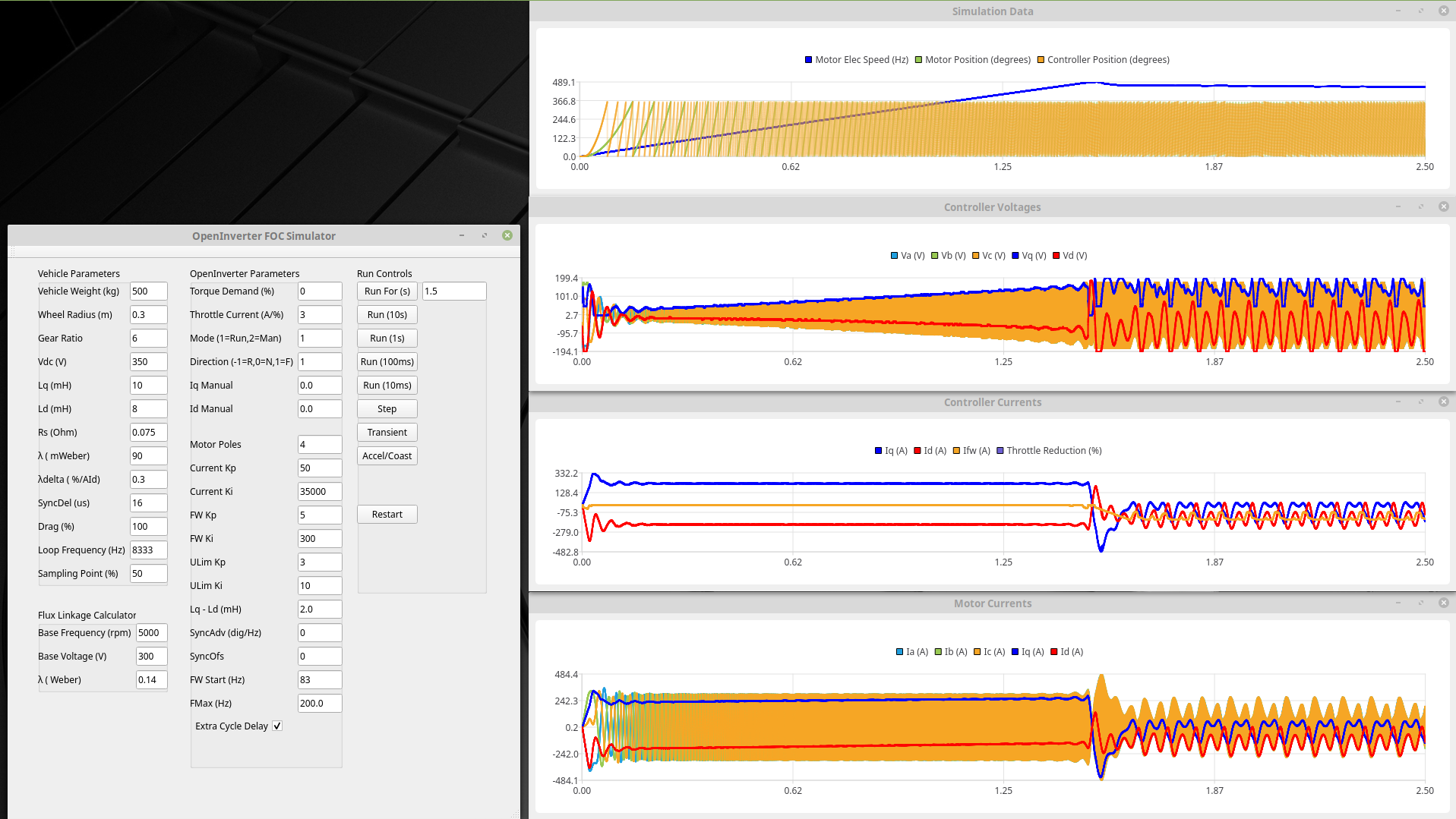

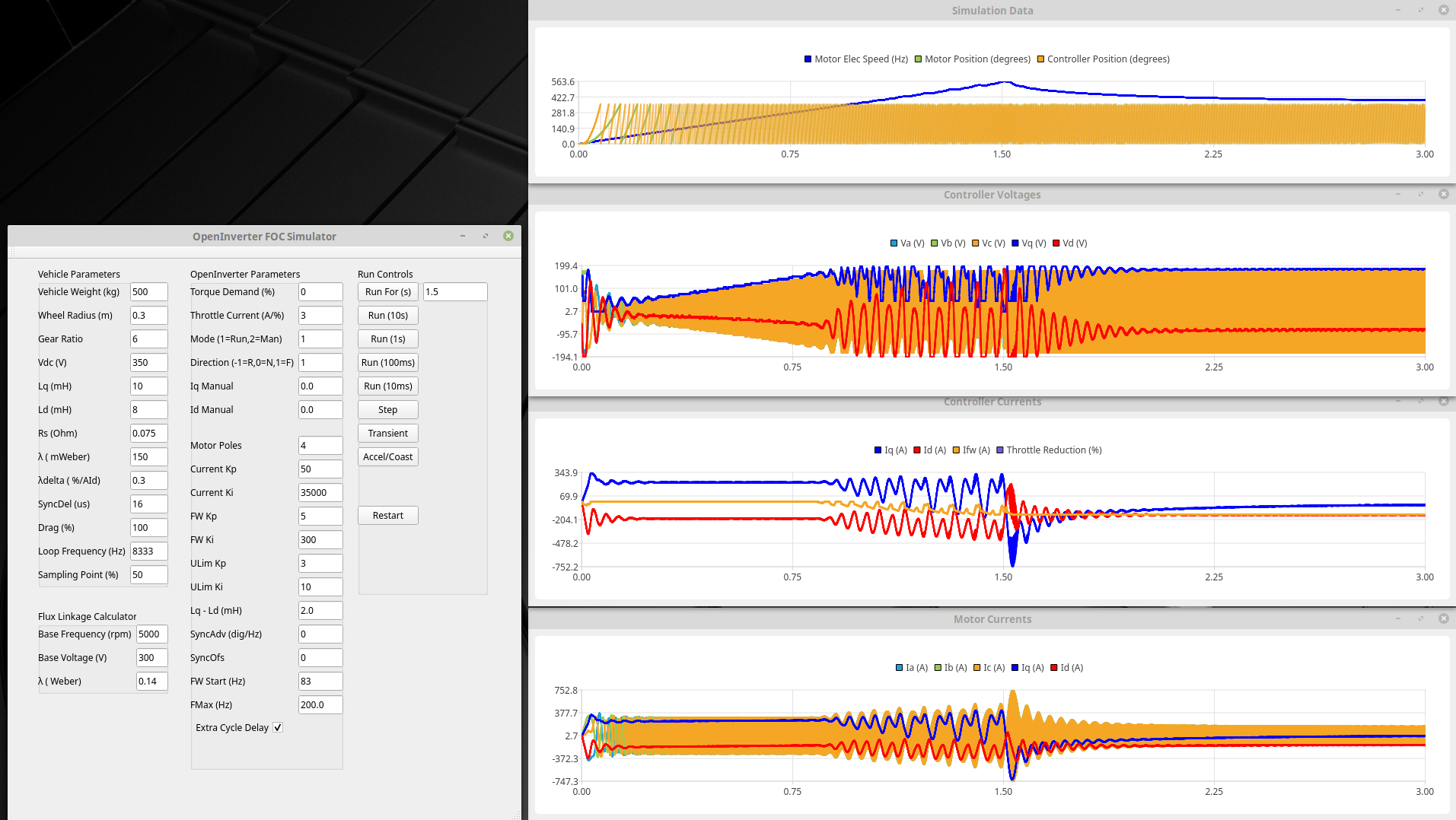

Here are the plots, two for each. One run just accelerating and one accelerating to around 7krpm and then coasting.johu wrote: ↑Wed Oct 05, 2022 5:52 am Went for another test drive on the different terrain around my dads place. More straight and level roads.
I changed the maximum d-controller amplitude to max-3000 (was max-1000) to leave more room for the q-controller and set fwmargin=4500.
Before I had driven with fwmargin=2500 and experienced a short burst of acceleration when coming OFF throttle
Shocking result: unwanted acceleration. At about 7000 rpm I came off throttle and the car accelerated happily to 8500 rpm or 100 kph in 2nd gear. Would be nice if it did so on demand. Had to force it back down to 3500 rpm, then came a bang and regulation recovered. No over current. Unfortunately no logging as it was just a quick test and one I certainly don't want to repeat as it is harsh on the battery.
Pete, can you simulate above settings? I know I could but you are more savvy with the simulator. The settings are as posted here viewtopic.php?p=45280#p45280 but fwmargin=4500 and maxVd=max-3000 in PwmInit()
fwmargin=2500, d-controller max-1000: fwmargin=4500, d-controller max-3000: The differences are fairly subtle and there is no significant difference between the behaviour of the two coming off the throttle. None of them look stable though and they are both going open loop at times when moving to coast. My gut feel is that you were lucky with the 2500 version (it was still going unstable/open loop but not in a way that produced the nasty effects) and it only took a small change to push it outside that sweet spot. Without more detail (a high speed log for example
The goal has got to be to get the control loops stable and staying within the closed loop region. I think part of the problem is that when you come off the throttle the Mtpa pulls a lot of -Id out. Up to that point that -Id has been helping with the FW but with it gone the FW controller has to suddenly add a lot more -Id to replace it to stop the motor voltages shooting up (you can see this in the plots where Vd and Id shoot up to full scale positive before being slowly pulled back down). This required a very fast FW loop response which then compromises the normal FW control and causes all the noise problems that can be seen in the plots. By changing to the FW and Mtpa scheme I suggested above you avoid this discontinuity completely and can instead tune the FW controller to be a lot slower which avoids all the noise and avoids a lot of the stability issues.
Edit - you can also see the difference between the controller view and motor view of the currents in the plots. Sync compensation should help with this and allow better separation of the q and d components.
Edit2 - That's interesting, based on the simulation FW isn't needed at 7k, will have a look at the settings as see what that means!
Edit3 - Ignore the above for now, flux linkage of 90 seems a bit low for the leaf motor, 150 would seem more reasonable. Need to redo the simulations to see what effect that has.

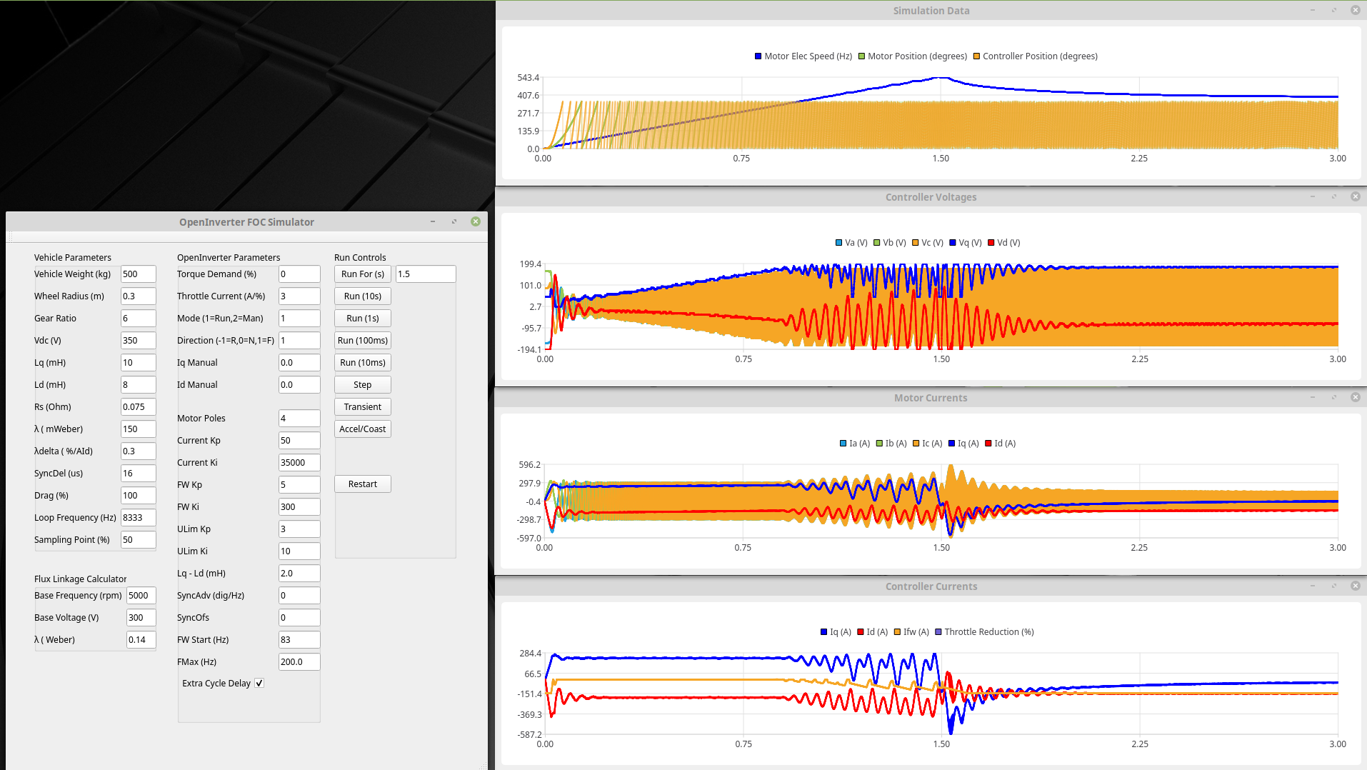

Two new plots, both accelerating to around 7k and then coasting but with the value of 150 for flux linkage so that FW is now active at that point.
fwmargin=2500, vd = max-1000: fwmargin=4500, vd = max-3000: Except that I got two of the plots swapped on screen
they look very similar. The fwmargin=2500 is slightly more stable (bigger overshoots on the currents on the fwmargin=4500 plot) but there is not that much in it. All the comments in the above post still apply.

Speaking of real data. If we know the battery voltage, frequency and modulation index to obtain a certain d or q current - doesn't that provide us with Ld and Lq?
- Posts: 1801
- Has thanked: 102 times
- Been thanked: 350 times
Sort of
Its not quite that simple though.
First imagine a locked rotor, in that case the DC currents are defined by the winding resistance. The inductance only determines the ripple current at the pwm frequency (lower inductance - higher ripple). This is how I proposed to measure lq and ld a while back, slowly rotate the motor while measuring how the hf ripple changes as the poles pass the stator.
Then as the rotor starts to spin you get three more terms coming in, the back emf in phase with the vq and dependant on flux linkage and speed, a term in phase with d proportional to speed, Lq and lq and one in phase with q that is proportional to speed, Ld and ld. The model doesn't currently include the last two (I don't fully understand their origin and would like to before I add them,). These may well be why the unwanted acceleration isn't there in the model? The other problem including them is I really don't have a good handle on sensible values for ld and lq.
The last complication is the the voltages commanded via the modulation index do not take effect till the next pwm cycle. This delay is a fixed time and therefore a variable angle as speed changes and so the q and d voltages set by the controller do not match those seen by the motor which causes some interaction from the controllers perspective.
Bear in mind all the above is from memory and I may find it is completely wrong when I go back and look at the equations!
Once we have real data I'm wondering if the best way to tune the model to match a motor is to have a process that just randomly adjusts the parameters and looks for the best fit rather than trying to calculate them.
Edit - forgot to say unwanted acceleration or deceleration can easily be produced in the model by playing with the delay based interaction mentioned above. Having set it to what I think is an accurate representation of the controller timings I tend not to adjust it though. The model suggests that unwanted acceleration or deceleration can occur when -id current commanded by the controller is actually seen by the motor as either +iq or -iq due to the pwm and calculation delays. This is what the sync compensation is meant to fix.
Edit2 - corrected extra terms description above to include Ld and Lq

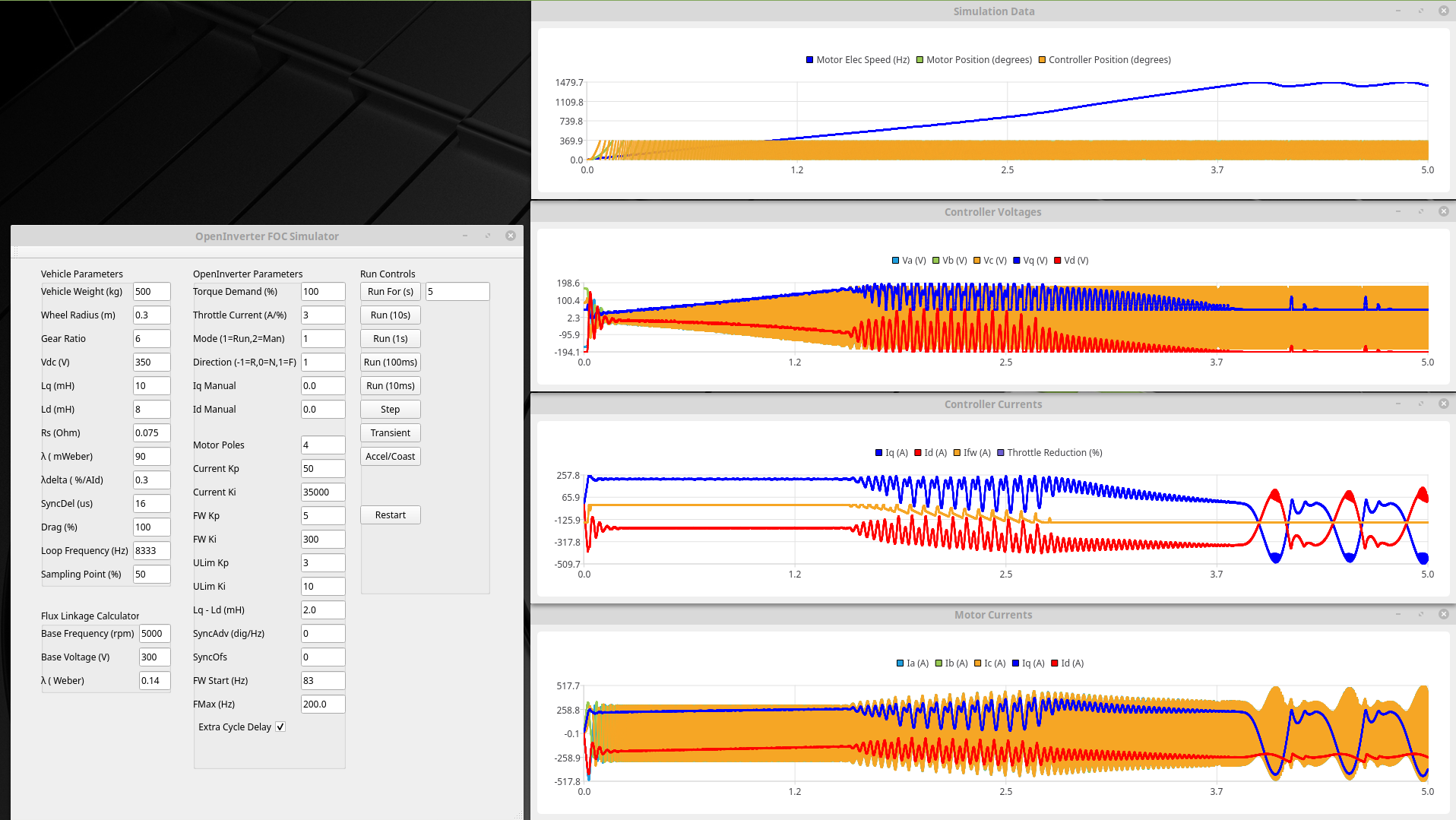

Added the previously omitted equation terms to the simulator and the results are significantly different to before but there is also some very odd behaviour and it is very, very sensitive to motor parameters (with Lq/Ld inductances of more than a couple of mH the results just make no sense at all!).

Looking a bit more at this and I'm wondering whether the simulation is right and the inductance values I'm using are wrong. I've never been able to find any really good Ld and Lq data for motors so it has been a bit of a guess but I'm wondering if the 2-10mH typical values I've been using are waaay too big.
The only data I can find is here https://macsphere.mcmaster.ca/bitstream ... _Ph.D..pdf, Fig4.9 on page 98 (p122 of pdf). It gives values for the leaf motor of Lq ranging from 550uH at 0A reducing to 330uH at 300A and values for Ld ranging from 150uH to 100uH for the same currents. Now these are 10-100 times lower than the values that I have been using in the simulations (and also much, much lower than the values typically used for the Mtpa calcs in the inverter software) and would make a massive difference to the results - the latest simulator results with the extra equation terms might actually start to make sense at that point!
So the question, does anyone have data for the Lq and Ld inductance for other motors?
Note - once we have a good set of logged data these values can also be worked out from that.
Edit - just tried the lower values on the new model and the results look very good
Hoping that someone can provide some evidence that the motor inductances are typically in the low hundreds of uH rather than mH.
Edit2 - Even the extra torque generated by Mtpa looks sensible now (which has always previously bothered me as being way too high)!
