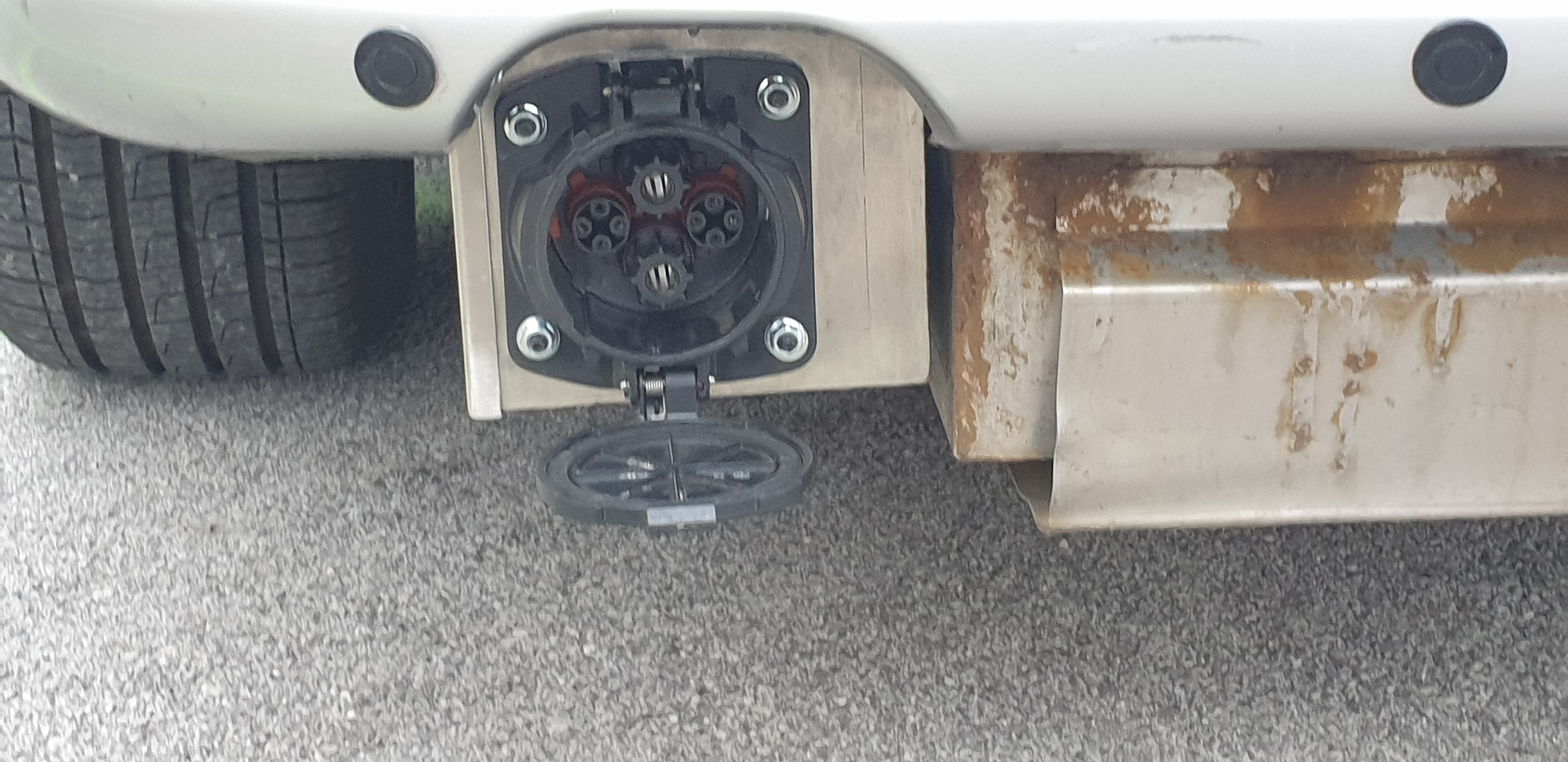

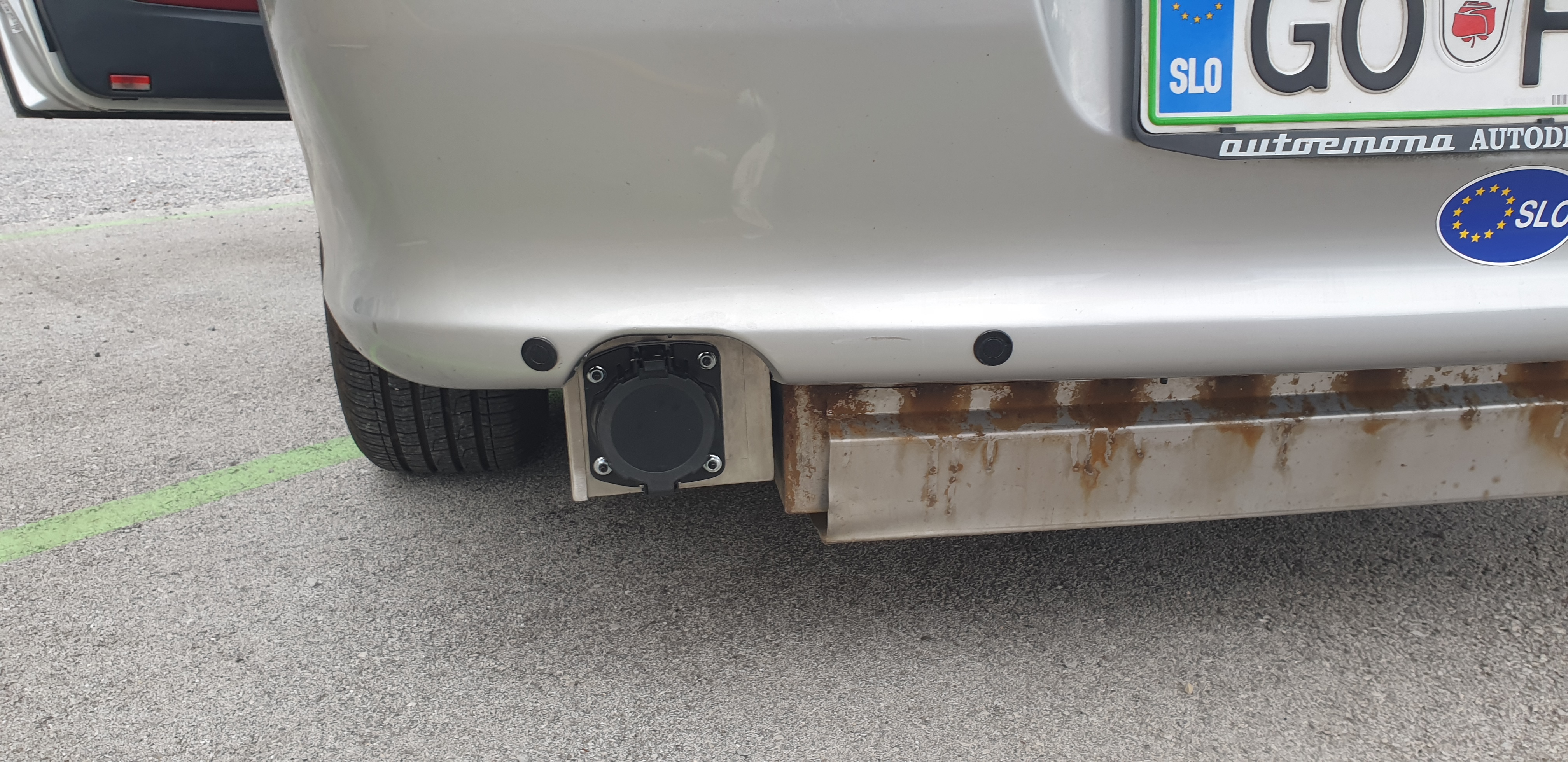

Posts: 3796
Been thanked: 413 times
Finally the fruits of my labour...
I mounted the box to the place of exhaust. Self sustained no power from the car required. Apart from solid GND. I intend to test this a bit. In the end i will probably add CAN line to BMS for protection.
I intend to simply use a heartbeat telegram similar to Outlanders 0x285 to keep chademo operating. If that would be missing VCU would stop.
Edit: that rust does not belong there 😁. I guess there is no inox welding wire. I have to sort it out before winter.
