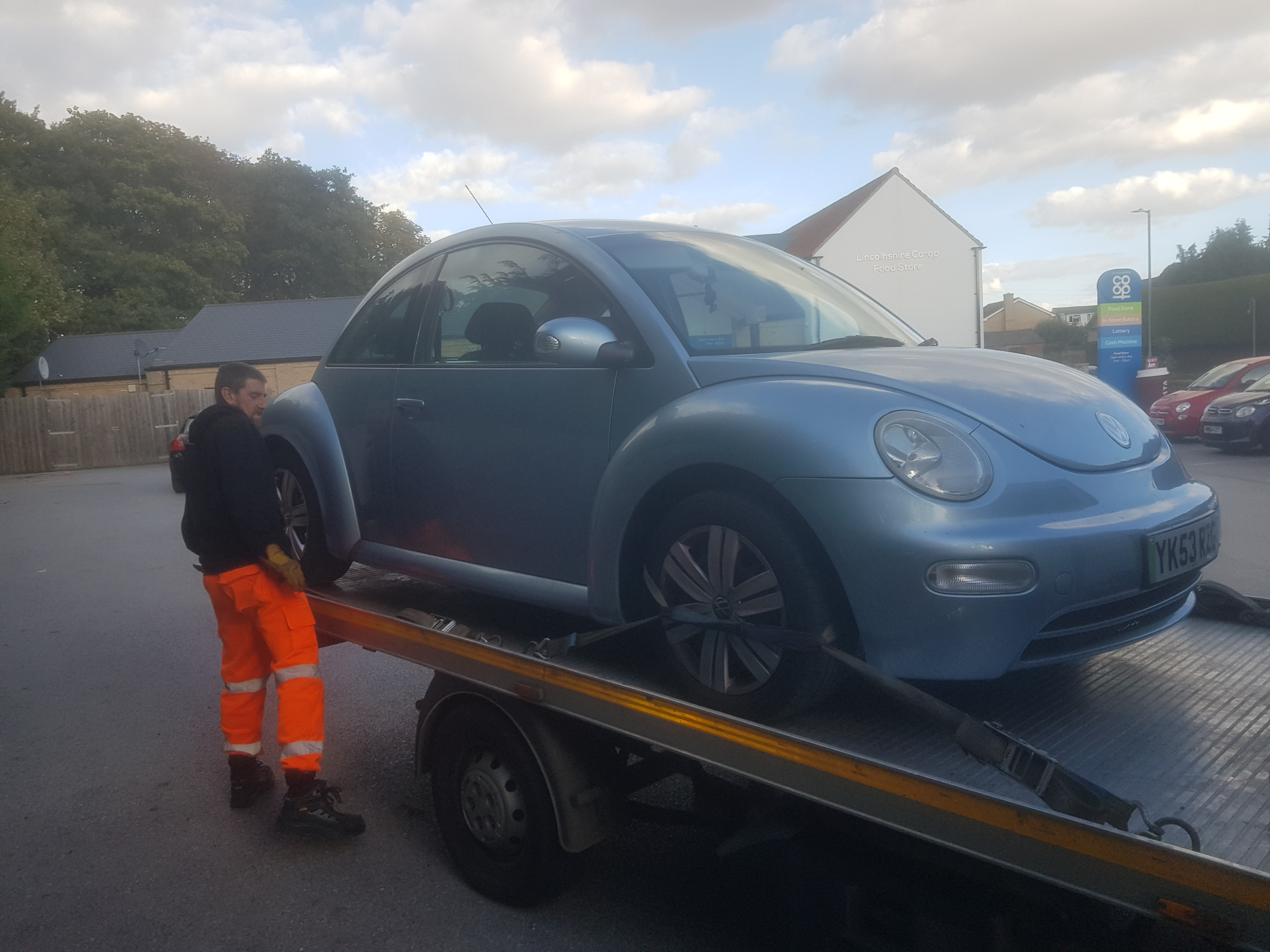

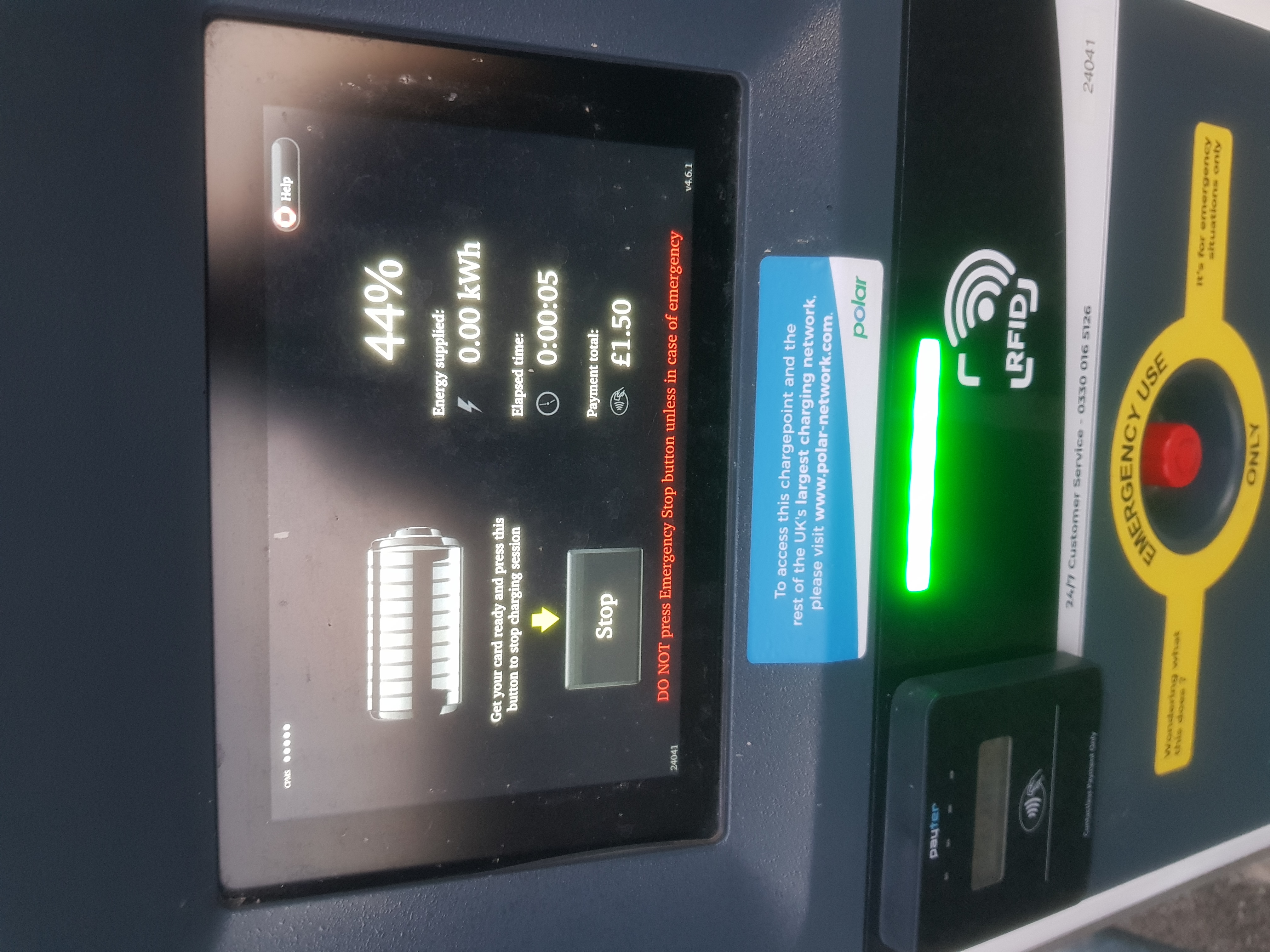

Currently awaiting recovery :( tried multiple chargers and now too empty to continue, getting recovery home instead of desired destination so I'm not stuck again :(
Charging starts then immediately stops with no apparent reason.

I'm not sure what the problem could be, it was communicating properly from what I can tell with the log file, the current request ramps up then it just stops at 4 amps.

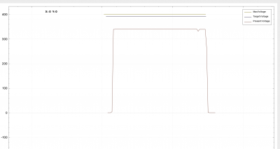

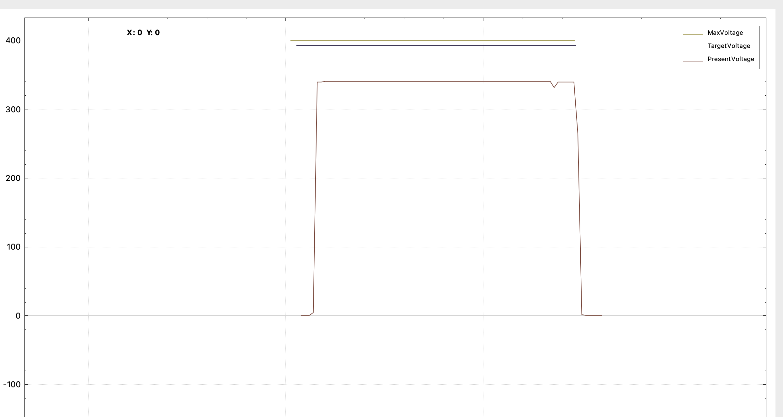

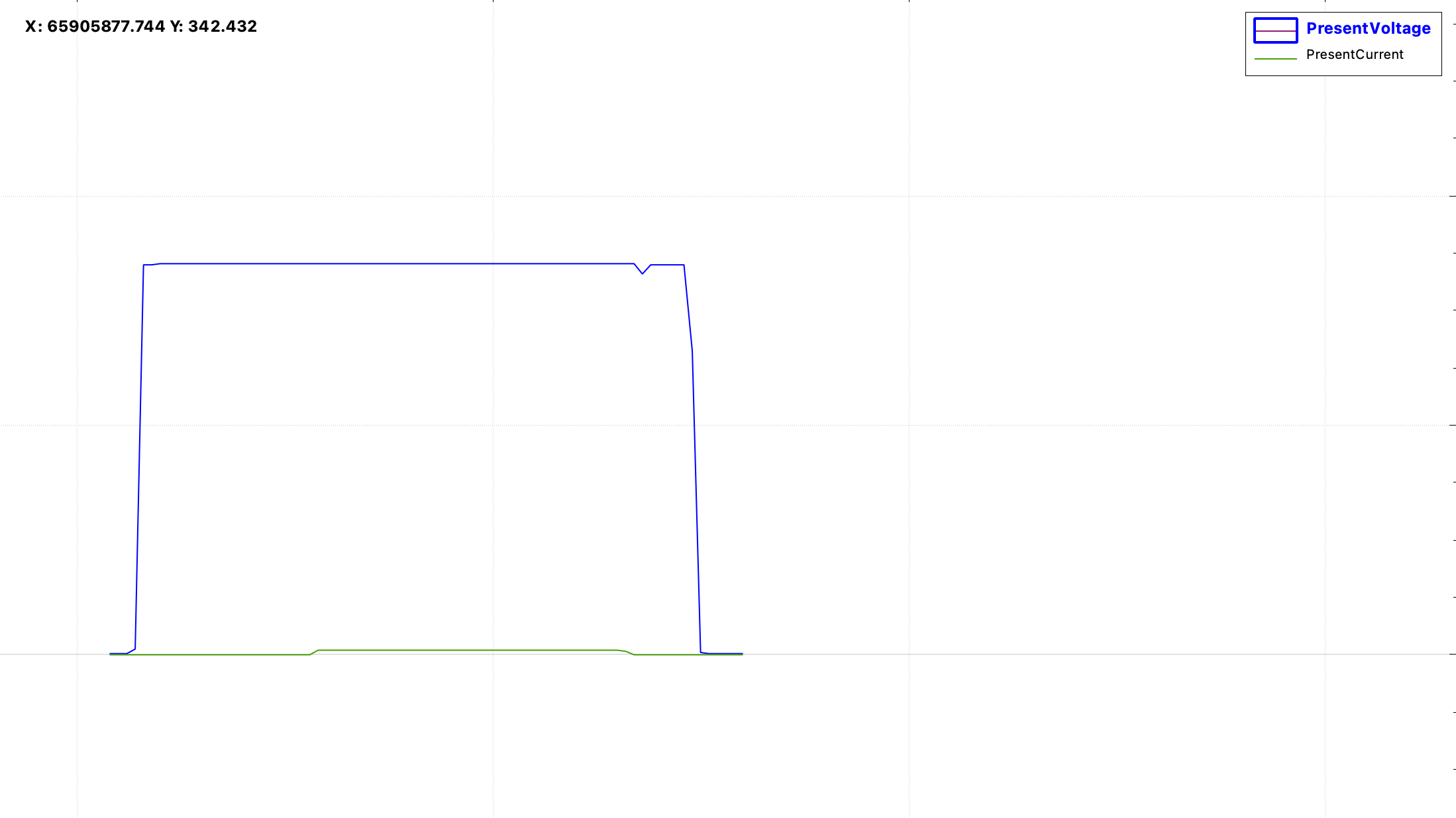

Still an issue today so grabbed a log
Looks like the voltage seen goes up to ~340v but doesn't drop back below 20v before staring the charge.

Looks like I've blown an input pin, IN2 is being constantly pulled to ground, the contactors are closing too early. Need to redesign to add input protection I guess.
