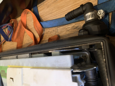

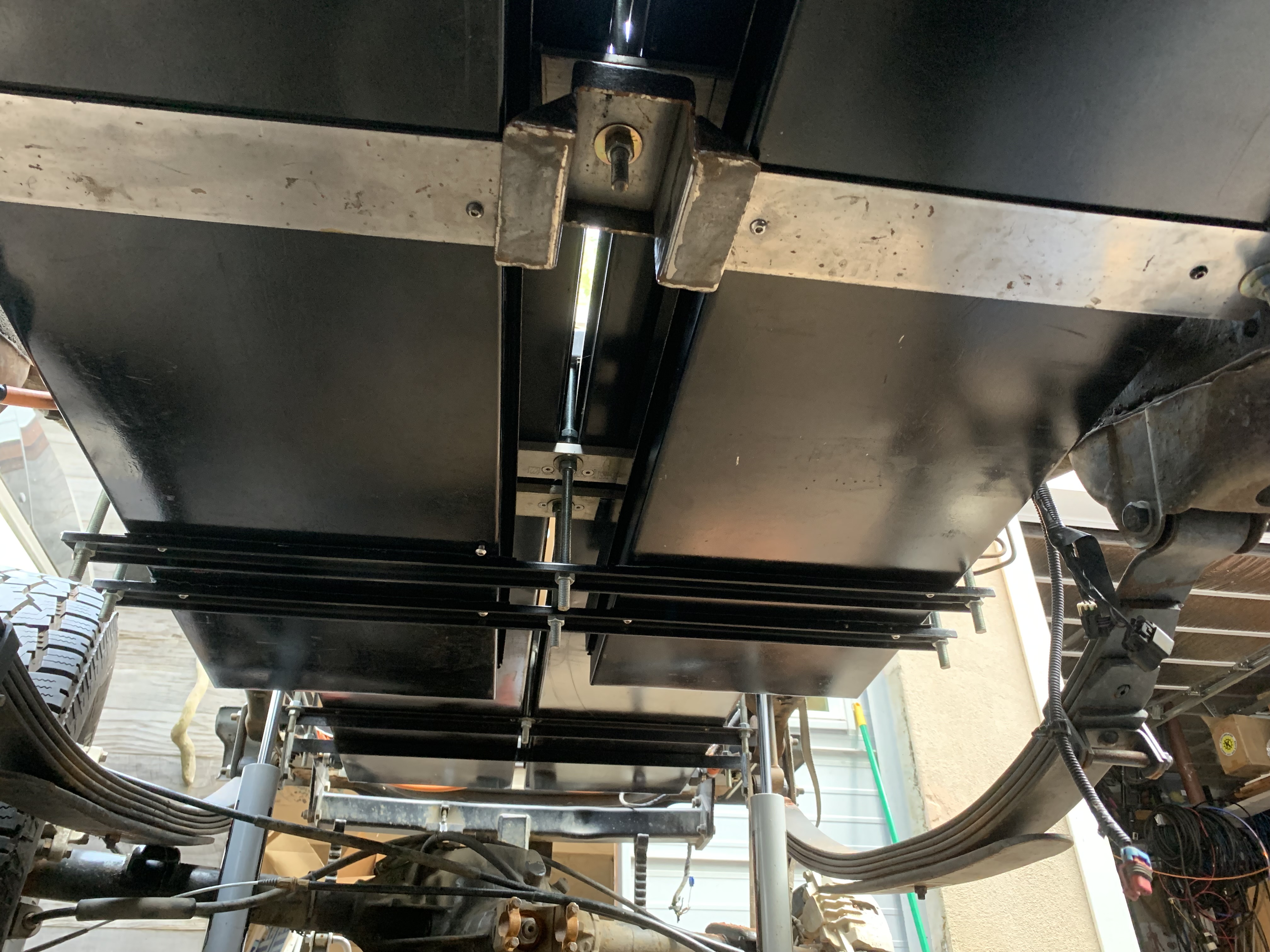

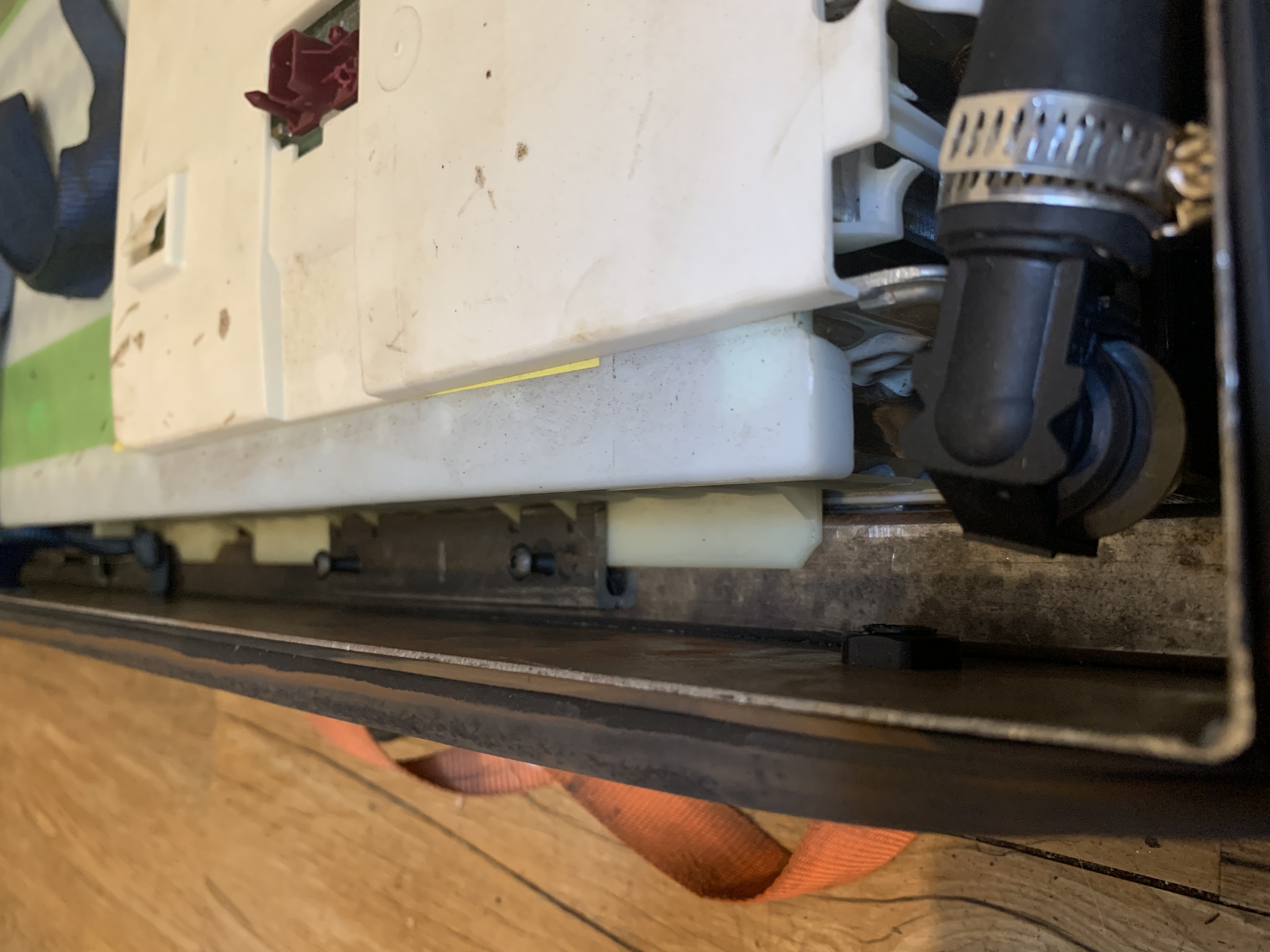

For me the biggest challenge by far has been dealing with the Model 3 modules: both BMS control, and packaging them strongly and securely into the vehicle. I lifted the truck in order to make room for the batteries between the body and frame. The long modules will fit like a glove under the bed and about 6" under the cab. The short modules will go below these, and further forward so that they are roughly equally below the bed and the cab. I've mostly finished the boxes for the long modules, haven't done much on the boxes for the short modules, and have partially completed a mounting system for the 4 boxes. I've both modified and fabricated new crossmembers that will support the battery boxes from above using threaded rod and crossbars. I think my current approach could use some improvements, both securing the batteries in their boxes, and securing the boxes within the vehicle. Would love to hear ideas and suggestions from you all!

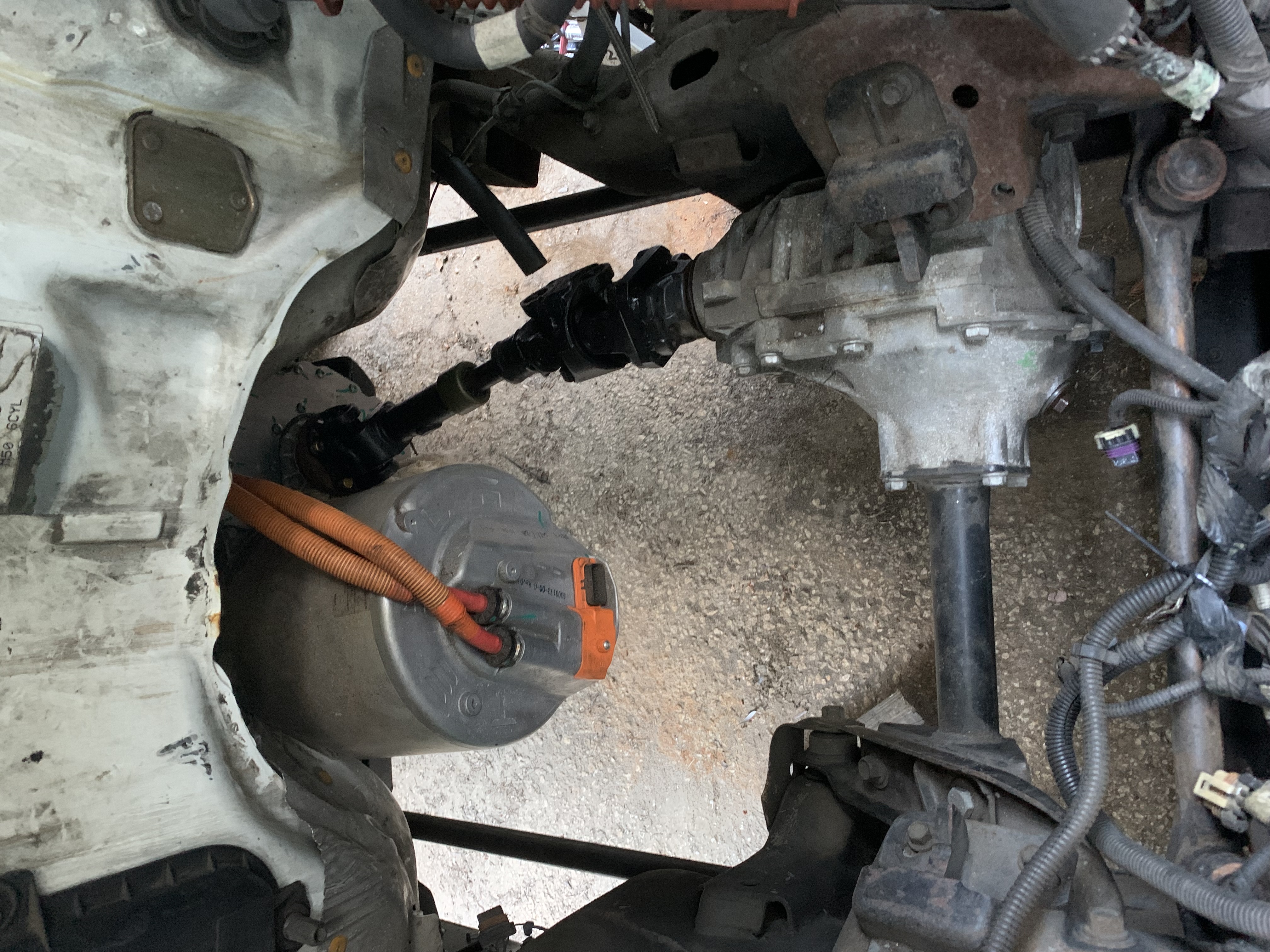

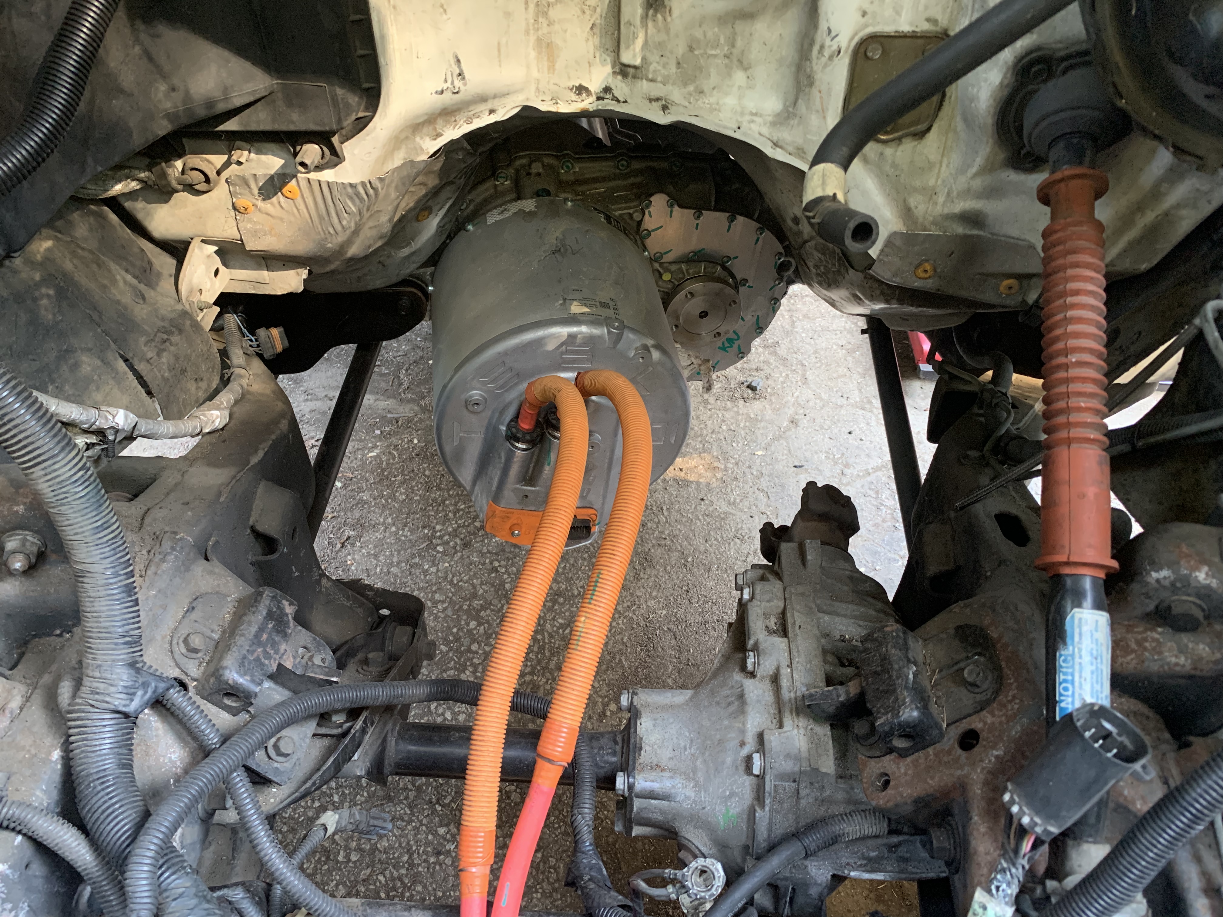

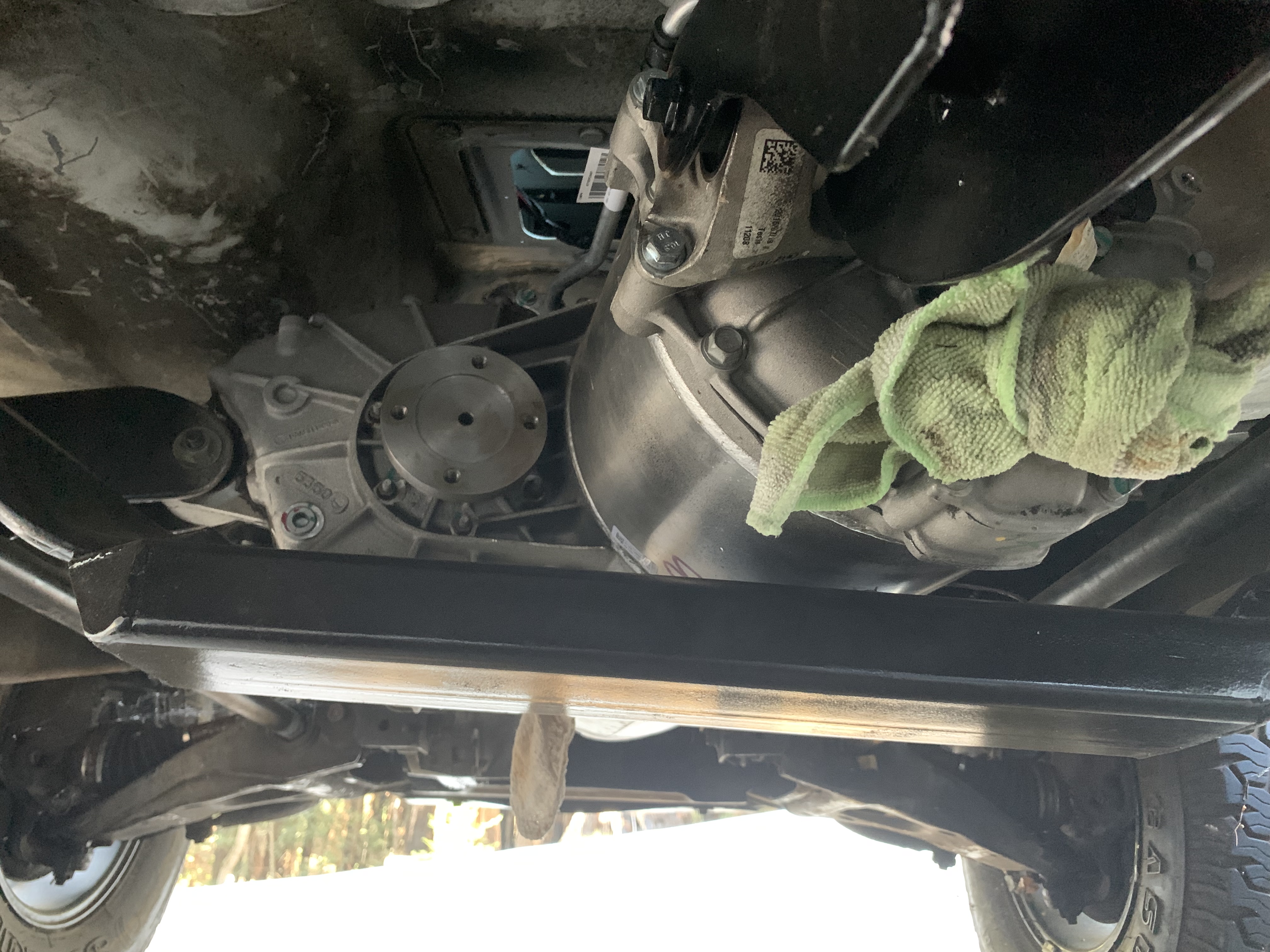

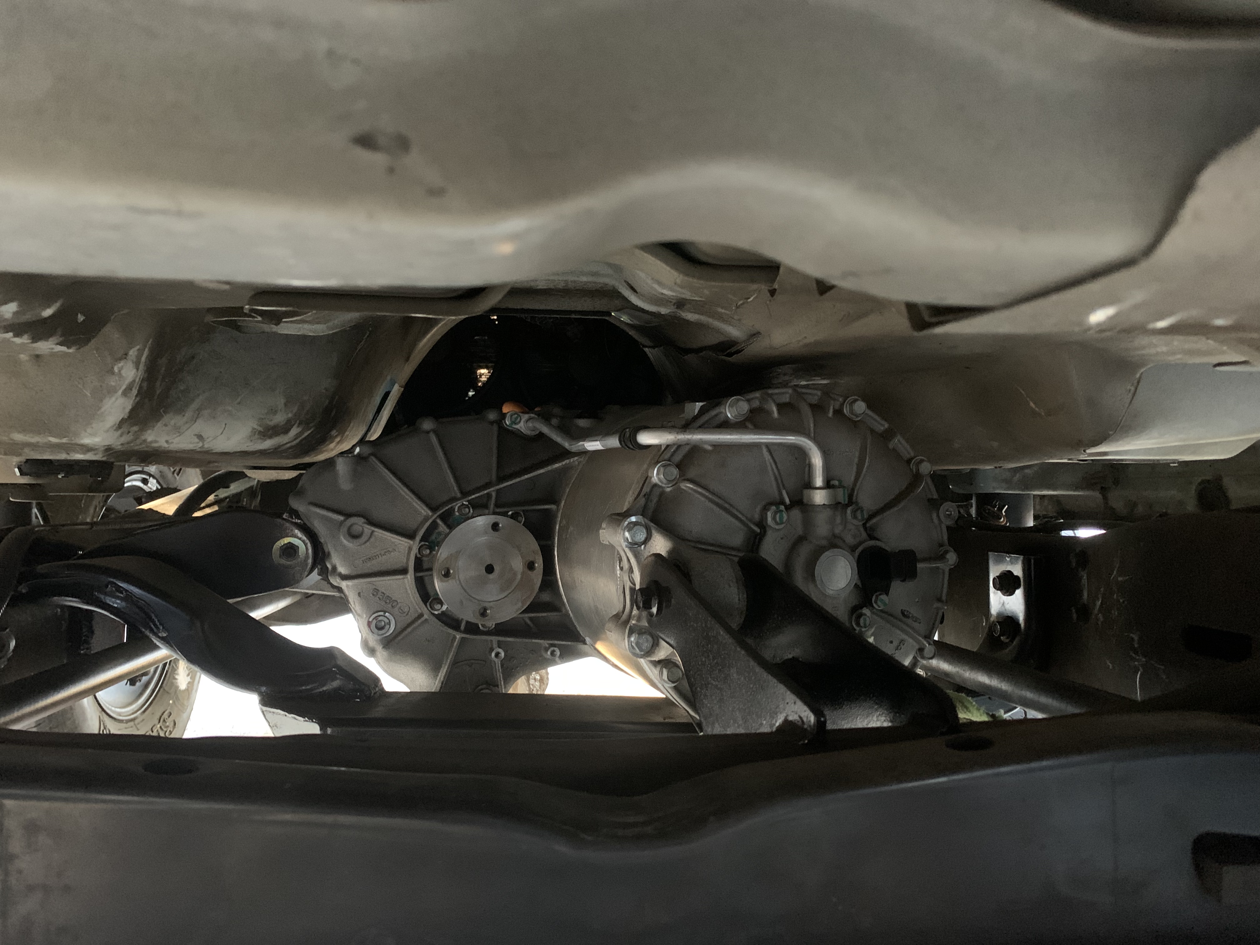

As for the remainder of the build, I've Quaifed all over the LDU with new gearing and LSD, plus the trusty openinverter controller. I've got a prius accel pedal installed and prius power steering (not yet installed). I got driveshaft adapters made at the machine shop as you can see in the pics, but haven't had driveshafts made yet.
I've upgraded the rear springs to heavy duty, replaced front and rear diffs with LSDs, replaced the rear end with one with disc brakes (plus a SOA conversion), installed some junkyard electric fans on the stock radiator...

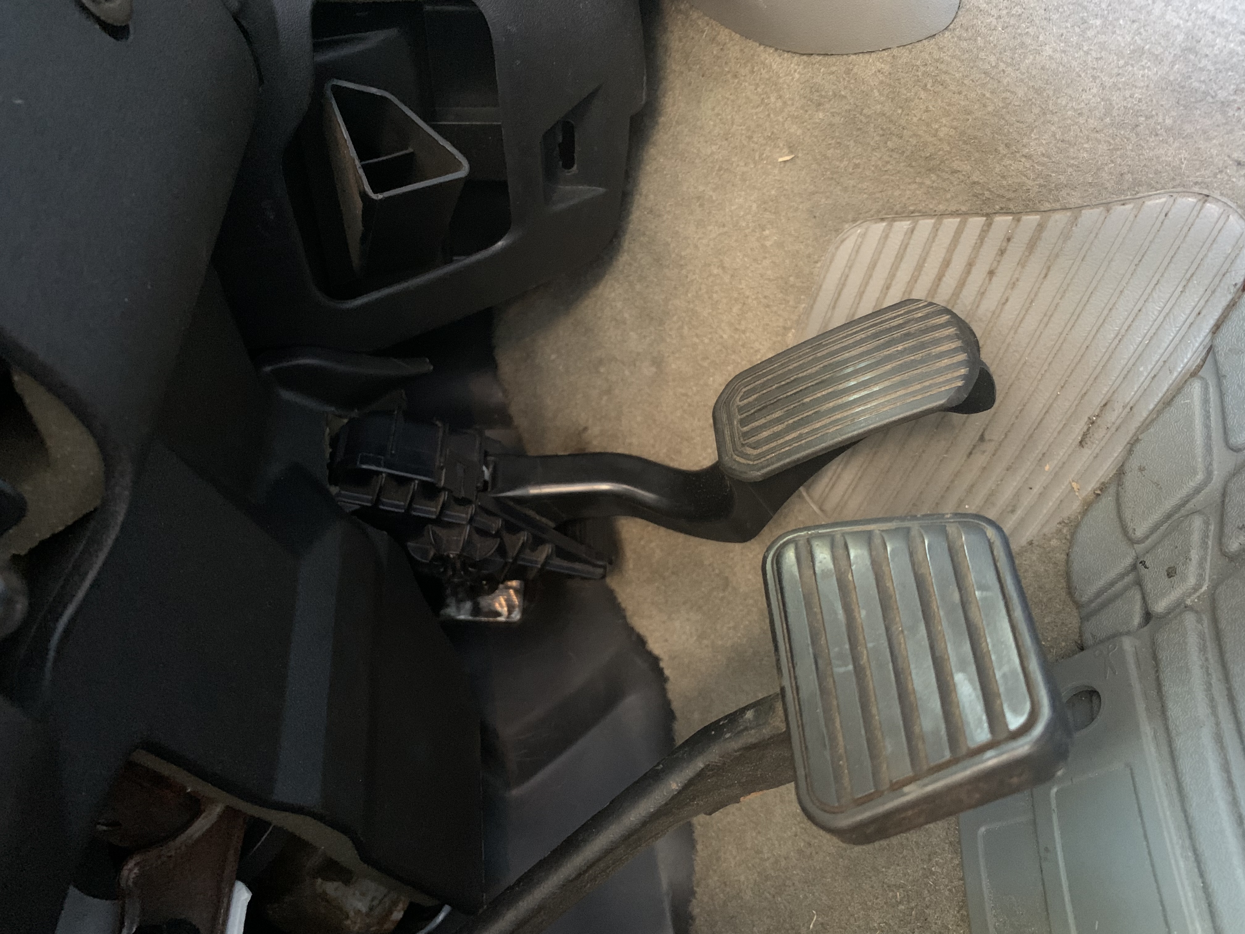

I haven't really taken apart the dash or interior yet; I plan to do that once I've got my batteries mounted.

are you going to get a plunging rear drive shaft made with a support bearing?

Yes, that’s the idea, a two-piece rear driveshaft with a carrier bearing mounted to the crossmember behind the LDU. The longer, rear section of the driveshaft will need a plunge or telescopic bit due to the solid axle suspension.
I mounted my LDU at an angle relative to the vehicle due to my front diff being off center over to the left. So while the output flanges are pointing in roughly the right directions, the angles aren’t all perfect, as in they don’t all add up to zero like in an ideal driveshaft scenario. Still don’t know if this mounting decision was a mistake or not. I’m hoping that some double cardan joints particularly in the front will do the trick. In my truck, mounting LDU at a slight angle actually allowed me to get it further up in to the transmission tunnel than if I’d mounted it straight.

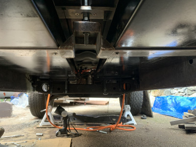

Damien’s ongoing truck build inspired me to get back on the forum and share my similar build! Long overdue update:
Drivetrain complete with modified LDU and custom driveshafts, and hopefully strong enough
All four Model 3 modules individually reboxed and installed
Openinverter model 3 BMS controller connected and showing bugs with the 23s modules. Tom trying to help debug but he needs a spare 23s BMB which I dont have.
6.6kW liquid cooled charger/ DC/DC installed
Vac system for power brakes installed
Reestablished LDU contactor control in the vehicle
Added a 12v fusebox from Nissan Leaf under the hood.
HV junction box mostly complete with ISH shunt, also have spare contactors for eventual Chademo charging.
Still need to finish 12v wiring
