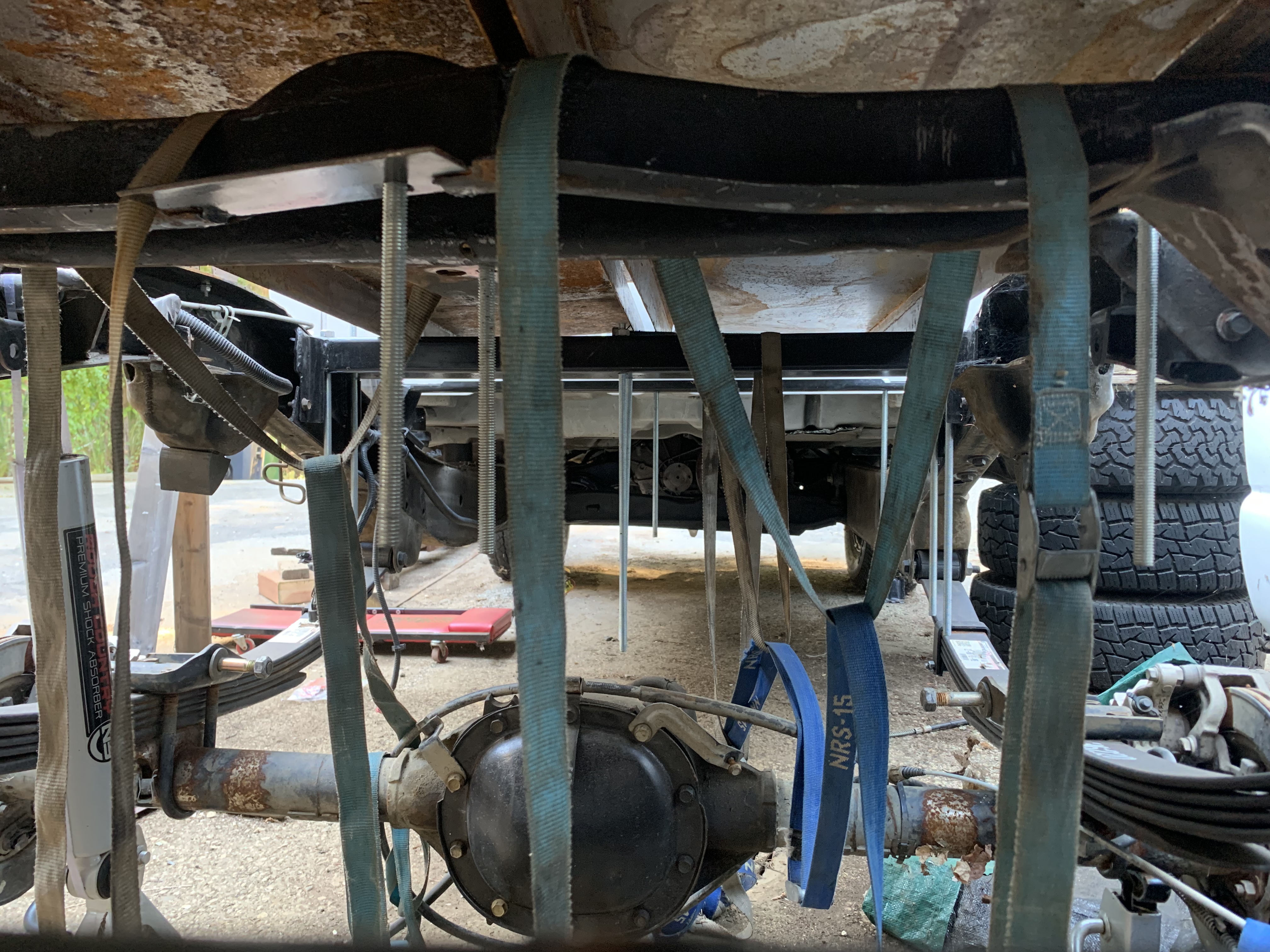

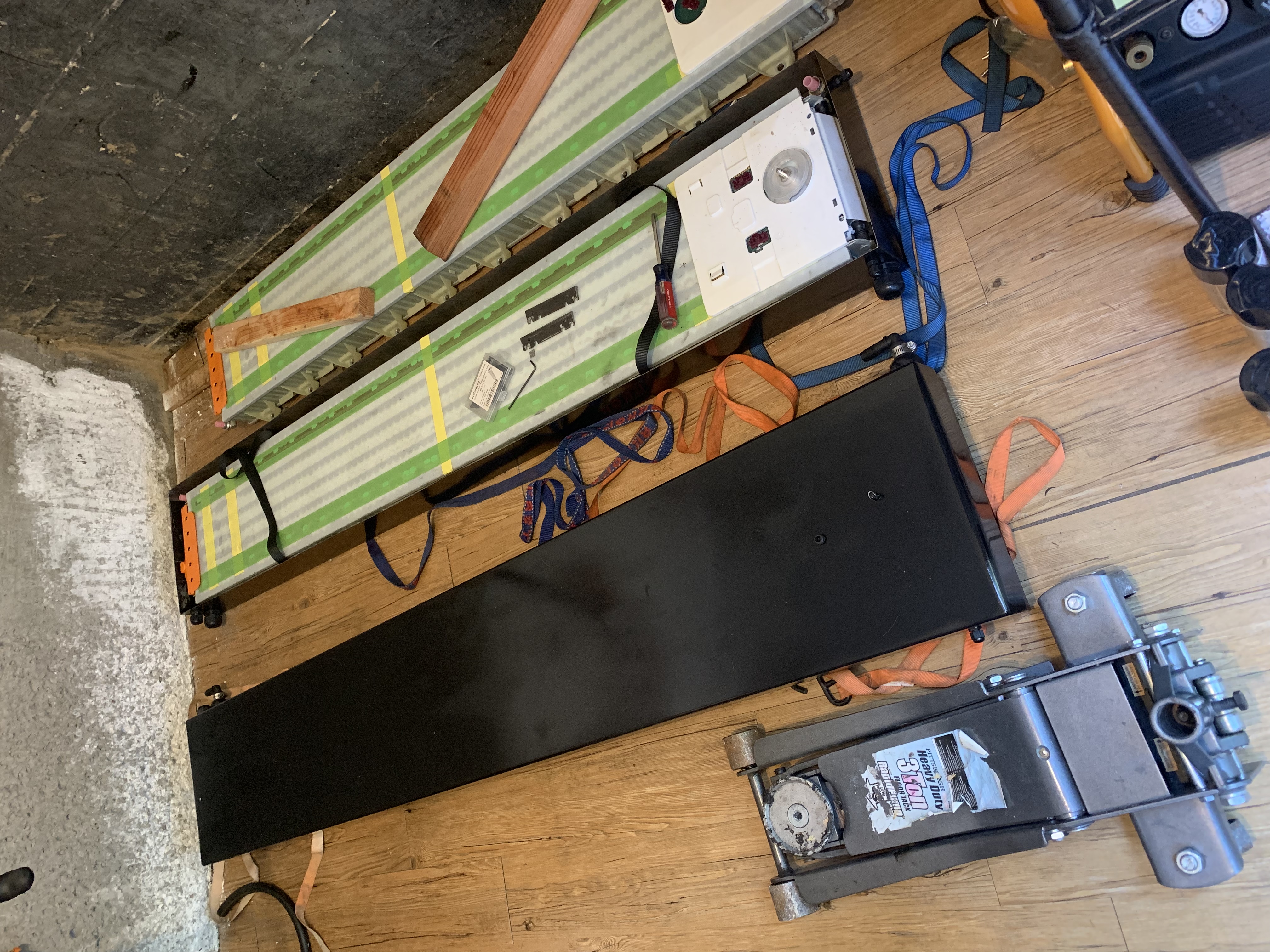

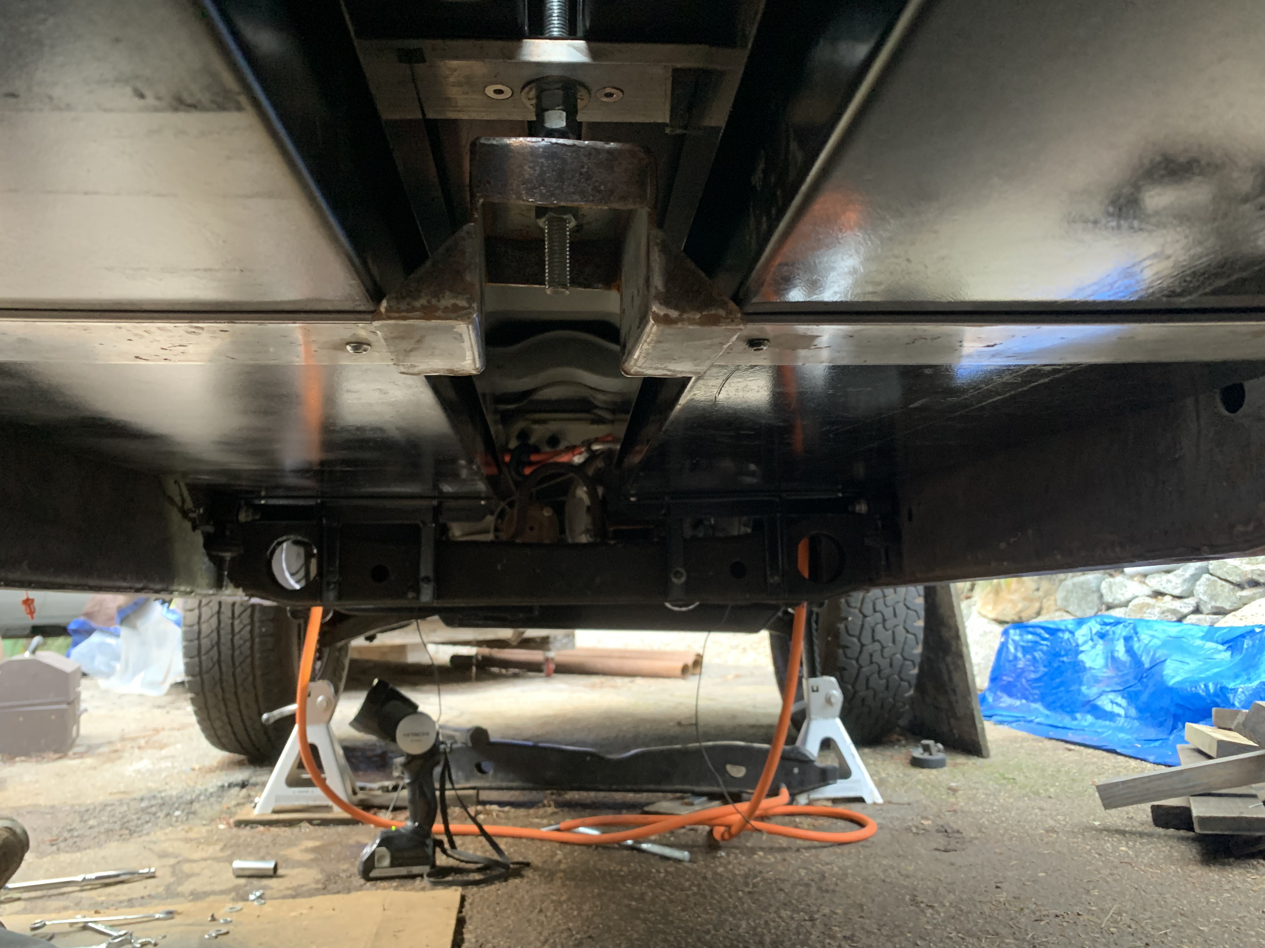

For me the biggest challenge by far has been dealing with the Model 3 modules: both BMS control, and packaging them strongly and securely into the vehicle. I lifted the truck in order to make room for the batteries between the body and frame. The long modules will fit like a glove under the bed and about 6" under the cab. The short modules will go below these, and further forward so that they are roughly equally below the bed and the cab. I've mostly finished the boxes for the long modules, haven't done much on the boxes for the short modules, and have partially completed a mounting system for the 4 boxes. I've both modified and fabricated new crossmembers that will support the battery boxes from above using threaded rod and crossbars. I think my current approach could use some improvements, both securing the batteries in their boxes, and securing the boxes within the vehicle. Would love to hear ideas and suggestions from you all!

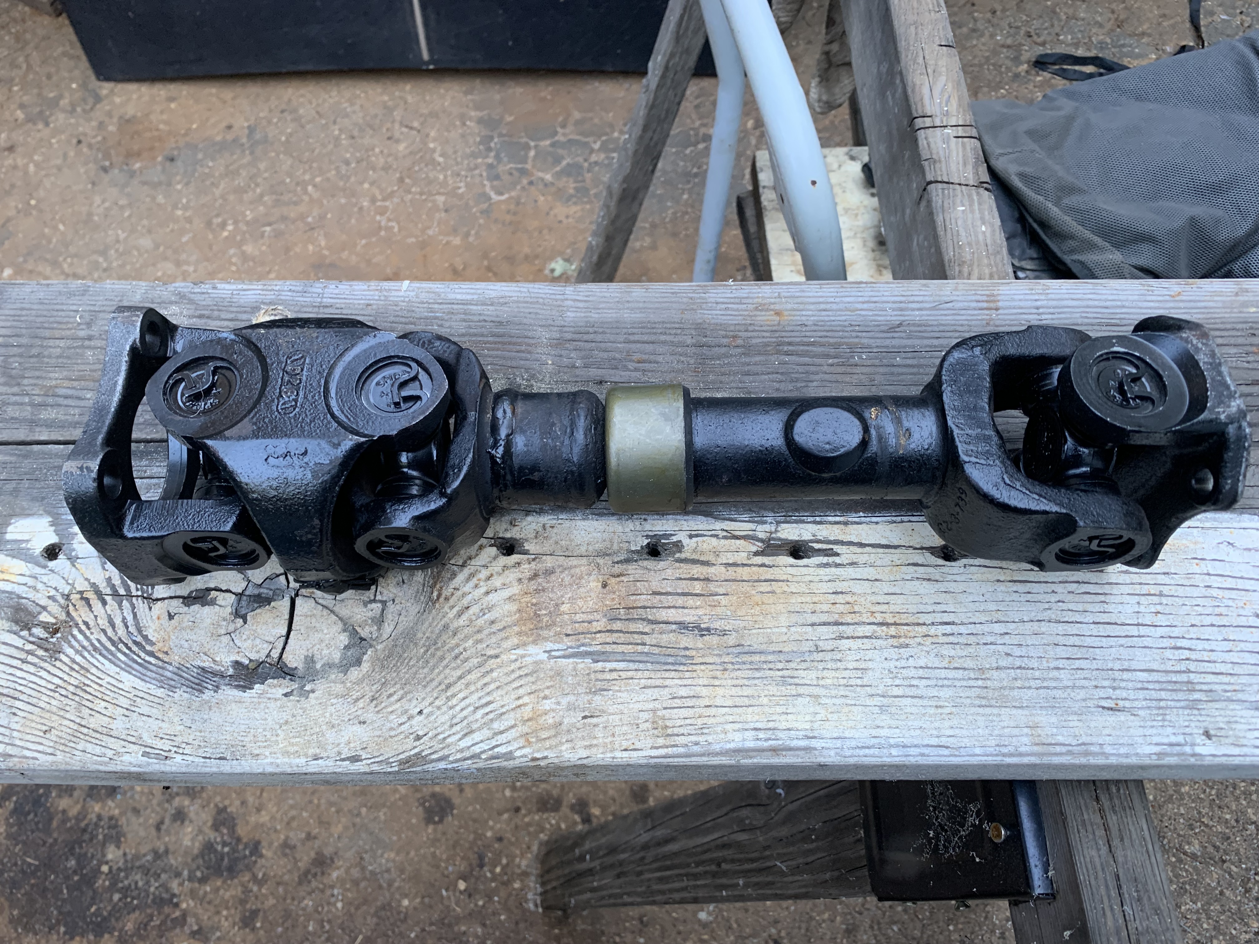

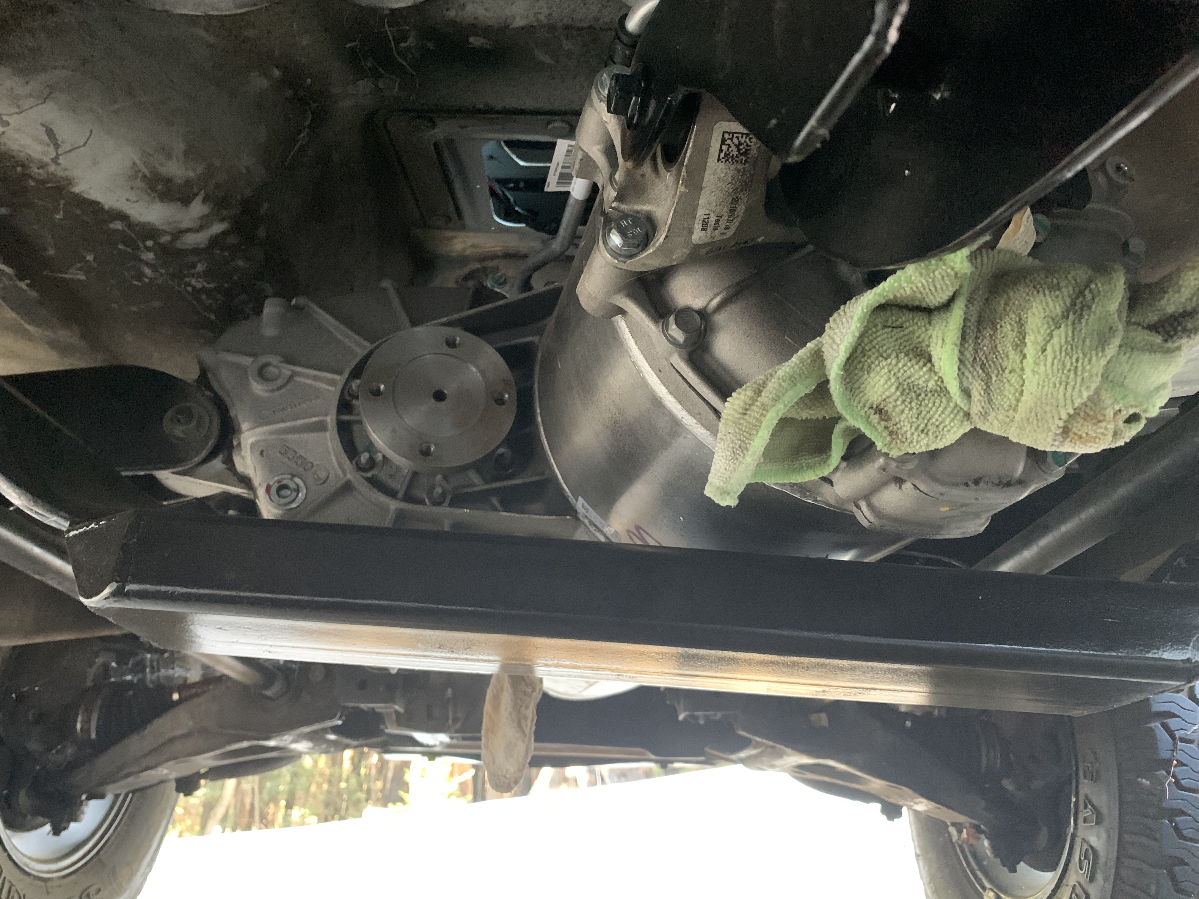

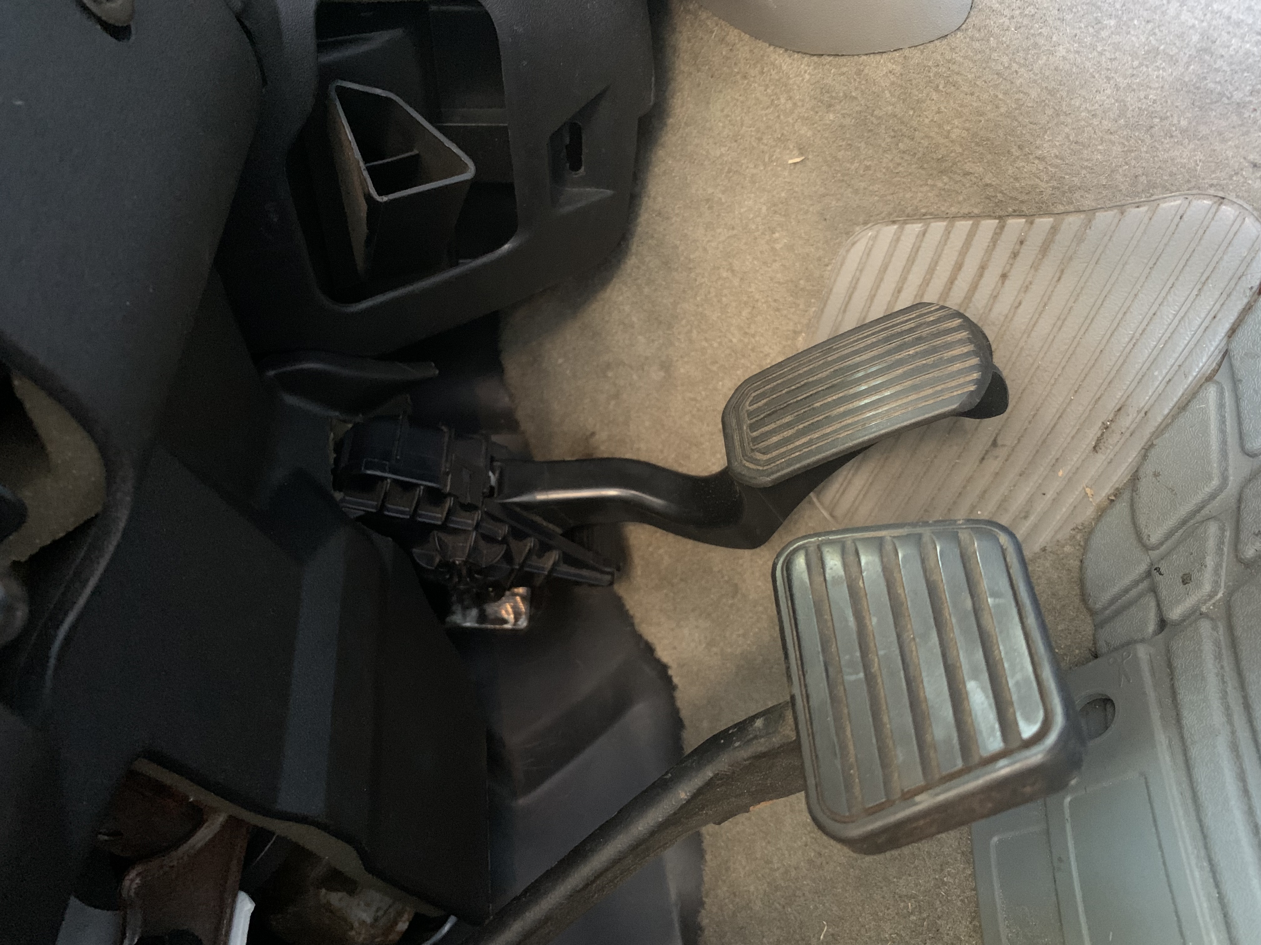

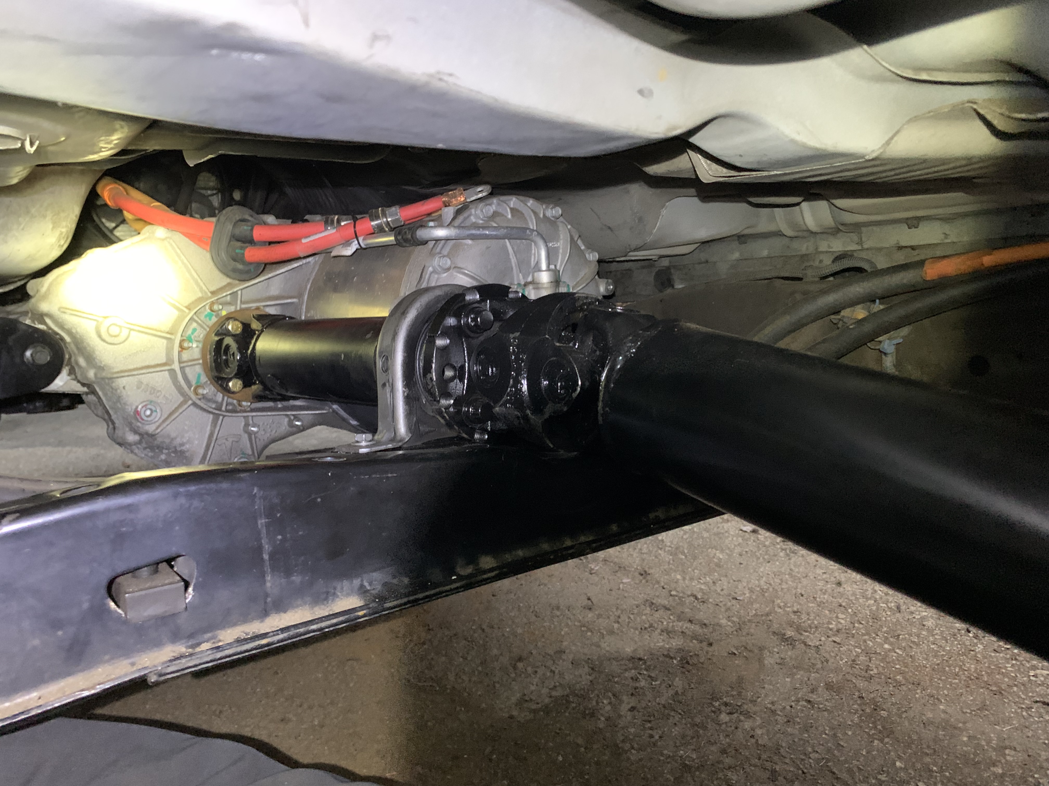

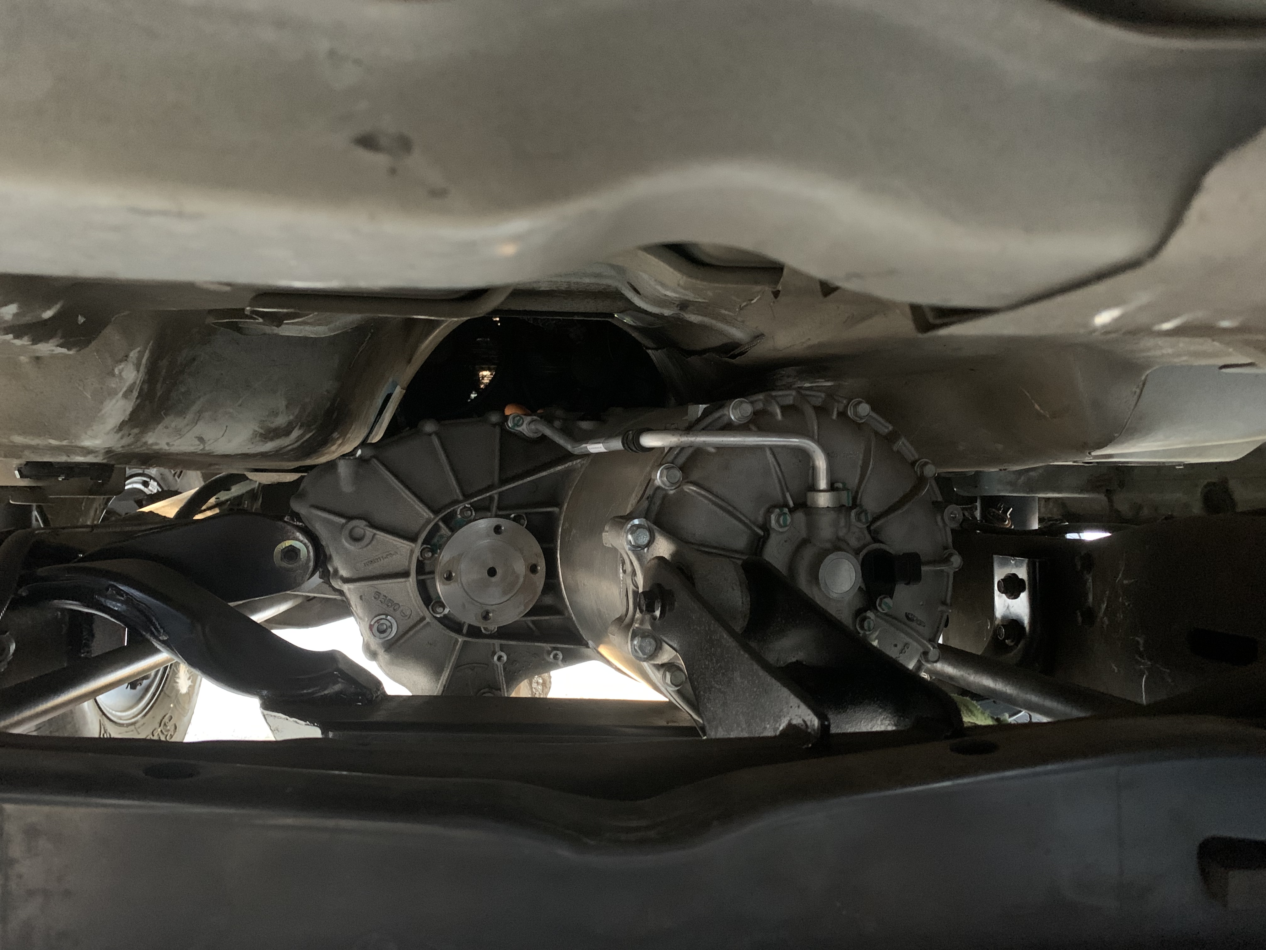

As for the remainder of the build, I've Quaifed all over the LDU with new gearing and LSD, plus the trusty openinverter controller. I've got a prius accel pedal installed and prius power steering (not yet installed). I got driveshaft adapters made at the machine shop as you can see in the pics, but haven't had driveshafts made yet.

are you going to get a plunging rear drive shaft made with a support bearing?

Yes, that’s the idea, a two-piece rear driveshaft with a carrier bearing mounted to the crossmember behind the LDU. The longer, rear section of the driveshaft will need a plunge or telescopic bit due to the solid axle suspension.
I mounted my LDU at an angle relative to the vehicle due to my front diff being off center over to the left. So while the output flanges are pointing in roughly the right directions, the angles aren’t all perfect, as in they don’t all add up to zero like in an ideal driveshaft scenario. Still don’t know if this mounting decision was a mistake or not. I’m hoping that some double cardan joints particularly in the front will do the trick. In my truck, mounting LDU at a slight angle actually allowed me to get it further up in to the transmission tunnel than if I’d mounted it straight.

Who’s got thoughts on mounting and BMS’ing the Model 3 modules? I really liked what SuperfastMatt did with his swap. My layout of the batteries in the vehicle will be very similar, but my current design has each module individually boxed. One problem I have is I didn’t buy the whole pack, so I dont have the full penthouse nor the structural elements from the pack like he does.

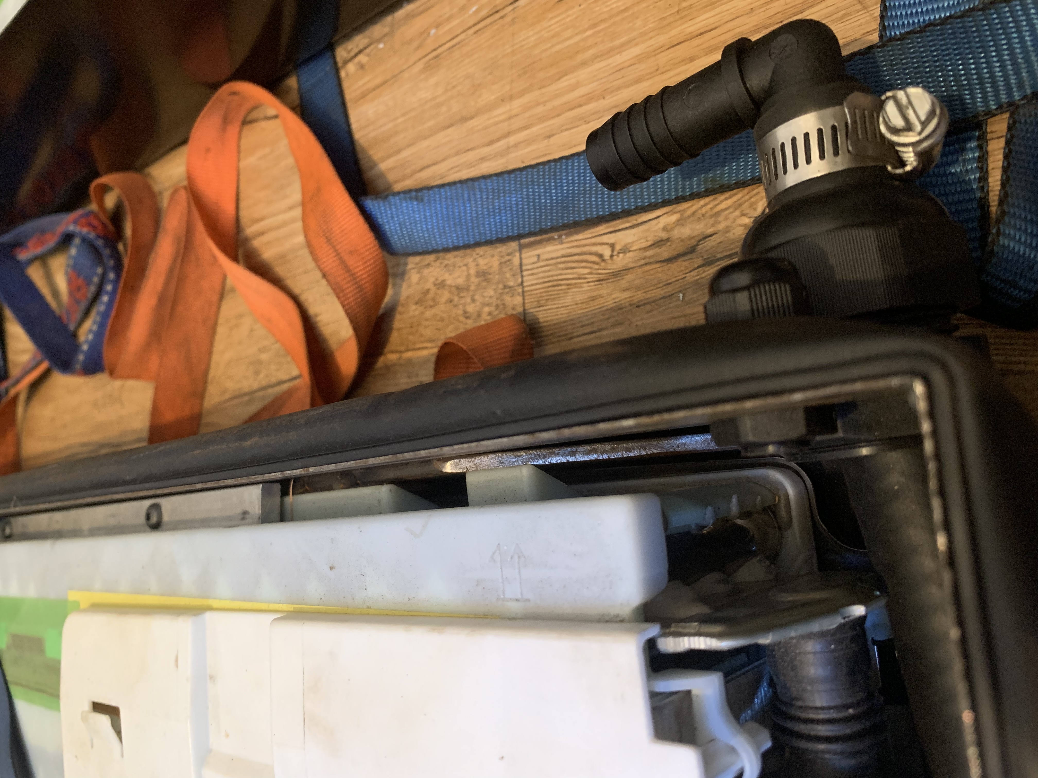

All four Model 3 modules individually reboxed and installed

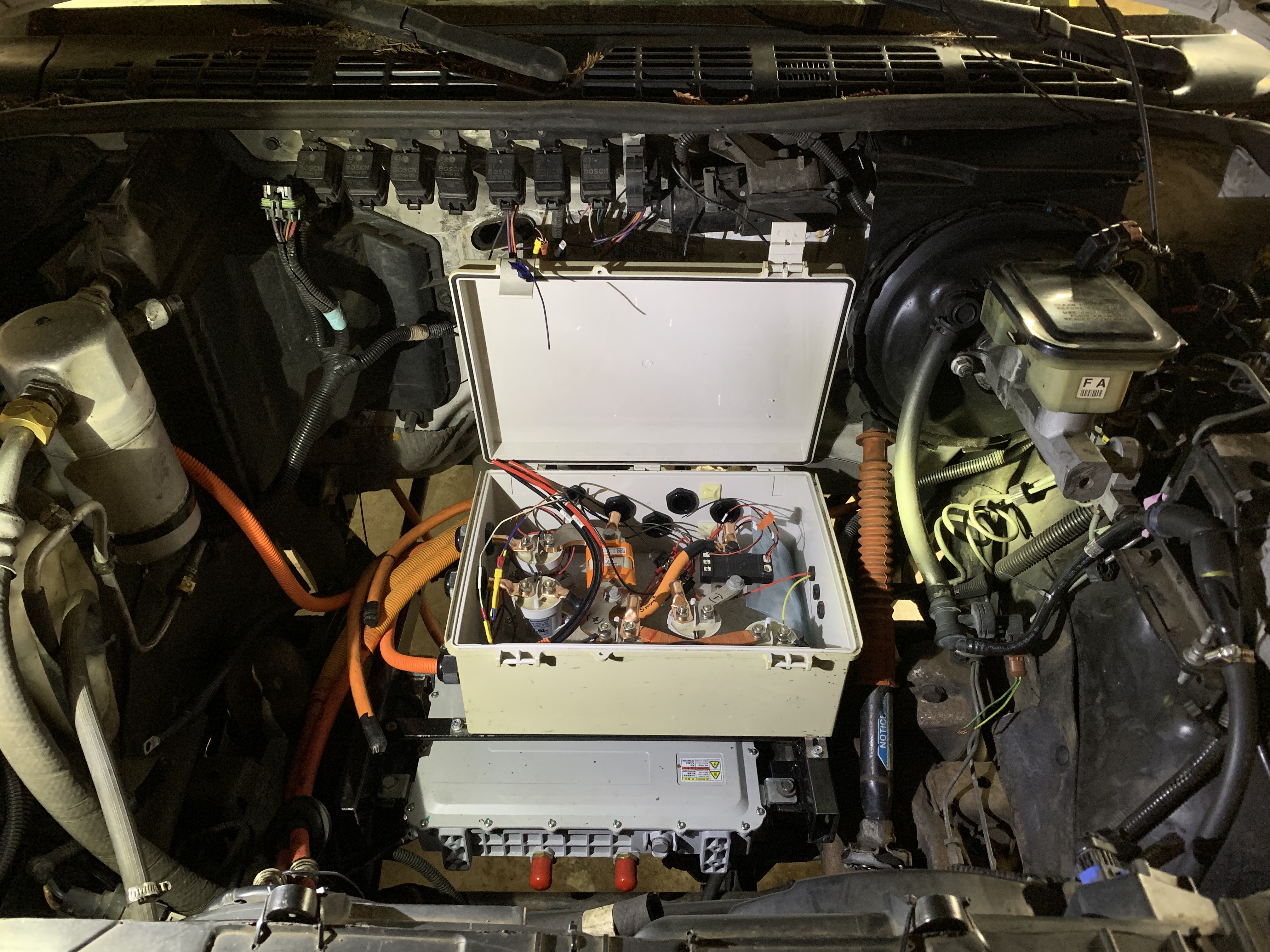

HV junction box mostly complete with ISH shunt, also have spare contactors for eventual Chademo charging.

ISH shunt wiring and setup? I downloaded the mfr documentation but still not exactly sure of myself
Does level II onboard charger (-) from battery (-) require going through the shunt?
